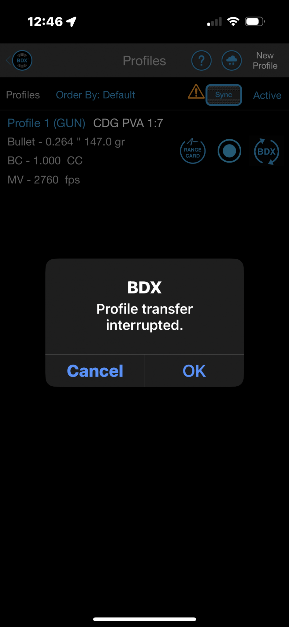

I’m having an issue getting profiles to sync with my 10K…. Specifically, I add a profile and try to sync and I get an error:
It will not sync any profiles, though matter how hard I try… it is connected to the phone and it just indicates it’s been interrupted
