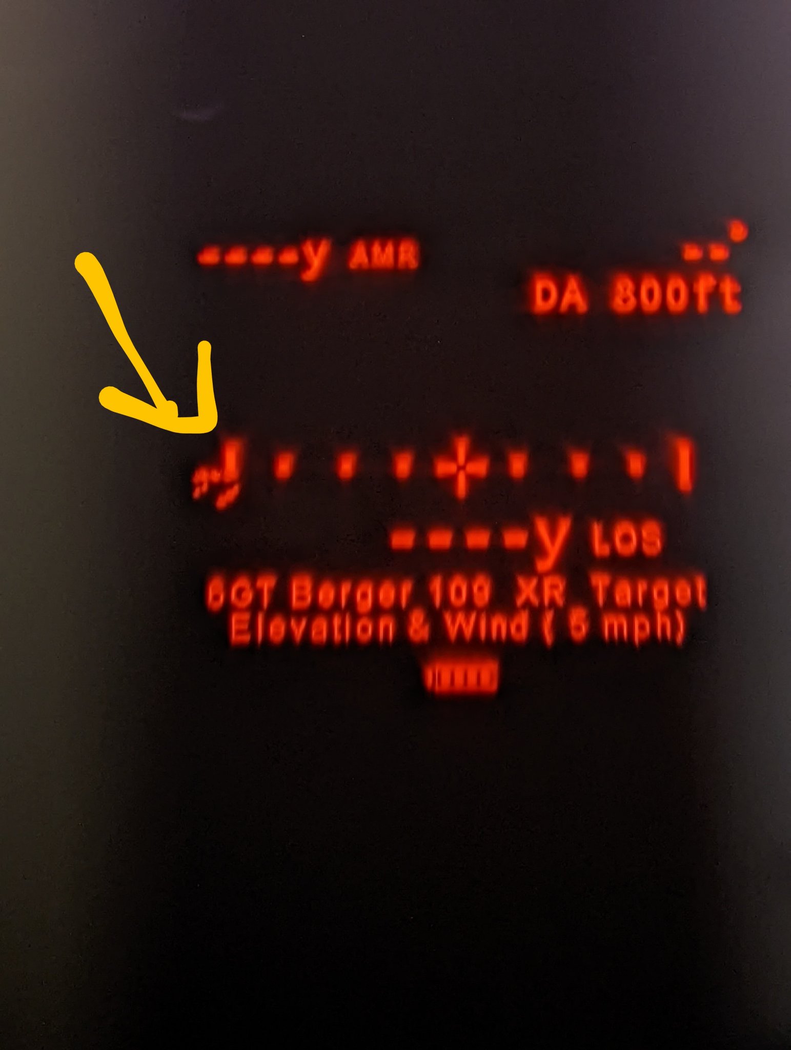

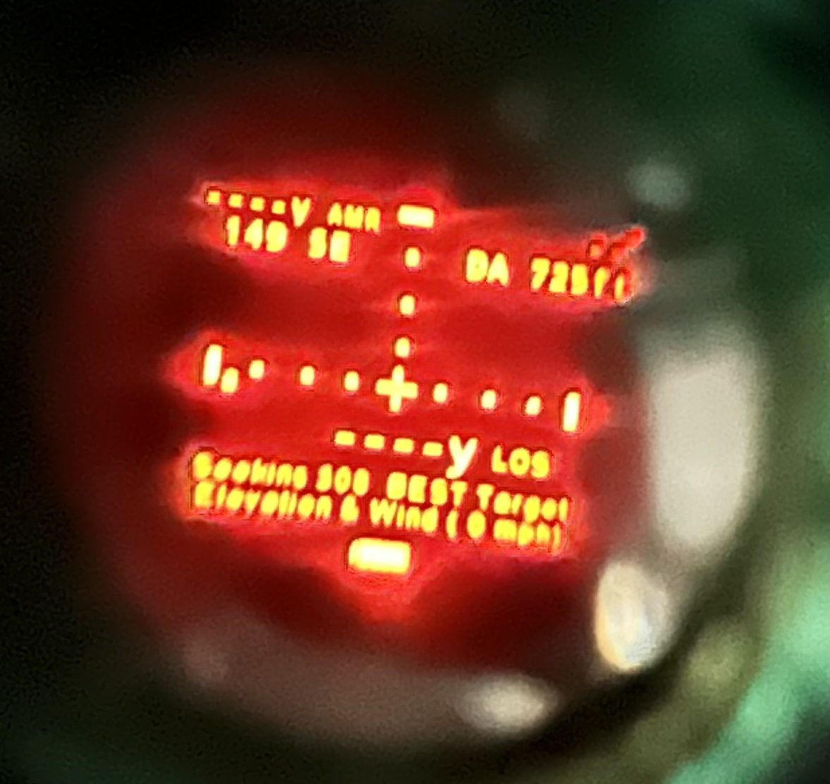

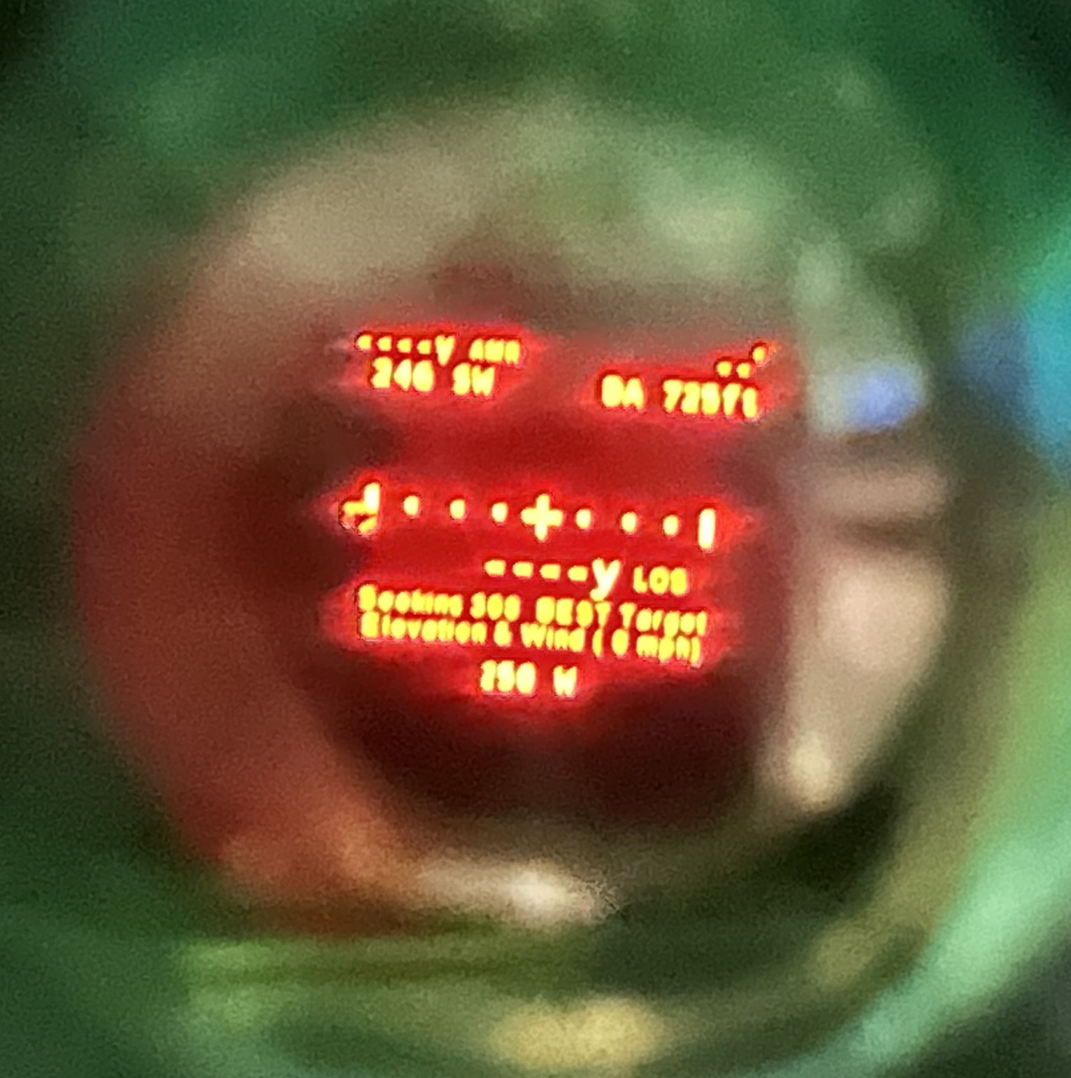

Did you try the specific setting? Target reticle and horizontal milling only? It's reproducible on all the units I've encountered... Including a local demo model in a store.
My reticles are all clean. I have the latest update and it shows the compass heading in the HUD.
I played around with a color palette and ended up with #f3faff as the tint I see.

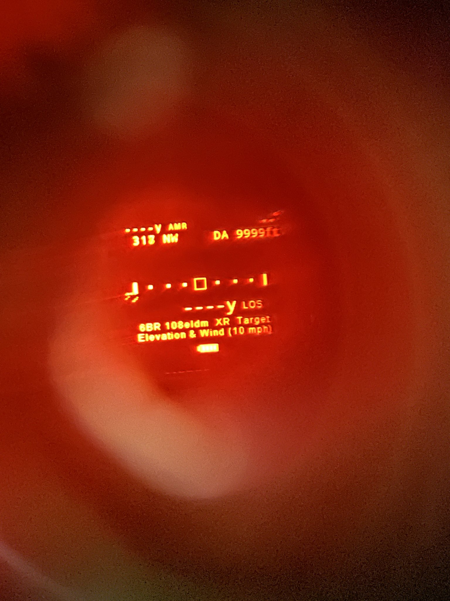

Well I guess I get to eat crow. Mine has the defect on left side on half grid. Hopefully the picture works.
And I’m using an iPhone.

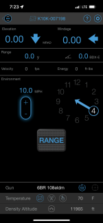

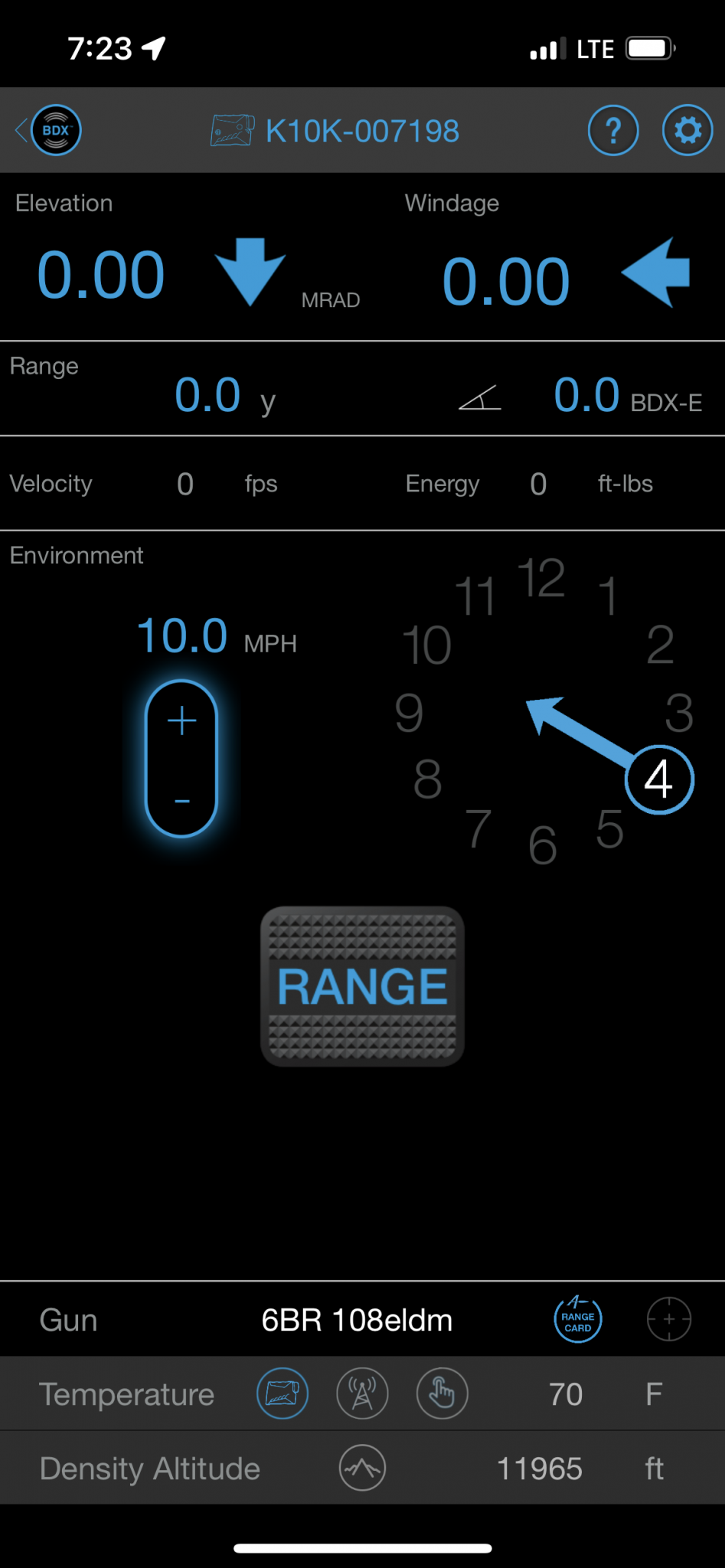

Next issue I’m having is my DA is always 9999. I live at 9000’ work at 10400’ and shot a match that was around 6500’
Each time DA is always 9999
So looking in my App the DA seems closer to what it probably should be. I don’t have my kestrel to compare too right now.

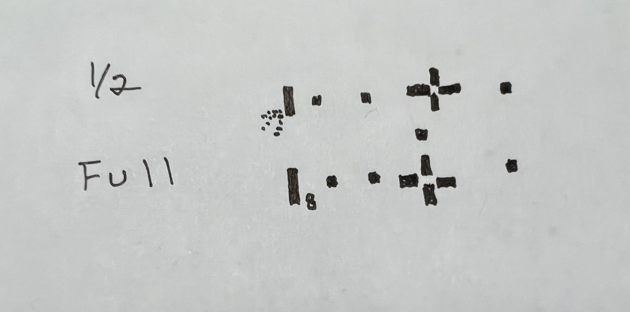

Sorry for the poor resolution but I added a cartoon drawing to help clarify what the pixels look like. 1/2 Grid (odd seemingly random pattern) and Full Grid (8) Center shape doesn’t seem to make a difference.
I use a new iPhone. I’ve sent these to a Sig rep and he should be getting back to me after while as he needs to ask some other folks there because he had no idea.
I spoke with SIG CS by the way, they say "there is no problem" with the horizontal milling grid. Unless there was a performance issue or technical issue, no reason to send them in. I also asked how to get the compass bearing on the HUD, they informed me that it doesn't exist but thanks for the suggestion and they will think about adding it later. 😆 What a joke... Standard CS experience from Sig. 🤦🏾‍♂️🤦🏾‍♂️
Is your temperature correct? If not, that might explain it.
Yeah, some of the CS folks seem to just want to get you off the phone. I've gotten great CS on this latest contact, so it just depends on who you get that day. I'll check mine when they come back from them on Friday re: diopter, compass, and the grid defect. If I see the same, I'll also get pictures over to them like @db2000 did, since they can't argue with reality.
I have seen this too. The DA 'maxes out' or some such , the actual DA that the binos report in the app is correct, so i think its a display issue. I use mine with a Tactix so I don't know if the ballistic solution is correct inside the binos, everything it sent to my watch was spot on and the dope from the system just worked.
Reactions: Stoweit and Baron85
That would make sense. I will try to do some more testing this weekend comparing to my kestrel and see what I get. Looking this morning the app does adjust compared to my home and work. Hopefully it’s just maxed out on the display.
So playing with my kestrel comparing to the kilos the kilos DA is around 200-300’ difference. This is looking in the app, the binos show 9999. So appears they are maxed out.
The temp in the kilos are about 5* higher than the kestrel. This was after 30-40 minutes sitting inside my house on the counter side by side.
Same experience mostly minus the 9999 display. Mine matches but I have to input the temp manually in the binos, otherwise it was off quite a bit. There were a lot of differing variables as I was in my truck as it was raining and cold outside, etc where the Kestrel was. When they are both in the same climate they seem to be within 200’ or so DA.
The temperature is going to throw off the DA. Mine arrive back at the house today and I’ll see how close they measure to my other temperature probes.
