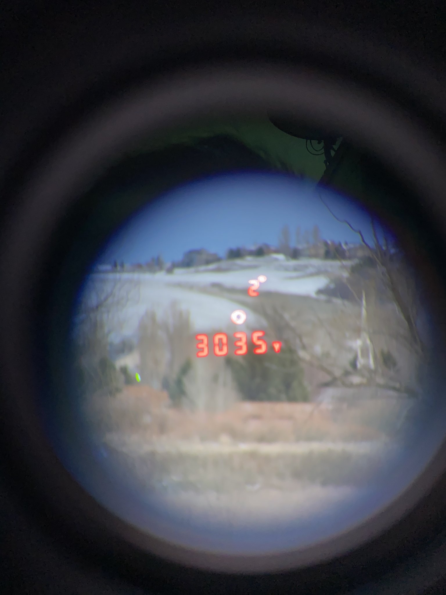

I used my Sig's last year at the NF ELR match. I ranged those targets out to the 2200 (or whatever it was) yard target they had without issue. My ranges were close enough to the Terrapin X and other vectronics that were in my squad and the squads ahead of and behind me. (Ranges were always within 10-12 yards I would say) I was able to do that again at Q Creek in the fall during some pretty windy, rainy, foggy conditions. Spotting with them has never been a problem at any of the matches I attended last year at any point or spotting game during reasonable shooting hours.
For normal PRS/NRL matches (1200 and in), i was always within 4-5 yards of everything else I was around last year. I am confident in them that the range error is well within the danger space of whatever I am shooting for the job. If you true up your drop with whatever RF you use, that becomes even less of an issue.
Free hand. 35f - overcast. 3035 on a side of a house.
Like Tac said - if it’s the danger zone - cool. Just don’t drop connection and we will be friends.
