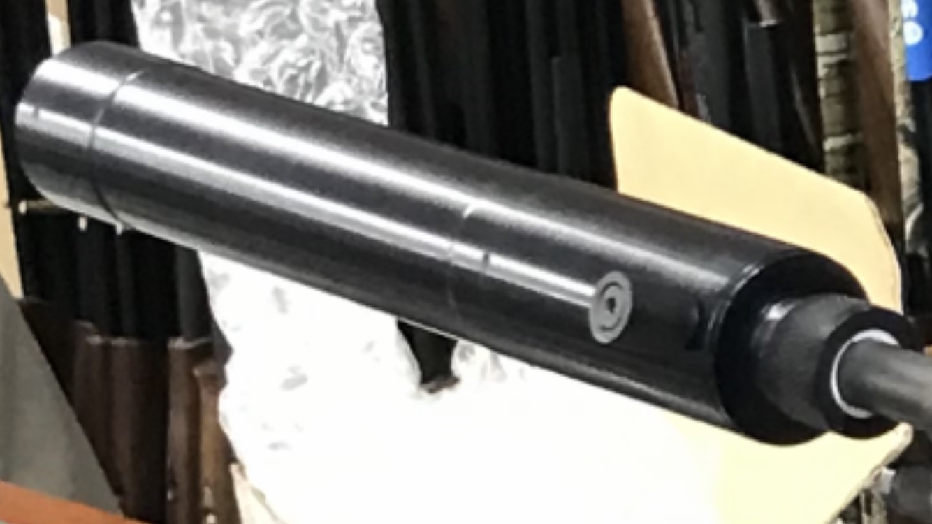

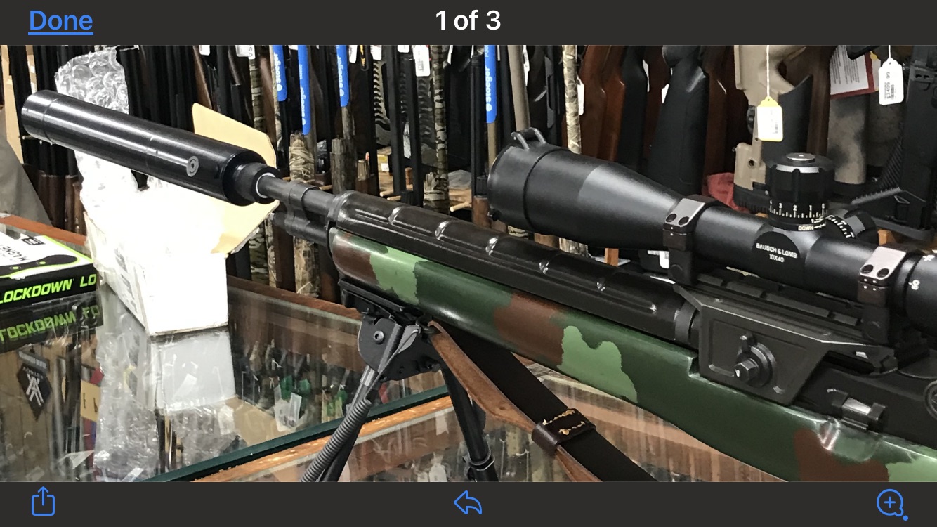

A few years ago I was lucky enough to have acquired an original Sionics M14SS-1. Long story short, I had it reverse engineered, and it turned out to be a well done copy of the original! The manufacturer even went so far as to try it on his rifle with great results! I know folks have make suppressors to look like an original but only in looks, these are nearly carbon copies of the original SIONICS suppressor Both inside and out to include a working relief valve.
I plan on using it with my XM21 rifle. Pictures when I figure out how!
