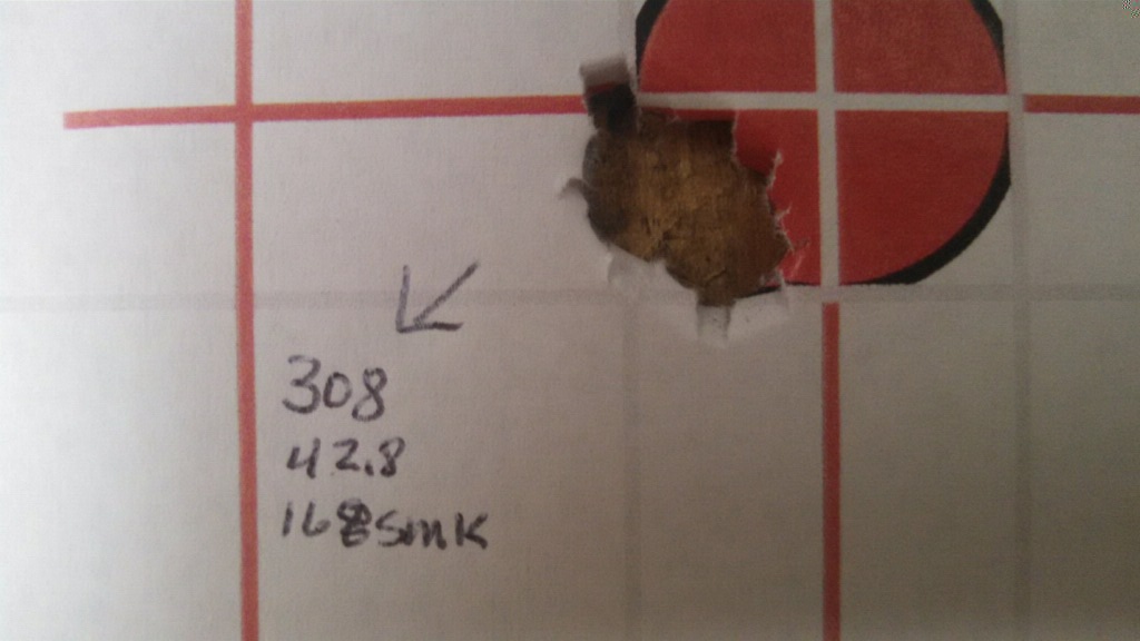

Dan gave me this load information back in May when myself and two friends attended his long range shooting class. In our discussion I said I could not load anything that shot as well as the FGMM ammo in my 308. So I took his info home with me. Loaded up ammo using prepped FGMM brass, GM210M primers, 42.8 grains of IMR 4064. This picture shows my best 5 shot group at 100 yards.

I was shooting with Sean Little a few months ago ( Sean owns Vapor Trail Tactical.. A training course. He is a well known Former Marine Scout Sniper and helped test and design the newest addition of the M118LR military sniper ammo, and he told me that in his basic conclusion during all the test was that 42.0 IMR 4064 with a 175 shot the "most consistently accurate and repeatable of all loads tried". He also said it didn't matter what brass you used... Lapua, Lake City, Federal ect... 42.0 was it. They were shooting the M24 and M40. That being said I took him up on the idea to try 42.0 with a 178 amax out of a .308 Custom with a Stiller Tac 30 action , a 28" HV Bartlein 1:11.25 and boy oh boy. Guy knows his stuff.
FYI. , the dot is 3/4" sticky I bought at Walgreens.
I loaded up 60 rounds but just haven't had time to shoot at distance. However , the SD and ES were really low with an average MV of over 2700 fps.
