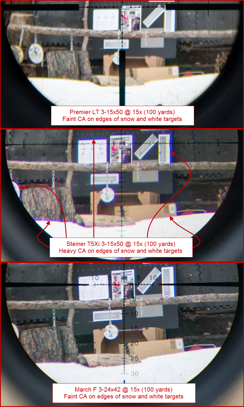

CA is definitely a subjective experience, some see it some don't, some are bothered by it, others are not. My worst experience with CA came from the Steiner T5Xi series (both the 5-25 and 3-15), my thought process was if I pay more than $1500 for a scope it shouldn't have "that bad" of CA. The Kahles K624i was another disappointing experience with CA (especially at it's price point, but that is because CA tends to bother me). The Mark 5 definitely had thick CA that was worse than any Schmidt I've owned so our mileage varies there. Atmospherics and lighting play a pretty big role in CA as well so depending on the day one might see a lot to very little. The XTR II does have some heavy CA but no worse to my eyes than the Mark 5, and I felt the T5Xi was worse than the XTR II. To me, where the Mark 5 3.6-18x44 really excels is in ergonomics, it is really short and has some of my favorite turrets on it. If Leupold came out with a nice .2 mil Christmas tree reticle along the lines of the MR4, Gen 3 XR, SKMR3 with an illumination option, I think the Mark 5 line would be more compelling to some.
The image below shows a comparison I did when I had the T5Xi to some other scopes, CA in pictures can sometimes look worse than with the naked eye because you are dealing with another optical system with lenses (that have their own CA) to take the image. You can see the center image with the Steiner has almost a ghost effect at the high contrast edges. While CA is not going to hinder you from hitting your target, it can be distracting at best and cut down on perceived contrast/detail at worst. (My general disclaimer: never use internet pictures of through the scope shots for an example of image quality (IQ) because it is very difficult to get a through the scope image showing off how good the image appears to the naked eye.)
Thanks for the images. Disappointing to see it that bad in the Steiner.
Keep in mind that newer reviews of the Steiner seem to indicate they have "fixed" some of the earlier CA issues on their T5Xi line. With some of these scopes there seems to be a high level of sample variance, meaning that one scope excels in an area while another scope off the same line does poorly. Reminds me a bit of OEM vs. aftermarket camera lenses, in the past it used to be that if you bought the OEM (Nikon, Canon, etc.) you could expect a certain quality level, whereas if you bought an aftermarket lens (Sigma, Tamron, etc.) it was hit and miss, some lenses were fantastic while others were less than stellar. For this reason, I highly recommend the Hide dealers when purchasing new scopes, most of them are willing to work with you and as long as you don't mount the scope in rings they will accept a return for another scope, so don't allow images like the one I showed above to dissuade you if you really like a particular scope, the adage YMMV applies here as there are many shooters who love their T5Xi's and swear they can't see any CA.
