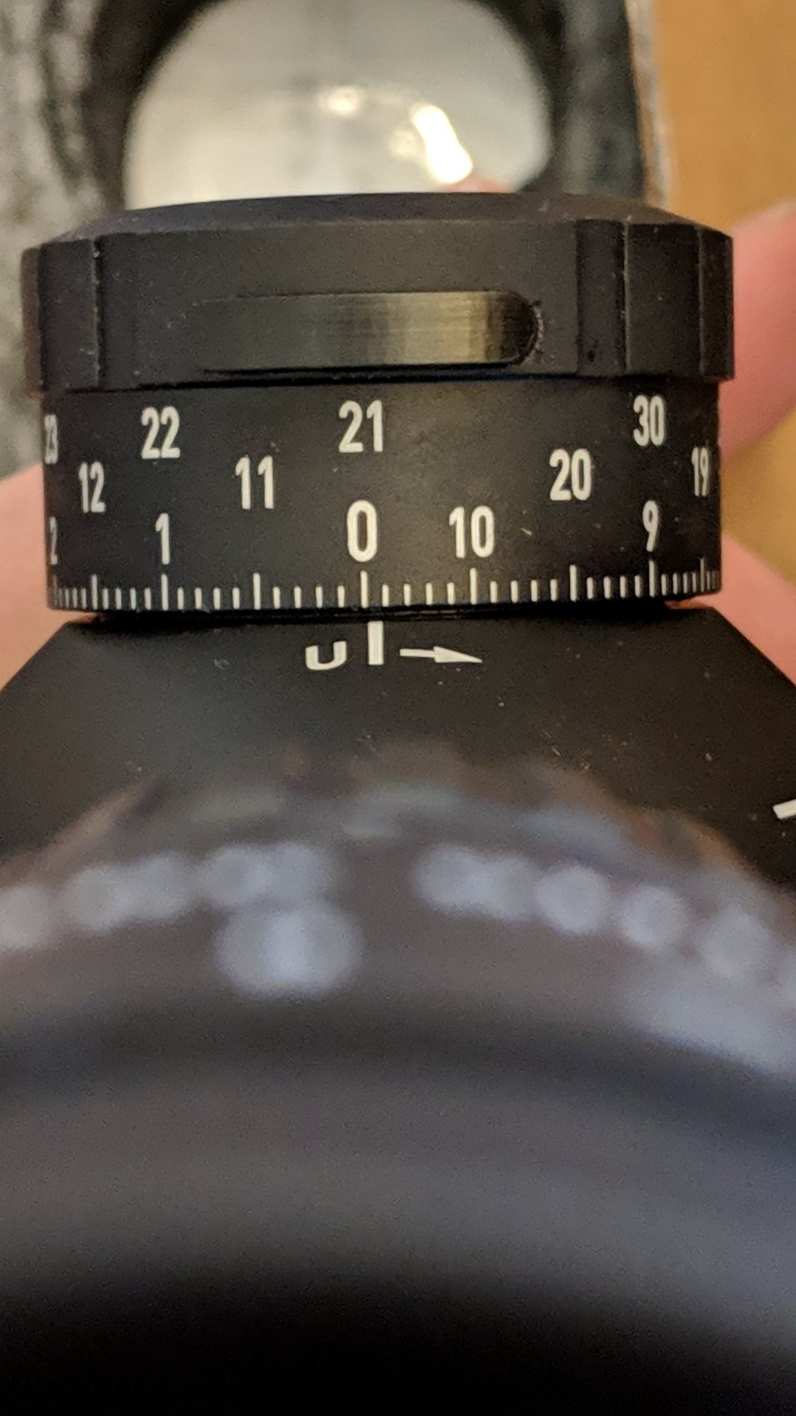

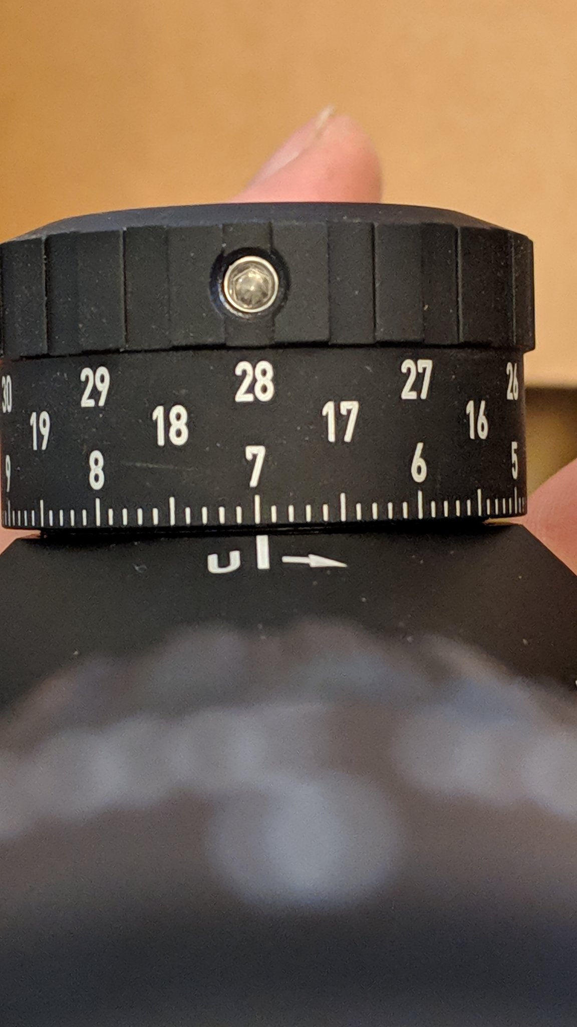

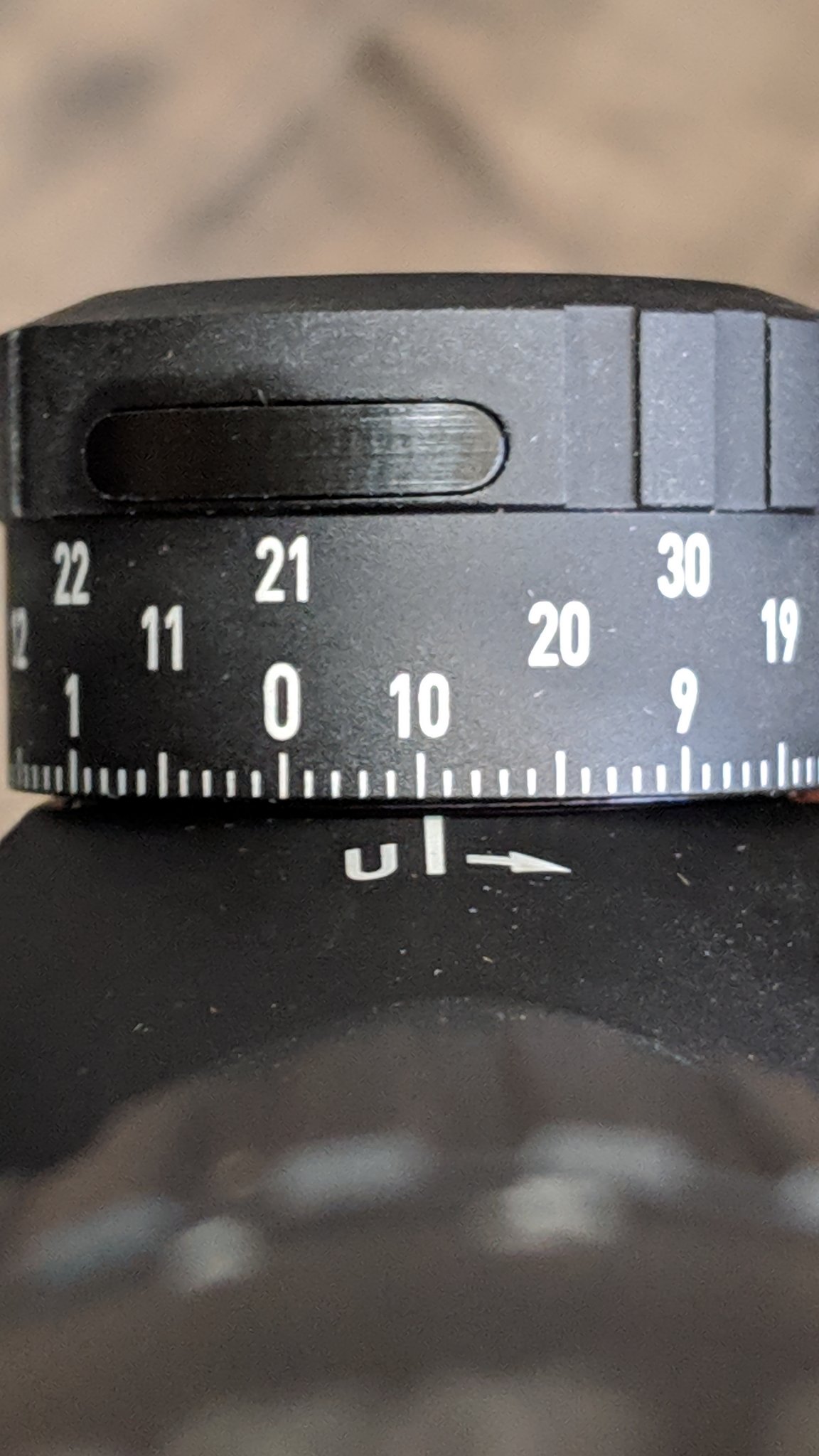

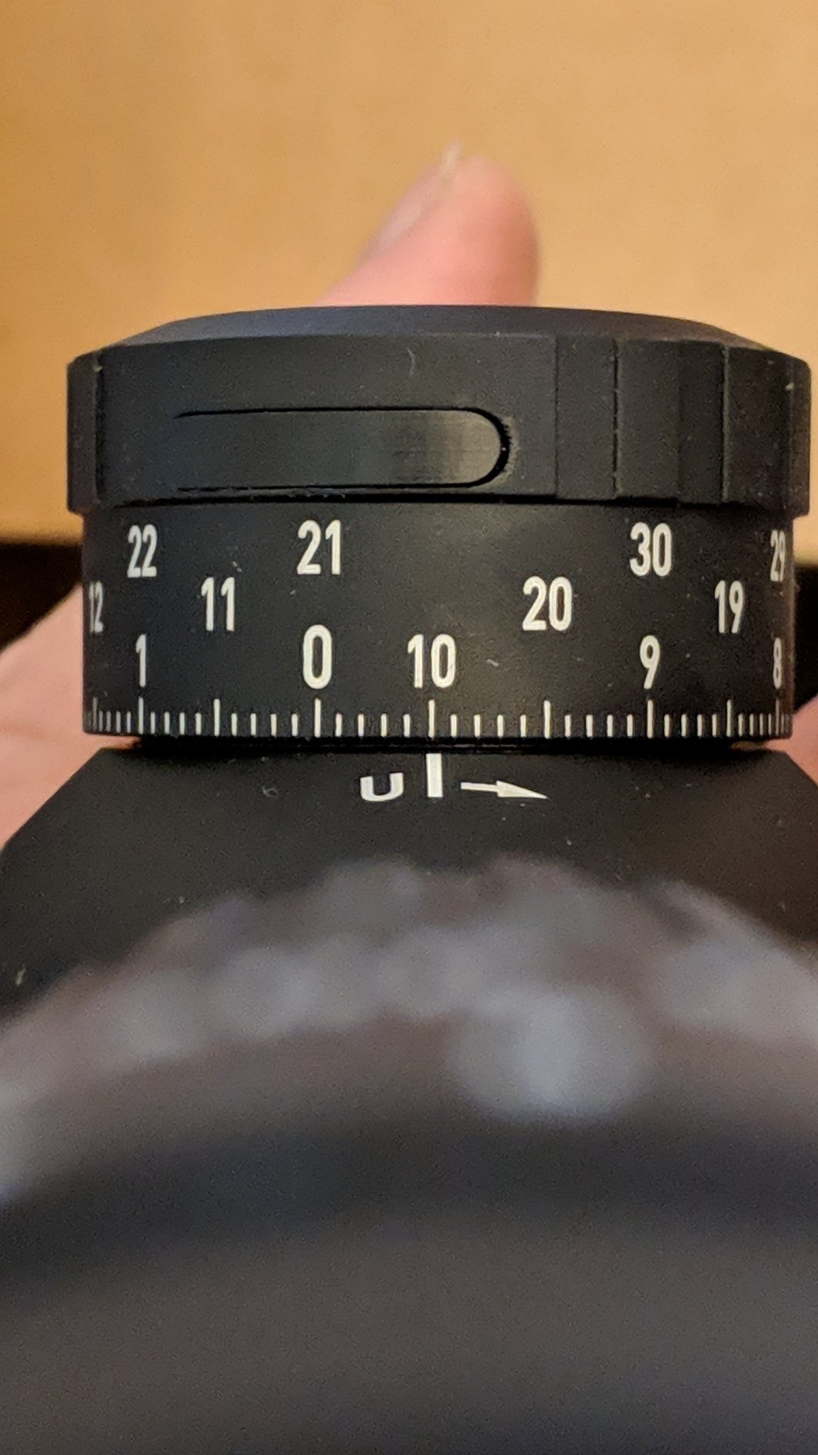

Turrets: I love the turrets. I had some apprehension before I decided to make my order. My experience with the M1, M5 and CDS (gen 1) turrets has been that they track well but have a somewhat mushy, inaudible quality to them. By contrast, my experiences with most of the German and many other flagship scopes has been crisp, audible and tactile. John, A Leupold employee by week, military sniper by weekend assured me that I would be pleased. He didn’t disappoint.
The Mk5 turrets are crisp, audible and very tactile.
The turrets lock at zero in the same way that the Leupold gen II CDS turrets do, but unlike those, these will go half a mil below zero to allow some flexibility if one has their gun sighted in at, say, 200 or 100 and a close shot calls for a sub mil adjustment.
As previously stated, the elevation is 30+ mils of travel, requiring multiple revolutions. Leupold’s turret indicates the second rev to the user via the button imploding into the dial. Upon entering the third revolution, an indicator button pops up on the top of the turret, much like many other scopes out there.
Tracking is perfect. Noting else to say here.

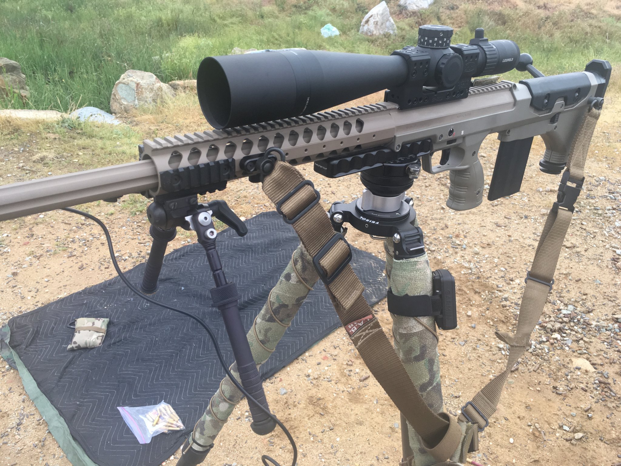

I shot one of my Mk 5 scopes in a PRS match in June… It had been my first PRS match in many years. There was a Leupold rep there from Houston who got pictures of my rig with the scope on top. He didn’t just take my picture, however. I was surprised to see at least five or six others using the new Mk 5s. Hopefully we see more in the future months and matches as Leupold gains new followers.

I own two now, both 3.6-18 T3’s. I had put one up for sale but decided against it before anyone bought it.
IMO the only thing keeping it from being perfect is the stupid indicator markings on the windage. It’s hard to line up/index. Not sure what Leupold was thinking there, but it’s a non issue for me as all I use the windage for is to zero and then the cap goes back on.

Anyone else have a elevation turret not line up? No matter what it is in between the hashes. Not a good first unboxing when it just arrived at the door 2 minutes ago. Spun the turret and losened the cap as if I was zeroing the optic.. still always back to what the first photo shows. When you dial it to about 7 it's close. 10 mils it's on.

I don't have any doubts Leupold will repair it. But being a brand spanking new optic I hope they would just send me out another. They repaired 2 mk6 optics with turret issues for me and I was pleased with the service. I'll give them a call.
They may very well do that.
TBH, other than the first small run of these, I haven't heard of any issues with the Mk5's. And that first small run issue was due to switching from a military contracted version to the commercial version (as I understand it), and didn't affect the performance of the scopes, it just confused folks by the markings on the turrets.
Well they are sending me a new elevation turret cap first to try out. I have another one of these coming tomorrow to put on my Fix rifle.. So I'll prob swap that turret cap on there quick to see what it looks like. Guy mentioned the markings are just most likely off on the turret but he had not heard of it before.
I don't have any doubt they will take care of me. Just disappointing as I have my arc rings here and ready to go shoot it this weekend.
Yes. mine are like that also. Who did you contact at Leupold about it ?. Guess I'll be giving them a call Monday. Thanks in advance.
I was #26 in the wait line and they called me back about an hour and 20 minutes later. Not sure the guys name, but he said he was sending me one 2 day air. Just talked to tech support.
