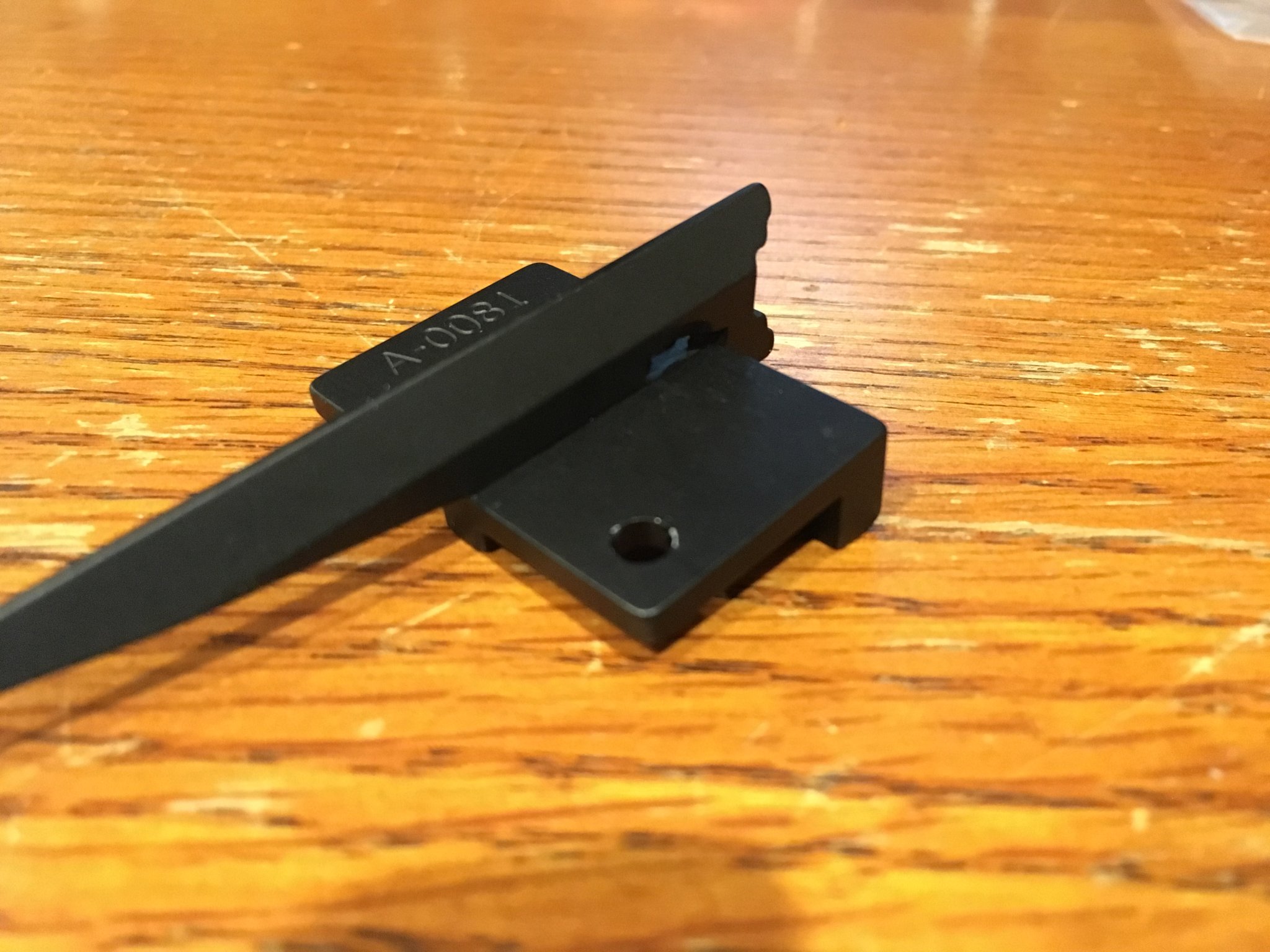

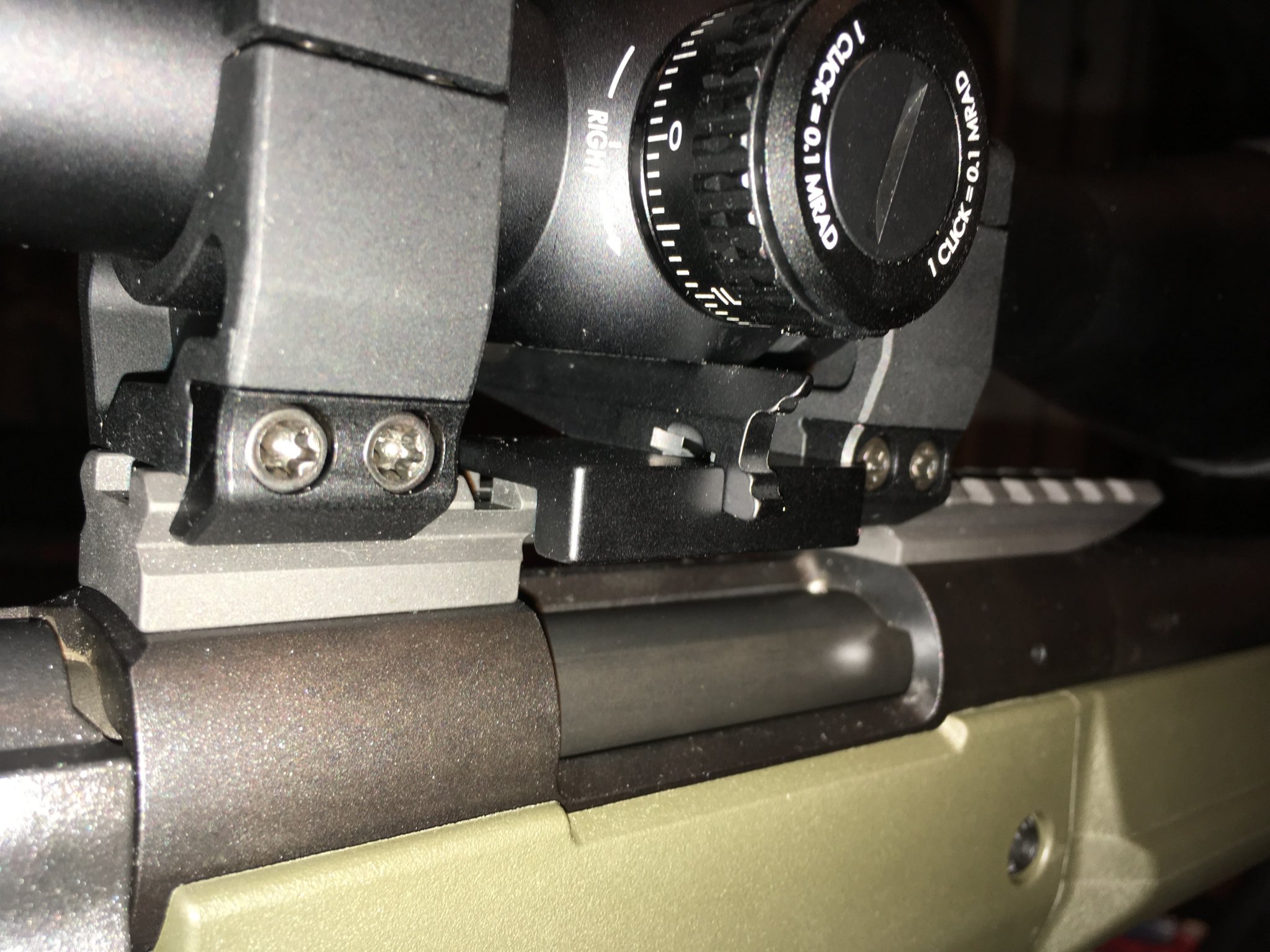

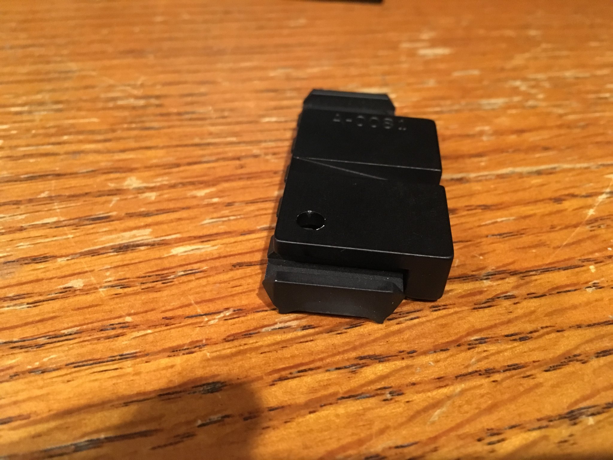

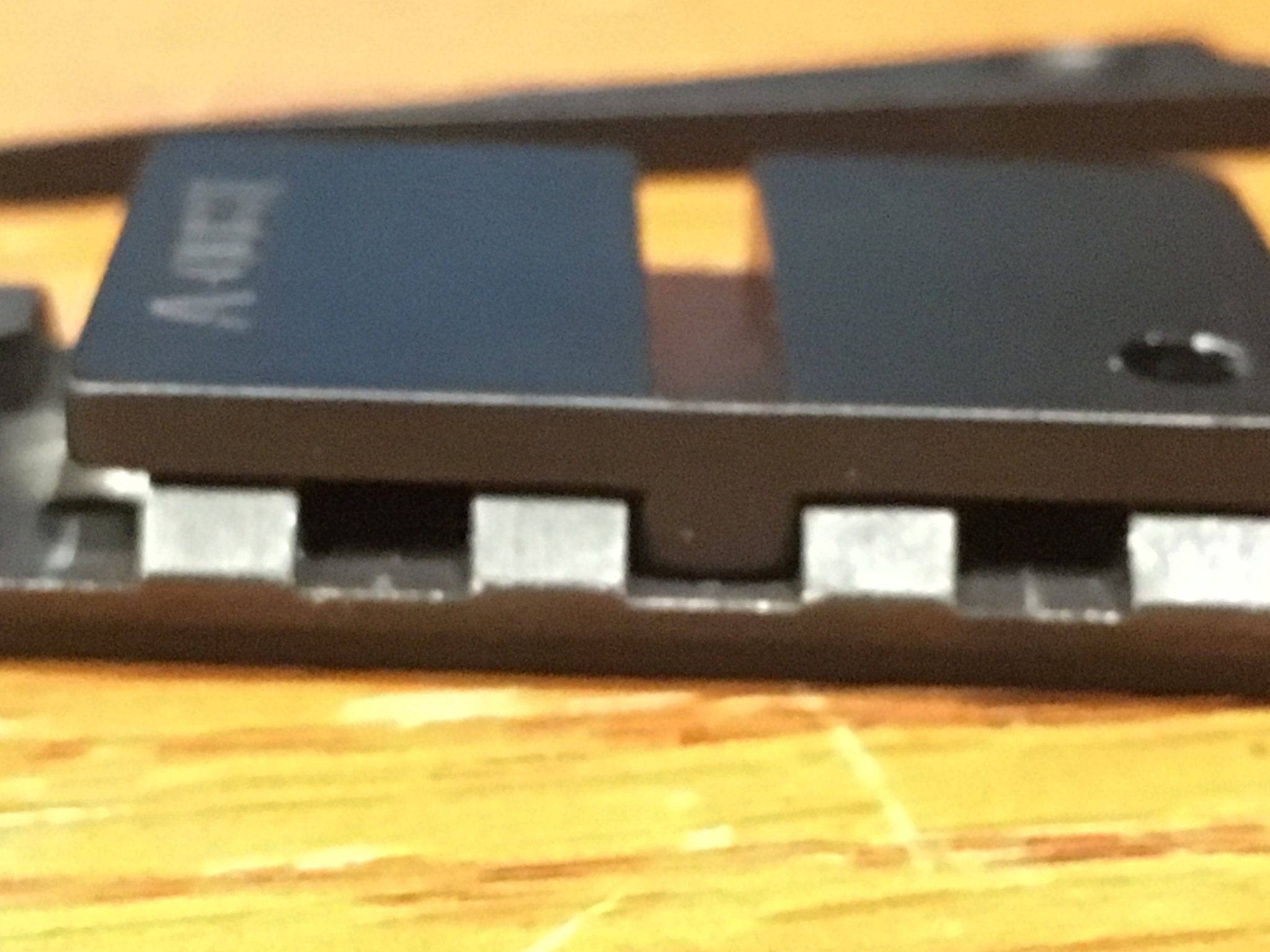

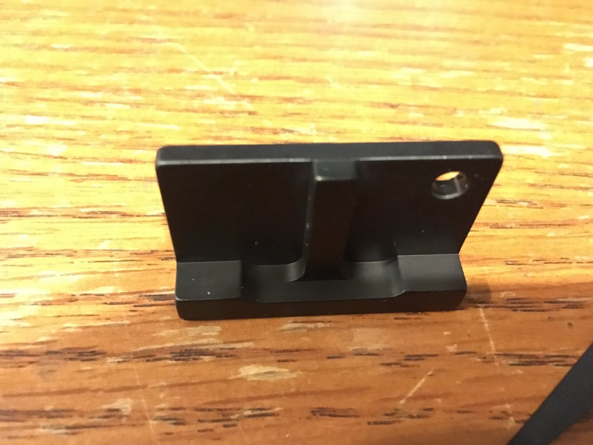

These spuhr leveling wedge kits work really good for scope rings if you want a simple way to level the scope. They are $30 & makes leveling easier

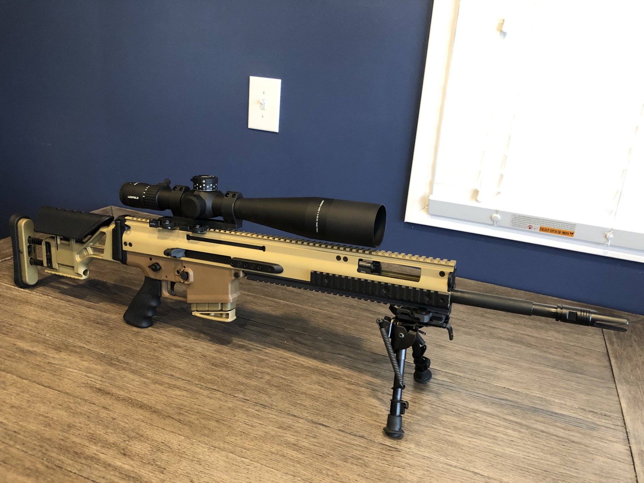

...anyone have a pic of the Leupold Mk5 5-25x on their SCAR 20S?
I should have a picture of the SCAR 20S with the Leupold later this week.
I bought a Leupold Mark 5HD 5-25x56 with CCH this weekend at Fin Fur Feather and have a LuRue Tactical scope mount QD LT745 (20MOA/35mm) enroute.
I have the Arisaka optic leveler combo and just need to install once the mount arrives.
I plan on trying this scope out on the SCAR 20s and my DD5V1.
Eventually plan on getting a SPUHR 4602 and possibly a NF ATACR 4-16x42, NF 5-25x56 or a Kahles down the road and have a dedicated scope for each platform.
With the weather breaking just want to get to the range and get some time in with the SCAR 20S.
That's cool, so is Spuhr selling those separately now vs. the leveling tool when you buy their mounts? One should also note that not all scopes have perfectly perpendicular reticles to the flat of the scope, they should be but you should verify with a plumb or level after. Also, I prefer to mount my scopes so the reticle is perpendicular (the vertical stadia to the horizon) with my natural hold (I tend to cant straight stocks to the left slightly) and so mounting my scope in such a way provides for much less adjustment when settling in behind the rifle - this tool will not work for those situations.
Reactions: LAW-DOG
I always plumb & check the tracking when mounting, the level usually puts me right on or very close to perpendicular. It makes things a little easier to dial in
Reactions: Glassaholic
Yeah the spuhr leveling kit is separate from the 1 piece mount designed for separate rings using the rail between the rings. There’s also the arisaka level which can be used for other 1 piece mounts, it has a flat bottom, slides between the mount & scope with a wedge

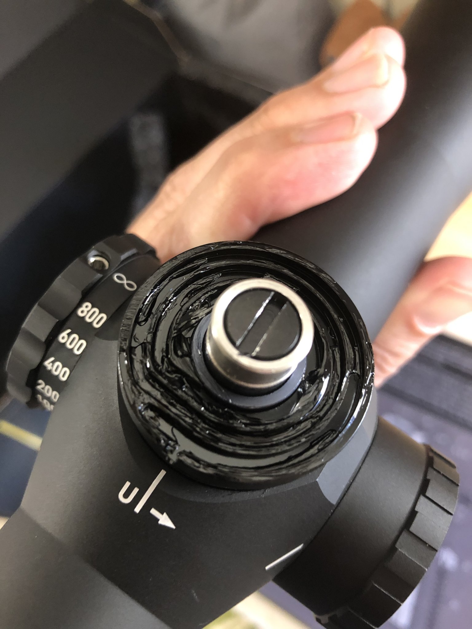

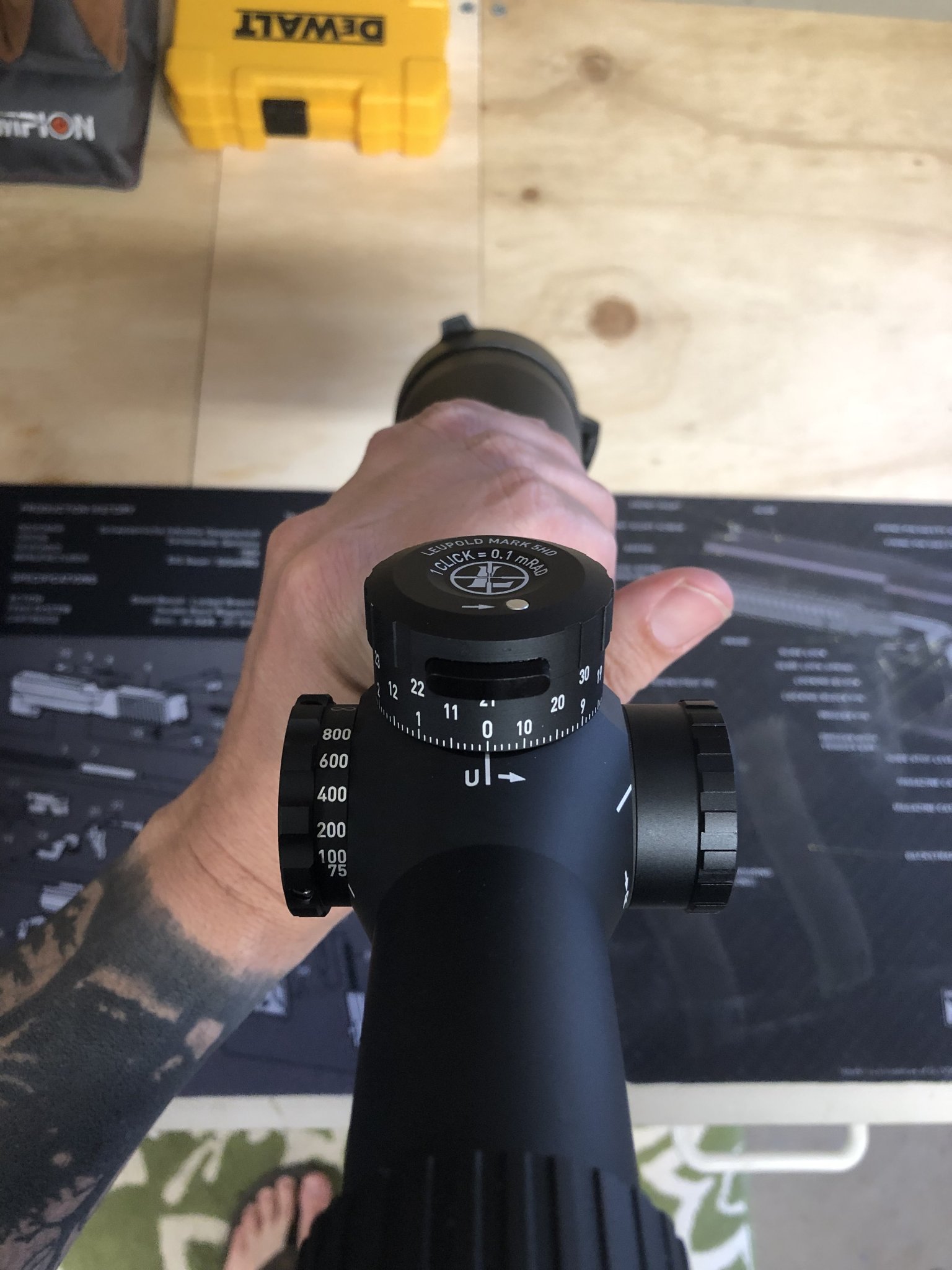

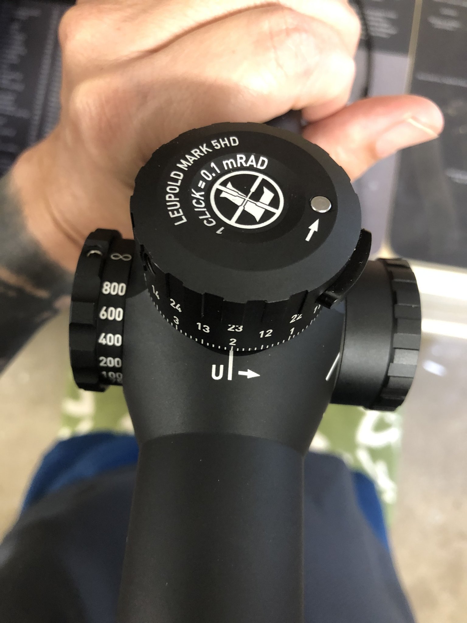

So just to sanity check, my new mk5 5-25, the adjustment screw under the elevation turret is used to set your zero?

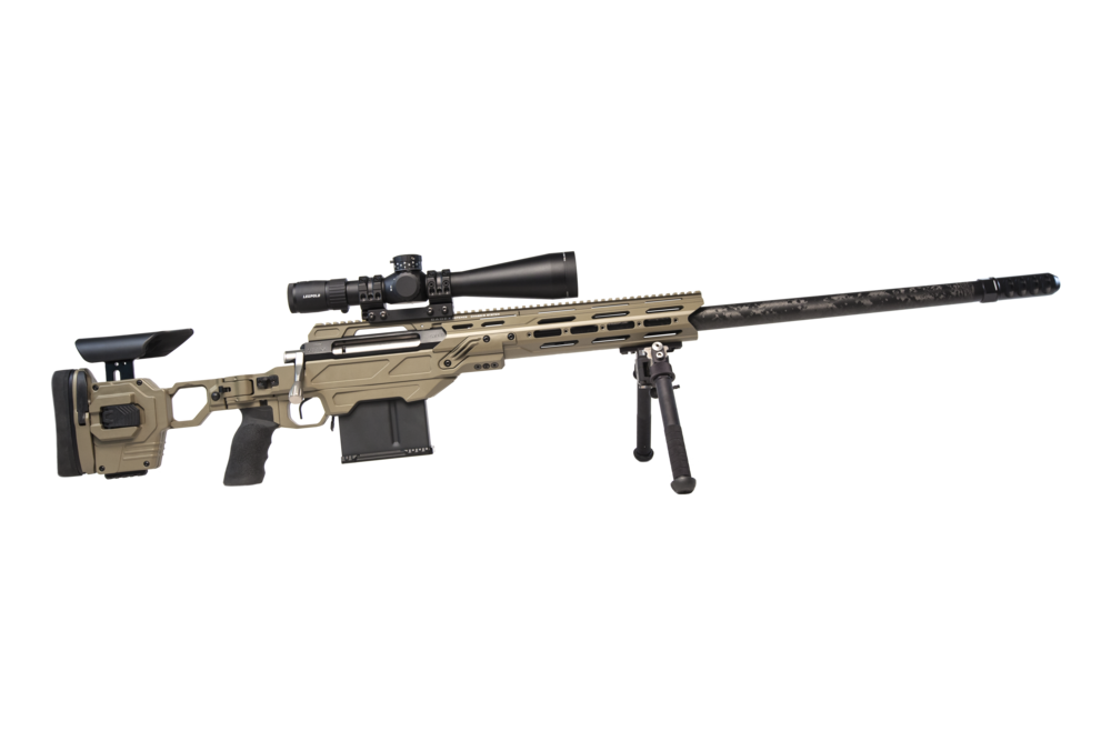

Whats everyone using for rings/mounts? I had ARC M10’s on my AT. Just got a Cadex CDX-30 with a flat top and wondered if there is another good mount outside of Spuhr.
Using a 3.6-18x44 version
I’m using mk4 high rings on my LRP Bergara XLR 6 mm creed
All you have to do, in regards to the turret hash marks lining up, is loosen the set screws, line up the hash marks, and tighten down the turret set screws. Mine line up perfectly.

Ya, removing the turret is not necessary. You adjust to your observed zero (say 2.3 mils), loosen the set screws, turn back to zero (locks in place), tighten the screws.
Ahhh...got it! Really impressed with the MK5 HD. I see the higher magnification model is out now. Looks impressive! I wonder what the set screws on the parallax are for?
Setting the parallax. Mine for instance was closer to 75yds on the dial, when shooting at 100yds. Loosen the set screw, set to 100yds and tighten again. Now 100=100 on the dial.
Ok...I didn’t know you could identify what your parallax was. I set mine to bottom out at 75, the infinity setting goes way past the mark.
