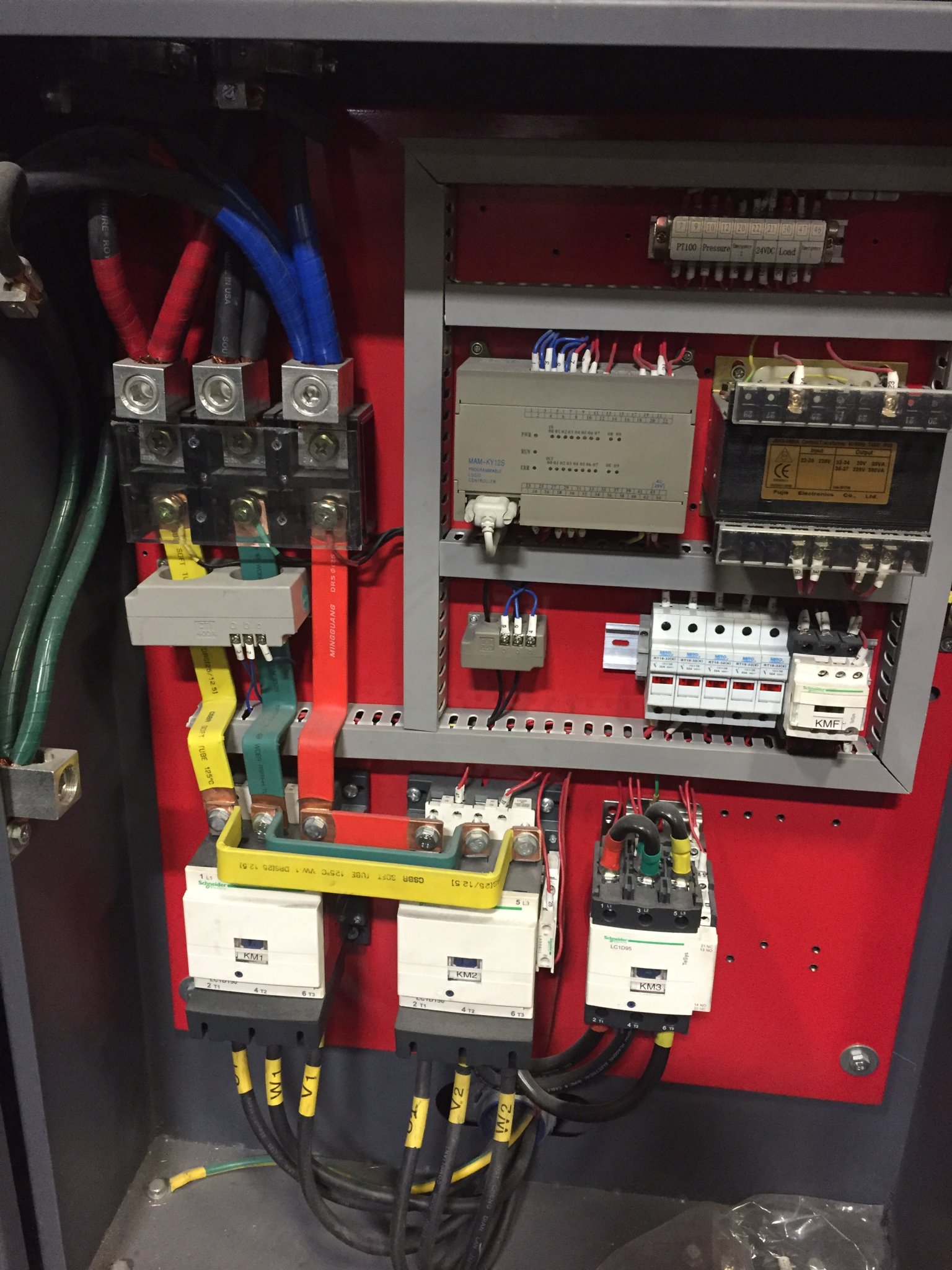

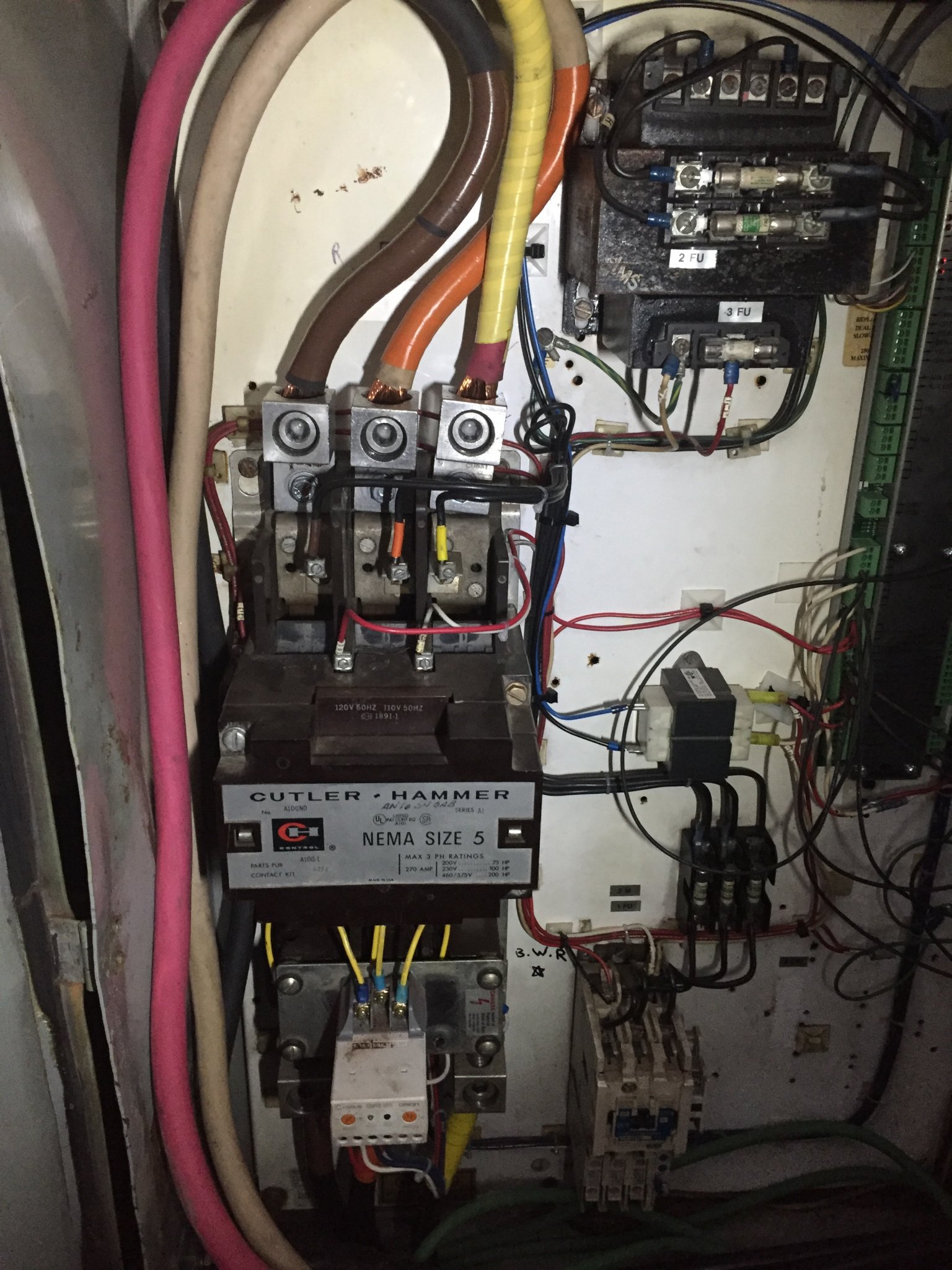

High amp stuff scares me. Both of these setups were in the +200A range, lower unit is sketchy chinese shit. Think the top was 575V, lower 460V. eta: lower was 480v service stepped down to 220 now that I think about it. Enclosure just had a magnetic panel for a cover.
I'm digging that green heat shrink to identify B phase. I guess in Wuhan they just use whatever they have on hand.
