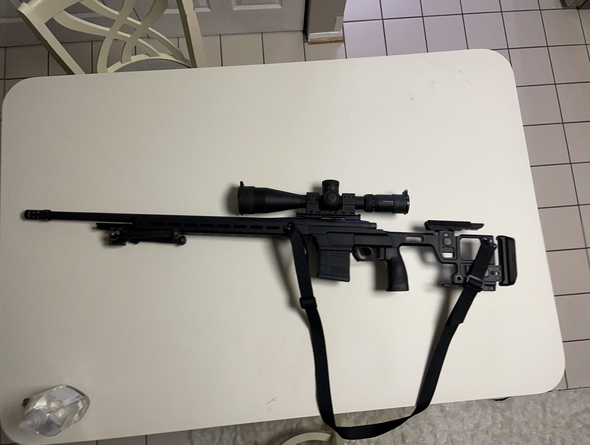

I cut the geek piece so it slides out easily. They are supposedly releasing a folder real soon so that will solve all the issues with the cheek piece for cleaningI just got my chassis in today and took the rifle to the range. I have to say, I love the look and feel. I need to adjust the mag, but not that big off a deal. The only real issue is the cheek comb. Hard to get the bolt out and I think it is going to make rifle hard to clean. Anyone found a solution?

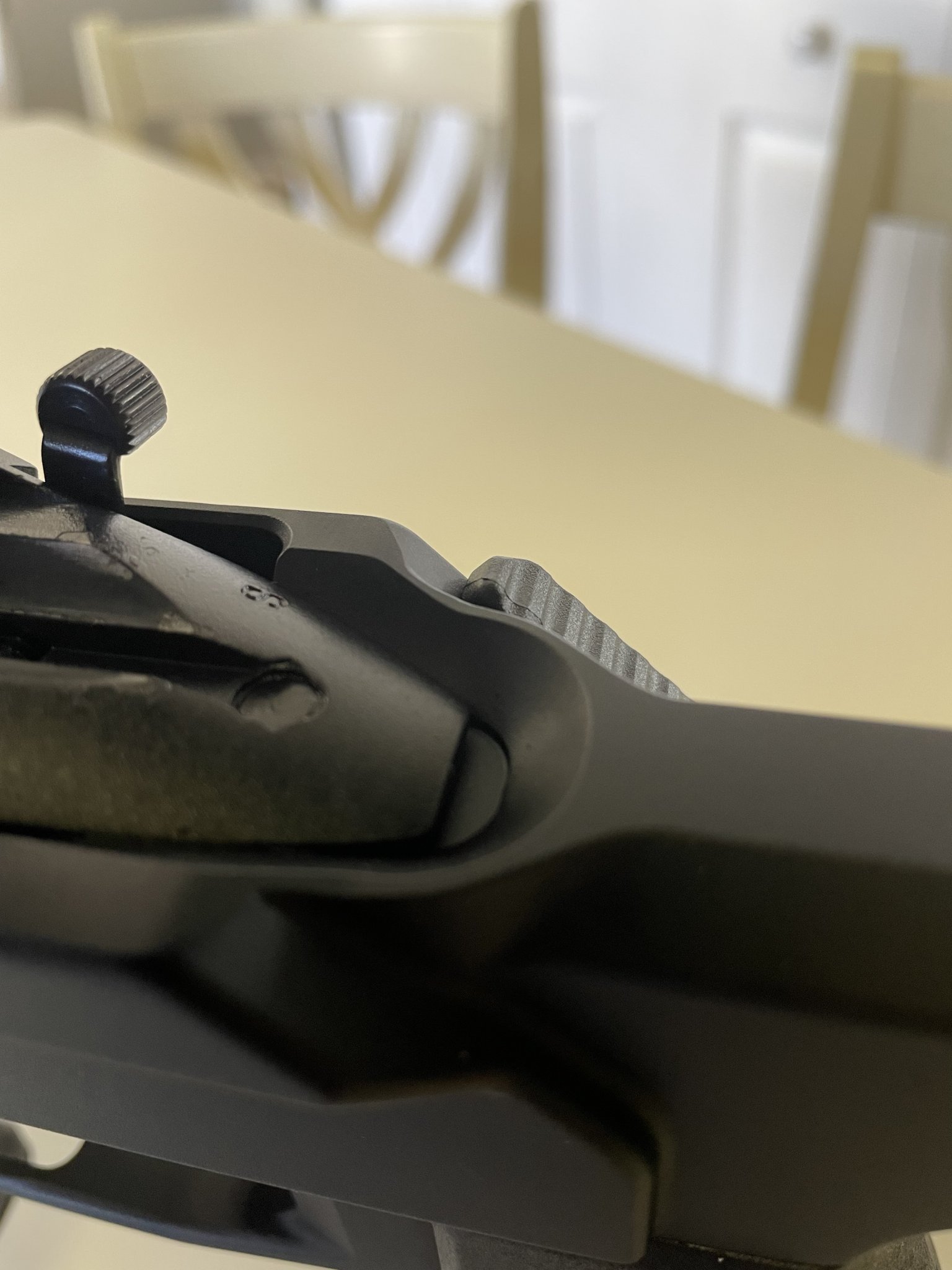

Does the rear screw protrude up into cocking piece raceway? If it is above flush, I suggest shortening the rear screw or using shim/washers.My Solus chassis came with the shims. I put three of them on the front action screw and the bolt moves freely on my R700 action. No shims on the rear, no problem

You're good, on mine prior to shortening the screw, it was protruding up enough the cocking piece was catching it on the way through.View attachment 8381174
