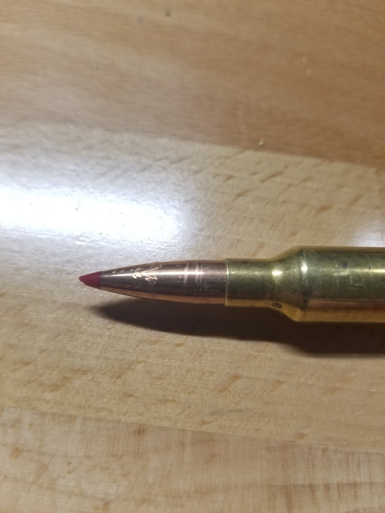

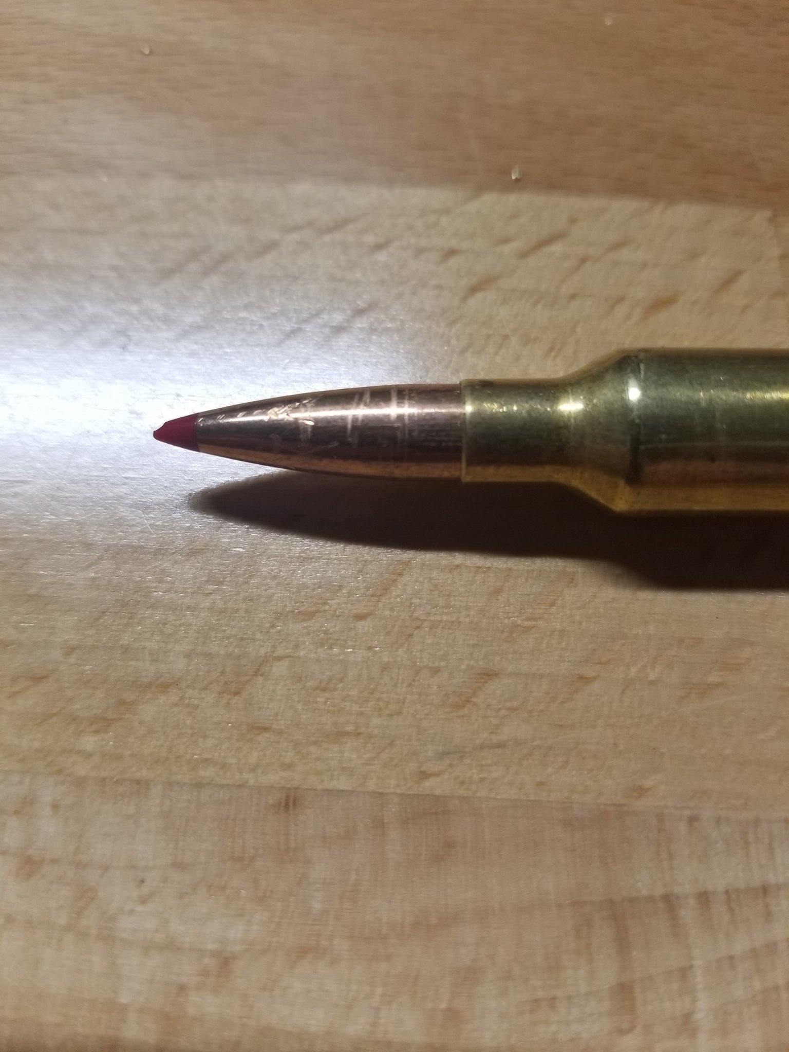

    I decided to try to load up some rounds for my new gas gun in 6.5 Creedmoor today and am having a hard time with my OAL. Bullets are 140gr ELDM. Using the Hornady OAL gauge if I shove the bullet in until there is no more movement I get an OAL of 2.8500. I tried loading some dummy rounds with OALs between 2.830 (Max mag length for my PMAGs) and 2.725 and they all chamber fine by dropping the bolt from the locked back position but when cycling the bolt it takes considerable force to extract. It's also pulling my bullets back out of the case some on the dummy round. I tried chambering a factory Nosler match round (all I have factory ammo wise) that has an OAL of 2.7445. Again, chambered fine but was crazy hard to extract pulling the bolt back. Examine the bullet upon extraction shows that it is pretty gouged up (pictures attached). I tried to use the OAL gauge and only push the bullet in until I met the first resistance and the OAL consistently came back at 2.6055 with the ELDM. This seems really short. Any ideas on if the problem is with me or is my chamber trash?

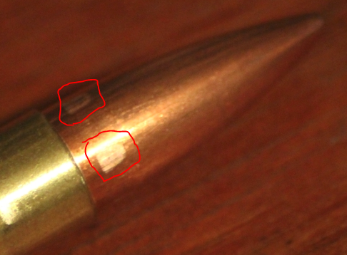

    I dont really see anything that shows its been jammed in the lands. This is what land imprints look like, little squared off things.
    I do see some gouges but I would assume thats from you feeding it into the chamber and dragging it over feed ramps.
    I also see what looks like you ran some steel wool over it, could be indicative of a tight freebore diameter. Smoke the bullet (unpowdered, unprimed case) or cover it in sharpie to see if that leaves any imprints.

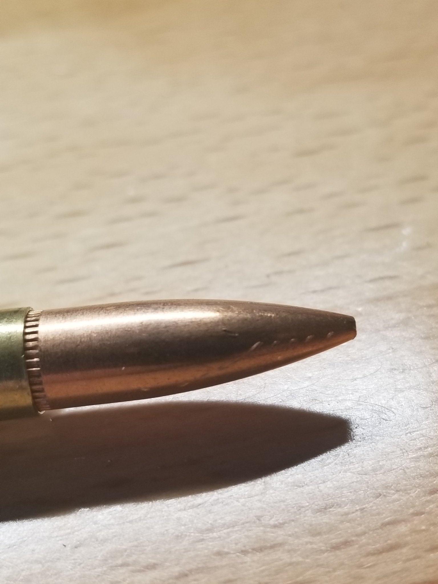

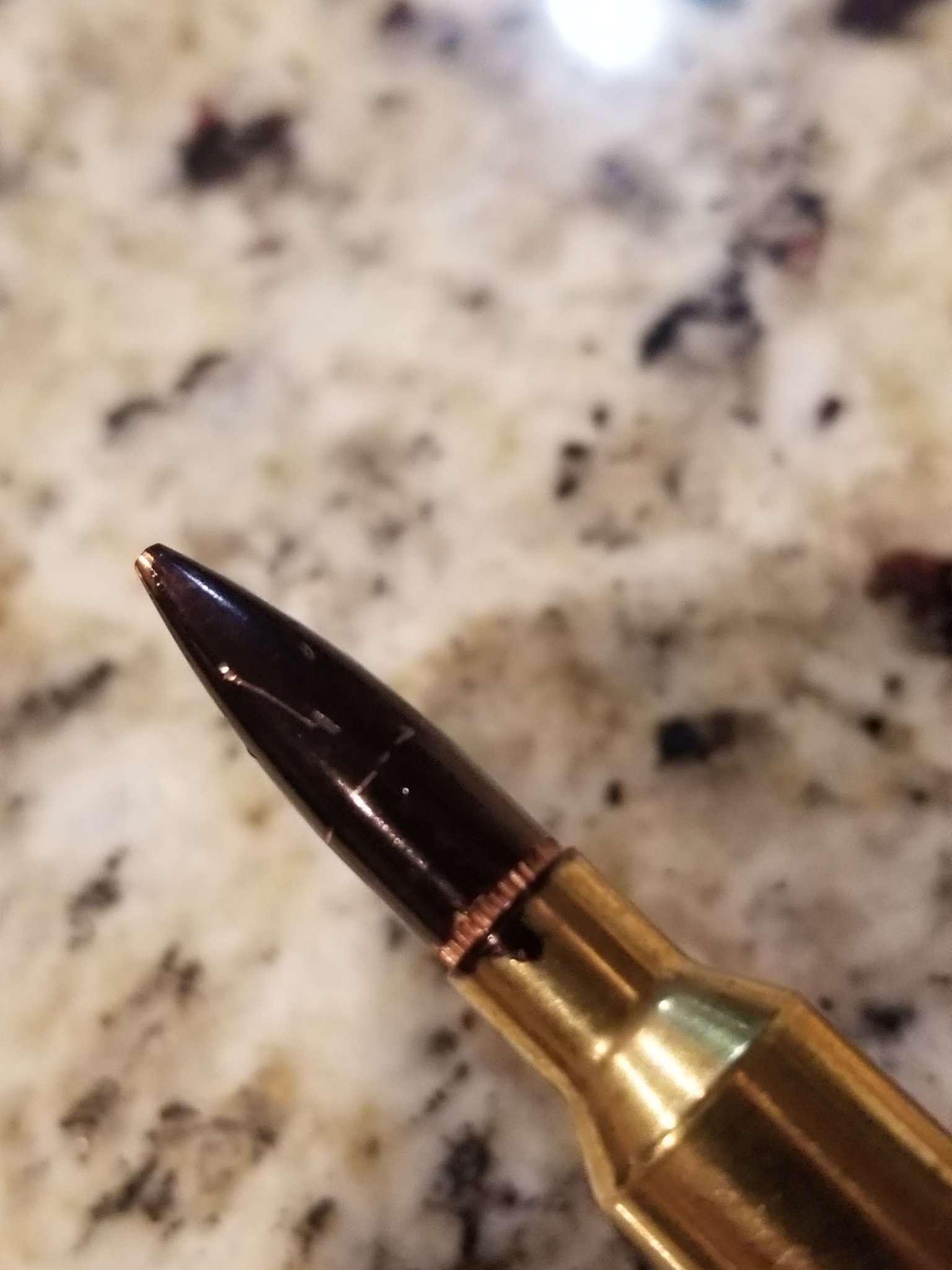

    Here is the dummy round:
    Thems some ugly bullets, thats for sure.
    Are they that nasty just from feeding them into the chamber by hand? Or are you dragging them behind your truck for a half mile down a gravel road first?
    LOL. That's all from chambering. I seated to desired length, loaded in mag, chambered using bolt release, then extracted via charging handle. All of them, even factory, were very hard to extract. I've had many ARs (all 5.56, no large frame) and have never had any with resistance on extraction.

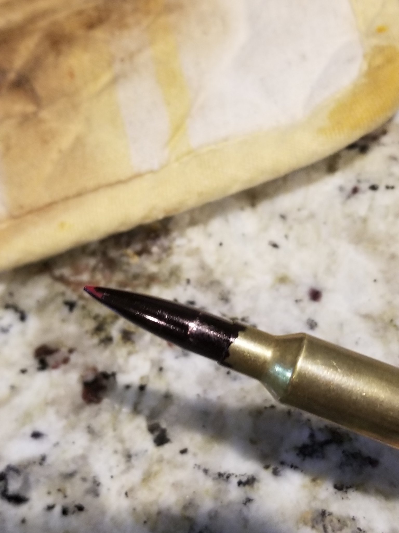

    Sharpied factory round:
    Sharpied bullet in OAL gauge jammed in:

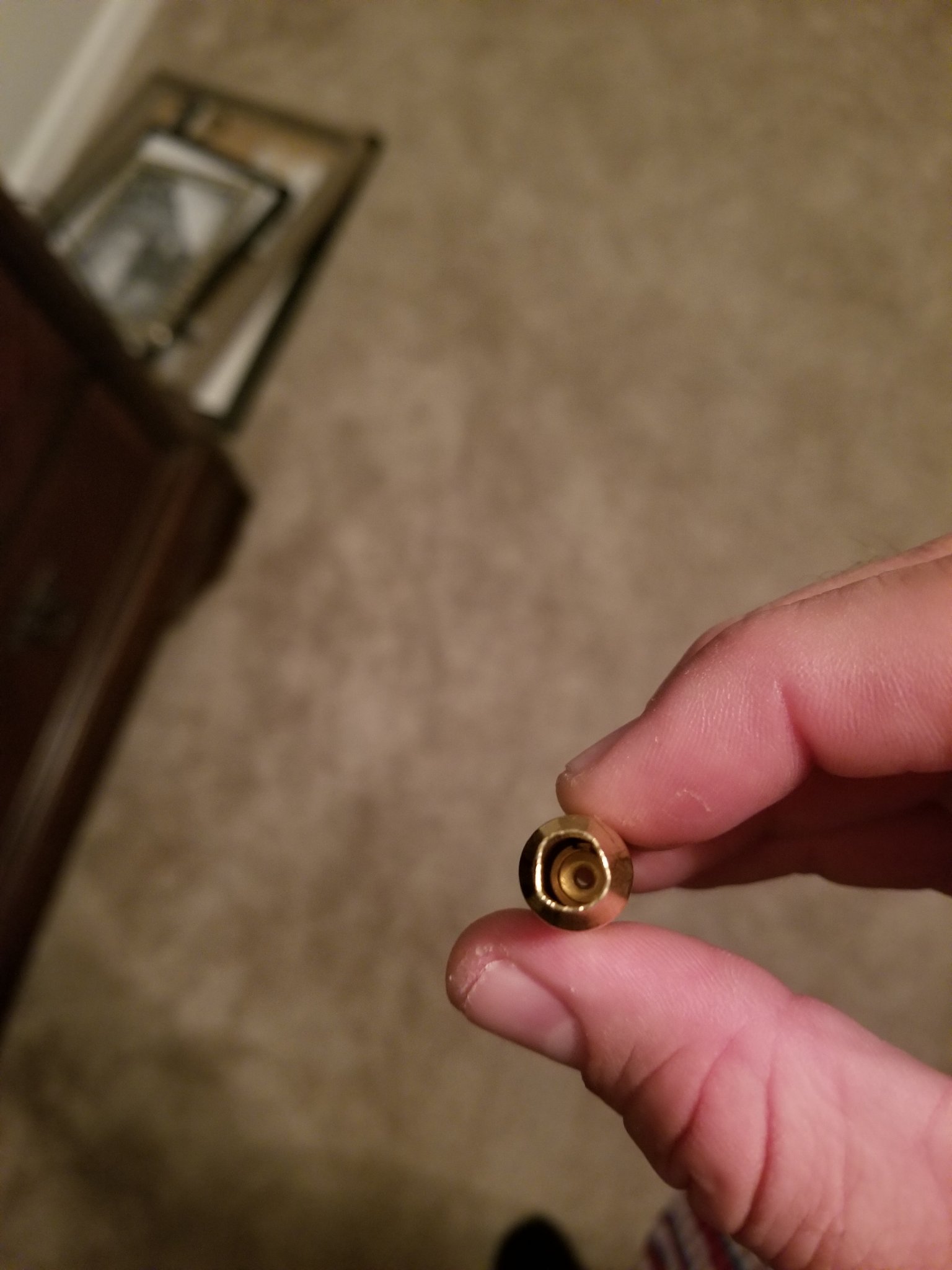

    Maybe. It's bending the case mouths on empty cases; I don't know if that's normal.

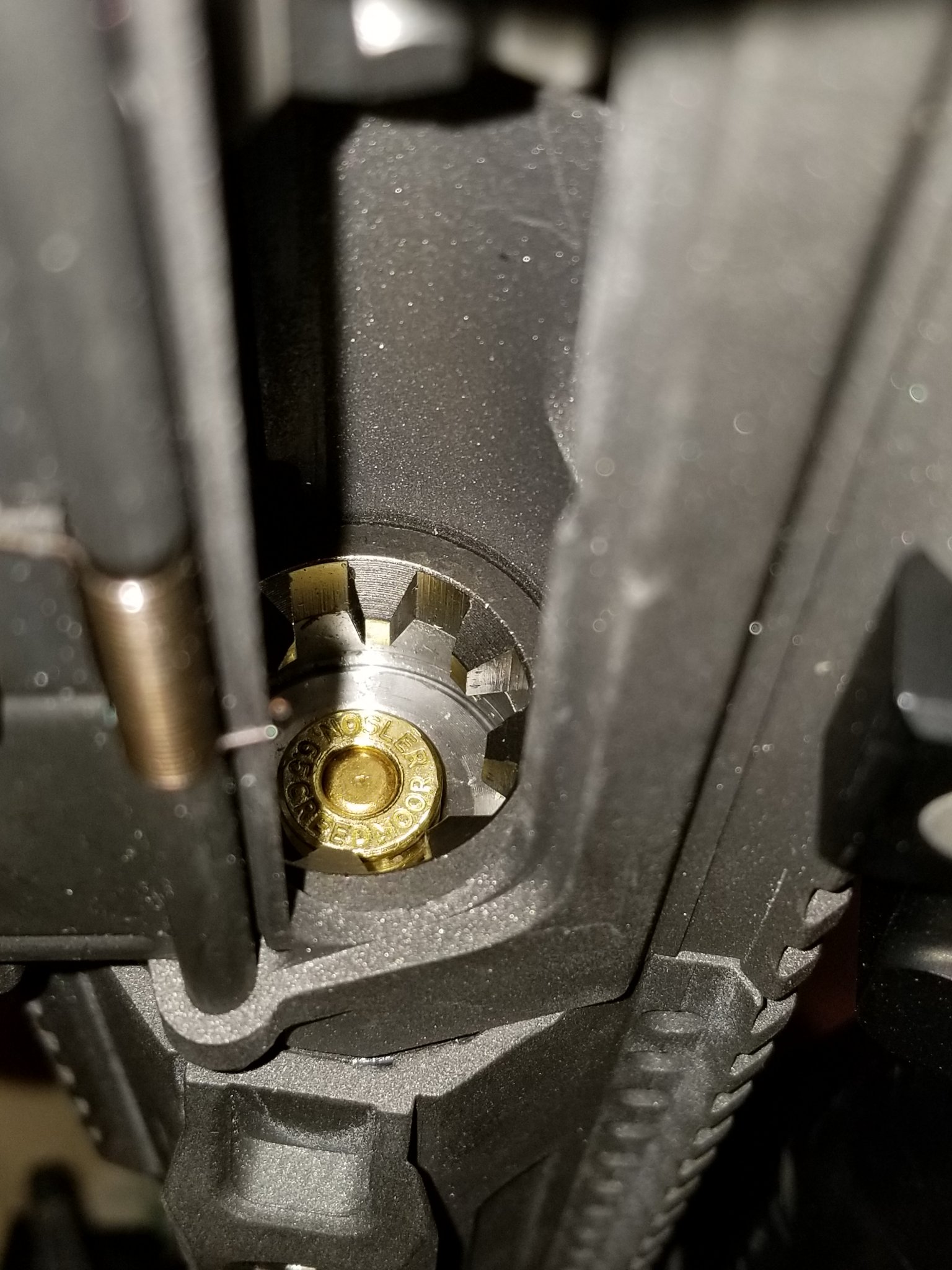

    Pull the bolt back and lock it. See if you can drop the brass in the chamber fully with the barrel facing the ground.
    I'm sure it's 6.5 Creedmoor, at least that's what the markings say.

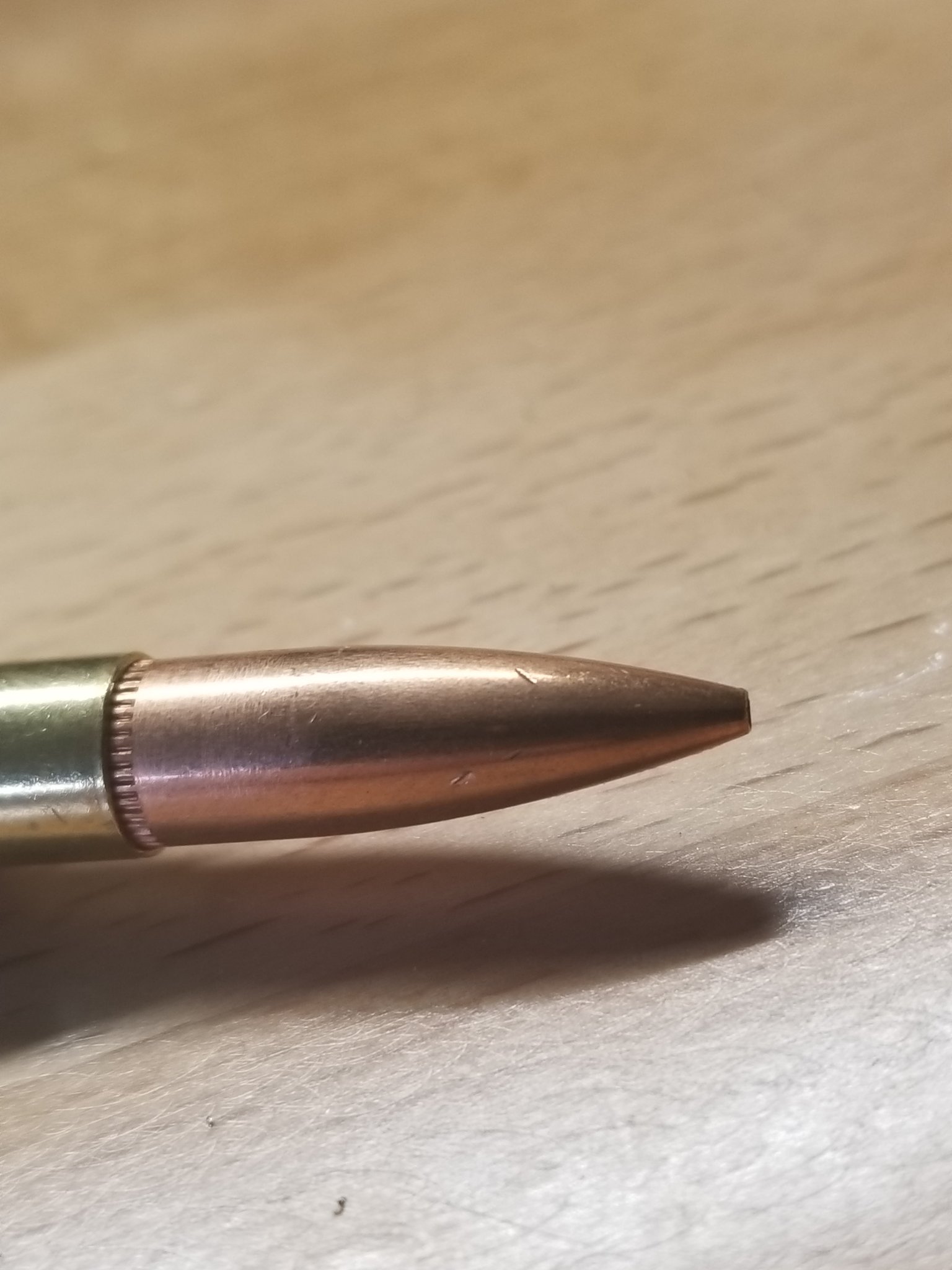

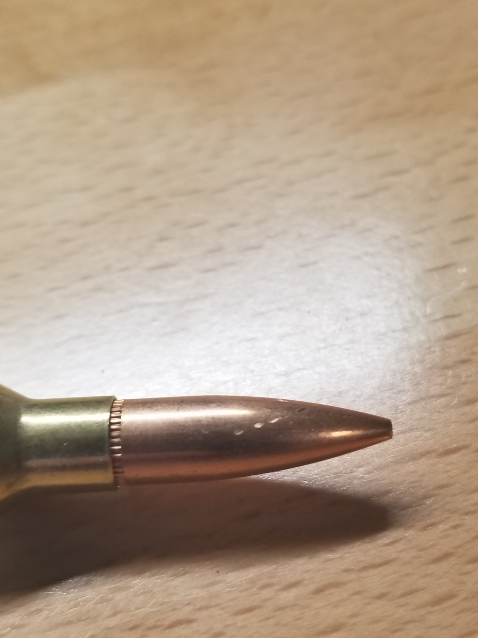

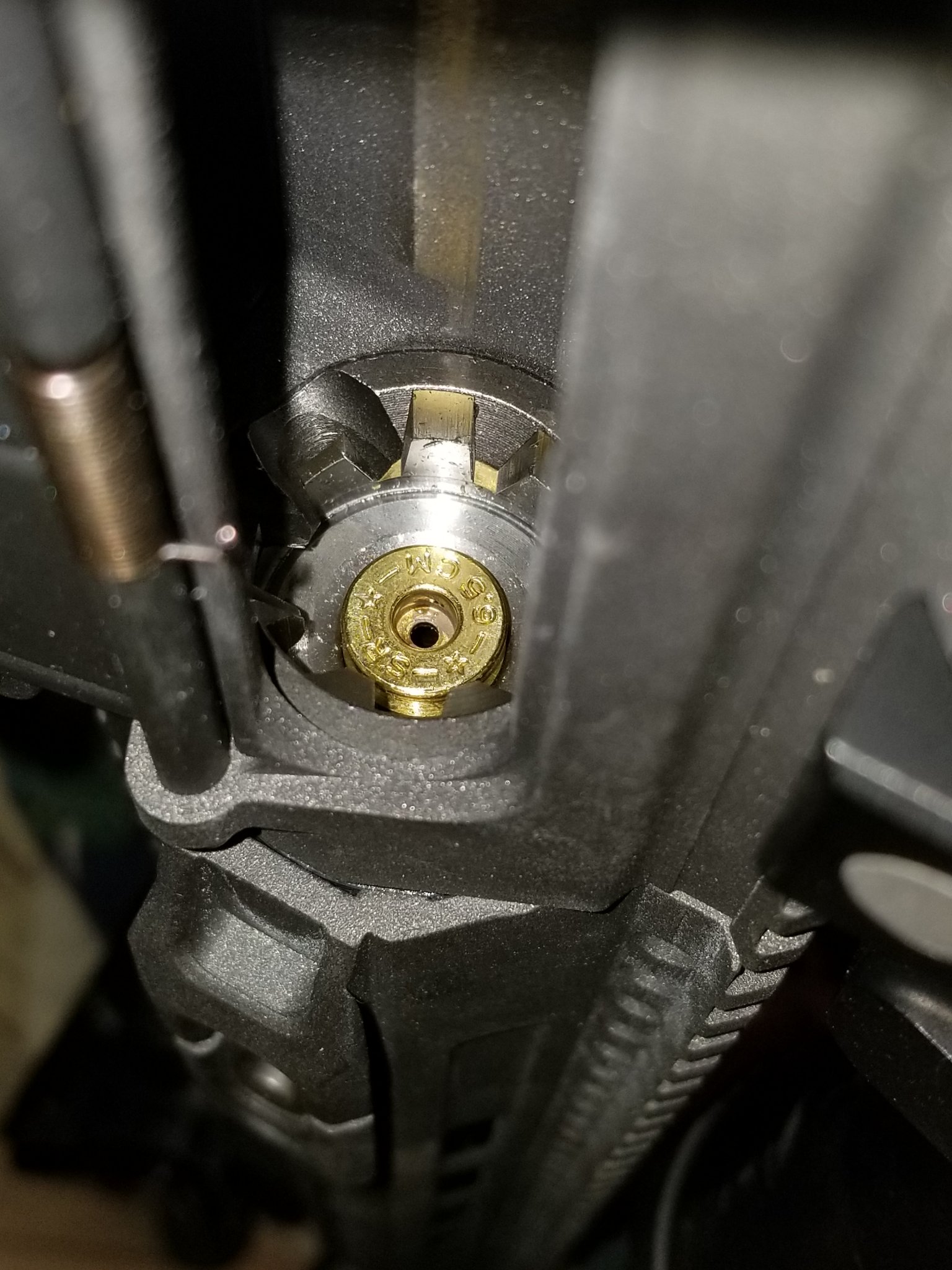

    Empty brass:
    Factory:
    Dummy round:
    Ummm... drop a piece of brass in the chamber and let the bolt go home maybe. See it the bolt closes fully.

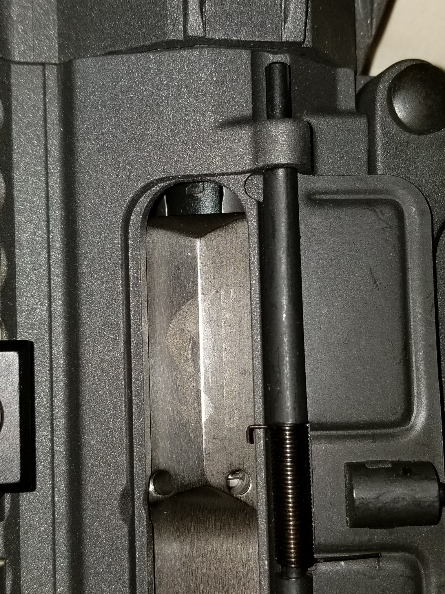

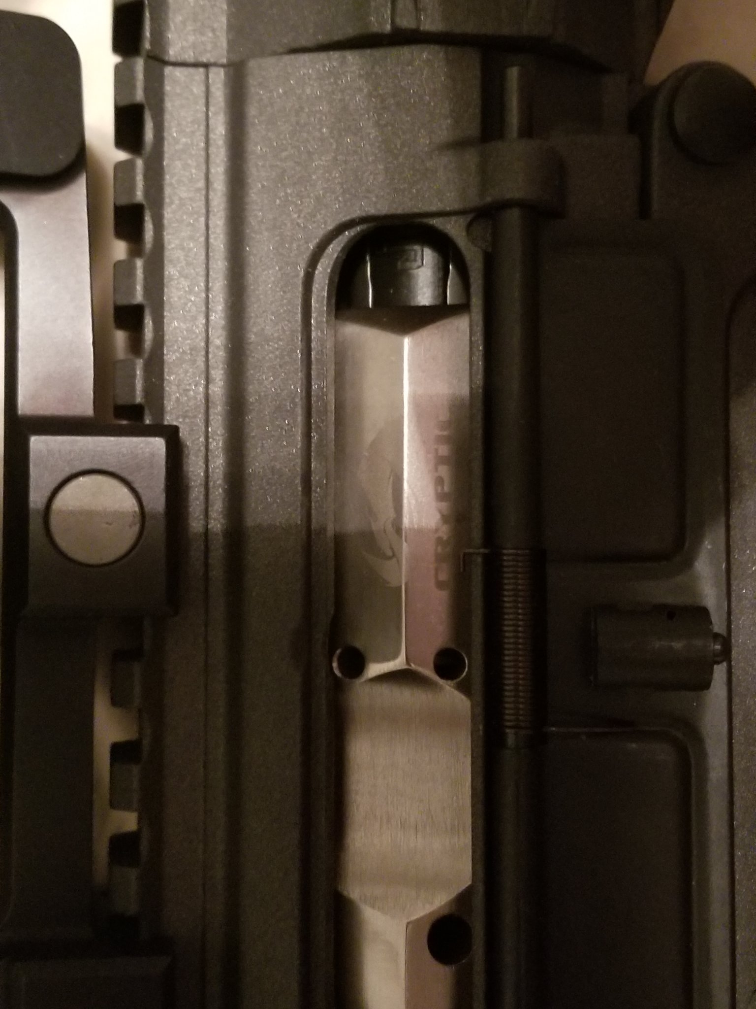

    Clean the chamber, bolt, bolt internals, extractor, receiver, etc and lube the hell out of it. It looks like metal fragments in the locking lug area too. Look for galling etc.
    Something is a miss with the barrel when it is doing that to the neck.
    Bolt won't close fully with just a piece of brass on the first try. Slam the bolt home again and it will. Ran a chamber brush in there and blew it out with some canned air. Same results. I submitted a contact us form to the barrel manufacturer with a description of the problems and pictures. Hopefully I'll hear back soon.

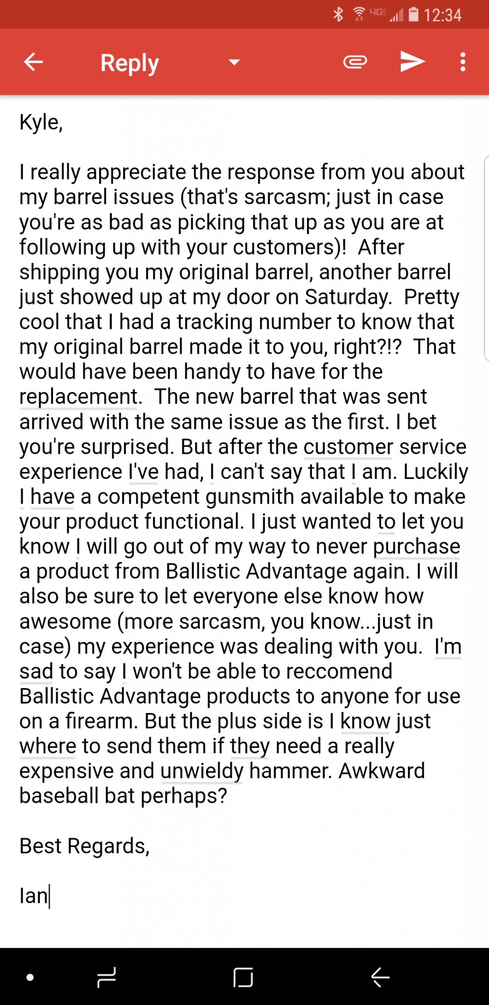

    Got a notification via my UPS account they're shipping me a barrel that will be here Monday. I have no idea if it's a new barrel or the original. Still haven't heard from them. I notified the CS guy via email the day the barrel shipped and asked to be updated on what was found when they inspected it and what the plan of action was. He replied the next day saying he would let me know. Tempted to take a loss and just use this thing as a fucking baseball bat. I understand shit happens and bad items get sent out. As long as communication is open and customer service is good I won't complain. This has just been sad on their part.
    Barrel showed up yesterday. It's a brand new in the package barrel. I doubt I'll hear from anyone about the original bad barrel. My smith said their sales guy calls him on a weekly basis trying to get him to carry their barrels. He was genuinely curious what the issue was and how they would handle it. I can promise you he won't be interested in their stuff now. Pretty big chunk of business lost for them.
