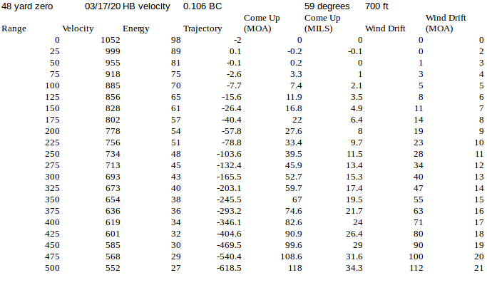

Some 22 LR Trajectory Charts

0.105 BC for CCI SV from the attachment on pg.2 still working well for everyone? Decent amount off from Strelok Pro (0.123)
CCI SV unfortunately isn't listed on my Kestrel Link Ballistics App. An AB Custom Curve would be stellar.
It works for me. That’s what I’m shooting mostly. Of course, I’m only shooting out to about 325 yards, so, somewhat limited verification.
That's way more than me at the moment. Soon to change though! Thanks!

My Kestrel LiNK App just ran an update that now has CCI SV 40gr Custom Curves!!!
I'd just created a profile for G1 .105 based on the info in this thread. Haven't had an opportunity to see how good it works though. I'll add the custom curve as well and see what wins!
Let us know how it goes.

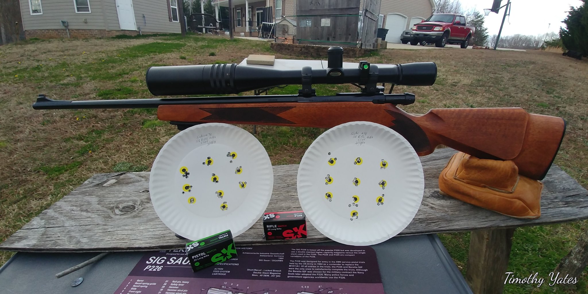

Only had a few minutes to shoot before it got dark, but CCI SV Custom Curve off my Kestrel Elite was good for 1st shot hits at 100, 200, and 300yds on (guessing) 4in or 5in plates.
Savage B22 FV in Boyd's ProVarmint with SWFA 3-15 FFP MOA zeroed at 50yds.

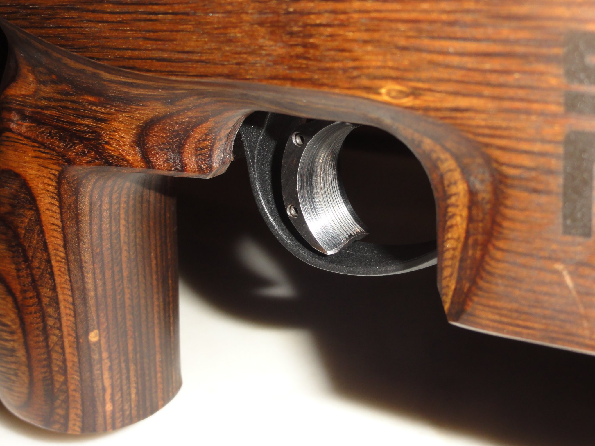

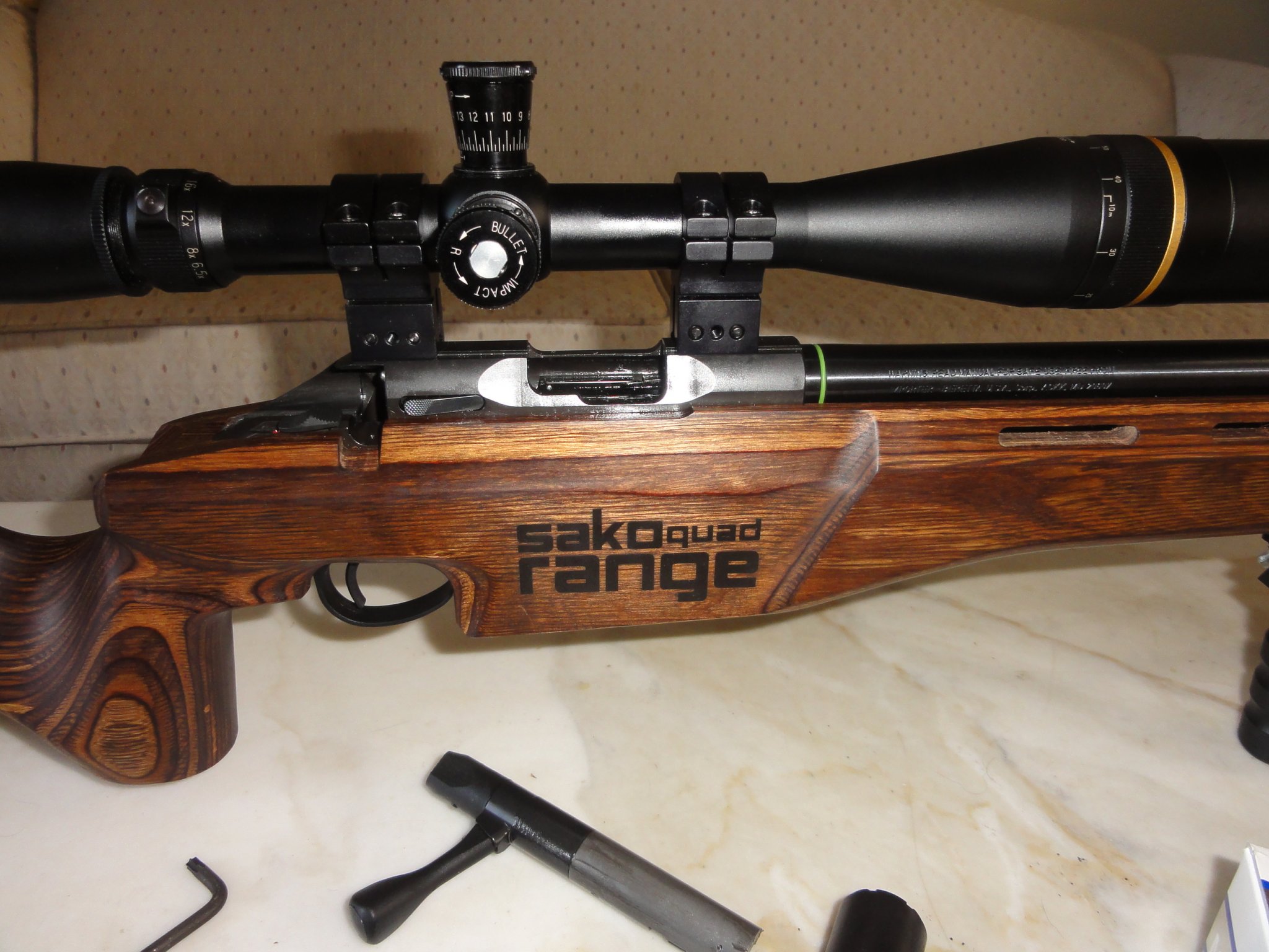

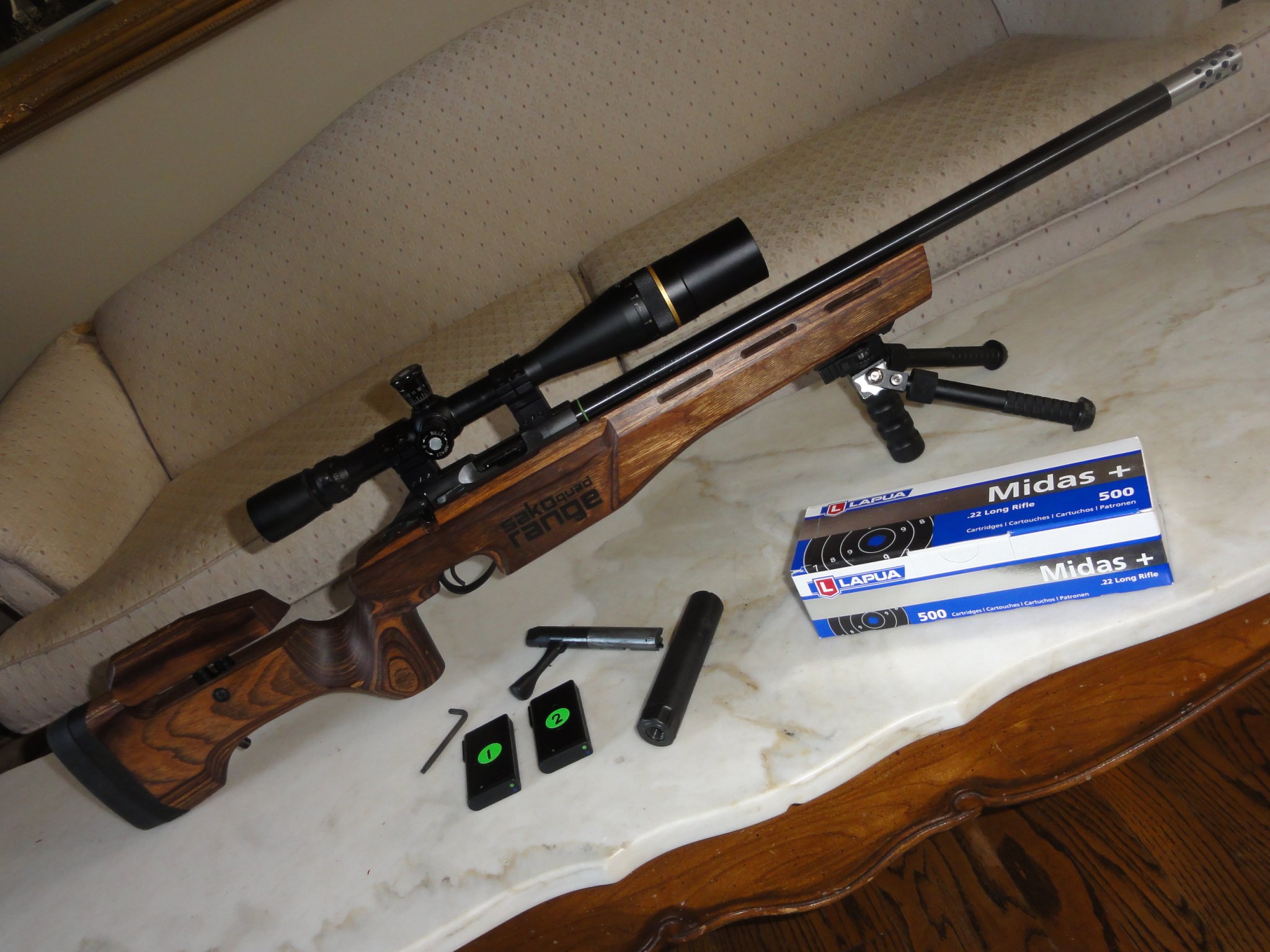

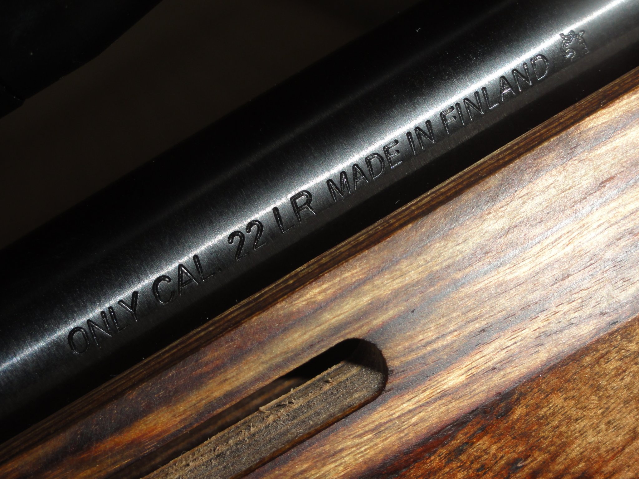

I just picked up this Sako Quad Range about ten days ago and in the photo she is still a little dirty. I took every fitting off of the stock and gave her a good going over with #0000 steel wool and many coats of wax.
She was also cleaned with toothbrushes and now she is looking factory new. Her prior caretaker did a really
nice job caring for her.
All my best
Shawn
I use 0.106 on the Hornady website calculator, that has been good in my stick out to 520 yards as long as the temperature and elevation are right. Printout is a lot cheaper than buying a Kestrel......
Reactions: lash
Sample output from the Hornady web calculator.
A couple of notes-
the drift does not copy right from the output data, so I correct that manually;
Ranges only given to 25 yards, so I add an interpolation column at each distance in Mils/yd.
Kestrel is a lot more convenient and quicker, but it comes at a price.
Reactions: TP1960
