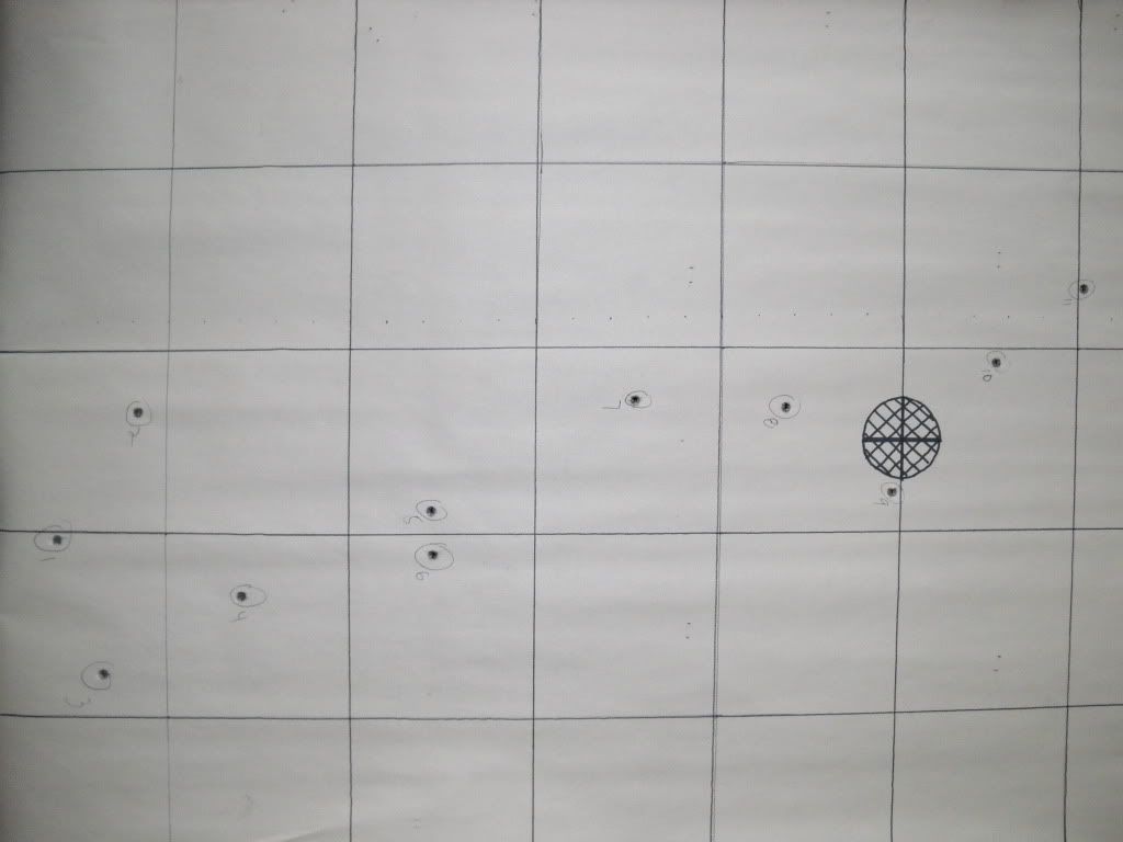

All cases full length sized, trimmed to 2.005, OAL at .010 from the lands. I shot a ladder test at 400 yards starting with 38.5gr and ending at 43.5gr. I got a node between 40.5 and 41gr of powder. I then loaded five round groups at .2gr increments for this node. I got two groups out of this that were sub moa, but the velocity is low to mid 2500 range. This doesn't seem to be enough push to get the downrange performance I am after, ie it does not out perform my 168gr load. So here is my question. I loaded to just a little past the Hornady book max for the ladder test, and did not get another node at the higher loads. The Hodgdon data shows a max charge that is significanly higher(45gr). I did not see any pressure signs. Should I try another ladder with a higher max, or maybe try different powder. Is anyone out there using this bullet with good results? Any input would be greatly appreciated.

I would add a pic of the ladder test, but I'm not sure how. Example of technology kicking my ass. The dispersion past the node seems to be very even up to 43.5gr. The last three are at POA or higher, suggesting that this is closer to the velocity that I want. I used my 168gr dope +.2mil for the test.
