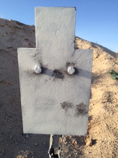

Well I'll be damned. The day I decide to test the "Low Node" loads from yesterday is the day the wind decides to blow hard. I shouldn't complain. It was an interesting test day. There was an average of 18.6mph wind, which was 1/2 value at my position. I had to adjust .7mils E to get to 300 yards and adjusted .4mils W. Of the three charges, the 3rd charge (41.5gns) printed the best group again. Its vertical was 0.912". Though it's not the greatest vertical, it will do for now. All in all, I gathered some good data. Something I overlooked to do though was chrono the load. I will do that tomorrow if time permits when I test the 3rd charge at 560 yards.
I also had 4 rounds left of the 3rd charge and took a swing at a 12" plate at 560 yards. Fuck, all I'm going to say is that I lost the first two rounds far right of the target. I had to adjust 2.2mils E, .8mils W and made two hits with the remaining two rounds low, right of the target. I was pretty humbled by the wind today. It was a cool learning experience. :)

560 Yards. Only 2 shots since I lost the first 2 far right. :D

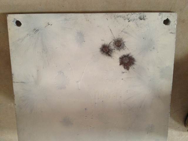

Here are some targets using 42 grains of H-4350 and 105 Hybrids.

Steel 3 shots 600yds
Steel 6 shots 656 yds
Steel 4 shots 760 yds
