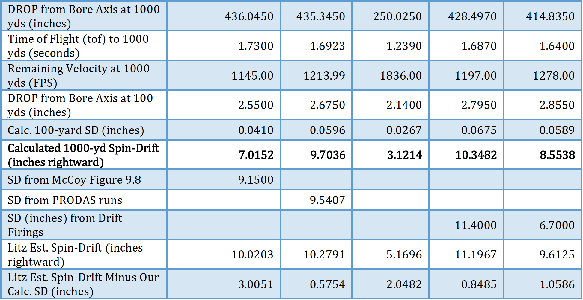

The numbers in the Jim Boatright are probably the best starting point and even those fluctuate all over the map.
if you decipher the data a bit, you can see where combined with a number of .30 Cal bullets most are around 9" of SD based on a variety of methods, the key to this is looking at the data used to calculate and realize you are not calculating anything at all because we fail to input this much data. All the variations over emphasis SD, that point is clear.
The one glaring variation is the 173gr 30 cal, and why is it SO DIFFERENT .... easy Muzzle velocity.
Look at the speed variations
At 1000 yards the 173gr bullet is still 1800fps vs the other 30 Cals that are closer to 1200fps, everything close to 1200fps is close to 9" of predicted, yet the one that 1800fps is 3" of SD
Huge variation and a huge amount of data necessary to come anywhere close to calculating this.

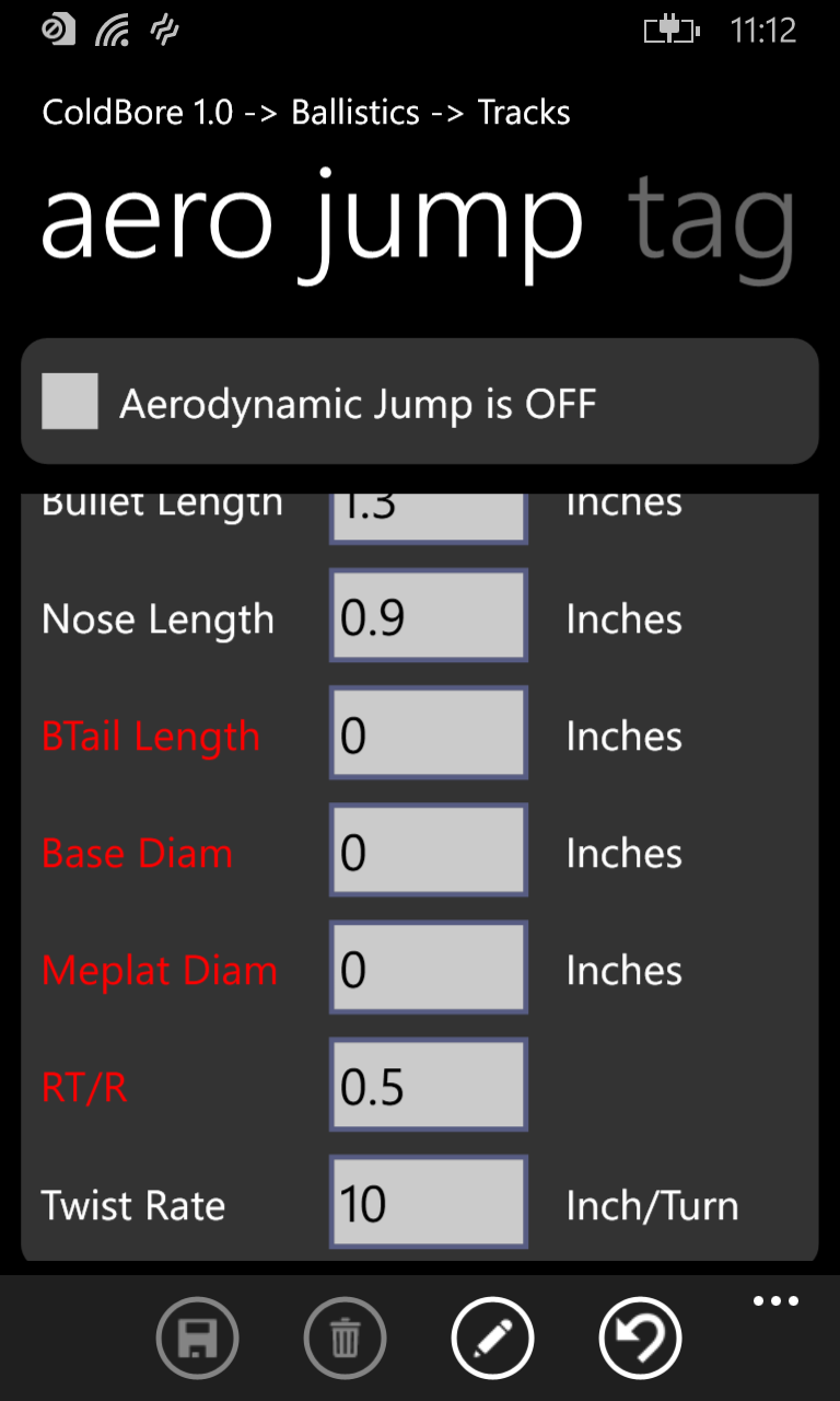

Nowhere are you are entering this much bullet data, you get one input, bullet length, that is it.
Speed is proving to be more and more a factor when you look at the numbers, and you can, in fact, go lighter to increase the speed and reduce a measurable amount of error or in this case drift
Even with Aero Jump, look at how ColdBore handles the inputs
So the Alex Jones of Ballisticians, who Gus Ruiz uses a baseline, Pesja is in ColdBore's DNA, it has you actually calculating things none of this other software does. It needs more data, hence better results.
Clearly, it matters, when you look at the papers on the subject. The error in SD using multiple methods can be as much as 3" of error between them.
I still think they are overdoing it to a certain extent because of the speed issue, we are running faster than before. The formulas were modeled first with artillery and next with slow moving 30 cals that were under 2600fps, actually, a 168 going 2550-fps, bad bullet with slow MV.
This is why the USMC ignored it because they said clearly it only mattered after Transonic and for that you have a radio.

The faction is about 1 to 1.2 percent for modern monolithic ELR bullets, and 2 to 2.4 percent for shorter, fatter jacketed, lead-core bullets. The ratio of drift to drop rapidly approaches this particular fraction as a limit beyond about 150 yards range. The trick is then to calculate the fraction accurately for any given rifle bullet and firing conditions. This observation explains the fact that higher velocity bullets have less spin-drift at long ranges--they have less drop.
Jim Boatright
So, according to your statement, lead core jacketed bullets exhibit a spin drift trajectory that is 2-2.4% of the drop.
Dividing that into five .1% increments coincides pretty well with the five BC clusters (.400 - .800 BC ) found in long range lead core bullets.
So would it be wrong to line it up like this:
.800+ BC= 2%
.700+ BC= 2.1%
.600+ BC= 2.2%
.500+ BC= 2.3%
.400+ BC= 2.4%
Okay so if it's a fraction of 2% based on the drop, let's look at this,
130gr Prime Ammo at 2800fps
8.0 Mils or 27 MOA to reach 1000 yard target
We'll figure 2.2% for a .585 BC
So I get
.176 Mils
.59 MOA
6.0 Inches
Yet my AB Calculator gives me .21 Mils or 7.2 Inches of drift, which is close but still more by a fair percent because the numbers are small. It appears if you round it up, you have an issue, you round it down, it's more so inline. 5" of drift vs 7.2", still not really a miss on target when you consider the wind.
My biggest issue is the solids are 1/2 of jacketed bullets giving weight to the idea that it's a combination of factors like jacket thickness along with the lead underneath. I have been told that this along with the twist rate can affect the bullet shape under the jacket. Are we getting shotty data because there is a potential to deform the core so a segment of the data is actually corrupt, leading to larger numbers?
If the jacket is such a wildcard, why has it not been addressed? A different core, thicker jacket, etc would knock these numbers down.
Because look what a solid does,
A Warner Tool Flatline based on my data means,
1000 yards is 6 MILs of adjustment with a 122gr 6.5
1.2% of 6 Mils to reach 1000 yard target is .072, or .25 MOA
It's more in line with my real-world results across the board. If Bullet has a thicker jacket and the twist rate is not disturbing the lead core the same way, you can easily have a lower number than 2% it can be 1.75% and have a measurable difference.
Funny solids are less than 3" (See Ode to Frank) and jackets are 6 to 7.2" under similar conditions, tells me it's inside the bullet not outside. The rifling is not going to really engrave the solid less, it's still copper, what moves is the lead core, which changes the flight characteristics and balances of which could add wobble. If you actually run the 2% vs 1.2% numbers it's huge.
2 Mils difference in bullet drop got you 1/2 the SD, seems pretty big. Why would you shoot a jacketed bullet or better, why would you continue to design a jacketed bullet if the results were so stark? Don't get me wrong I have been a solid fan for years and I have a long history with solids. These numbers alone would make jackets obsolete. At least it would change jacket technology or even better core tech, a stronger core would act like a solid because lead is so soft, a true target bullet could easily replace lead with something else.

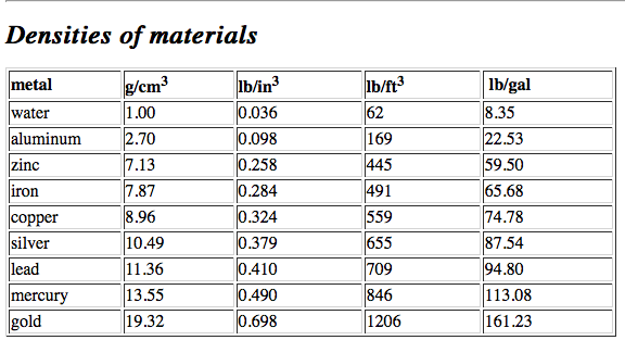

I looked up densities of lead vs copper,
They have a lead replacement designed just for this,
Why Use Technon® in Lead Replacement Compounds?
Technon® offers many advantages to compounders:
Technon® has a spheroidal grain structure. This makes for a faster and better mix
Technon® can save energy during the mixing process
Technon® has a Tap-density of 11.75 g/cc, which is higher than any density filler material currently available
Compounds containing Technon® are easier to inject, and better protect the injection machinery
Technon® has a large particle size, opening the door to many new applications, uses, and formulations, which are otherwise protected by patents.
What Are Some Lead Replacement Applications of These New Materials?
Ammunition: Projectiles and shots,
I am willing to bet if 2% can swing in small percentages up, it can also swing down with modern bullets and repeating the same value for something that is changing constantly like bullet design and manufacturing, it's not as big as advertised.
