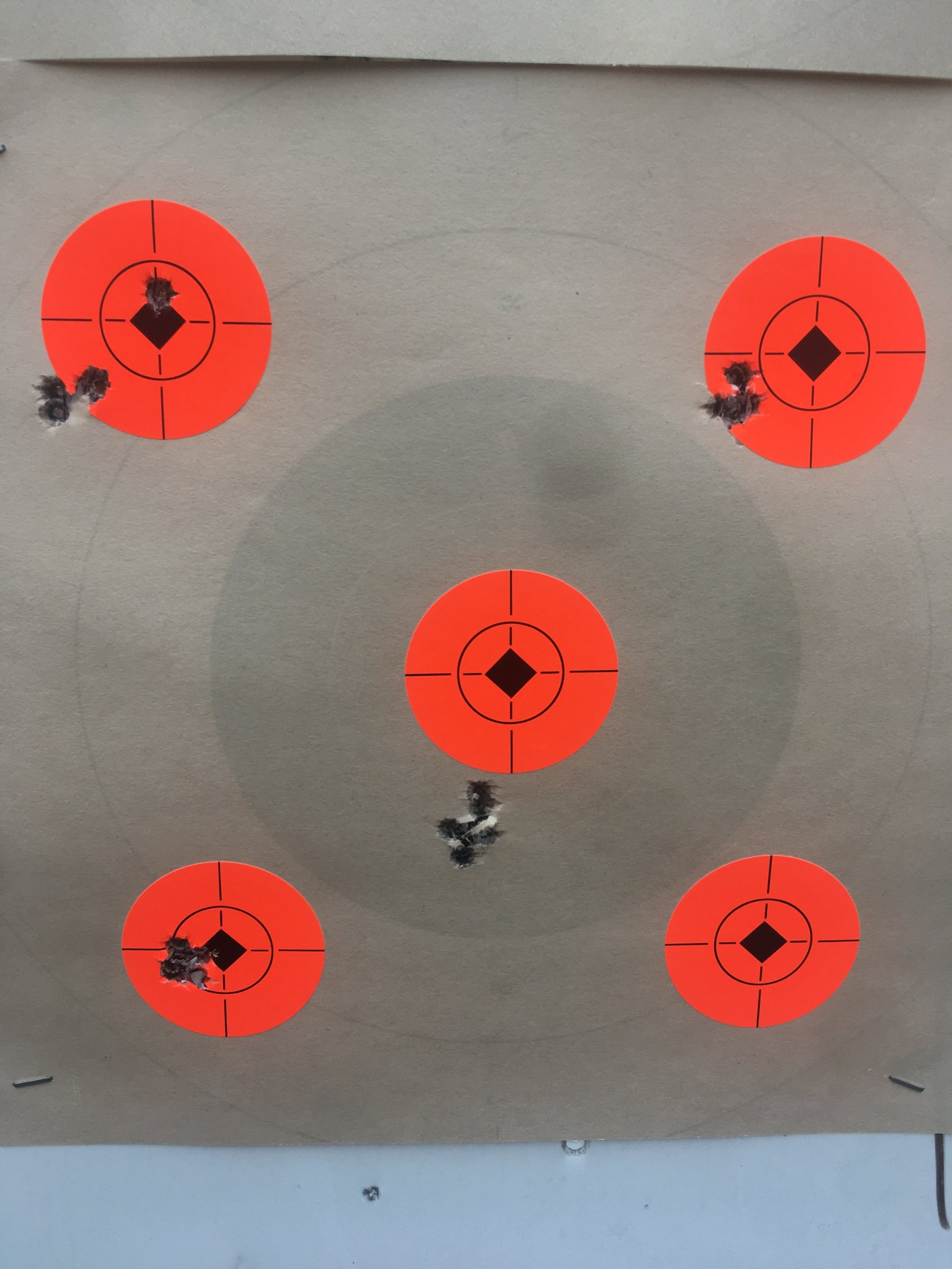

I do zeroing from barricade because I suck at shooting prone. These were 5 round groups off barricade when I put new optic on. Craddock Bartliens are hammers.

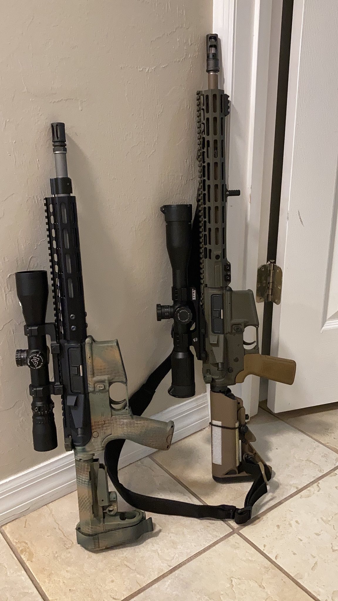

Good day gents.
Just a quick recap on my DMR evolution.
I sold the rifle in the original post to my brother in law and bought a 16" CLE Bartlein. It sits on a Vltor MUR upper and has a SLR HG.
I've now been running this rig in DMR style comps since Dec of 2020.
I'm hooked.
My CLE barreled rifle will shoot .75MOA groups with black hills 77gr and about 1MOA with IMI 77gr.
I've hit targets in comps out to 800yds even though it's only a 16" 5.56 (223 wilde) barrel, and it's a monster within 500yds.
I'm extremely pleased with this setup.
I've also had an urge to create a short handy hunting/long range upper so I snagged a 12.5 Noveske 6.5 Grendel barrel, Noveske HG, and put it on another MUR upper.
This is a picture of them side by side.
I hope the Noveske upper performs well like the CLE.
Dare I say, if it does, it may even make the CLE obsolescent.

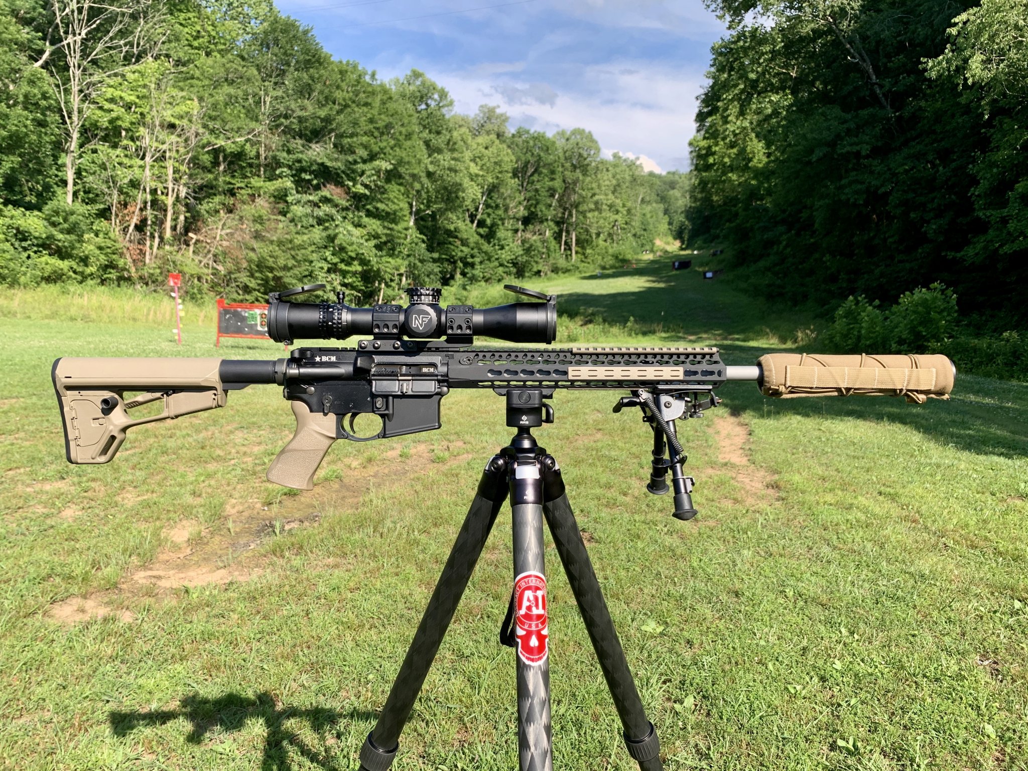

To reinforce what @Trigger Monkey spoke of above, here is an example:
16" BCM/CLE/Douglas upper with a 13" KMR handguard. NF 4-16x42 F1 in a Spuhr. Geissele SSA-E. Magpul ACS-L stock.
The barrel is a Douglas spun up by CLE, with their chamber, which is a 16" recon mid-length 1:7" configuration. Only notable difference is 5/8-24 muzzle threads.
It is a snug chamber. Factory new Hornady brass barely fits the chamber. New Lapua or Federal are fine. There was a 0.002" headspace difference with the Hornady being longer than the Lapua/Federal. It flat out shoots. I think the average of every group shot over the first 200 rounds is in the 0.6-0.75" range. Velocity isn't a concern as a 75/77 grain bullet is coming out at 2625-2650 fps. Plenty for 600 yards.
Bipod stud up front. Rail section in the rear to clip into the tripod. I prefer the Harris over the Atlas on the SPR style rifle.
Magpul ACS-L gives a solid area for cheek weld, locks up snug, and provides the club foot for a rear bag.
Weight is favorable coming in at 9.5 pounds without the can and ammo. Say 11 pounds with the muffler and 20 rounds.
On the optic: skip the 1-8. I had the NX8 on a different 16" upper, and it isn't conducive to precision. I originally went to the NF 2.5-10x42 on this rifle. It works, but the NF 4-16x42 is tits. I'm usually in the 12-14x range.View attachment 7420614
