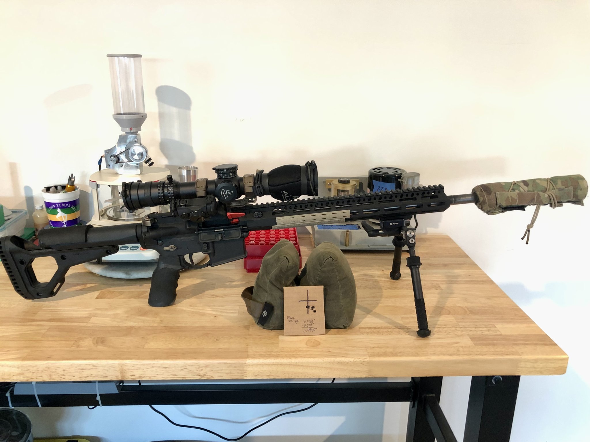

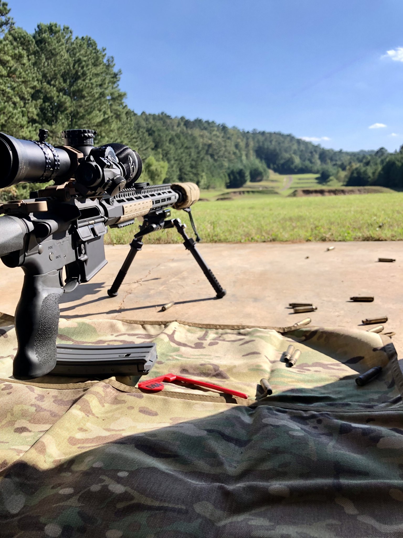

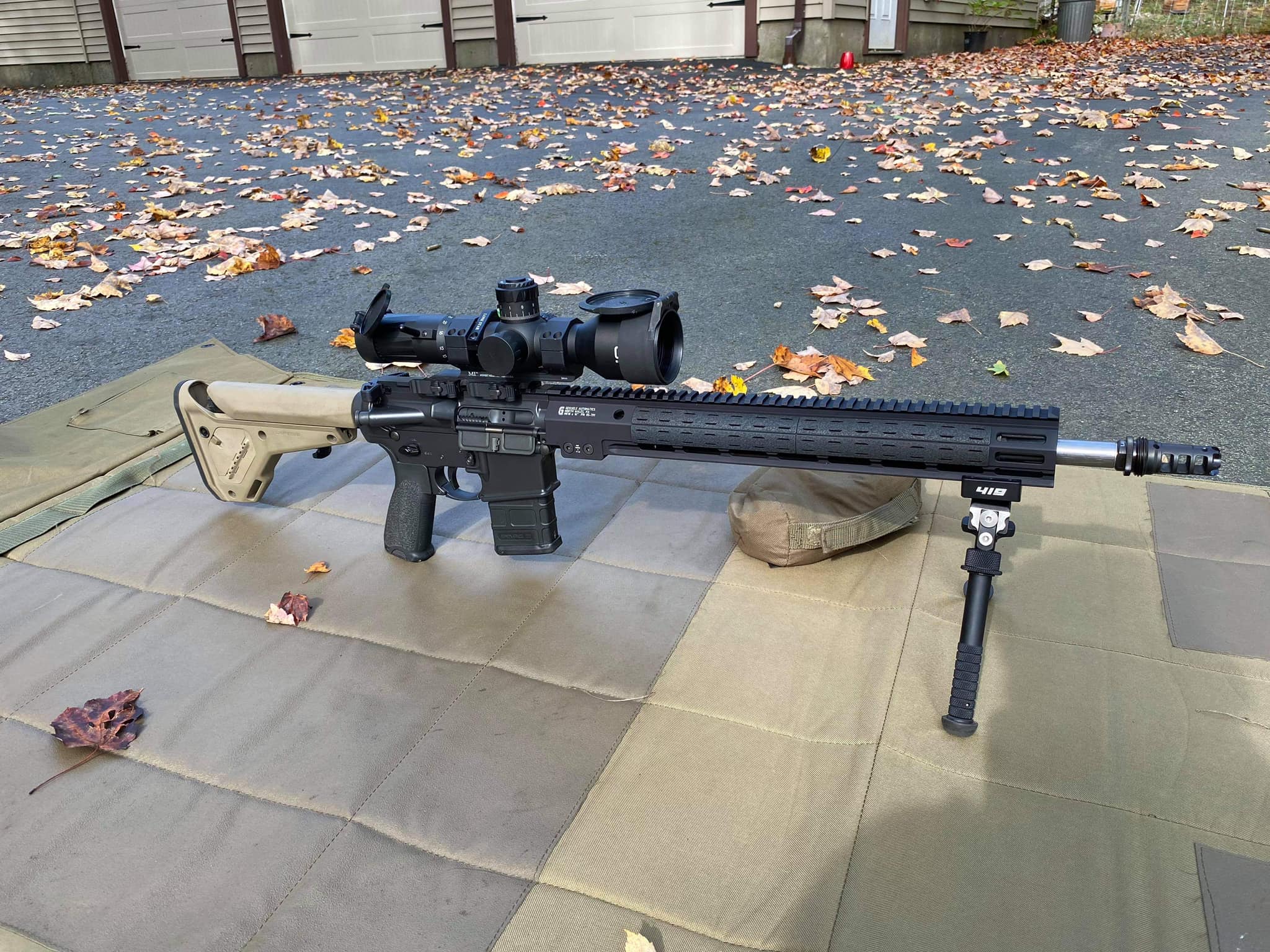

Finally got my SPR/DMR all put together for matches:
Upper Reciever
  • BCM M4 Upper Receiver
  • BCM BCG MPI Auto
  • BCM MCMR 15”
  • 18” 1:7 Douglas SPR Contour CLE Match Chamber
  • Superlative Arms 0.75” AGB Bleed-Off Solid
  • Rifle Length Melonited Gas Tube
  • Area 419 1/2-28 Hellfire Adapter
  • TBAC DOMINUS-CB

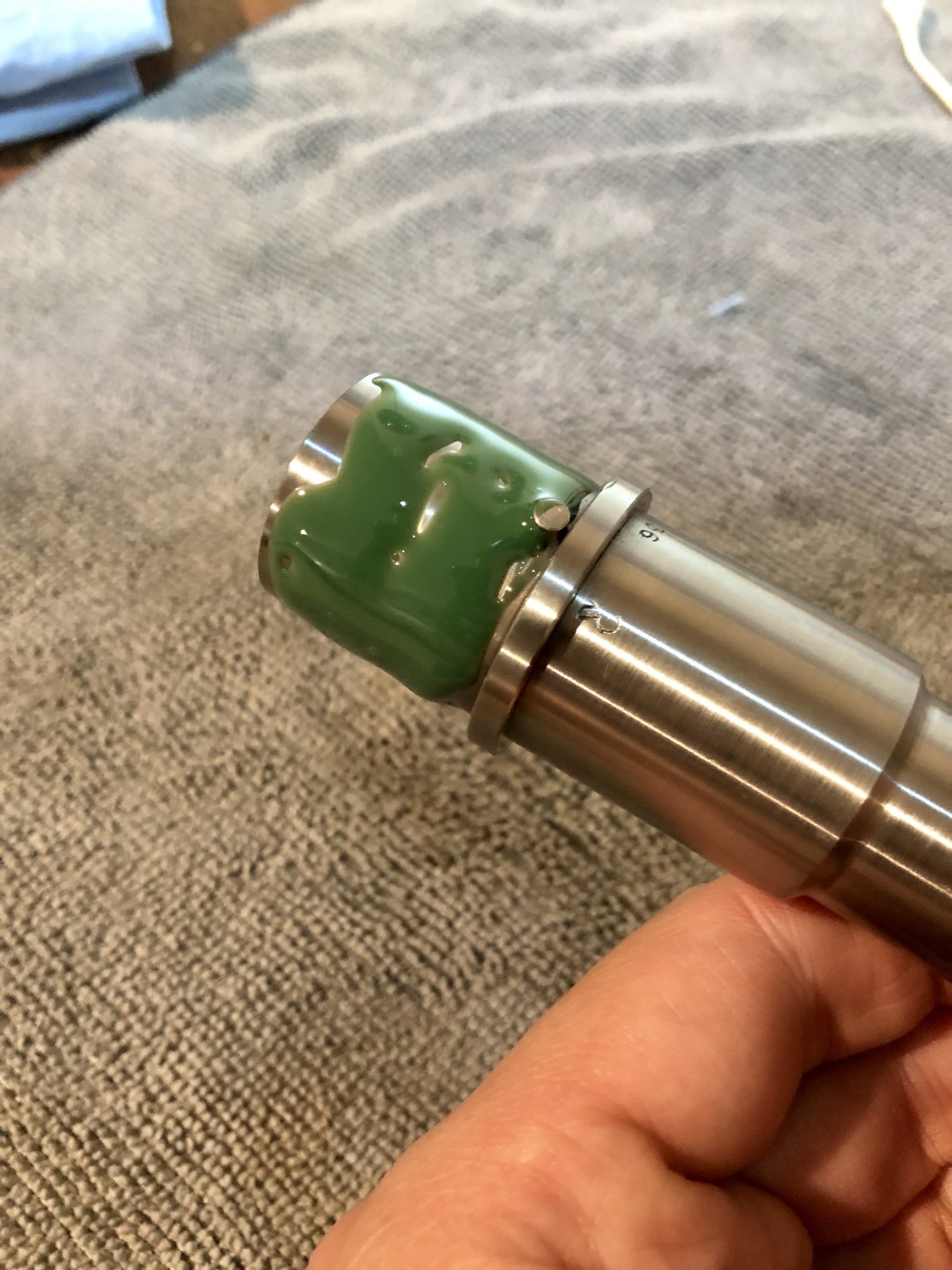

  • Upper Receiver face lapped and barrel bedded with Loctite 620
Lower Receiver
  • SBR’ed Lower
  • Magpul UBR Gen 2
  • Carbine Spring
  • H2 buffer
  • Larue MBT
  • Surefeed Mags
Optics
  • Badger Ordnance COMM 34mm 20moa Tan
  • Badger Ordnance COMM J Arm Tan
  • Badger Ordnance COMM Micro Sight Mount Plate
  • Aimpoint H2
  • Nightforce ATACR 4-16x42 MIL-C
Finally got my SPR/DMR build all put together for matches:
View attachment 7699225Upper Reciever
  • BCM BCG MPI Auto
  • BCM MCMR 15”
  • TBAC DOMINUS-CB
Lower Receiver
  • SBR’ed Lower
  • Magpul UBR Gen 2
  • Carbine Spring
  • H2 buffer
  • Larue MBT
  • Surefeed Mags
Optics
  • Aimpoint H2
I really like that you face lapped and bedded the barrel to the receiver. In terms of accuracy, how the barrel mates to the receive has always been the only weak point of the AR. Curious what kind of groups you'll manage with that barrel/mate combo.
Only thing I would add to your already insanely nice build is a bubble level or anti-cant device, it starts to make a difference past probably 400 yards. I recently switched to the Accuracy First one. Can't recommend it enough.

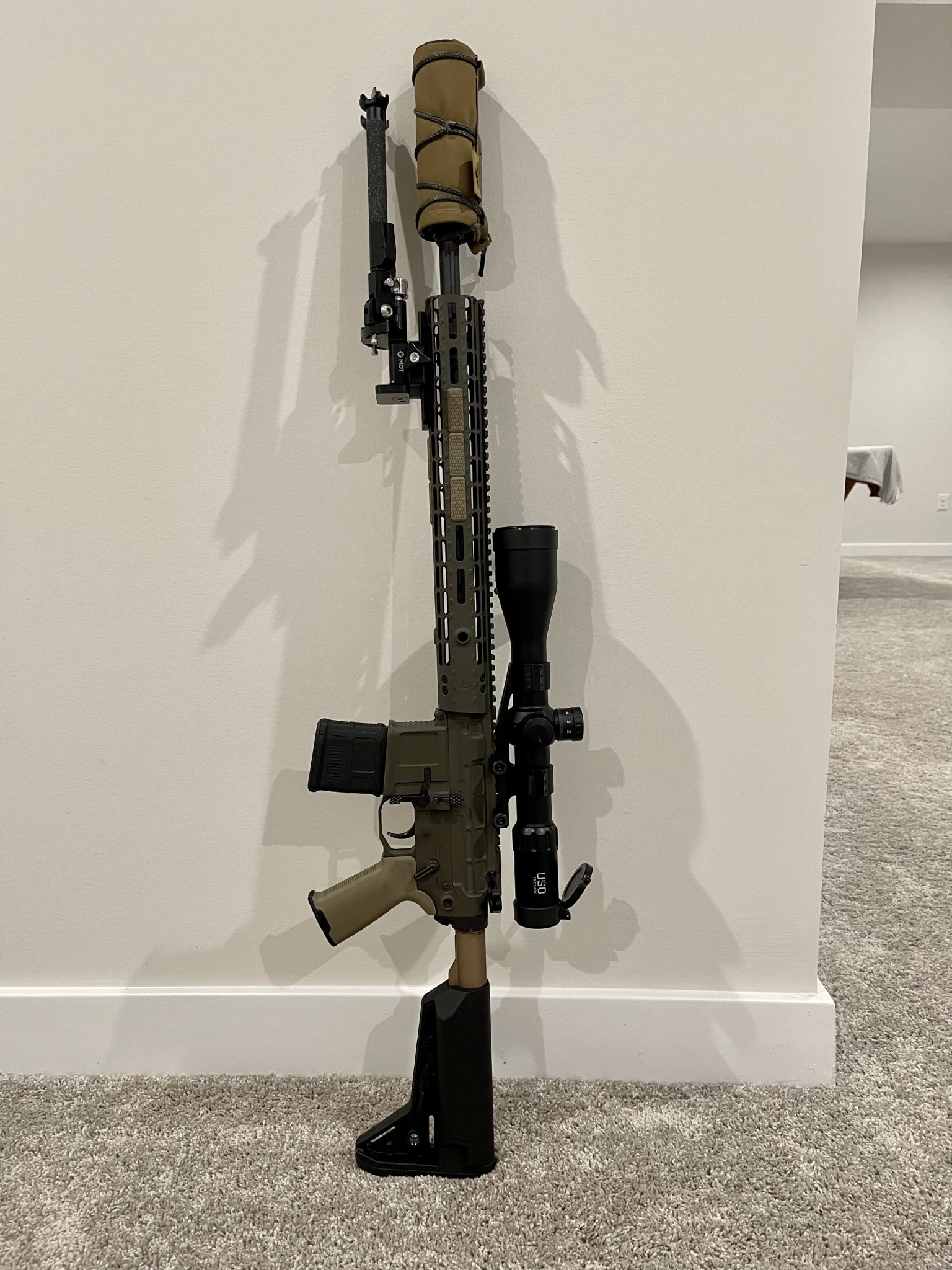

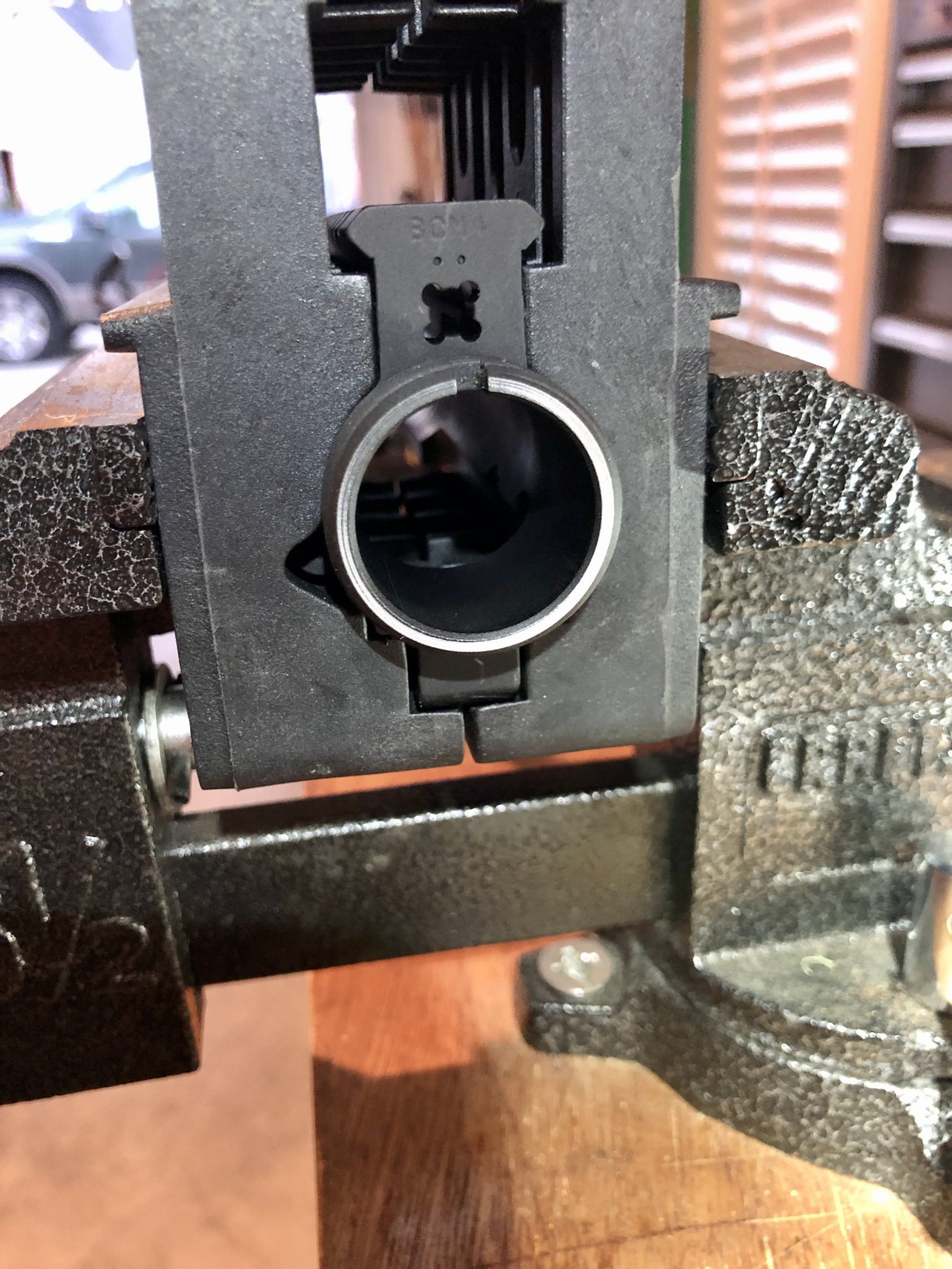

Thanks, I was pretty surprised how uneven the receiver face was from anodizing. I chose Loctite 620 because it’s a high strength, high temp resistant retaining compound. Specifically designed for bonding cylindrical parts.
Thanks for the feedback about the bubble level. I used one for a bit, but it wasn’t for me.
Plan on shooting it this Saturday and I’ll report back. The local gun range DMR/SPR matches start next month so hopefully it’ll shoot well enough to be competitive in that match.
Reactions: Phatcow
I'm doing a gasser precision match on my farm this fall and really looking forward to shooting small targets with these gassers. Bunch of my buddies have been building SPRs, 6ARCs, 6.5Gs, etc. so it will be fun to see what they have come up with....
I like that pad you put on the Magpul UBR (I'm a huge fan of that butt stock)... does it get in way of the charging handle at all? Looks like its clear of the pull range. I might have to add one of those to mine.
thanks
Thanks, got some 1/8” thick foam padding from Michaels and secured it with E6000 glue. It does not get in the way of the CH.

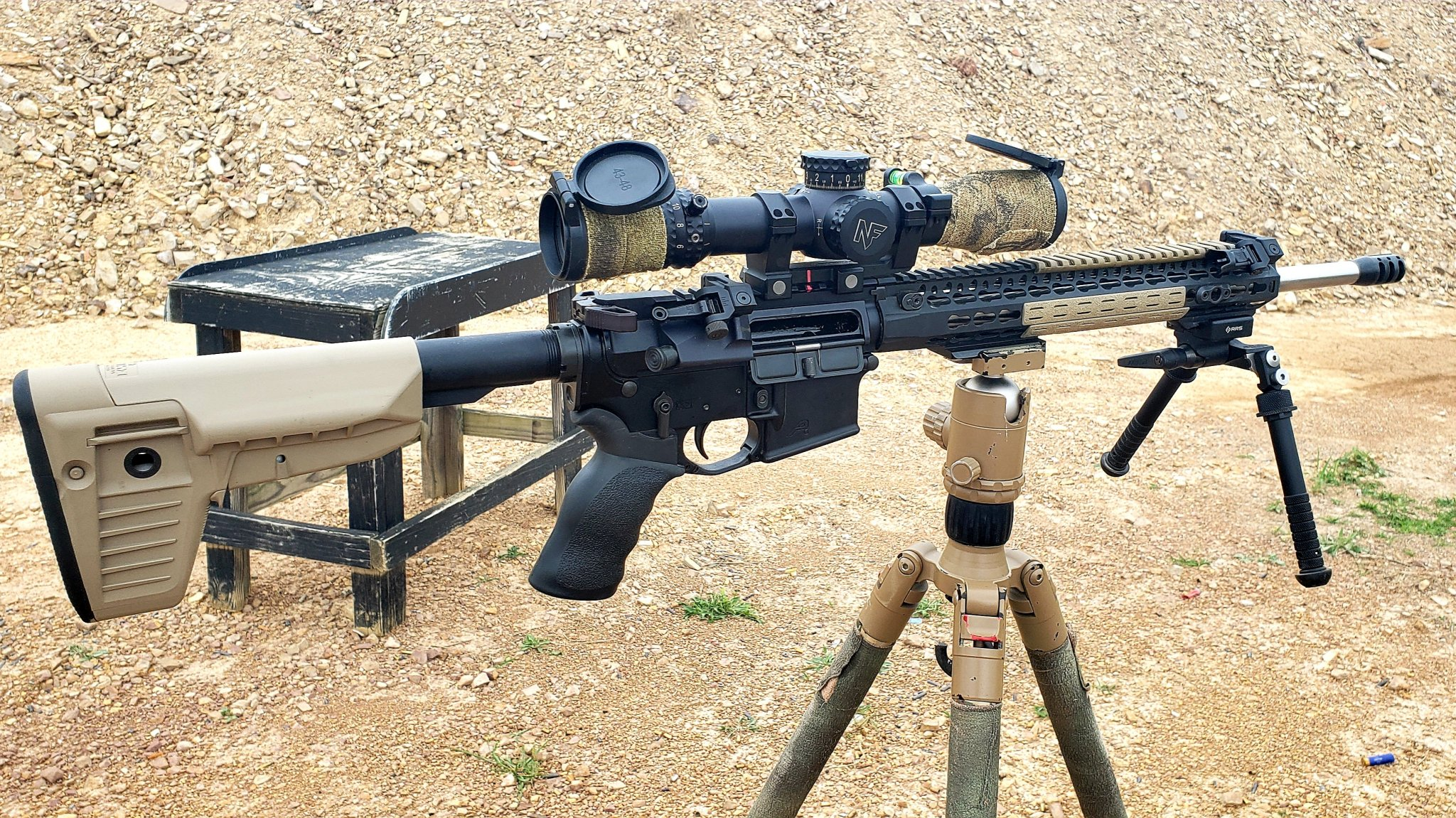

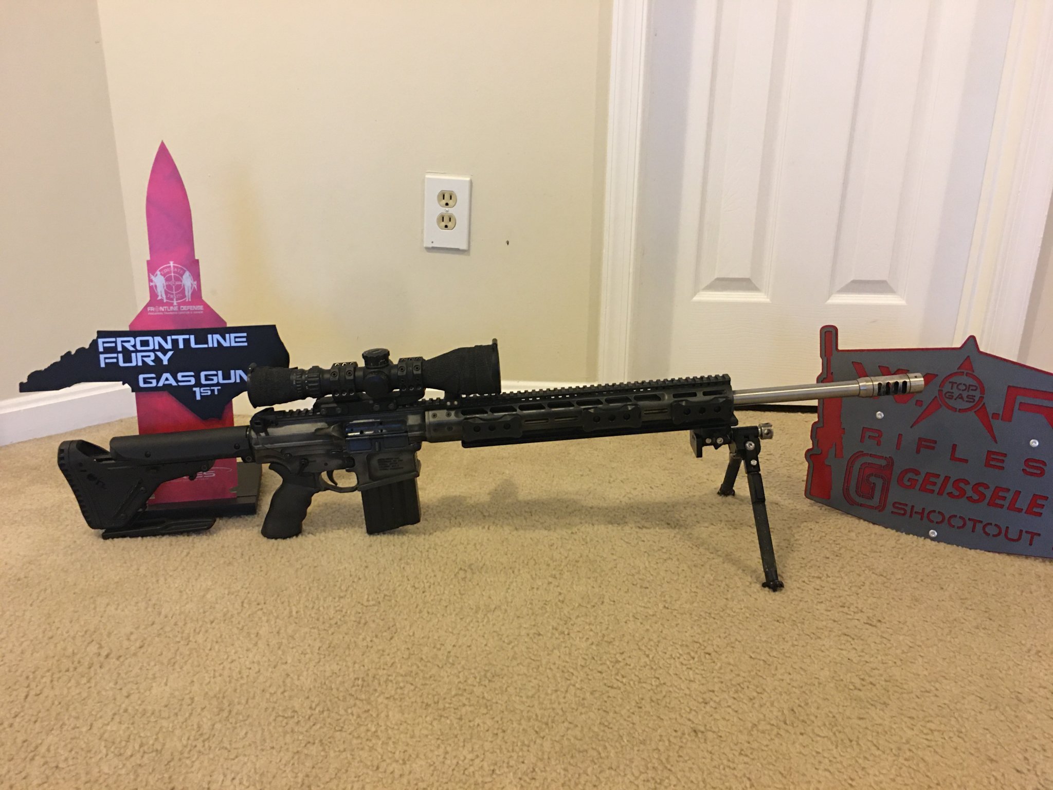

This is my SPR/DMR blaster...
Upper:
Vltor MUR-1a
Radian Ambi CH
BCM BCG
BCM KMR-13 Alpha
BCM Keymod Sling Mounts
WOA 18" SPR barrel 1:7 twist
Aero Precision Lo-Pro GB, generic gas tube
PRI QCB
BCM Aluminum Pic Rail
Keymod ARCA mount in the back
Lower:
Aero Gen II Forged Lower
SOLGW LPK
Magpul MOE Trigger Guard
BCM Ambi Safety
Ergo Delux grip
Geissele SSA-E Trigger
BCM A5 Receiver Extension
Vltor A5-H2 buffer (I think) and standard rifle length spring
BCM SOPMOD-MOD 1 stock
Optic/Sighting:
NF ATACR 4-16X42 F1 w/ MIL-R
NF UL 20 MOA Mount - 1.44" height
Midwest Industries offset sights
I built this just before my club stopped shooting regular DMR matches but I did use it in a 2-gun team match last year and I've had some other range trips with it since then. It's a pretty fair dinkum shooter, an absolute hammer with factory match and not too shabby with 55 gr ball up to about 400 yards if the targets are generous (e.g. MGM Flasher Target).

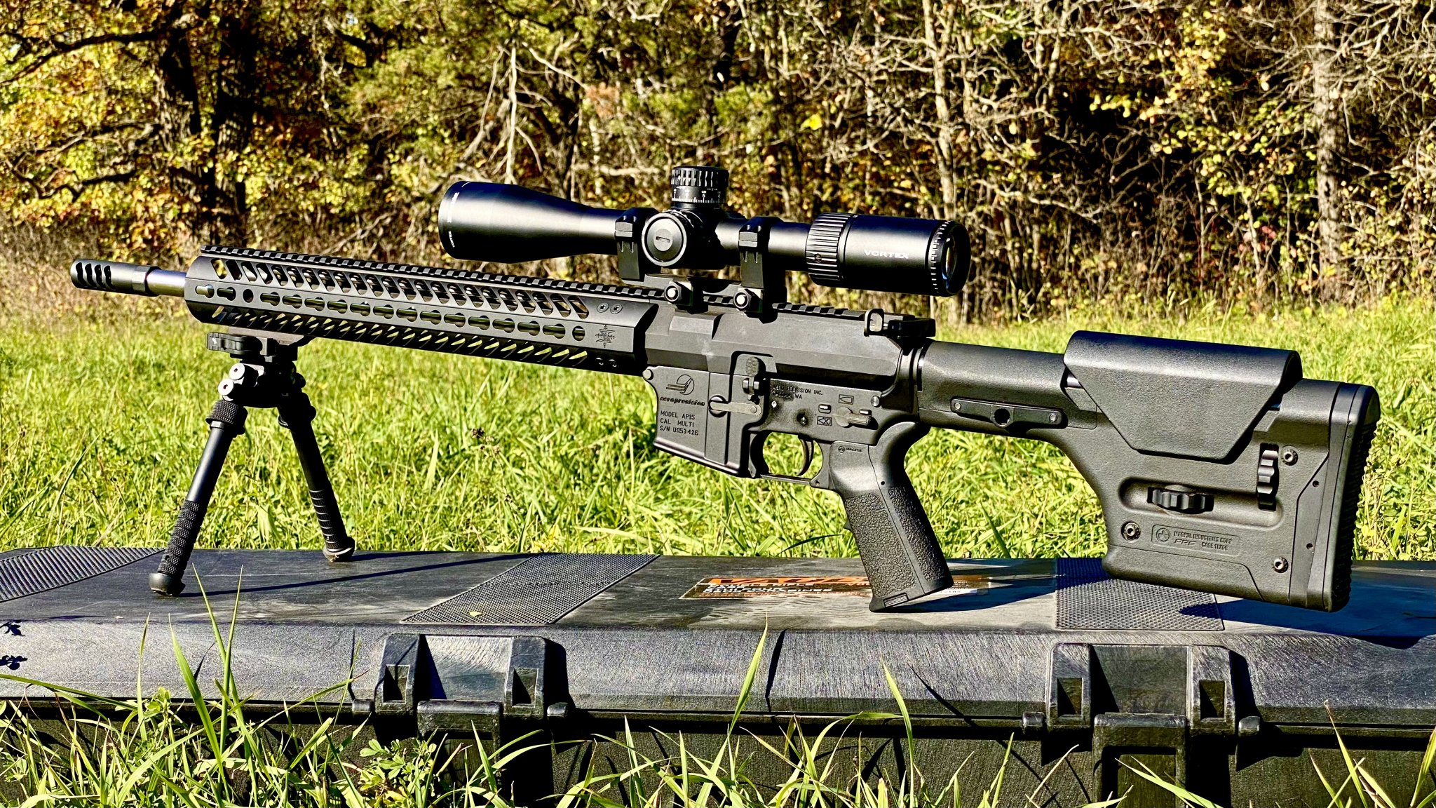

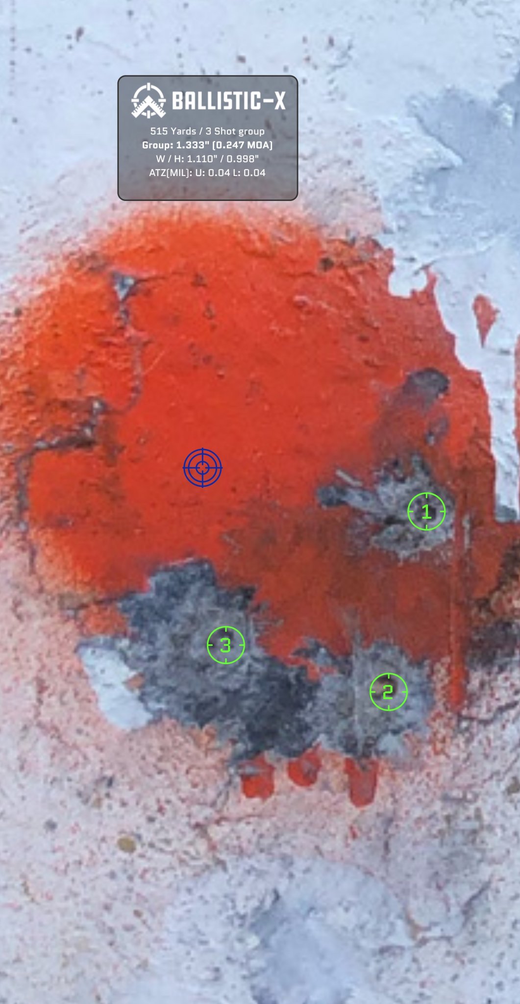

Stretched the legs on the DMR/SPR build for the first time yesterday. Pretty pleased with the results. Without shooting for groups it grouped consistently around 3/4moa with reman ammo. I don’t doubt the groups will shrink with handloads. Most of them had 3-4 that were sub 1/2moa, and 1 or 2 would open them up to 3/4moa. Ran it out to 520 yards with ease. The bleed off setting on the Superlative Arms gas block is super nice and you can really tell a difference from full open to the bleed off settings.

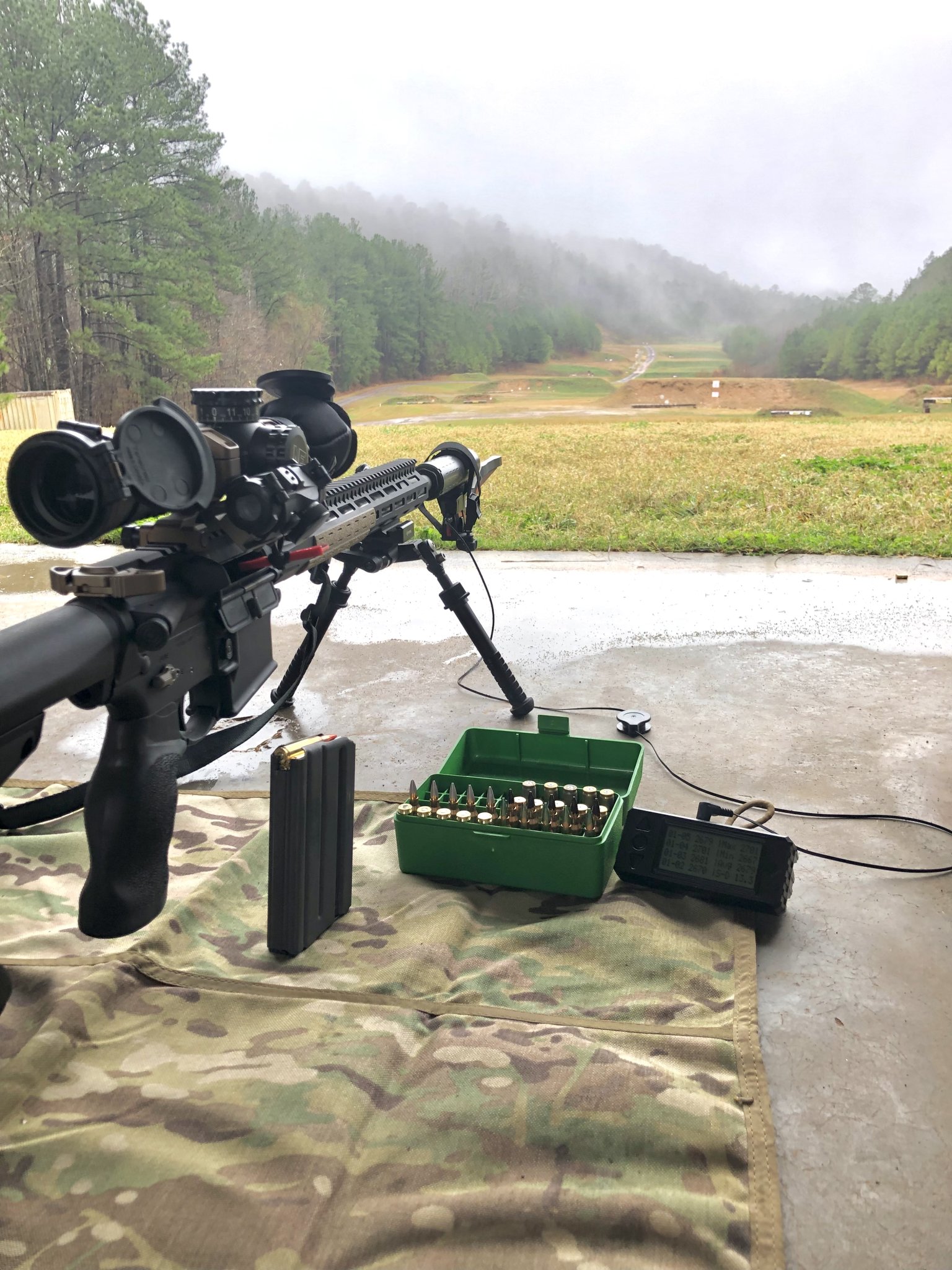

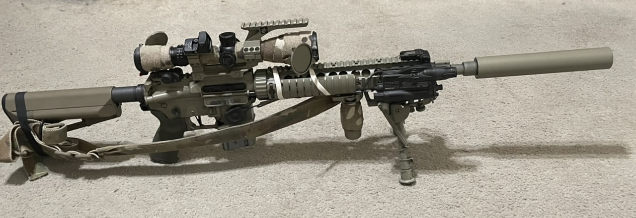

I run a DPMS recon in PRS. (16 inbarrel, stock I swapped in a AGB to run a suppressor).
Bushnell Elite (3-18X)
Larue QD mount.
Sandman-S on a FH QD mount.
Was running Harris Bipod, The atlas-prs is better for prone, harris deploys faster.
Not fancy, but puts rounds on target Saturday Afternoon.

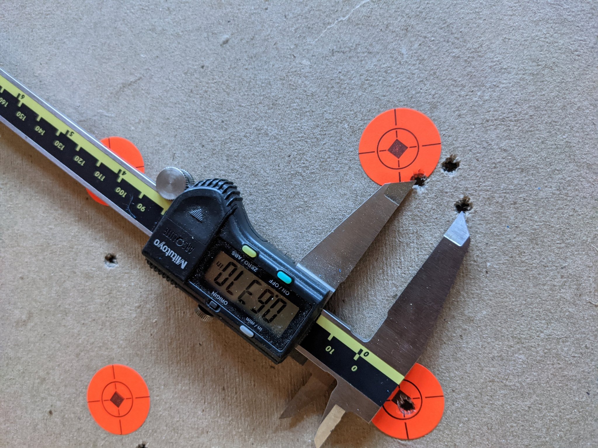

Update for my gas gun enthusiasts on this thread after a couple recent division wins at my local match with the .223 DMR.
Don't play the game like an open class bolt gun:
1, keep your set up as light as possible, your recoil should already be comparatively low, so take advantage of the fact that, if it's still balanced, it'll be easier to adjust your NPoA while in position.
2, speed is your advantage, take advantage of the fact that you can follow up quickly before even the switchiest wind changes by learning to spot misses and make that easier by running a gridded reticle.
3, Lastly, depending on your caliber, focus on the stages where your caliber shines.. for me, stages with 2 moa targets and/or all targets inside of 700 yards.. if you have stages with ranges outside your caliber or comfort zone, use that time to experiment a bit with maybe a position you wouldn't normally try or a technique and any hits you DO make, consider them bonus for the gas gun division lol

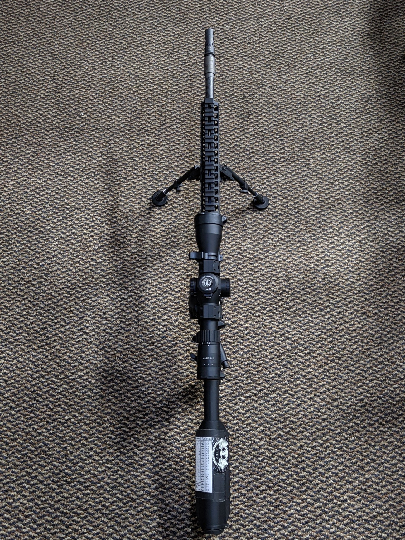

@Phatcow I have been kicking around the idea of running the SPR at local PRS matches. I went back and looked at old match booklets and about 75-80% of the targets are between 300-700 yards. I definitely think it would be manageable and more enjoyable than running a hot rodded bolt gun.
I got the Guardian match at GTI in November that I made the decision to run the SPR. There are 3 stages that have unlimited round count and the SPR/DMR would be better suited than a bolt for lugging around the old nuclear facility. It’s about 5lbs lighter than my AI AX.
Local gun club was supposed to start SPR/DMR matches this month, but looks like it got postponed to January.
Ran barricade, tank trap, and cattle gate drills this afternoon. One round per position and move. Also had a 1/4 MOA group at 515yards

For me, I go back and forth between DMRish and Recce optics setups on the same gun depending on what I want to do with it:
Rifle
- SanTan billet receiver set
- Aero 15” handguard
- 18” CLE/Criterion SPR .223 barrel
- CLE bolt w/ Bootleg suppressed carrier
- Geissele & JP internals, Magpul furniture, etc.
Optics
- US Optics TS20x w/ JVCR (DMR)
- Burris XTR2 1-8 ffp w/ ballistic circle dot (Recce)
This setup does extremely well with both optics on it. Super soft shooting and accurate with 77gr SMK handloads and is one of the first rifles I always reach for.

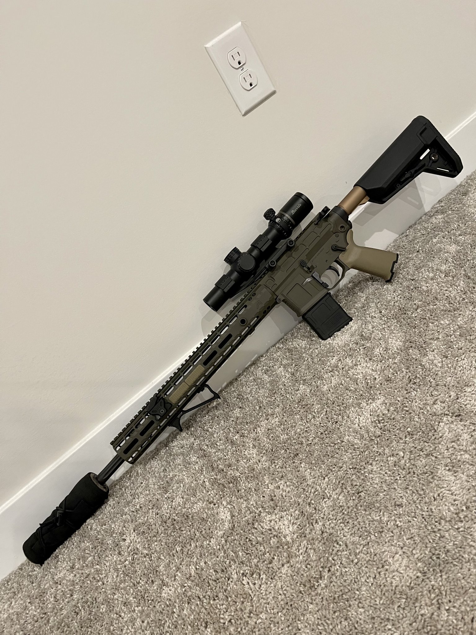

Im looking to build my first SPR for matches and training courses with the after thought of a SHTF. I know its opening a can of worms becuase everyone is different. I just want to be able to learn at training and be competitive in a match. Picking the right caliber is my hard part. What do training courses like hatcreek or ridgeline or CR2 recommend you use for their SPR/DMR courses? I used to shoot FTR with my bolt gun so I dont really know what Im getting myself into. Is Wylde the way to go and then build the rifle with a CLE barrel and Rifle gas system? Is a different caliber worth looking at?
Given your parameters I’d choose a .223 carbine, I mentioned some reasons why I’d choose a .223/5.56 earlier in the thread as it applies to DMR matches. Those reasons can also carry over to training and ”SHTF” scenarios because you can carry a lot of .223 and it’s still cheaper than .308/6.5 CM/etc…. I would recommend .223 Wylde because it works as an AR-15 barrel chamber, it’ll shoot .223 REM and 5.56 NATO match ammo well.
It’s hard to go wrong with a CLE barrel, they have the reputation that they do for a reason. Since this is supposedly a “do-all” rifle, I’d recommend a 16” ML gas barrel, you’ll still have plenty of velocity to hit targets at 600 yards while still keeping the package nimble. A pretty good recipe for an all purpose rifle is below, it’s not the end all be all of lists but if you know what you’re doing you’ll be able to hang in DMR matches, do carbine training, and have a decent package when society folds up.

Thanks. I was only thinking 18in to be able to use the heavier 69gr or 72 to get that extra umph at distance. And Then running rifle gas system to keep it as smooth as possible for follow up shots. I would rather have a nice accurate upper for matches and training and then maybe build a second upper with shorter barrel etc for the home defense. Maybe thats wrong though. I tend to over think everything.

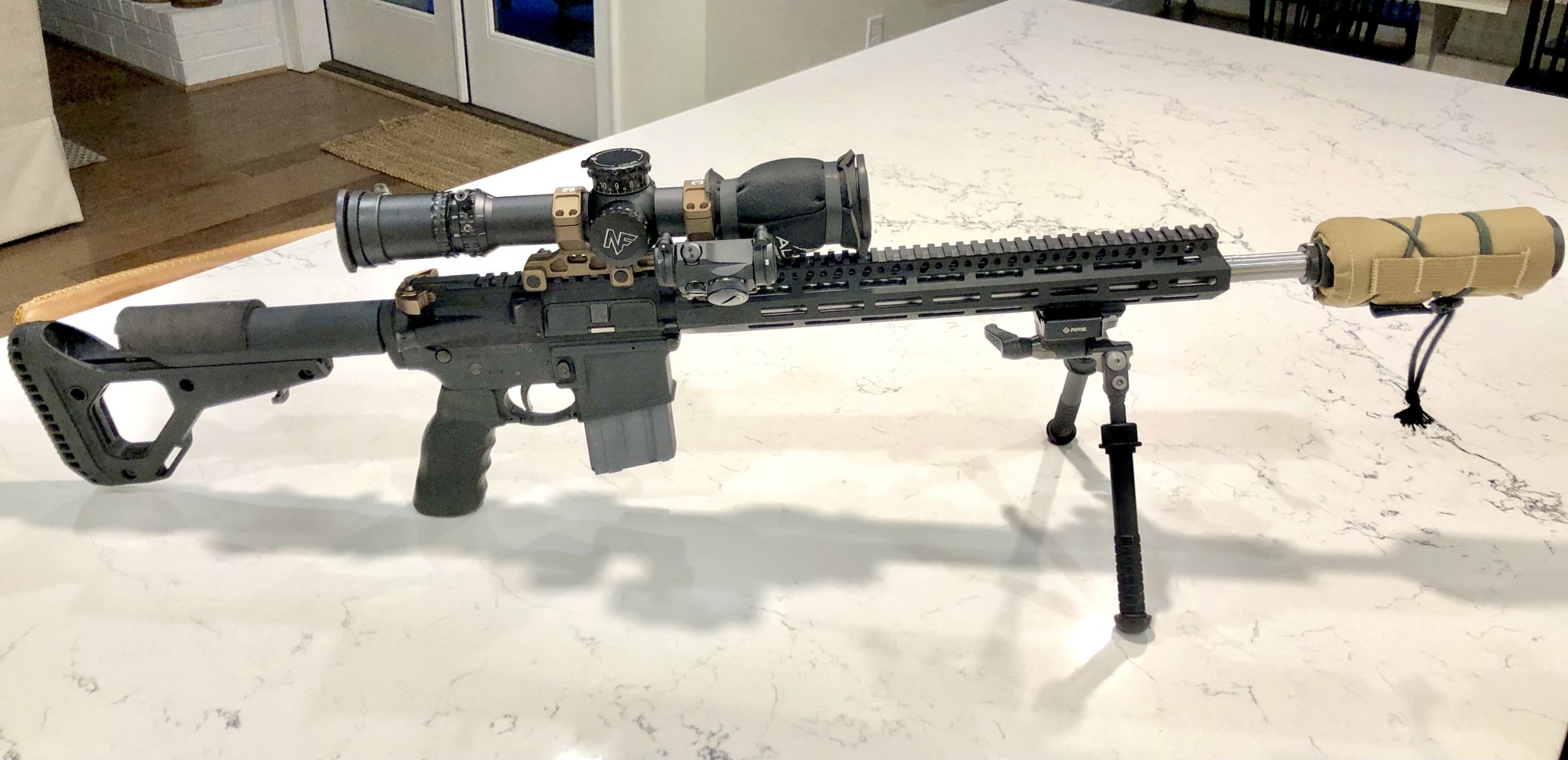

Current build. Waiting on the Vortex LHT 4.5-22; EOTech on it for testing. Shooting great at 100, need to test it at longer ranges still.
Intent is a secondary shooter platform for team prs-style matches (think: TTG Sniper Challenge).
Reactions: PBWalsh
What gas block are you using and how is the clearance? I have a 15” mk16 I was thinking of using on a SPR build but worried about the slim ID.

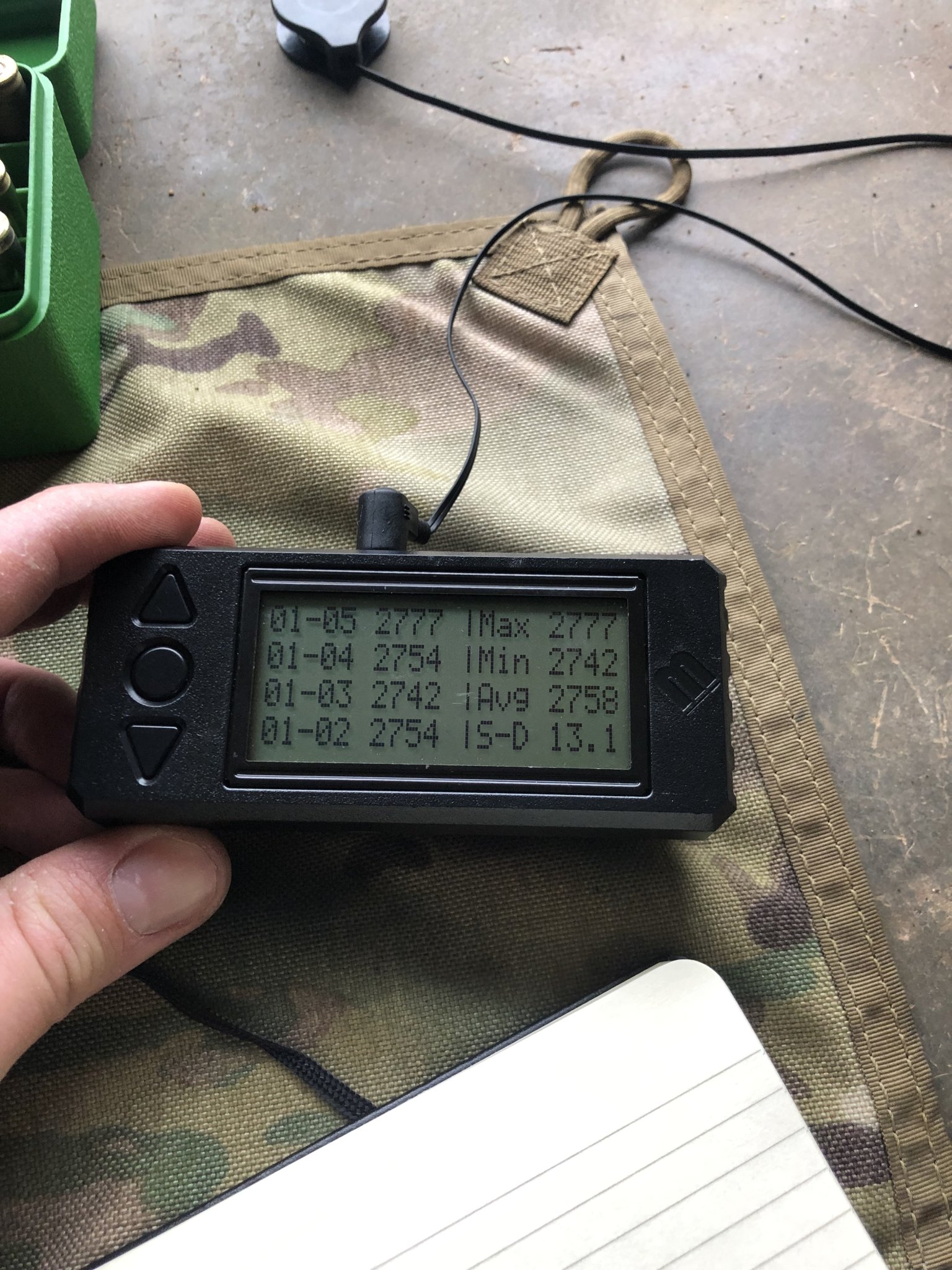

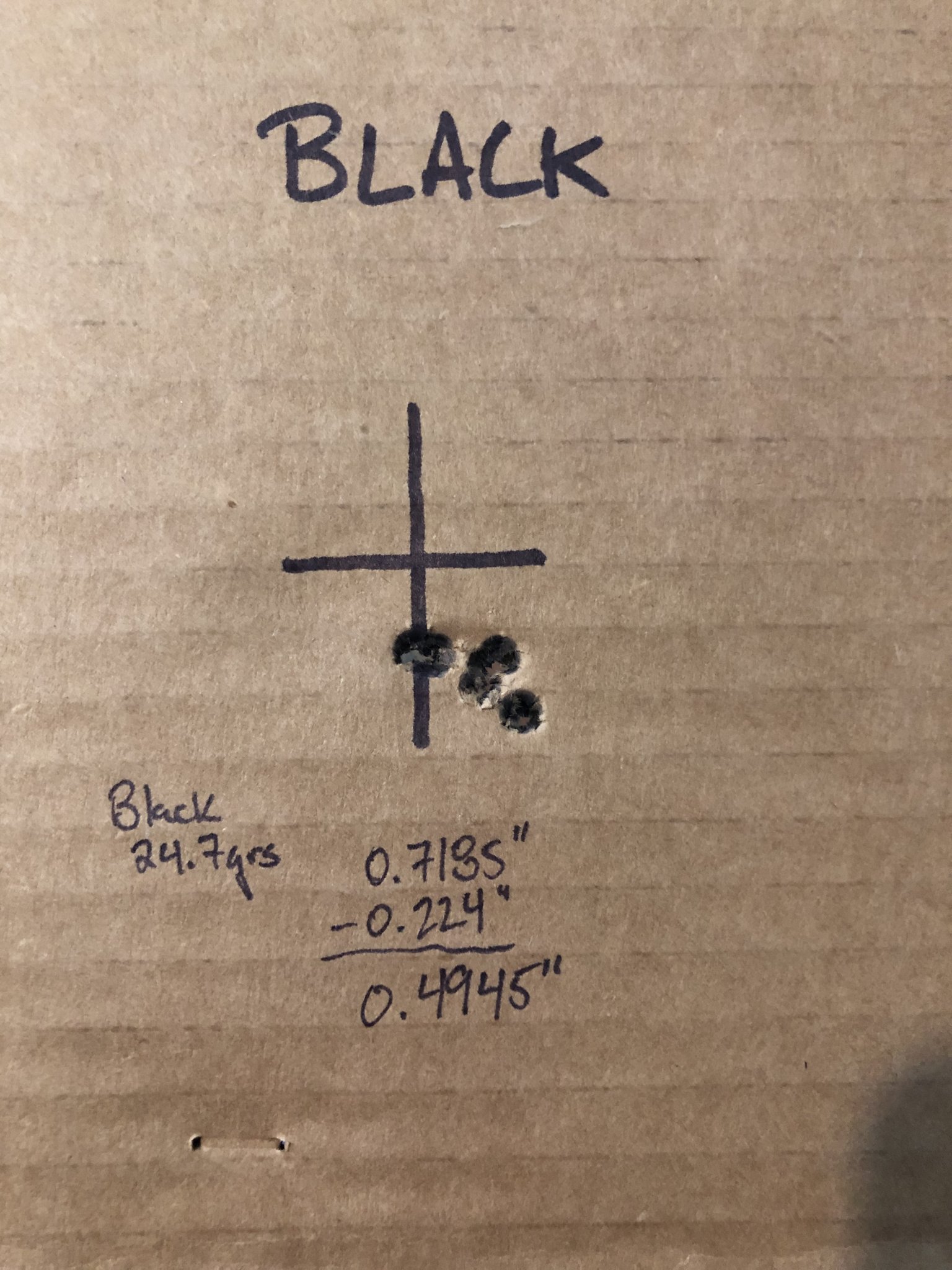

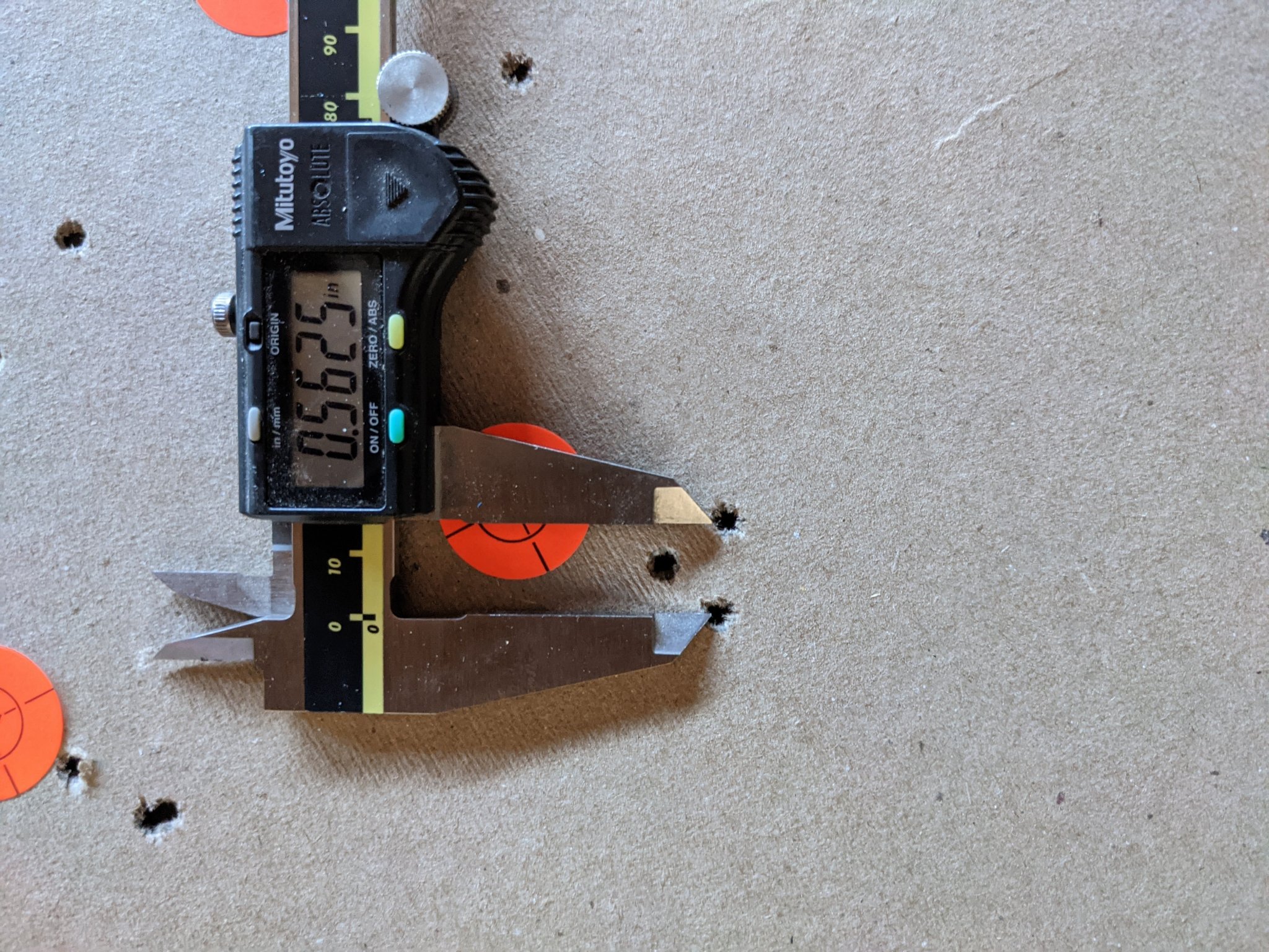

Finally got around to developing a load for mine. I loaded up a 5 load test series with 5 rounds each. Most of the five shot load development groups were ~3/4” with only two being sub 3/4”. Gold 24.1grs (5/8”) and Black 24.7grs (1/2”). Settled on 24.7grs and loaded up (200). Maybe when I get some more time I’ll play with seating depth to see if I can’t fine tune it more.
After some setbacks our first DMR match will be in January and I am really looking forward to running this setup.
Virgin Lapua Brass
Federal 205 SRP
VV N140 24.7grs (compressed)
77gr SMK
COAL 2.275”
Average 2758fps SD 13.1fps ES 35fps

Will be running an 18” Rainier Ultramatch Barrel, 1-7T, 223W with an OSS Helix 762 QD. NF ATACR 4-16x42 with a Holosun 509T offset. Should zero the red dot Saturday.
So far its been a great system to shoot, really enjoying this rifle.
