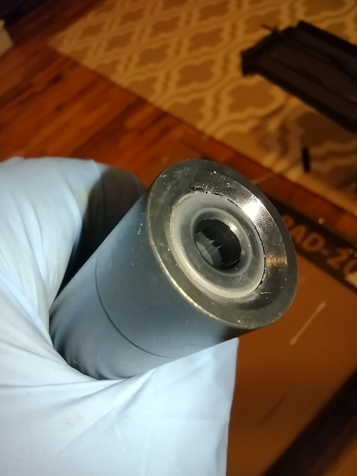

For those of you talking about trigger needing work, is the adjustability not enough for your liking? I have to work pretty hard to get mine to shoot sub 1" at 50 yds. Does this picture tell anything about the muzzle?
