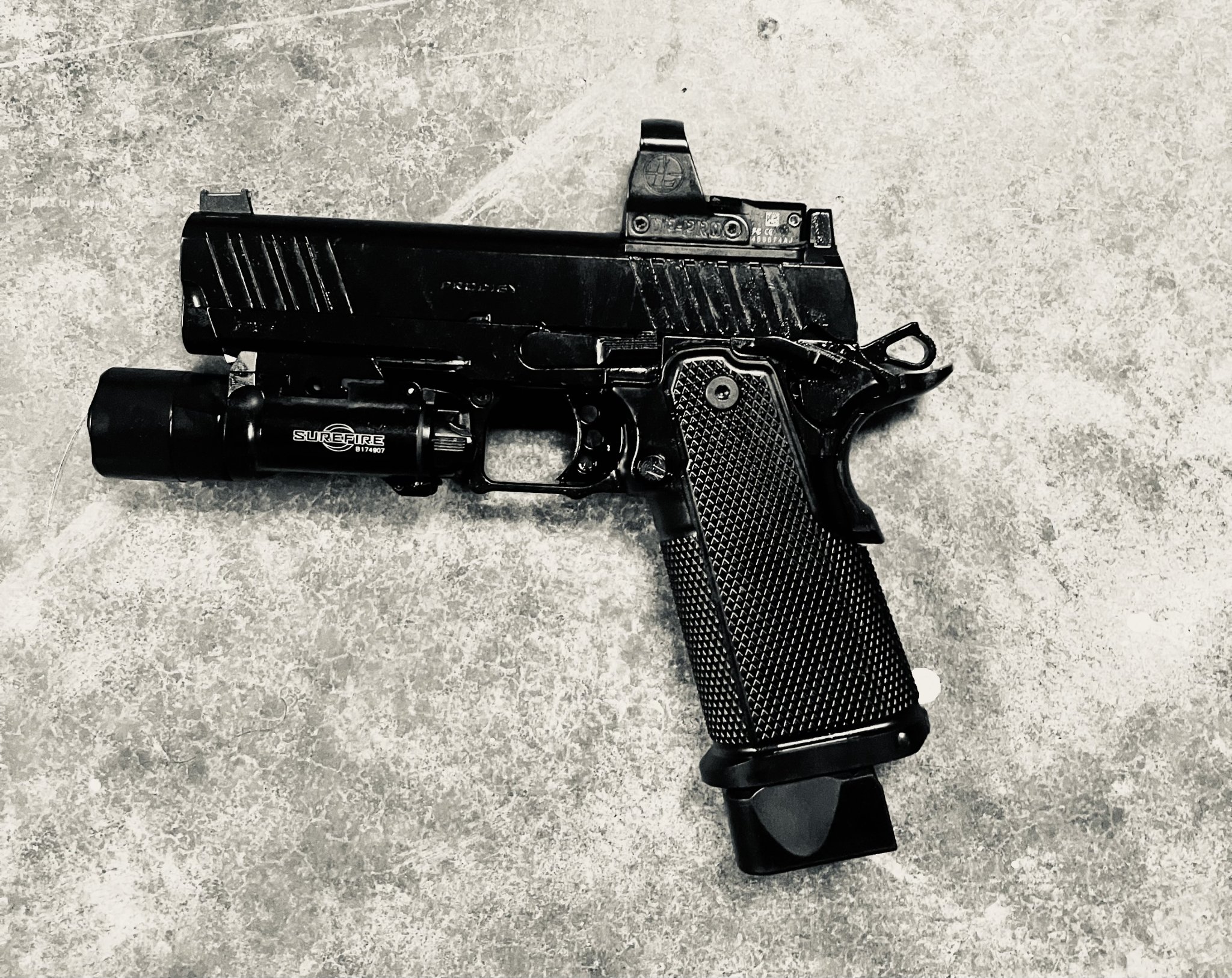

Just got back from shooting about 500rd through my Prodigy for the first time since installing the PT Hero grip and Red Dirt trigger and tuning it.
I ran off a few thousand 124gr 9mm with 4.0gr Titegroup. 1023 SD 11 on my 1050 autodrive
Man this thing is absolutely perfect. Smooth as silk, trigger is amazing and feels great in the hand. Not a single hiccup or issue.
I'm done messing with it. It's exactly how I want it.

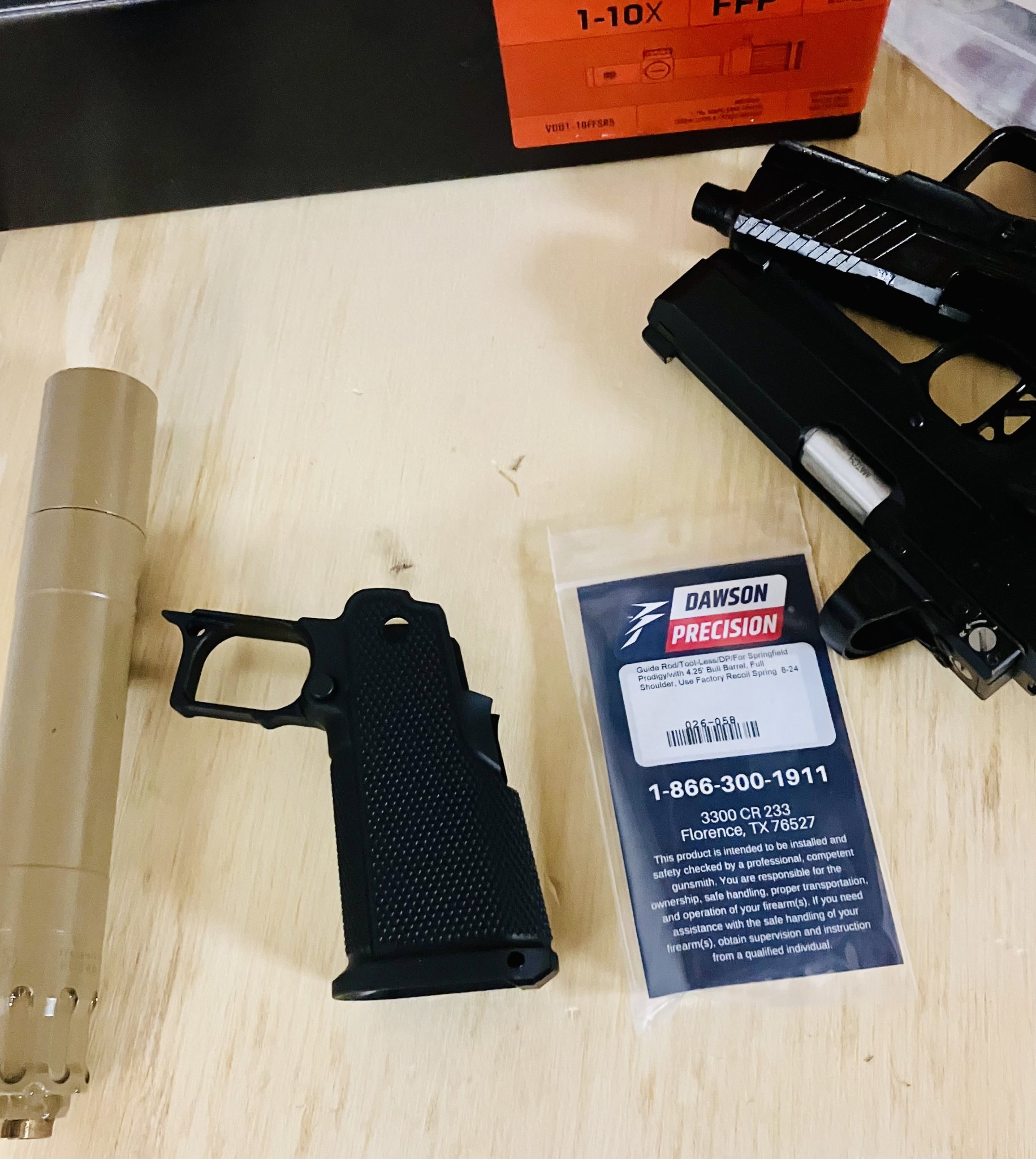

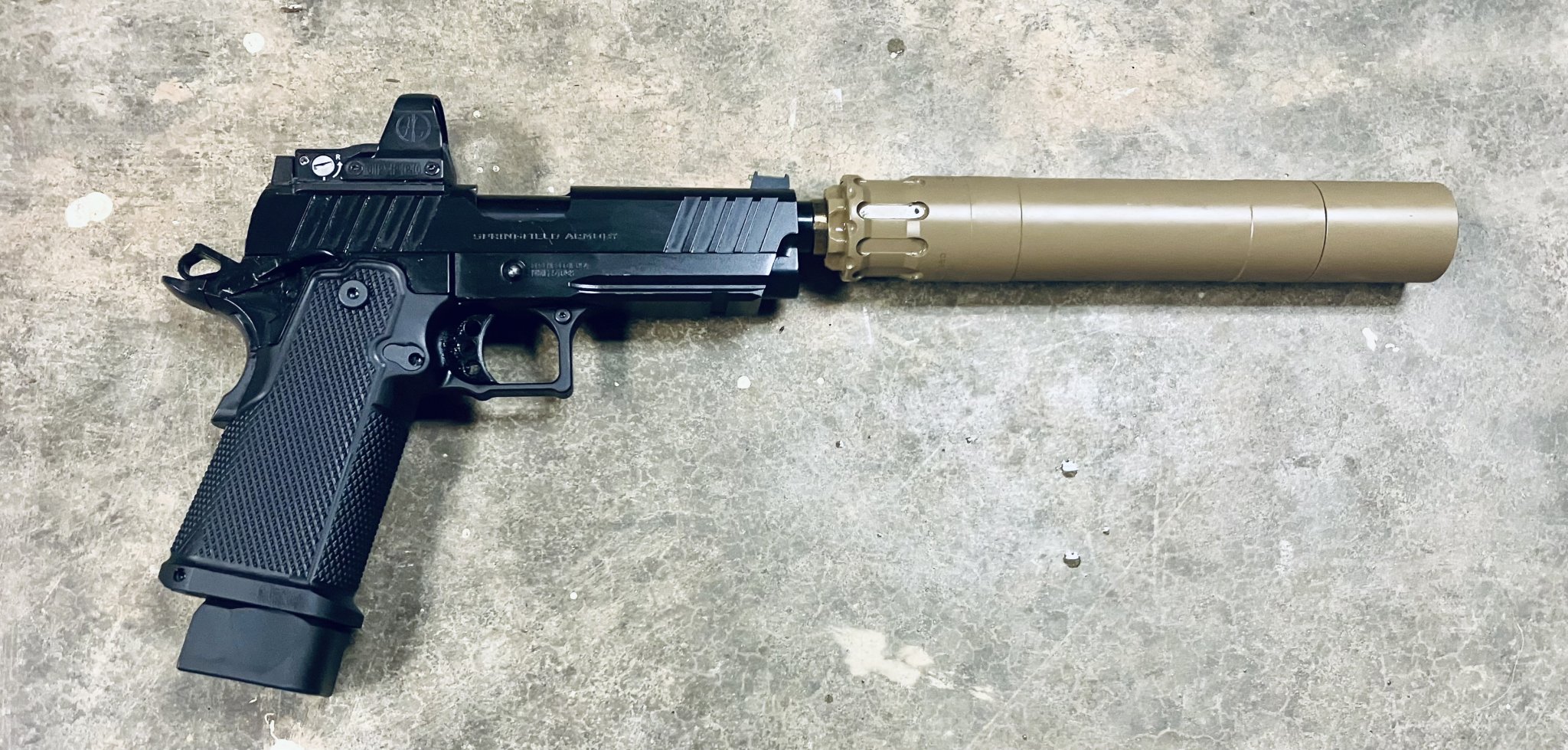

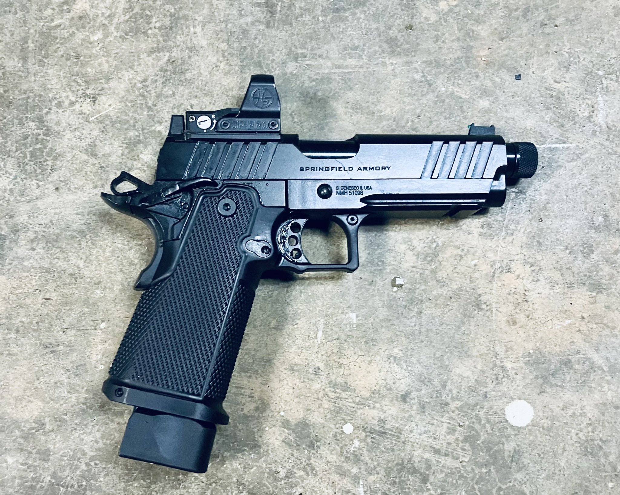

love mine also
Installed phoenix hero trinity grip and also Dawson tool less guide rod
Still waiting on Jarvis threaded barrel for suppressed use
Loved tinkering with mine so much I’m ordering cheely parts to assemble my own. Going to style it after the atlas ares

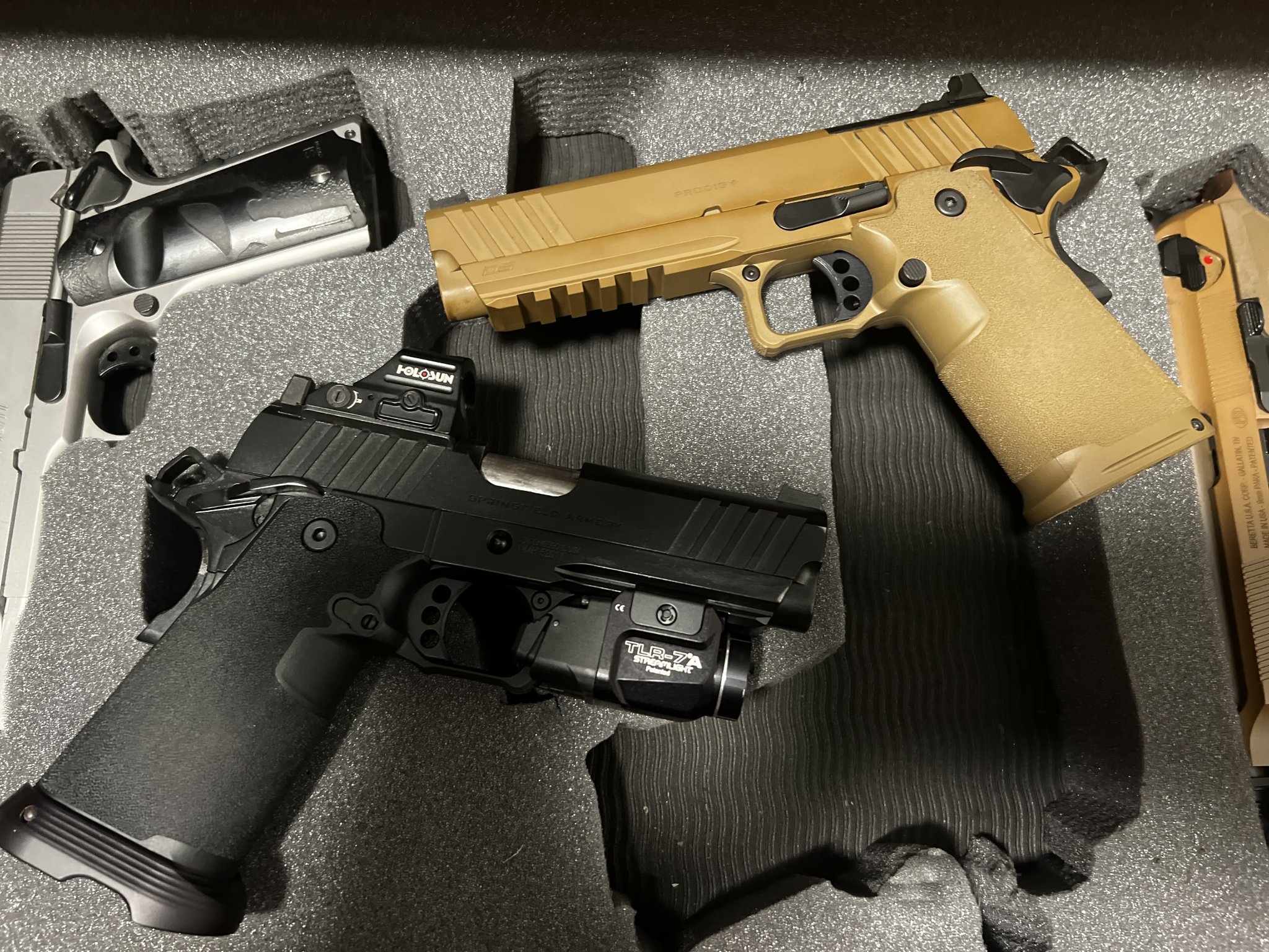

I took my Prodigy out today to shoot with my brand new SIG P320 XFive DH3. Man these are 2 badass pistols. They both are stupid accurate, feel amazing in the hand and shoot flat as hell.
Im going to throw this Holosun 507c up for sale and grab another Delta Point Pro I put on the P320. While the 507c runs great, I just like the bigger window of the DPP. I have a ROMEO1 Pro on my other P320 which also has a bigger window but I just love this DPP.
Banging some plates at 15yds with boring consistency. Such a joy to shoot.

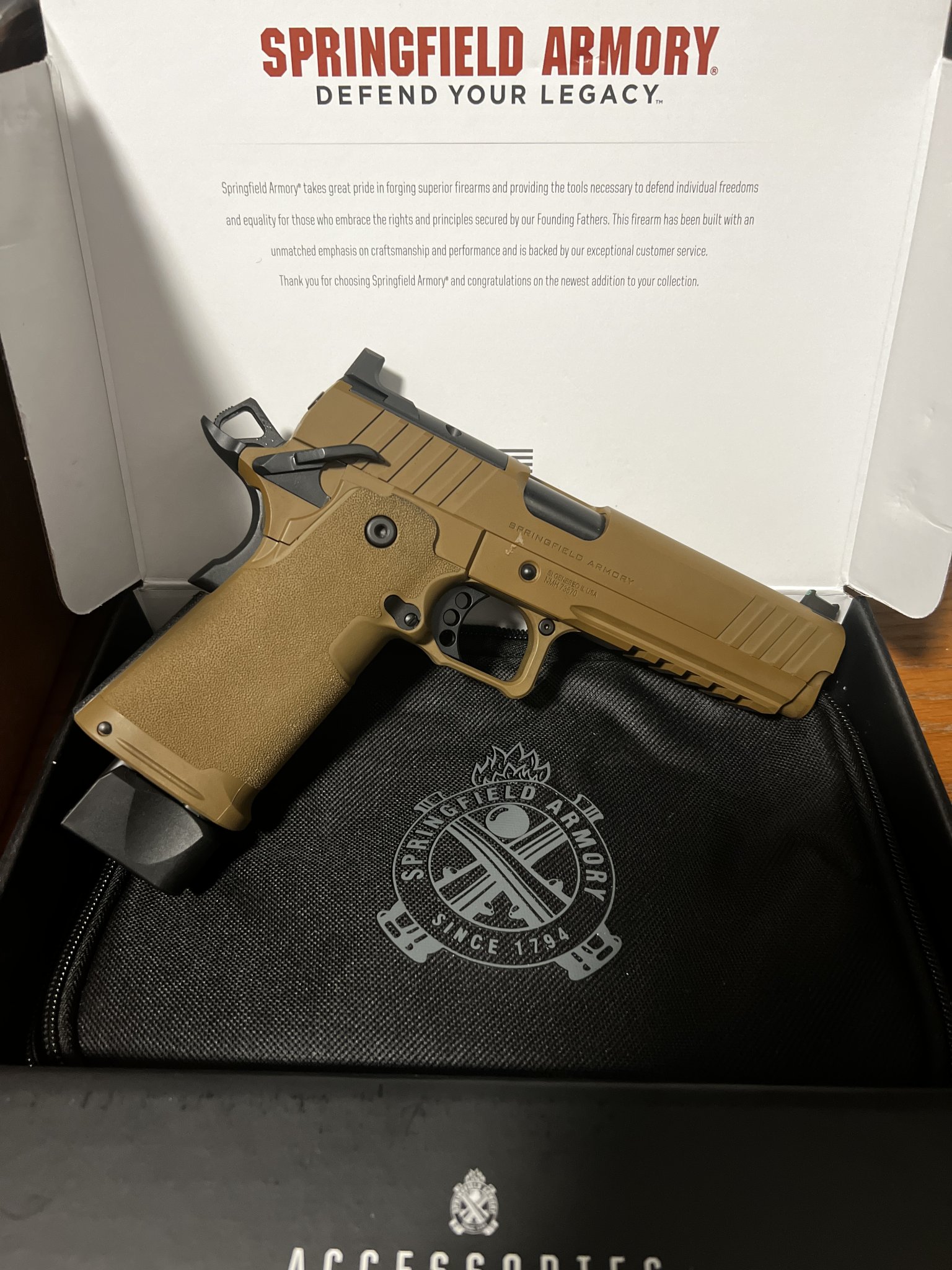

Started my oldest boy in a local range’s beginner handgun league this year. Intro’s new shooters to the handgun sports, takes them from complete noob to being able to handle a full stage safely. Been shooting it with him, he’s getting pretty sucked in, having lots of fun and wants to shoot all the time. He’s doing pretty well with a Glock 19 at 12 years old and kind of small. Found a great deal on a lightly used 4.25” prodigy, he’s getting it for Christmas. Of course I had to “function” test it first 😁. It’s surprisingly not as far away as I would’ve thought from my Staccato P.

I was pleasantly surprised, granted zero experience with Springfield 1911’s. Was expecting something like a rock island reading/watching all the bullshit on them out there. Read through this thread and it seemed like a no brainer for a base to be modded as skills improve. So, thank you for posting your project, it’s super helpful for me.
Edited to add, my local honey hole had 2 of the same 4.25”, each for $1k. Appeared to have the same light wear, 1 was great, 1 was terrible. The slide was oiled but would stick in various positions and stay here until helped, among other things, the choice was obvious.

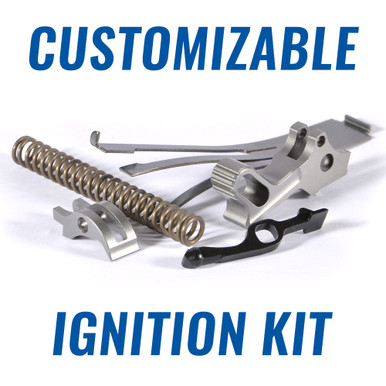

For some inexpensive upgrades that make a HUGE difference the EGW Ignition kit and Red Dirt trigger are awesome upgrades. Night and day difference from the factory trigger My factory trigger was gritty and got a little better as I dry fired more but isnt even a comparison to the EGW/Red Dirt upgrade.

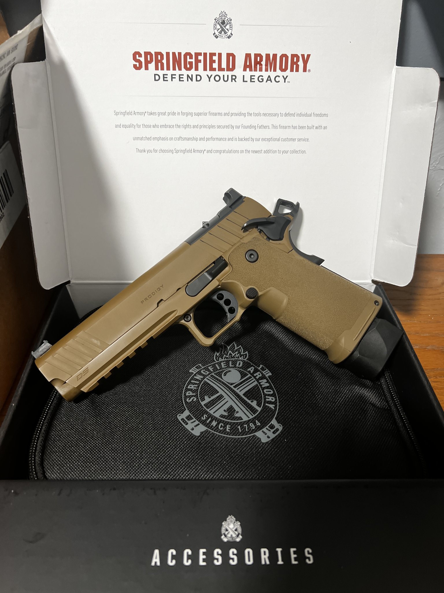

Short Story version:
Got the 5” and I’m surprised that I like it as much as I do. Plan to put 12,000 on it in 2025.
Long Story version:
Just picked up a 5” prodigy. First 2011/DS/WTFever you wanna call it. Was going to buy a Staccato P but figured I’d try this out for 2025 matches to see if I like it more than my G17. If I do, I’ll get a Staccato P for 2026.
Snagged it used (it actually looked new and couldn’t imagine the original owner shooting more than a mag through it) from a local shop. I sold the Hex Dragonfly and optics plate that came with it so the gun ran me just under $900. Popped on my RM06 and X300V on it and ordered up a safariland and 5 extra SA mags. Cleaned and lubed it the way I do my Glock and then ran 1,000rds of Speer 124gr TMJ. Goal was to see how long it would go without a malfunction while running it like I run my G17.
500rds day 1, 150rds day 2, 150rds day 3, and 200rds day 4 (all within a week and no cleaning or lubrication other than what I did when I got it).
First failure (stovepipe) was just at 900rds. From 900-100 it became super sluggish with those rounds pretty much becoming single shot with my pushing the slide forward with my support thumb lol. It his was expected but I just wanted to see what it can do if I treated it like my Glock.
Note on round count: I actually have 1100rds on it as I ran through 100rds of various JHP ammo I had in some boxes. Ate Federal, Speer, defender ammo without malfunction.
Accuracy wise it’s extremely easy to hit exactly what you want with it and cleaning a timed dot torture drill is stupid easy. (Not that it’s a hard drill but still.)
Speed is well 2011 fast which is easily faster in the hands of an average shooter. Sub .2 splits are easily done by most without any real effort, whereas with a factory glock you have to work for it.
Springfield (duramag) mags are solid. No issues with magazines for the 1,000rds.
It’s a blast to shoot and I plan to keep it stock outside of a 10-8 tooless plug and a Taran magwell. Is there a shootability difference it and the staccato P? Eh not really. I’ve run a buddy’s stock P and it shoots the same. Is the prodigy as finished and fine tuned as a P? No. Not at all. Recoil is the same. P’s trigger is nicer but I can shoot the same groups.
Now when compared to my other buddy’s XC, his is A LOT flatter when doing rapid drills. But that’s outside of what I want in a pistol. …and price 😂
Do I like the prodigy? Yes.
Do I regret getting it as a Glock fan boi? No.
Will most handgun shooters be able to out shoot (as in be limited by the gun and not their ability) it in its stock configuration? No…and that’s true for any pistol really.
Will I still buy a P in 2026 if I still like it? Who knows. But that’s the current plan.
Hope my ramblings helped convince someone to try a new pistol or at the least get rounds downrange instead of watching TV. 🍻

My 5" factory trigger was gritty and left a lot to be desired out of the box. That was on a brand new 5" pistol.
For under $250 you can throw a EGW Ignition kit, RED Dirt trigger and Tooless guide ride and spring in there and its a completely different pistol. Every other upgrade is purely cosmetic after this.
Do you guys install these ignition kits yourselves? It needs to be fitted correct? I’m certain I don’t have the skills to be messing with filing sears and whatever else goes into that. I definitely don’t know a 1911 gunsmith I can trust. Just curious if you guys are sending yours out for someone to do the install.
Most of the parts are drop in, at least on my brand new 5-in prodigy.
The plunger had to be fit and all I did was lightly move it across a stone and keep fitting it until it was perfect
The spring you just slightly bend each finger until you have reset and trigger pull where you want it.
There's a great YouTube video showing you exactly how to do this and it's not hard

Also, to be clear, there are multiple triggers you can put in the Prodigy. Atlas, Red Dirt, etc..
I have both the Atlas and Red Dirt and I find the Red Dirt the best design thats all

I did the trigger thing for my Bul armory, I would tell you to order an extra sear spring and get yourself some snap caps.
When you're done getting things installed and you need to test it, put the snap caps in a mag and drop the slide about 100 times to make sure you don't get hammer follow.

Yea I adjusted out all the pre-travel in my Prodigy with the Red Dirt trigger and EGW ignition kit and my grip safety works perfectly.
