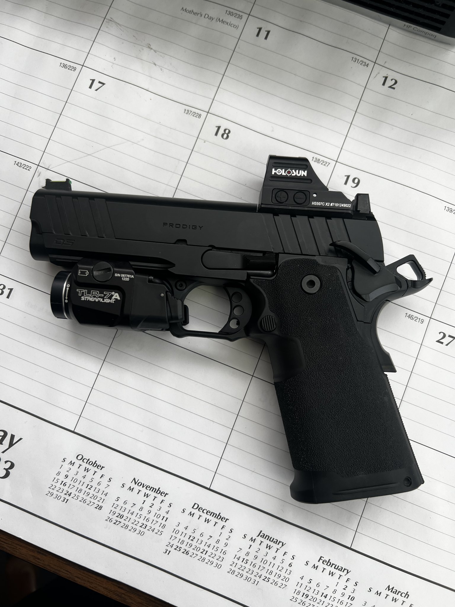

Well, I probably should have just shot my new Prodigy before buying anything for it then decided. hahaha.
I dry fired it 1000x or so since I bought it. I took it out to the range today and put 300rd or so through it shooting 90% my 124gr Extreme HP/4.0gr Titegroup load and 10% Blazer Brass 115gr factory ammo.
Mixed HS Cleaned 9mm brass
CCI SPP
124gr Xtreme HP
4.0gr Titegroup
1.135" COAL
All rounds were run on my 1050/Ammobot. Brass was all processed on a dedicated brass processing toolhead deprimed, swagged, sized. Then all brass was run on a dedicated loading toolhead with a Mighty Armory flare die, Redding Micrometer seating die and Mighty Armory crimp die.
I loaded the first 20rd mag with the 124gr Xtreme HP handloads and I had 2 Failure to Feeds. Very first round out the mag stabbed straight into the feed ramp and didnt slide up it into the chamber. I pulled the slide back a hair and let it go and it went in the chamber and fired fine. The next 3 fed and fired fine, the 5th round same thing, stabbed straight into the feed ramp. I again pulled the slide back and let go and it fed into the chamber this time. Next 15rd in the mag fed and fired fine.
After the 2 FTF in that first 5rds through the gun, never had another problem for the next 280rds. Every round fed, fired and ejected perfectly after that first 5rds.

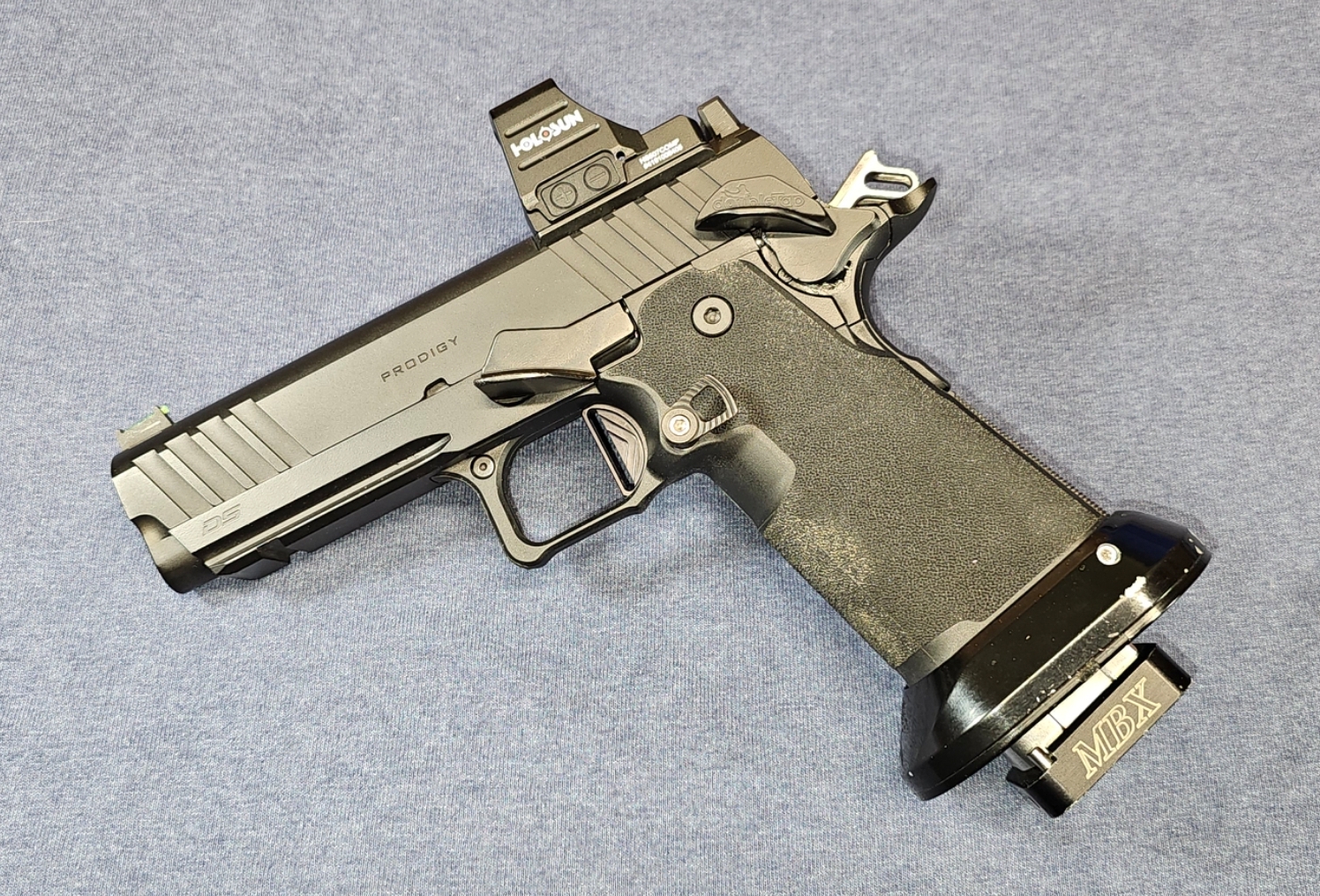

I am extremely happy with my purchase. The gun is super smooth shooting and very accurate with my handloads.
I have a bunch of parts coming this week. Ill start replacing parts 1 at a time and seeing how the gun runs and feels. The trigger has definitely smoothed out from when I first got it but its still got a little gritty feel from the wall until the trigger breaks.
Alright, some updates for anyone that is following or cares on the new Prodigy progress and testing.
So after putting 298 problem free rounds through it the other day as mentioned in my previous post, I brought it back to the shop and tore it down.
After cleaning everything I had a pretty good trigger that was breaking around 3.75Lbs on my trigger pull gauge. Still had the slightest ever grit feeling at the wall but was way better after lots of dry fire and cleaning.
Last night, I Started adjusting the sear spring per the Atlas video. I had it adjusted down to around 2.75lb and felt really good, still had that little bit of gritty pull when you started pulling from the wall and before the hammer fell. Couldnt get rid of that no matter what I did but it was honestly a pretty darn nice trigger if I couldnt do anything else.
My EGW ignition kit, mainsprint, tooless guide rod, atlas trigger package and Dawson firing pin came today.
I tore it back down, installed the Atlas trigger and bow, got that tuned where I wanted it, installed the EGW ignition kit and tuned the sear spring that came in the kit.
WOW is all i can say. Grit is gonna, nice short take up before hitting the wall, trigger breaks at the wall like a candy cane. No more grit and additional travel before breaking like the factory ignition parts. Also, it measures dead on 2lb trigger tested 15+ times in a row on my Timney trigger pull weight gauge.
I am very happy with the gun now, the 2lb trigger pull, Atlas trigger and the way it breaks is excellent. Never thought these parts would get it feeling like this without sending to a smith to work the trigger. Really like the feel of the Atlas trigger too compared to the factory trigger shoe.
Also, life is SO MUCH BETTER with a tooless guide rod. I actually realized I ordered 2 by mistake. I have the Atlas tooless guide rod installed with the factory spring currently. I have the EGW toolless guide rod assembly with their spring and all I have not installed yet. Ill test both setups at the range and see which one I like best.
I have not installed the 19# mainspring that came in the EGW ignition kit or the Dawson extended steel firing pin. Ill decide if I need/want to do that after I get some rounds through it as it sits configured today.

Yep, Ive been testing that a ton already. I had to make adjustments to not get hammer follow. As it sits, everything is perfect but will keep testing
Something else to consider is the over travel. Very good friend and rifle /pistol builder took his over travel a tiny bit too short and the slide coming forward was enough force to fire pistol if he was still in the wall. His split times were fucking amazing 🤣
I just dropped the slide another 50+ times and hammer never fell. Trigger pull still sits right at 2lbs.
I did have an issue with the EGW disconnector not fitting in the hole. That was easily fixed with with fine grit sandpaper. Ive read others having this issue and EGW stating they come oversized to be fit to each gun. It literally took a minute to get it freely moving in and out of the hole.
Last issue I had was with the EGW disconnector holding the slide back when you fired and held trigger to the rear. The EGW disconnector sticks up too high and the slide wont slide over it. Another easy fix by sanding it down and polishing it so the slide moves right over it like the stock disconnector.
My Holosun plate came and its installed. Im ready for range session #2 to put 500 or so rounds through it and see how it performs.

Well, my son and I took the Prodigy out for the 2nd time today. First time with all the new parts.
Ran smooth as hell and trigger is WOW! Honestly, I may adjust the trigger a tad heavier but we will see.
Not a single hiccup, malfunction, nothing. We put about 400rd through it. 124gr Xtreme HP and Titegroup run on my automated 1050. I fucking love this pistol.
My 4.25” prodigy has run really well to date, not a 100%, but I still don’t have a huge round count on it. I’d have to go back and look at my posts, but if I recall, the failures I had were with a fairly dirty action so I just keep it clean. I know for a fact that my 1000 reps of dry fire and slide cycling prior to ever shooting it, definitely got a lot of cerakote out and smoothed things out immensely. Now I want the tan 5” model.
On another note, I have a full size 1911 that I’d love a qualified person to possibly do a little trigger tuning to. I don’t think that’s part of skill level. Anyone around WV that I can trust with that?
So my first issue with this Prodigy and its minor but annoying. Pulled the pistol out of my range bag last night to clean and put back in the safe after yesterday's session and notificed the fiber optic filament was completely gone on the front sight. It fell out of the front sight while shooting yesterday.
My son was the last one to shoot it and we were using the Holosun 507c the entire time so we didn't notice it on the range. Little disappointing but not the end of the world. Looks like Springfield cut a corner here to save money vs using a closed front site with the fiber optic filament inside like most other high end pistols..
I called up Springfield and they were quick to answer and immediately said they were sending out 2 green and 2 red new fiber optic filaments so they did handle the problem quickly.
Doing a quick search on the internet, I found lots of complaints about this very issue that many have had with their Prodigy in the first month.
The way this filament is installed on the Prodigy, the filament is cut to length and pushed through the 2 holes on the front site then you burn and mushroom the 2 ends to make a knob or mushroom so it cant fall out either end. Not a design I like but we will see. Happens again after I replace it Im putting new sights on it.

Did Stevie Wonder cut that slot for the filament?
Reactions: drglock
Seems like they are perhaps cutting corners on not getting the ends "smooshed" well. I know on Archery and Shotgun sights it can be a problem as well. I suppose it's also possible the sight is too close to the muzzle and the melting the end of the fiber. Most of the ones I've seen space the front sight back just that 1/8-1/4" from the end of the slide. At least they sent you some parts, better than the shit shows I've gone through with Beretta and Burris lately. I might lay a little super glue down on the bed of the sight when you replace it.
Funny you say that, I asked the customer support rep the exact same question. "Do you think its heating up where the mushroom is getting soft and thats why it fell it"?? He said no thats not happening, someone went too fast and didnt ensure the mushroom was big enough and its easy to overlook because its so small....
Well, I could believe this on a very small percentage but with all the reports of the exact issue online reported by many, its either heating up and melting and falling out OR the QC of this step before leaving the factory is non-existent.....

That is the most common type of FO front sight. Melt one end of the fiber before sliding it through the sight, from the rear toward the muzzle. Pull the fiber tight, clip it slightly long with side cutters, and then melt the end into a round bulb that contacts the sight. Don't smash the melted end into the sight, allow it to melt into a bulb that touches the sight blade. The greater the material melted the longer the fiber will last. It may take a couple of tries but once you get the hang of it you'll have really durable fiber optic fibers.
I am aware on how to install it. The issue is the widespread reports of new Prodigy owners reporting their factory installed filament falling out in the first month or less of owning it...
