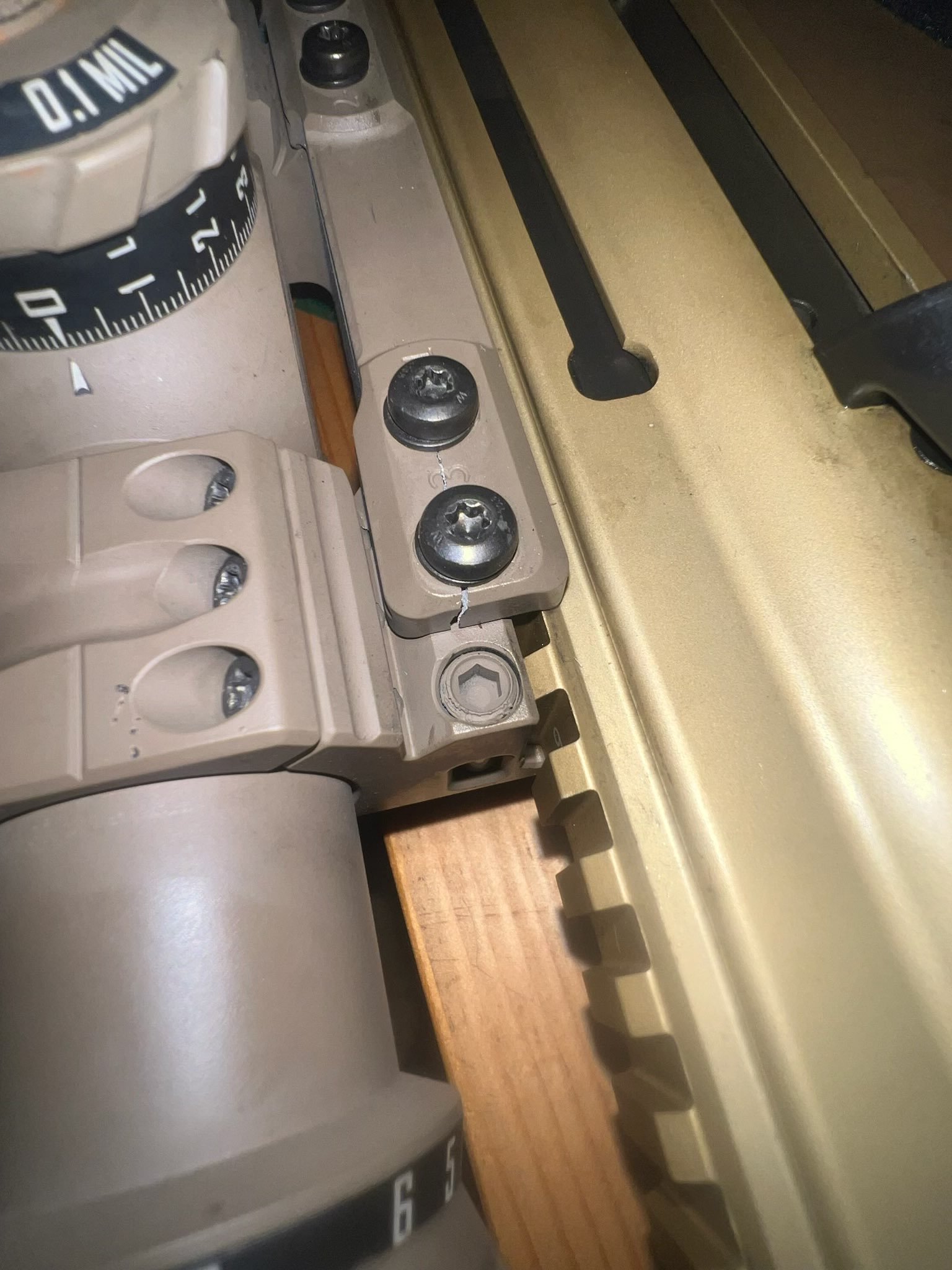

Read the other thread. I would have never sandwiched that scope with the little mounting surface area it had into that mount with as wide as the rings are. Would have went with the NF or something else with narrower profile rings to provide some clearance. Still voting user induced error.

I'd have sent it back before trying to install it. If the manufacturer is not capable of using the same type of screws what would give you the idea that it's of quality? Fanboys and the www pimping over priced equipment?
I've have 3 in use with a 4th ar cantilever one that largely sits around. I broke the plate on one retorquing and got the new plate. It broke likely in the 30 in/lb range as i was headed to 45. I like the mounts , but will seek trying something new next time mostly due to price point. last one i got didnt have the 'lines' on the rear cap which bummed me out as ONE reason I would get these was for scope level and confirmation ease but im just as willing to use feeler gauge method or similar and verify on a plumb bob either way.

I was told there was batch of side plates with a metaliturcal composition out of spec which led to the crack failures in some cases. I haven't cracked the new one but it's been tourqued twice. The original one broke second torquing.
I thought they updated with a newer version that has a 5 screw side plate.
I'm not buying the metallurgical BS. I've broken the 4 screw plate on 2 x different mounts (1 @ 3rd torque & 1 @ second torque), also broke the side clamp on one of their aesthetic mounts on second torque. All broke 5-10 inch pounds under max. Now carry a spare clamp for both.

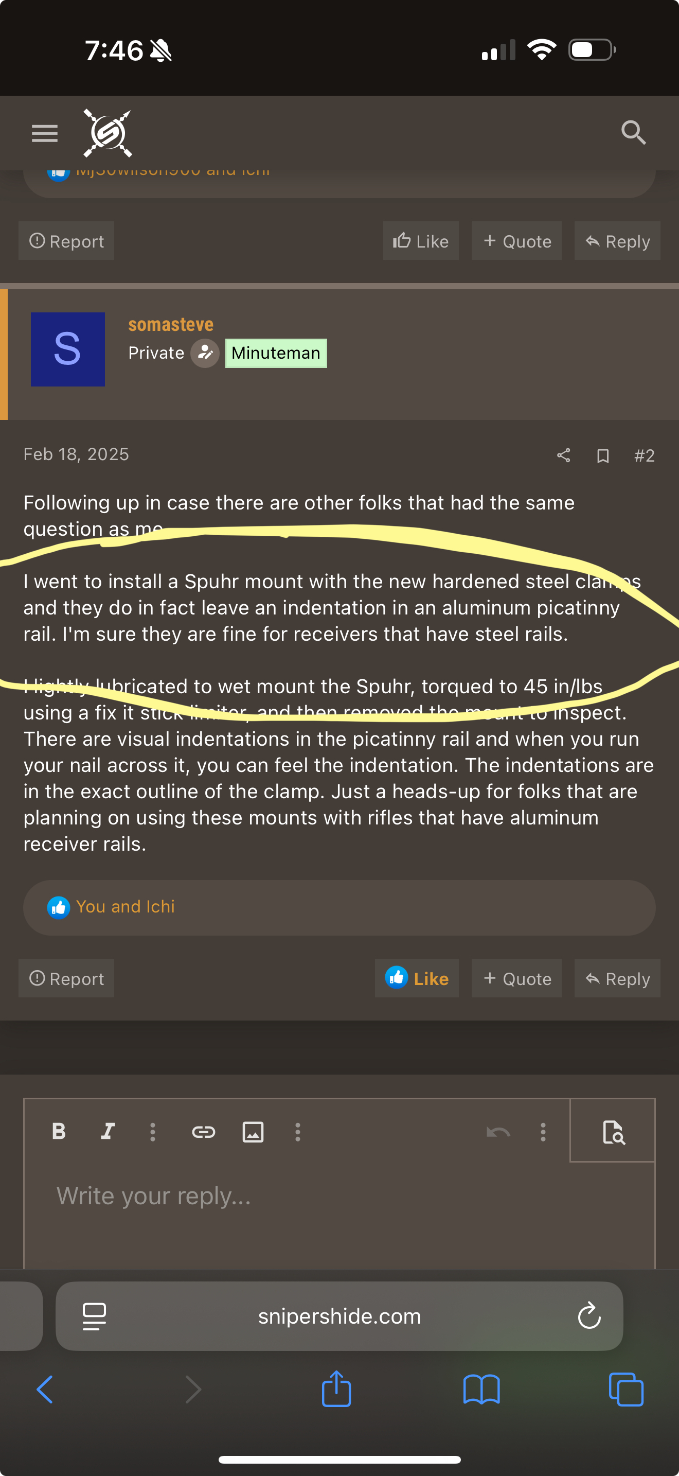

Somebody on the Hide mentioned they actually oil the picatinny interfaces so the mount can “settle in” with less chance of cracking.
Yep, this is their recommendation if memory serves. Other manufacturers make mention that “rails” vary dimensionally from one manufacturer to another. I use a damp Q-tip of rem oil down each side.
Hmm.
Looks like the “solution” damages your rail
Hmm.
I feel like this should be expected clamping steel on aluminum, but not great
