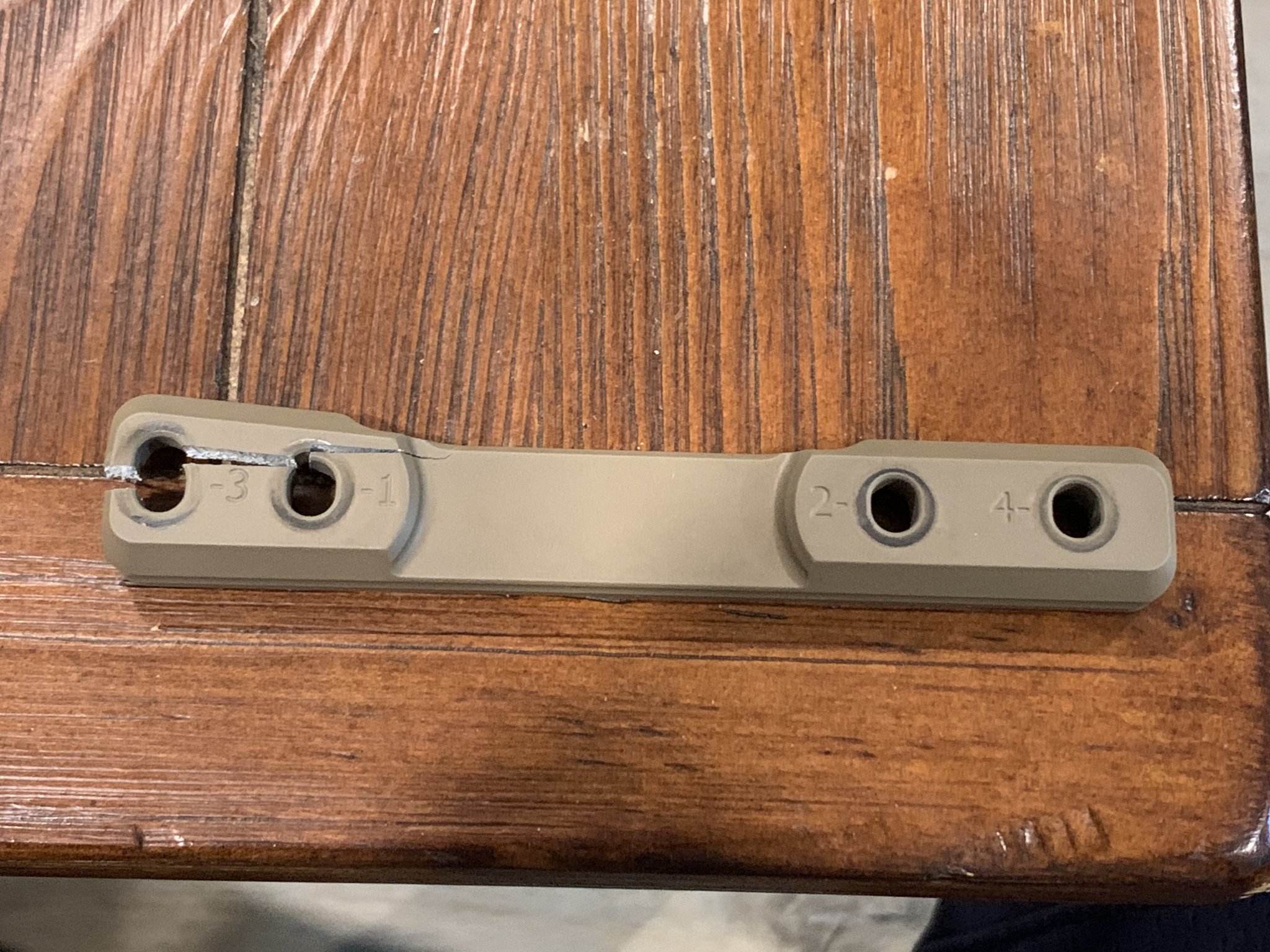

What about that cracking side rail including the new redesigned ones ?

Yet I’ve never seen thinner sculpted NF mounts crack like that. It’s a design flaw. Whether that be a bad material or hardness call out or a designed in stressor causing cracking under certain conditions. It’s pretty consistent in all the pictures I’ve seen posted with cracked Spuhr mounts.

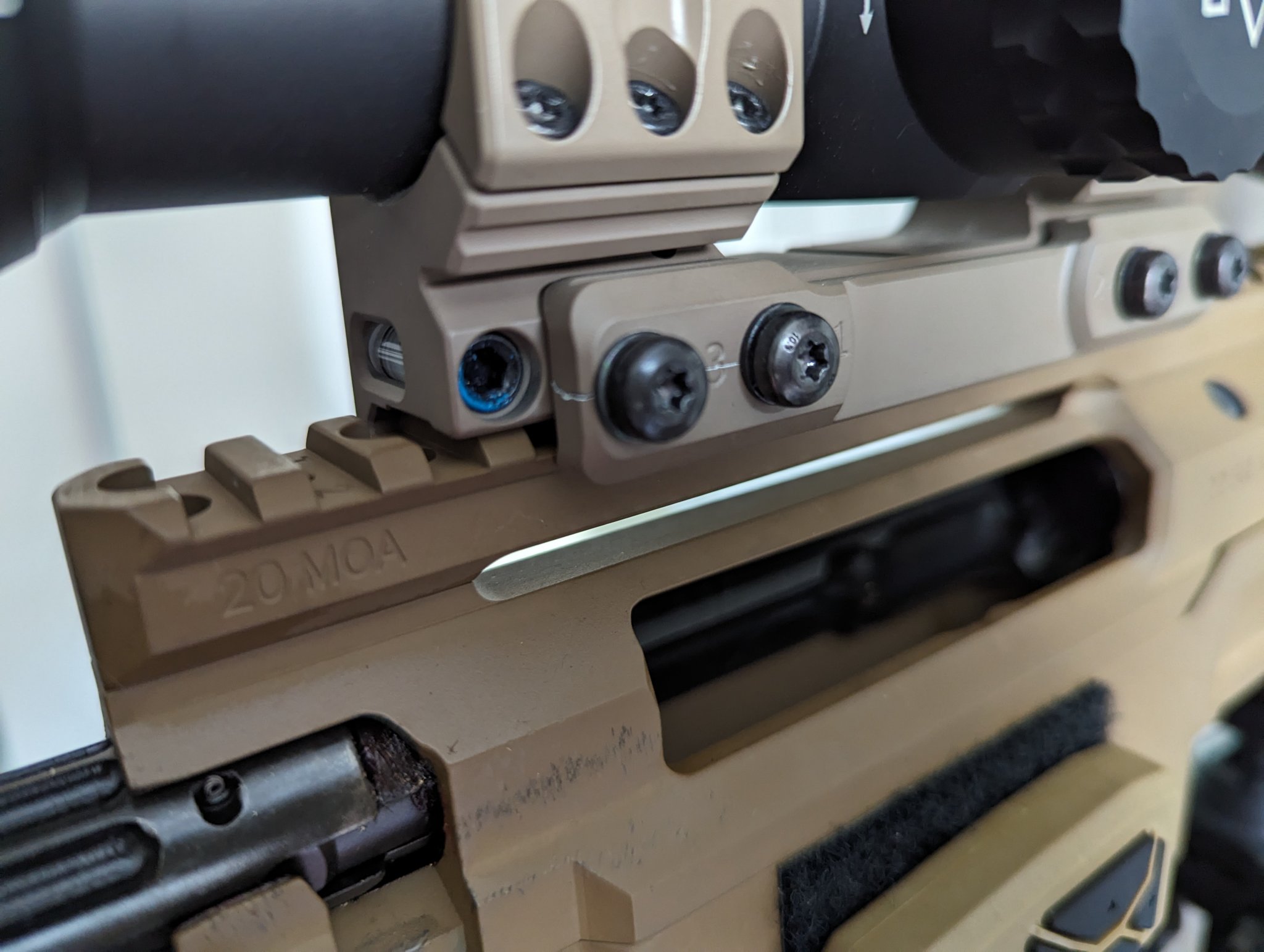

just cracked mine……
not sure what to think honestly, was on my gun for the past few years. took it off to put on a new stock, went to remount and CRACK. didn’t do anything different from the first time. 45 in lb fix it stick.
went 15, 25, then 45. on 25 the #1 spot seemed to slip a little bit, thought it was kinda odd. then finally let go on 45.
not sure what to think, makes me nervous that my fix it sticks are off or something. frustrating when you pay all this money for good gear and still have issues.

just cracked mine……

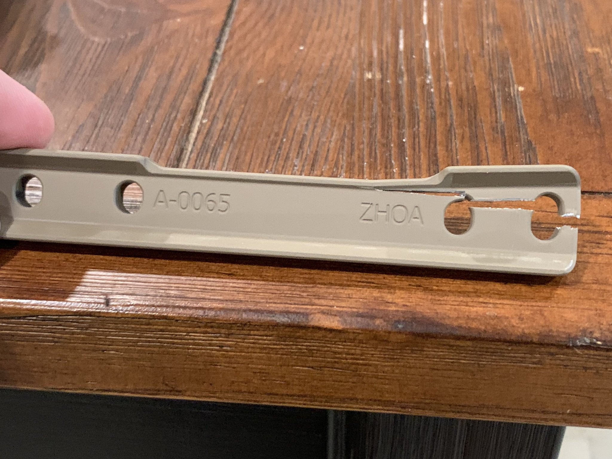

In the 2 years since that post 3 more clamp bars cracked while the rifles were sitting in the safe, for a total of 5 cracked clamp bars out of 11 Spuhr mounts… that’s a 45% failure rate. And before anyone asks, no the fasteners were not lubed or loctited which would alter the final torque/stretch values, and yes, my somewhat expensive Mountz torque driver that I use to install scopes gets checked and calibrated several times a year in our calibration lab at work so they were never overtorqued because of an installation tool problem.
After the 5th clamp bar failed and was replaced under warranty (thanks Mile High!) I said enough and there are no more Spuhrs in my safe.
My hunch is the failures are a combination of material/process variability coupled with a bit too much filleting and chamfering done in the solid modeling program during the design phase for the sake of cool looks, and there’s not enough margin remaining in the critical high stress areas if the machine shop gets a batch of material that isn’t 100% up to spec or the machining was done on the thinner side of tolerances.
Also of note, you should not have a design where 2 features on the same part are competing to center that part (the ring cap tries to center itself on the scope tube which should be the primary constraint to maintain even pressure on the scope tube, but then when you snug the ring cap screws the flathead ring cap fasteners also try to pull the cap so the conical heads on the screws are concentric with the countersinks in the ring caps-- so if things aren’t machined 100% perfectly those competing constraining features are going to try to pull the cap in different directions and induce additional stresses on the scope tube, cap, or impart bending loads on the fasteners.)

just cracked mine……
There's a thread somewhere that evaluates the different torque wrenches and limiters and how precise they are.
That said, a mount should not be that intolerant. That's a design and/or manufacturing flaw.

Not being a smartass, but from my perspective the biggest issue is that they keep breaking?
Having only the pictures of cracked parts on this thread to go by, I think that if I still worked in the aluminum machining arena, I’d want to have some tests done in the alloy in those parts. At least a couple of them look like heavy grain structure or even like cast/precast aluminum.
I did a bit of work developing precast parts for automotive HVAC connections. Much testing and modeling analysis is performed on the various iterations of a design. Being the development group, we saw plenty of failures as we tested to failure.
I’m not casting aspersions as I’ve not seen the failed parts in person, but I would want to test and also polish for micro grain structure analysis. Something is not right. It might even be a combination of things. The multiple stressors mentioned above possibly being one of them.

I would, but no longer have access to all the good equipment for sectioning, polishing and microscope analysis since I retired during the Covid Wars.

Whelp I joined the broken clamp bar club. I've owned plenty of Spuhr mounts and hadn't had issues before. And I stuck with them because the amount of accessories that can bolt on, diving boards of all sizes, Send It level mounts etc. Considering replacing this with a badger.
Over rated is a fair assessment, it's at a premium price and has had a known flaw for years with minimal effort put in to fix it. Hmm, maybe use steel or a steel insert for this clamp bar, easy fix.
I mounted this last summer, I'd guess it's broken in the last month or so. The last screw was wiggling out but it still shot ok last week.

Yes, they will. But the problem I see is that there has been no identification, nor revision to fix the problem that I'm aware of...so you're just going to get another part that will fail like the last one? I'm not stating that as a fact, but rather asking how will it be any different?

I called them and emailed them as they requested. I'm sure they will send out a new clamp bar. And I'm the meantime until the new part arrives I borrowed another clamp bar off an unused Spuhr.
They upgraded the clamp bar but they crack too
Maybe they need to use a 2 piece bar like zco
