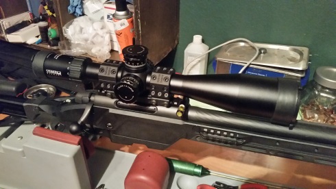

I did this setup Spuhr mount is nice but I did not pay attention to the fact that the parallax knob will be to big therefore the leveling option is useless in my setup. Only way is to go with the higher mount but this will result in loosing vertical adjustment and I do not think this is worth it to level the scope is nothing that need to be done every day. Bubble is way to small to be useful in the field. I used this mount : SP-4601

I suspect the 4001 will be the go. I've got a 4001 and 4002 to try this week for my March 5-40x56 on a Tikka T3 (Roedale chassis with 20MOA rail) and the advice I have received suggests that the 4001 will be the better option as far as height is concerned.
