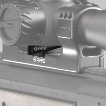

TheOE800 In the first picture you can see a slight angle above the RRS logo on the 1.26" installed. That is the redesign for the leveler so you don't need the square base when using our mount. Plus our new leveler wedge is a lot wider so it will not tip easy since you aren't using the base. About half the wedges are in the machine the other half is at anodizing.

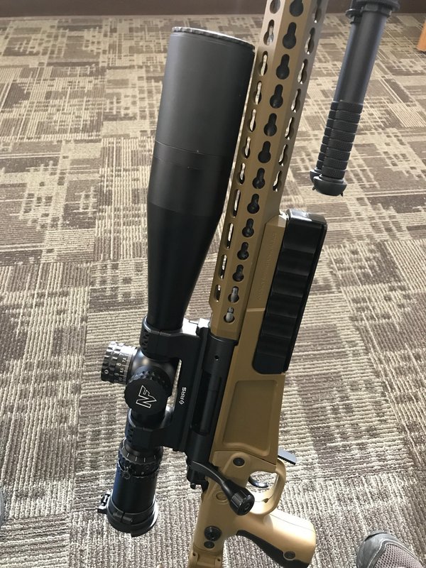

EDDK9 this is a picture of our 1.26" 20MOA with a 56mm ATACR on our AX AICS chassis. When I put the caps on they can touch, will be a little better with the 0 MOA.

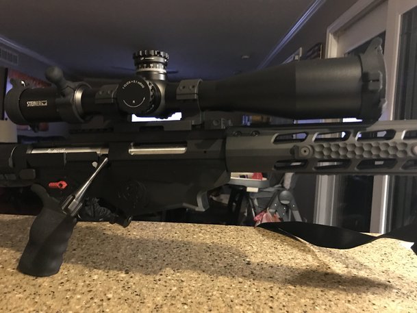

Does the leveler system work with an optic such as a Steiner M? The knobs are visually larger than most and don't leave much room on both sides.
The leveler should work on any scope or mount. If using our 1.5" mount you will use the base and leveler wedge. If using our base and wedge with separate rings you put in the two set screws that will firmly hold it against the picatinny and use the slot in the base to guide it level. On the new rings, same operation minus using the base.
http://soar.reallyrightstuff.com/Scope-Ring-Leveler

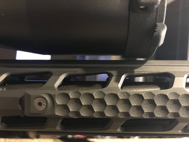

Understood. The problem would lie with the 1.26" 0MOA mount and the knobs covering the base on the Steiner M. I'll take some pics later and post them.
