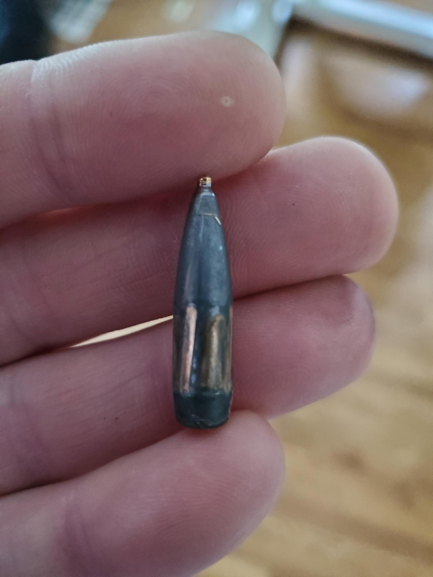

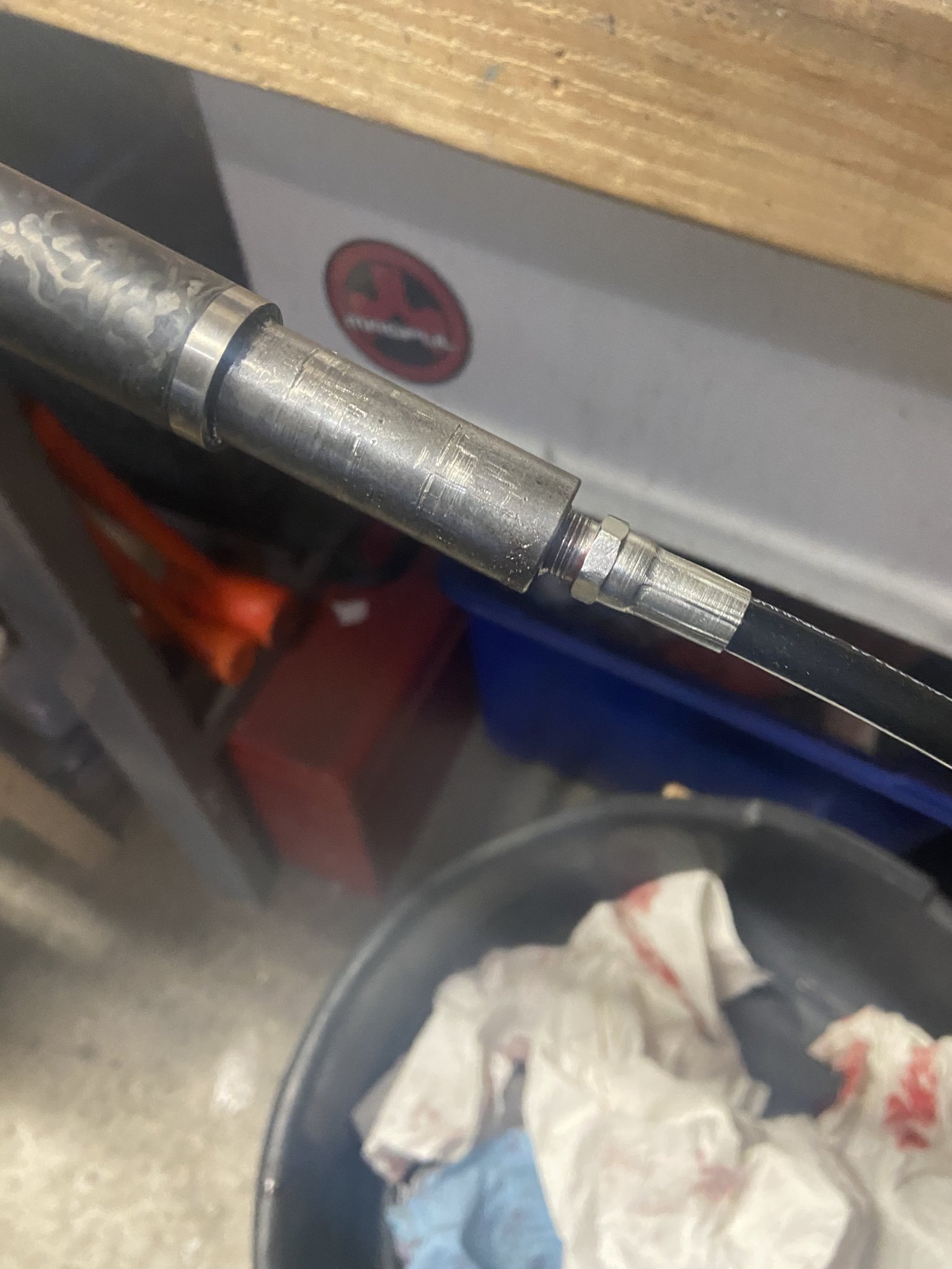

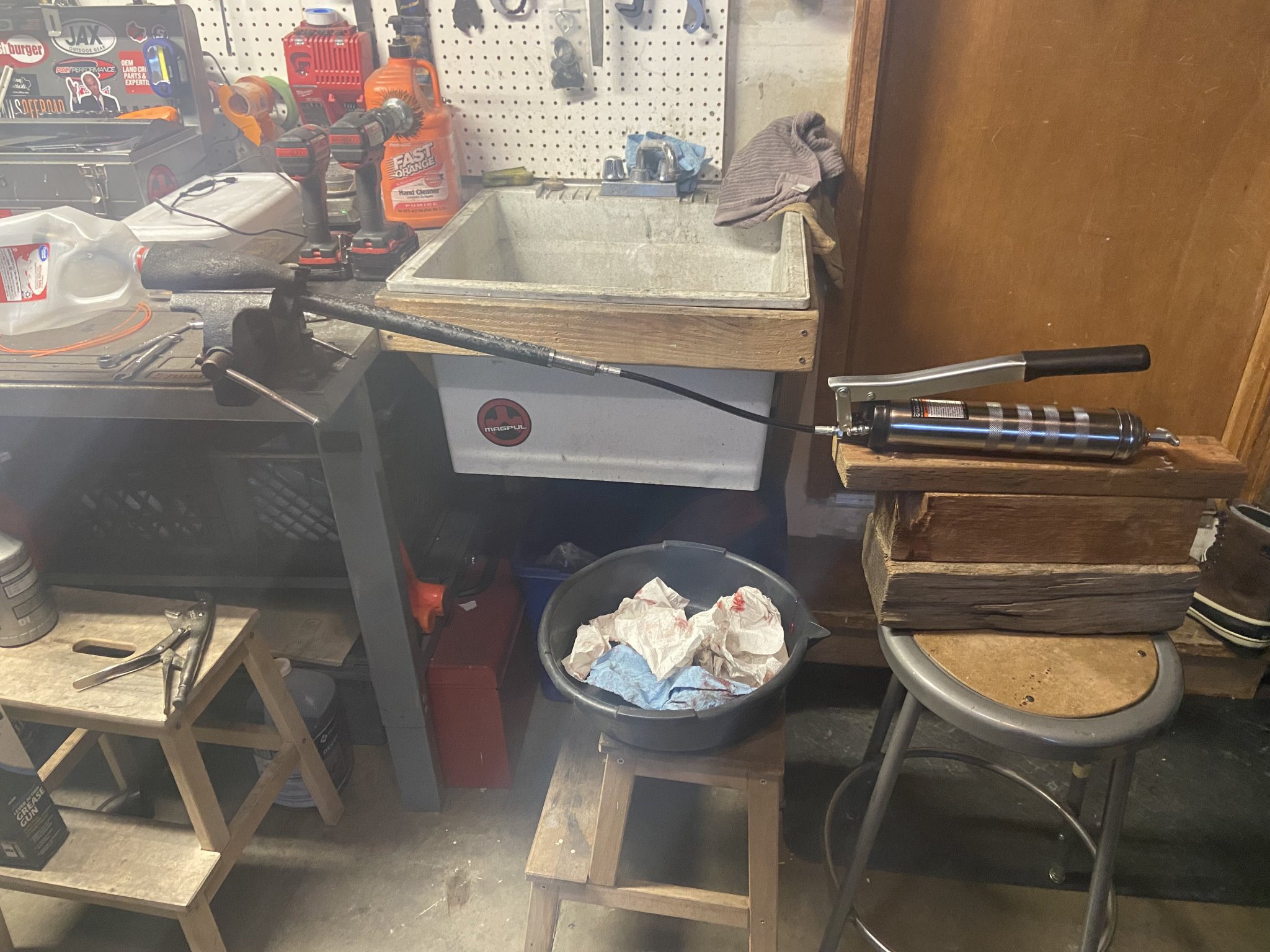

Success!!! Drilled out the back of the bullet very carefully using a collet made out of thick tape. We purged the grease gun of air again and gave it 3 quick pumps and the lead core went shooting across the room! LOL.
I fuking said point it 45deg down angle into a bucket, with some rags in it !! Catches the grease and the stuck bit of lead.
The weird shadow or smudge in your barrel is lead smear. DONT scub the shit out of it. Just a "normal" clean, then you are good to go.
Often relieving the pressure off the core works, which is why you DONT drill it close to size, incase you slip and scratch the rifling.
Well done. Dont do it again

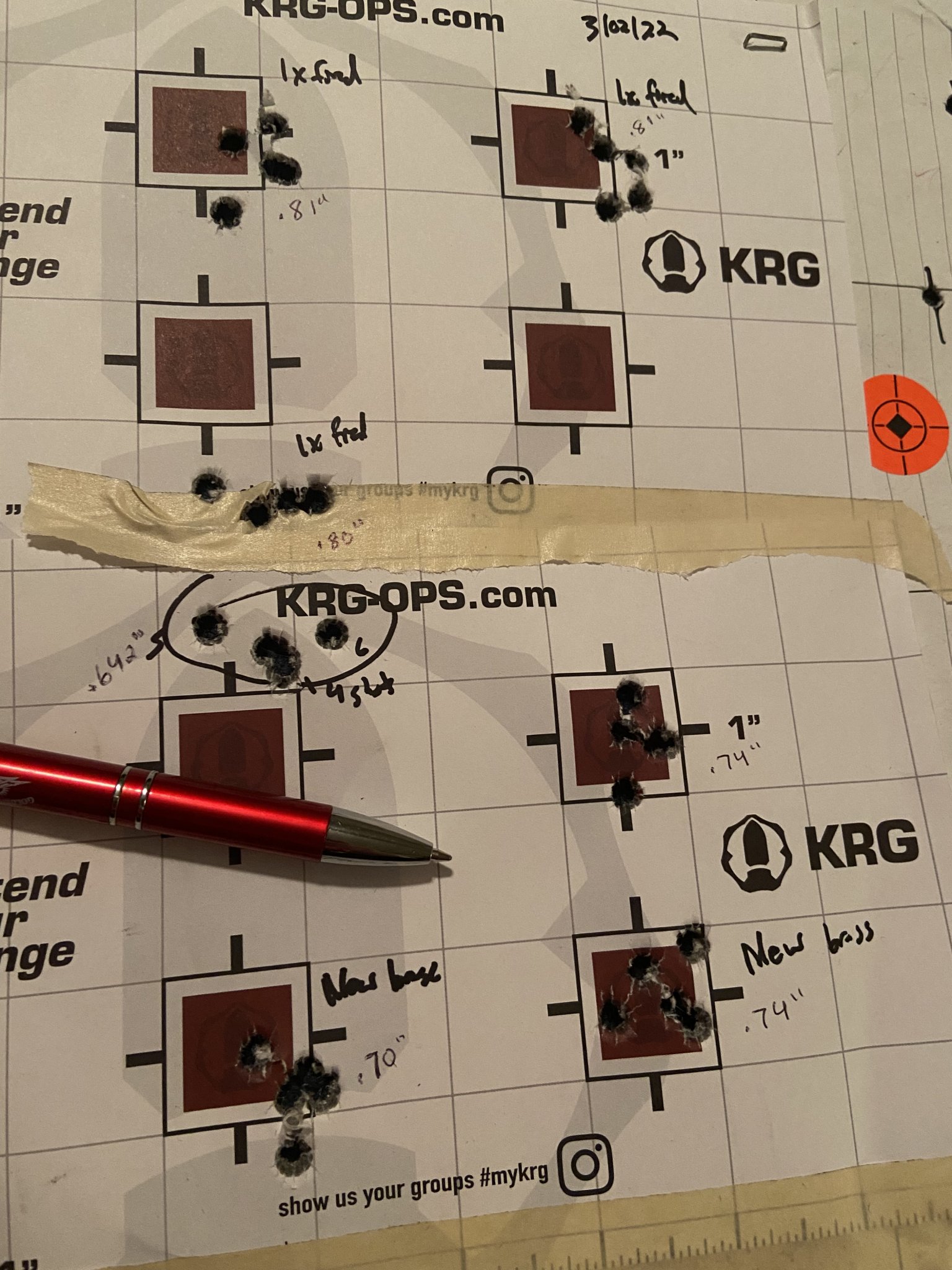

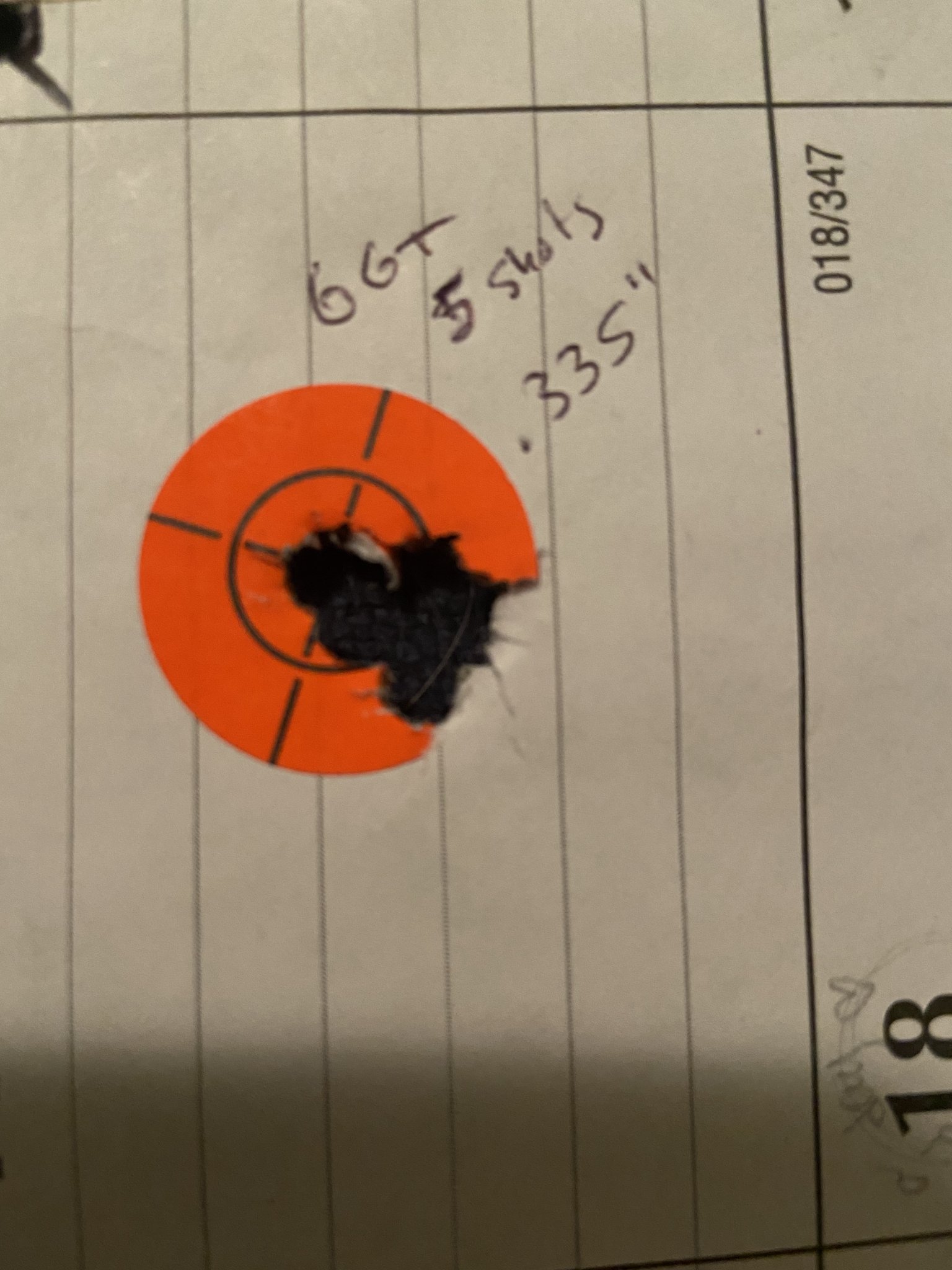

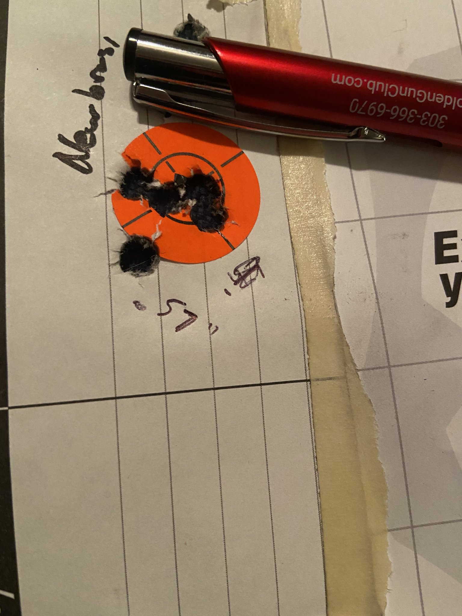

Got out to shoot it and it’s showing promise but not quite as tight as I would like. 5 shot groups between .57”-.81” adjusted for bullet diameter (100 yards). So it’s averaging about 3/4 moa without having finalized load development. I’m glad the barrel’s not ruined! Hopefully I can get it down to 1/2 moa with decent SD’s by a little more tweaking. Not bad for a 12 lb Hunter I suppose!
View attachment 7819465View attachment 7819466
Have you done any seating depth work with it yet?
Not much, mostly powder. My earlier (shorter) rounds actually showed more promise before I stuck the bullet, jumping it might tighten things up a bit. I haven’t messed with seating depth tests much to be honest, have you guys had good luck with those?
Oh yeah, it's a huge difference. You can either do big jumps in 4 groups or do a ladder with .005 per or .010 per and then dial it in further.
I literally had a note in my data book to do a seating depth test next, lol. I’ll probably try in .003 increments as EC suggests. Will report back here if anyone’s interested.
I’m an idiot. Let’s just get that out of the way first. Doing a ladder test on a 6.5 Creedmoor proof carbon barrel, I didn’t powder the case. Primer shot bullet into lands about an inch and a half from the back of the breach, including chamber. Bullet is a 140 ELD-M.
1. Tried tapping, then ramming it out with a cleaning rod. No luck.
2. Tried a steel rod next. No dice. Really hammered on it (idiot).
3. Tried tight fitting brass rod from the hardware store after soaking in penetrating oil. No luck.
4. Rigged a 5/8-24 fitting into threaded muzzle in an attempt to use hydraulic pressure and blow out with a grease gun. Ruptured 2 grease gun tubes, hasn’t moved.
I’m guessing with the hammering from the muzzle end the bullet has expanded, making it even more tightly stuck.
Any ideas or a smith that could take this on before I send it to PROOF and beg for mercy? This barrel was just starting to show promise and I’ll be really bummed to lose it. View attachment 7816485View attachment 7816486

Have or know anybody with a powerful air compressor? Instead of using the grease gun get a male air adapter for the hose connected and adapt it to the 5/8-24. Fill the void with water and then hit it with air. You need a lot of PSI for this to work. But drilling out the center may be easier if you have a drill press.
Maybe try putting some CLR down the muzzle. Might be able to eat enough jacket to rod it out?
I foresee this approach coming nearer expelling the bullet with a LOT of velocity as opposed to a slow push IMO. YMMV

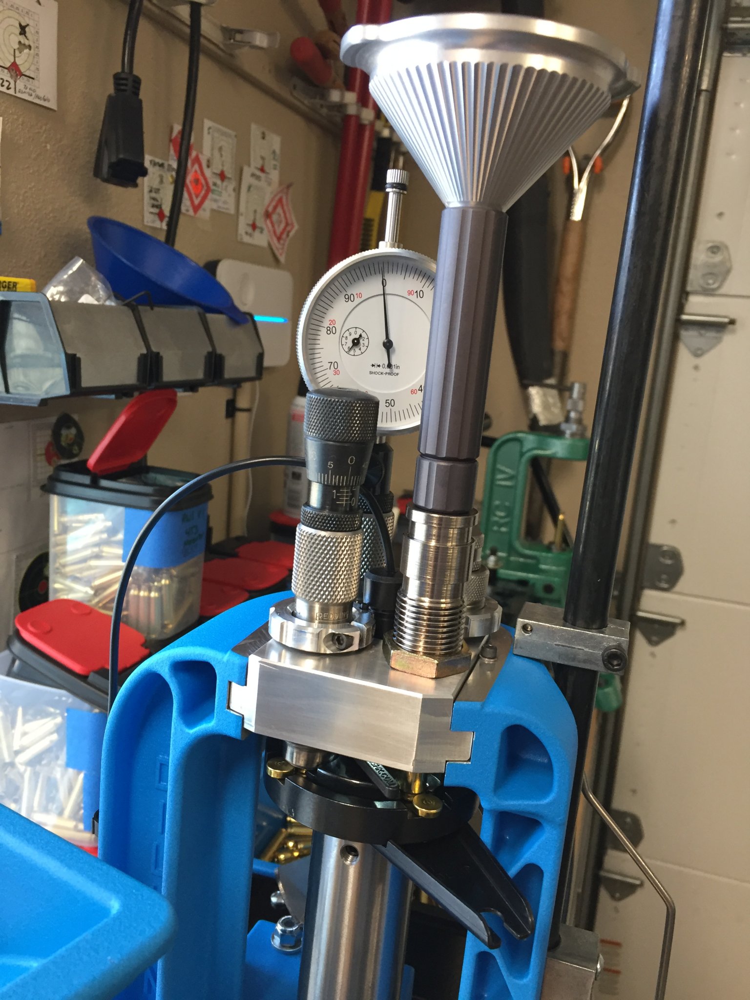

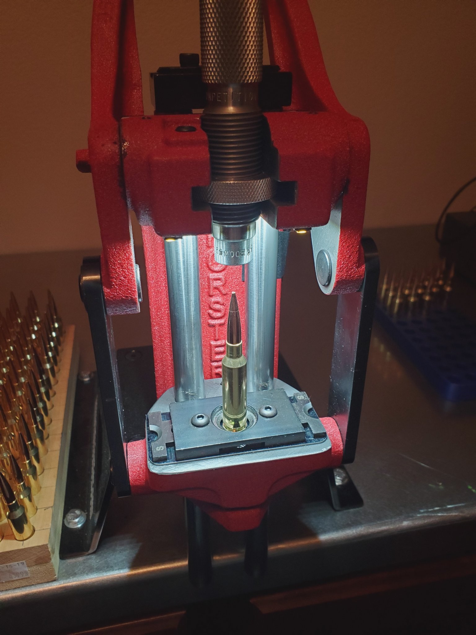

For anyone interested, I think I figured out how this happened.
I use the A419 funnel system on my Dillon 550. Auto Throw into funnel at station two, bullet in station 3, similar to this photo. H4350 bridged, only dropped a few kernels of powder I'm guessing and so it was more than just a primer that ignited when I fired. That's why the bullet was stuck so good, it was more than a primer. I caught another one that didn't get charged because of this issue and am considering how to address this because it's obviously not good.
