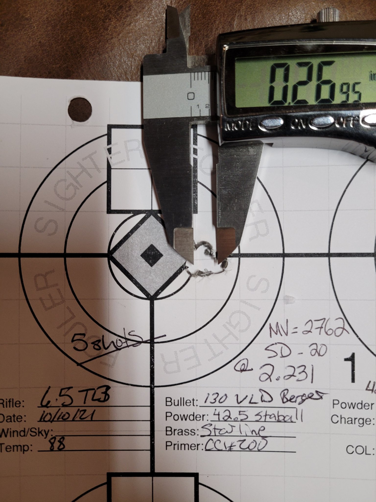

Well, true to form the 130gr Berger vld grouped awesome when touching the lands. Here's the card and info.
The 153.5 is going to be a bigger challenge. I only did a pressure test plus 5 rounds at what powder charge I was shooting the others at. Well I got a little swipe at 42.5gr with the 153.5 bullets.... the speed I could shoot them at where I I have any pressure wasn't quite what I wanted but was acceptable and would still be super sonics at 1500, but I may have to change powders to get where I want to be with that bullet.

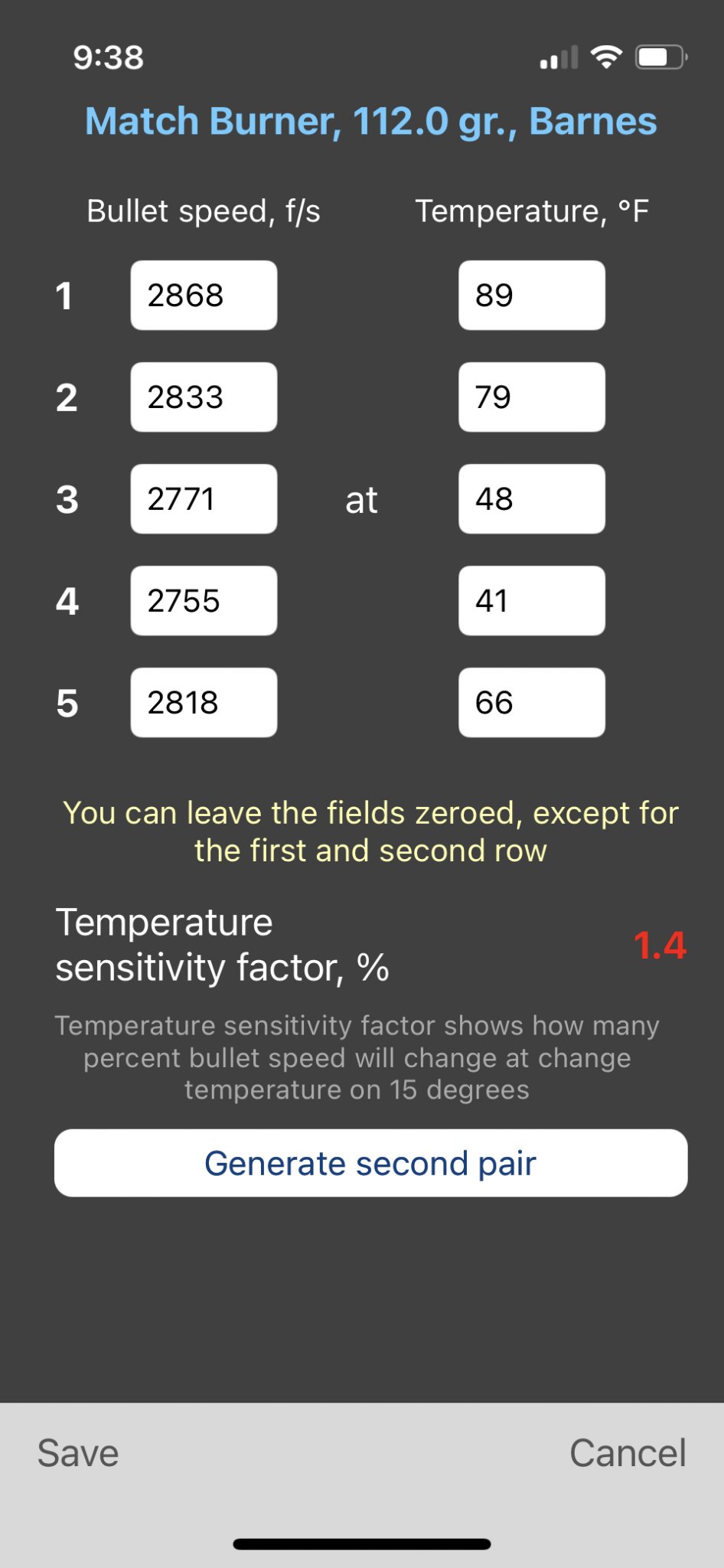

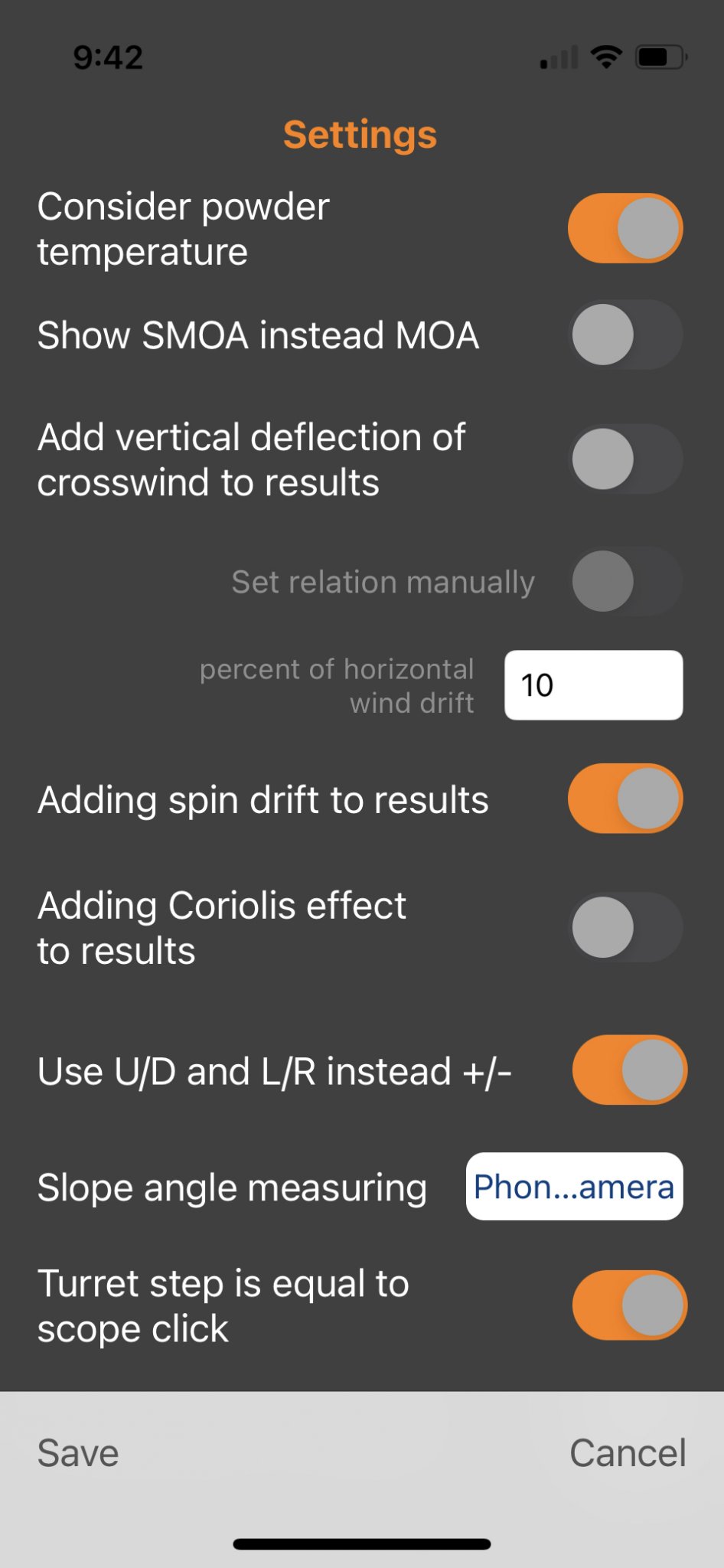

What value are you using for Temp sensitivity for StaBall? I'm about to shoot my 1st ladder with it. 41.3 to 44.0 grs with COL of 2.820.
Oops. I've been running Strelok forever and it appears that parameter is either gone or now I can't find it. Just a checkbox to turn on powder temp.
It's under MV:
But I was talking about the parameter at the top of the settings page "Consider Powder Temperature" (which is what you think the ambient temp of your ammo is sitting in the box or in the mag, it defaults to the current temp so if it's cold like 32degF or hot at 90degF, it considers/includes that):
