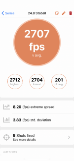

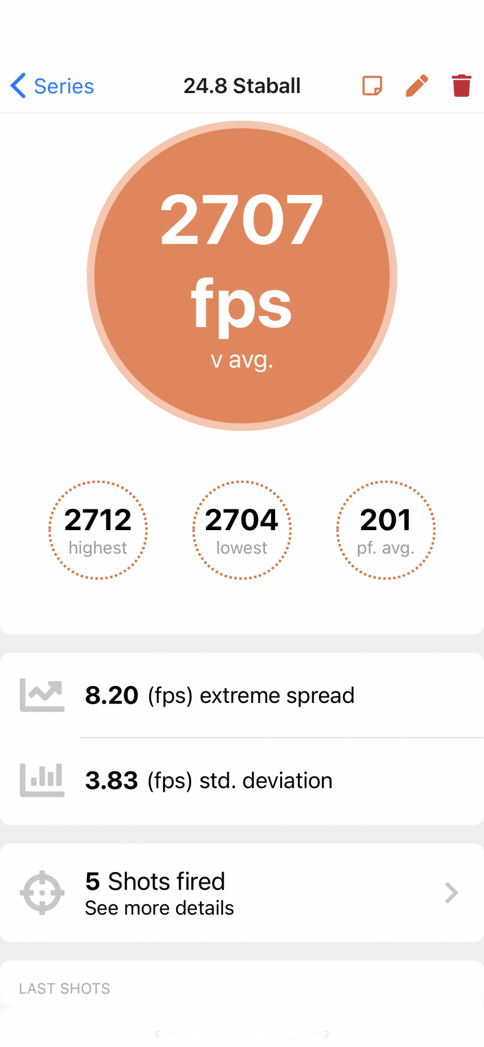

To add some additional data points, I did some initial load testing with StaBall today. Rifle is an 18" CLE Wylde rifle gas MK12, OCM5 supressor, LC uniformed brass. Temp was 50°. Five round groups as follows:
25.0 grains:
2702 fps, SD of 10
.55 moa
25.1 grains:
2721 fps, SD of 8
.80 moa
25.2 grains:
2721 fps, SD of 11
.80 moa
25.3 grains:
2716 fps, SD of 18
.58 moa
25.4 grains:
2740 fps, SD of 27
1.39 moa
No pressure signs on any of the charges. I did notice when I was loading them that 25.4 grains was starting to crunch, which is probably why I was getting erratic velocity at that charge weight. Looks like I'll focus some more development around 25.2 and possibly play with seating depth a bit.
The groups all opened up some on my second go-round when I pulled the magnetospeed off the gun, but that may have been me.
Overall the powder seems promising. It meters nicely out of my Uniflow, but is filthy compared to 8208xbr, so I'm not sure that it's converted me. Nice that it's at least available.

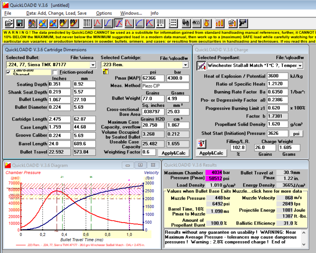

Seems like 25.8-26.3 is the sweet spot for Staball match on a long throated Rem Match chamber with a bolt gun (62K PSI)
Should give about 2780FPS out of a 20in near max pressure. I get about 2880 out of my 26in with varget and 80.5.

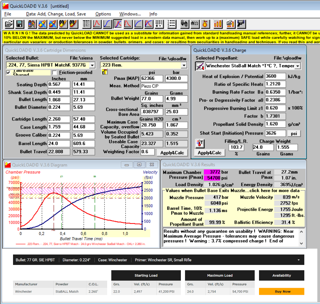

26.5gr staball match, LC 223 brass (not 556), CCI 450, 77tmk at 2.475, ARC Nuke 26in -> 2990 FPS. No pressure at 44F outside air temp. QL shows that's a 61K PSI load.
