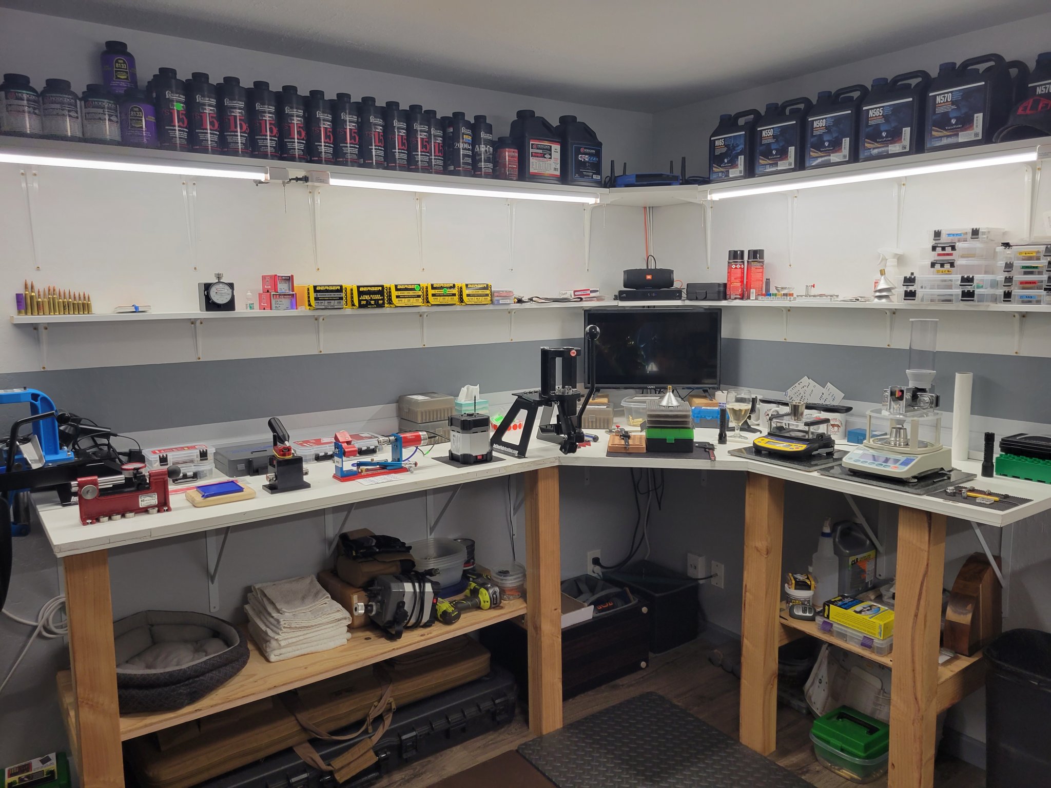

Static is making me crazy!!!
So untill you get personal grounding straps, antistatic mat and ozone machine?

I have got to figure out a way to keep static from killing my production with my V3. I have it on an antistatic Matt, and have the little ground wire. I can't get through charging 25 cases without static making me stop and messing up the scale. There's got to be a way to do this???
I have an anti-static pad under my Chargemaster and never have any problems. The only small problem I ever have is a few grains clinging to walls of powder tank when emptying out. An artist's paintbrush knocks those right down.
Yeah, I have the anti static mat that's in the picture with the little grounding wire but it didn't seem to do much. However, I got a bad ass power cleaner strip and if I take off my shoes and socks it's all good now. No more problem. Not sure if it's the shoes and socks or the power cleaner or both, and I probably won't ever attempt to find out honestly.... just call me the barefoot loader from now on....
I'm not all that far from my ground rod... I could ground to it with a 10ga wire and probably get a decent ground. I don't know how good of a ground I've really got doing it via a plug

Well boys.... the barefootloader now just has static with cold feet.... this makes it awful to load. Let me tell you guys what I did and maybe some smart person on here can help me. I'm willing to go to some extremes at this point. This sux
I tried switching to the standard cover instead of the 419 clear lid.
I have a really nice power cleaner strip
I have an anti static mat with the leads that I've tried clipping to various items including the Matt, the scale, the dropper , the trickler. ..
I have left my scale on full time.
I haven't sprayed any anti static stuff but have used dryer sheets to no real advantage.
It seems ok until I start loading. It almost seems like the trickler builds static or something because it work fine for 6-10 rounds and then starts creeping in. It dissipates quickly, then not so quickly, then it doesn't go away at all. If I leave it alone and go sit down it will go away and drop. I'm at a total loss....
Would putting it all in steel and that sitting on the ground work? I could weld something up if it would...

Yeah that's what I did with the antistatic mat leads, including the wrist strap. Seems to have zero effect if I wear it or not. I tried putting the wrist strap on the glass powder stack and on the trckler too
Reactions: Mike Islander
I do remember a few folks complaining that the Area419 scale tray would cause drift. When they switched back to the stock tray the issue went away. Are you using the ground screw on the back of the scale to ground it? Also try installing the wind screens to see if that makes any difference.
I clipped on to a metal tab but not I'm not using the ground screw. I would think that if it were the tray it would do it all the time though right? I will try getting the wire on that ground screw though, I didn't see one but I didn't look really well either

Yeah mine will sit there on zero too but after I start running it, the static starts at some point
On you drift and inaccuracy problem with electronic scale . Just a thought . Are you sure it's static charge ???
do have LED light setup illuminating your reload bench ???
I Removed my ( 2 ) 4 ft. LED tubes . and put back in the old ft. florescent tubes over my reload bench . Those 4 ft. LED light tubes give off interference , electromagnetic frequency .

I don't but I want to put led tape light up but this static issue has stopped me from doing anything else. It basically eliminates my V3 from anything more than 5 or 10 rounds most of the time. I feel pretty sure it is in fact static doing it because of how it behaves and seeing my ball powder on the side of the glass tube.
Maybe there is a min distance for that. ?? I have nothing but LEDs in my shop and have no issues. 4 long strips and one large center dome. But they are all a few feet above the bench.

I got some solid copper wire and tied it to the grounding nut on the back of the scale, then clipped on to that with my ground wire clip, which is plugged into the common ground on my plug. This plug is also very close to the ground rod.
Your Static problem is just crazy weird . Is it possible ? the unit can be making, and giving to itself .
Yes I think it is possible, but it seems like it's the v3 doing it, not the scale. The more it runs, the more static that is acquired on my scale. Of course I don't actually know, but it sure seems that way. I'm going to just run a bunch of loads now and track it and just dump the powder in a container vs dumping it back into the hopper, in case that adds to the static
