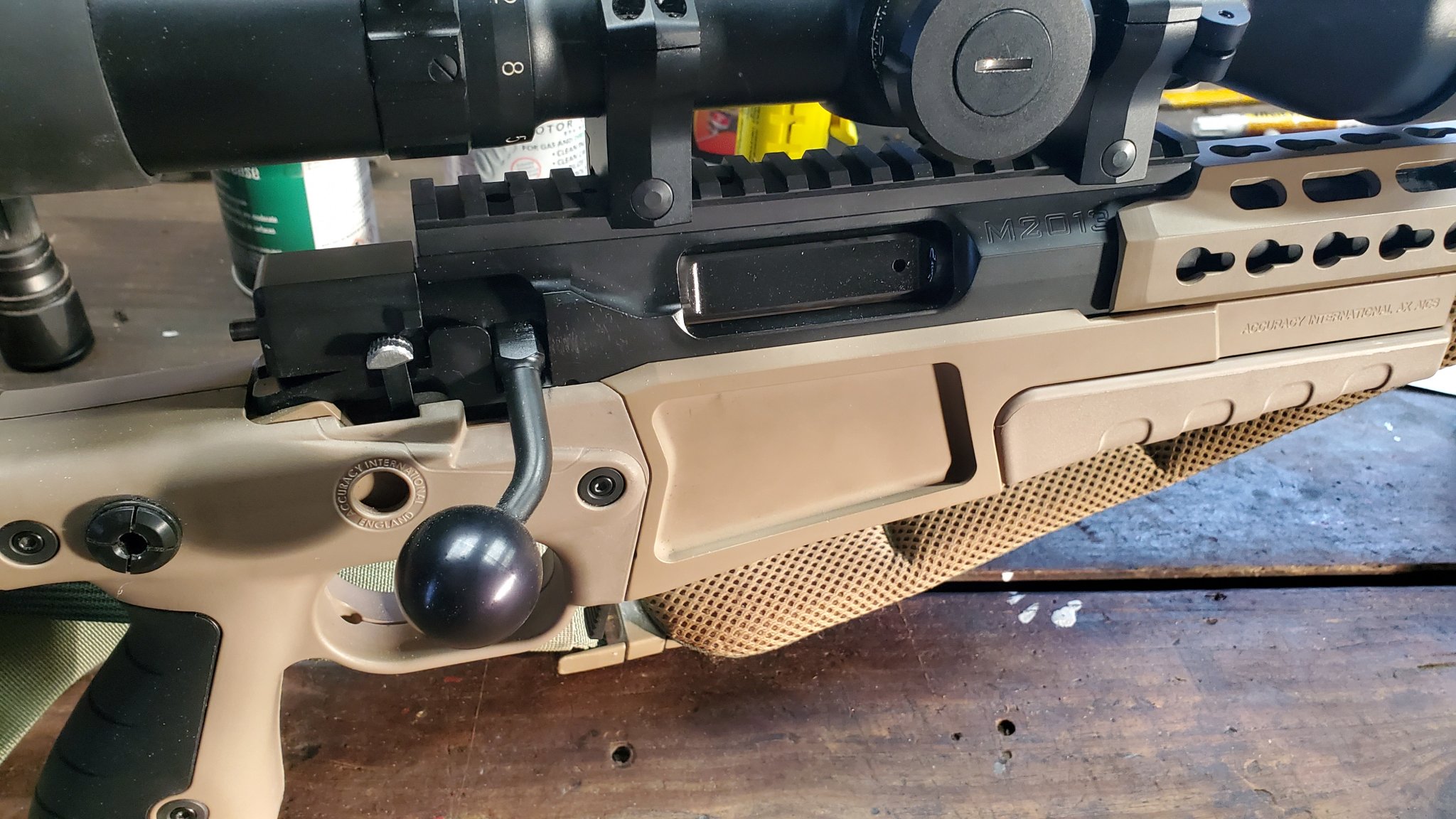

I know im performing necromancy on this thread, but has anyone had both the Sterk and Anarchy swept bolt handles in hand? I'm very curious what the main differences are, like if one sticks out further, is more swept back, etc.
(Still new to the forum, so if asking this on an old thread is bad juju, I apologize)
