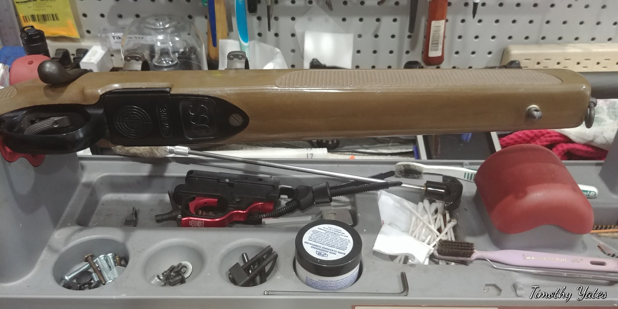

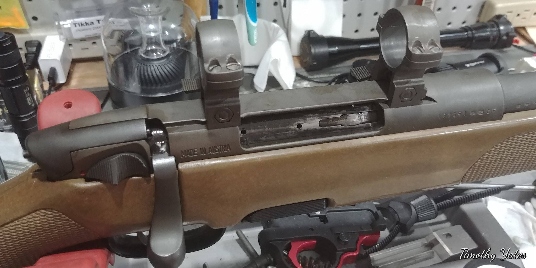

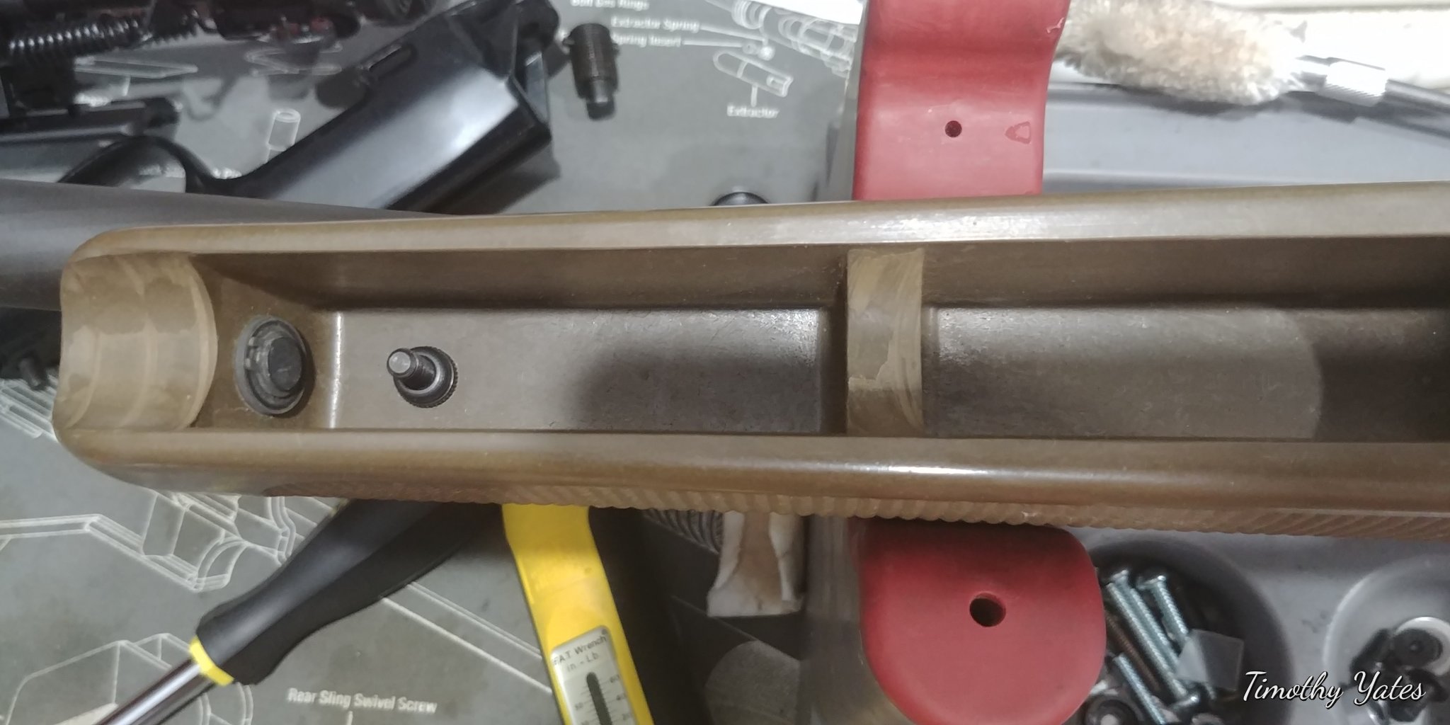

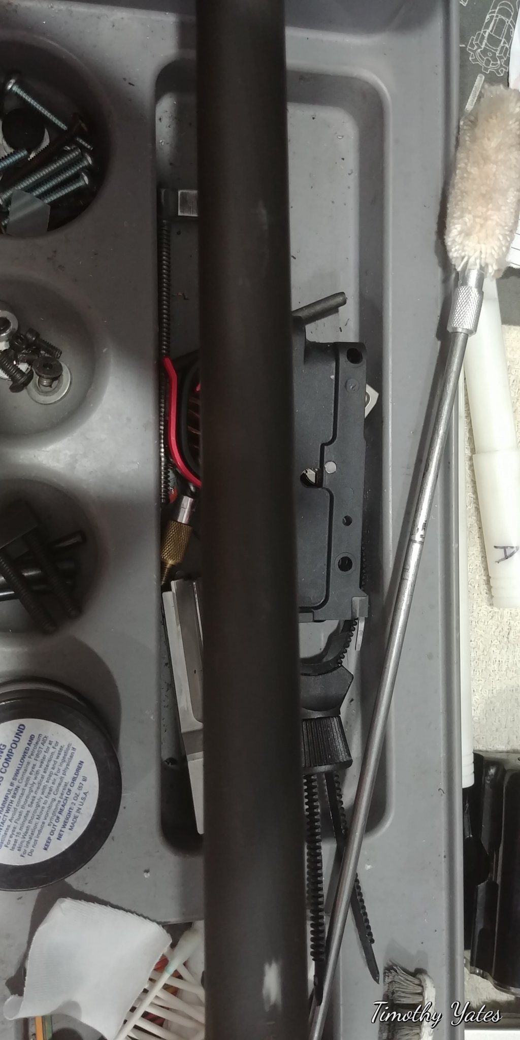

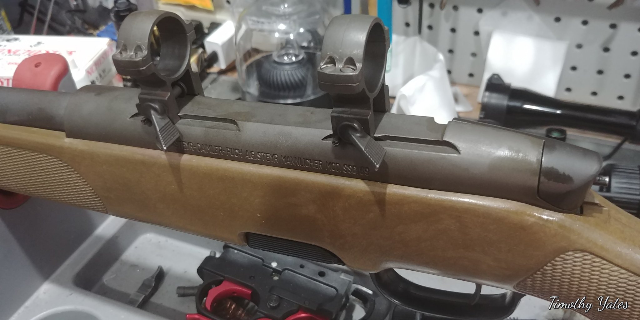

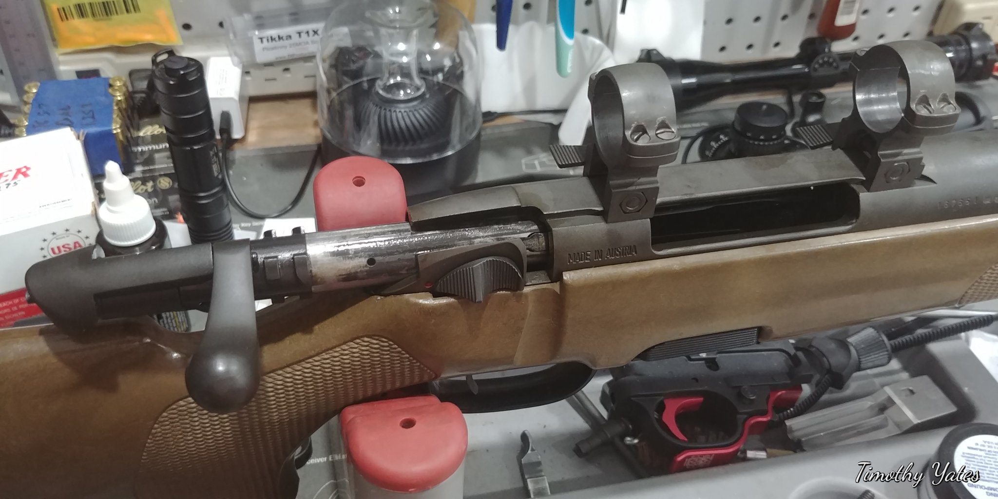

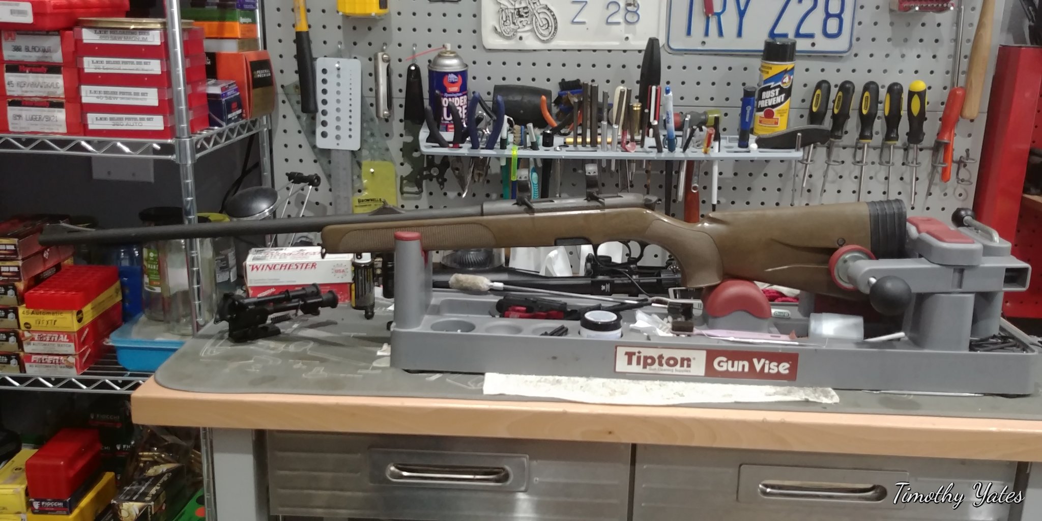

Here are photos of mine. By the evidence shown on the stock and barrel, looks like at one time the barrel was touching the stock at least in two places; it is floated now though. Mine come with this bipod stud already attached, I just figured it was factory. The stock or trigger guard has no cracks anywhere that I could find. The magazine loads and feeds good. Trigger is fantastic at a consistent 1 lb 2 oz with zero creep and overtravel. The bolt is like soap in the hands slick. (bet ya never heard that one) just made it up lol. Anyway here is what I got, scope I want to use will be here tomorrow, hopefully I can get to a range soon to shoot it.You were clear. I ask because mine would be great one day and not so much the next and I wondered if sometimes I was flexing the forend into the barrel. Mine didnt come with a bipod swivel so I drilled one and eventually the stock shattered in that region. I thought maybe my stock was just old and brittle but I was probably loading it too much or maybe the factory stock just wasn ment to support a bipod on a single stud.

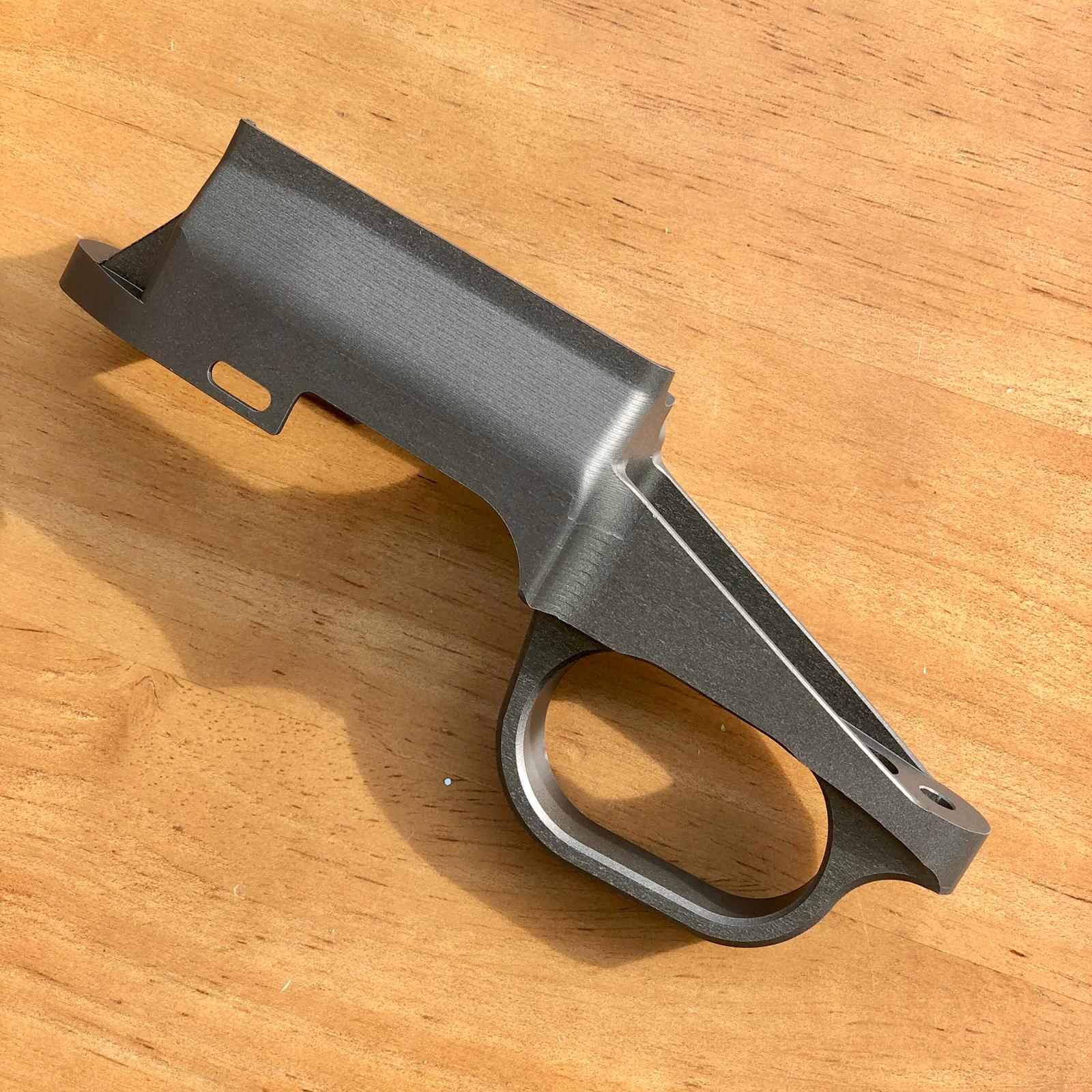

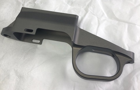

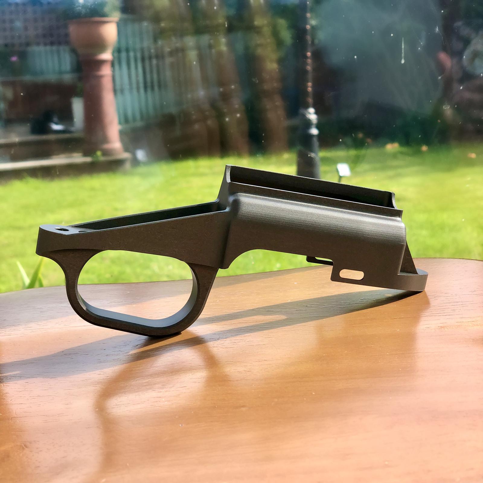

Bit of a bump but if anyone still uses the original mags in the SSG I’ve ended up having a few CNC machines to replace the original plastic housing!
They’re finished from the raw colour by vapour honing and anodising. Pic below!
How much do they cost and where can you get them?
