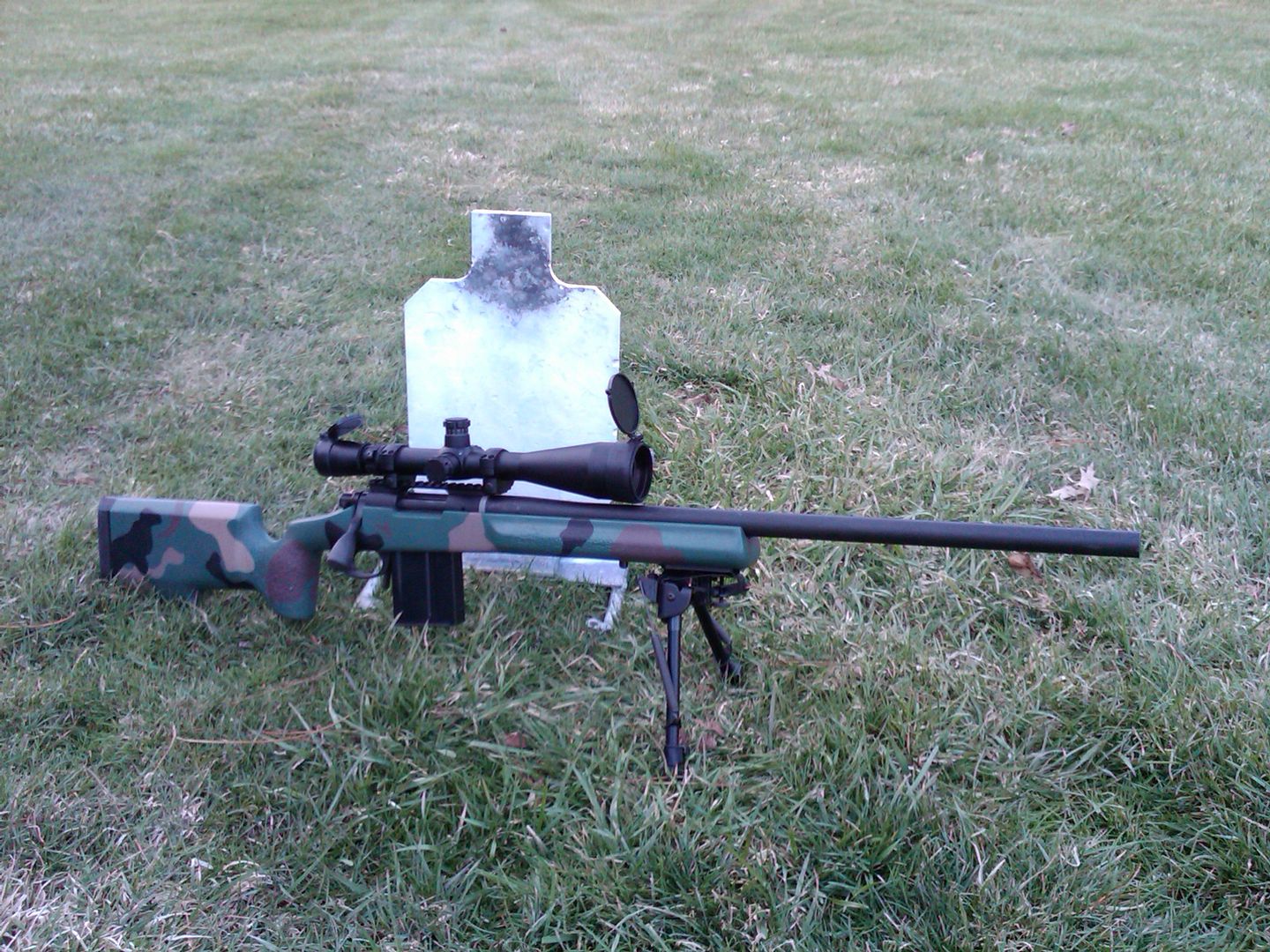

Once again Austin's (Deadly0311) expertise was very helpful today. He gave me some 308 load data not too long ago and it was spot on!!!!
155 Lapua Scenar
45.7 Gr of Re-15
regular case prep
It shot 3 shot groups into 1" to 1.10" at 300 yards today with mild wind!!!!
Head shots on this 10x17 LV Steel target were practically done in my sleep.
Austin is a great resource for this site!!!
