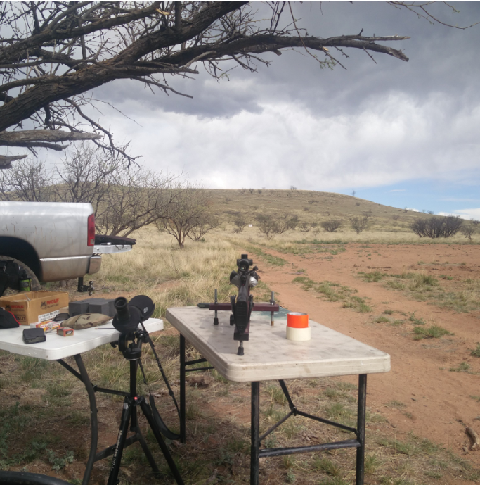

Well another shitty weather day that impacted my results. As luck had it, had to deal with a storm blowing through as I settled in to testing. Dark clouds over this project seems to be the norm!
7066836
Couple of verified data points:
  • Factory loads - My Savage B22 Compact clearly likes CCI Velocitors the best
  • My Savage B22 Compact clearly shoots the GDS HV better than the LV version
  • The Anschutz 54 does not shoot either GDS versions very well
I'm going to focus only on the HV version for the next round of testing. While I was moving around between guns and the LV vs HV, it substantiates my findings at 65 yards:

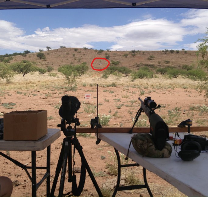

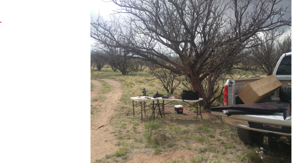

Rather than packing it up due to the bad conditions I decided to stretch things out to about 140 yards, only shooting the Savage and only shooting the HV rounds comparing them to the factory CCI Velocitors. Wind was bad in a 90 degree left to right direction clearly shown by the CCI's:

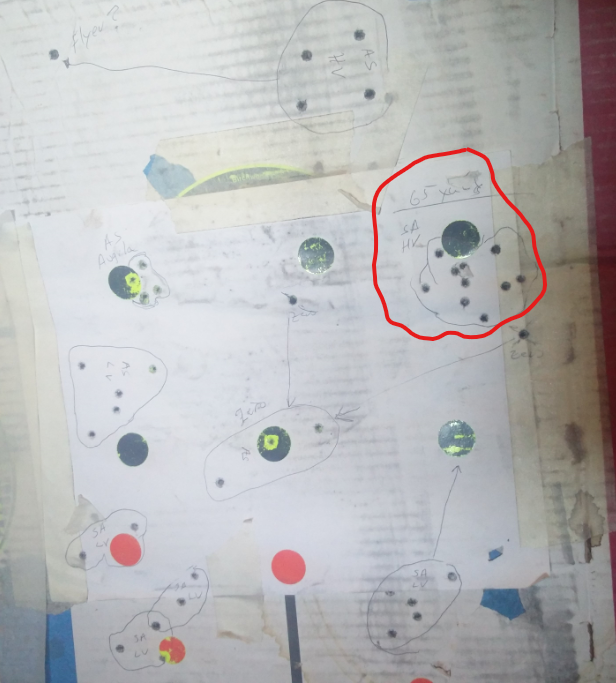

After sifting through all the initial v2 target results, grouping appears to fall into these ranges in edge-to-edge in inches:
50 to 53 yards 0.88 - 1.61
63 to 65 yards 1.70 - 2.02
100 to 118 yards 2.05 - 2.70
140 yards 6.25 (3.59 w/o flyers)
The final builds and testing of version 2a HV will commence this week. Really hoping I can get some relief from the wind next outing. The final 2a test rounds will include the following:

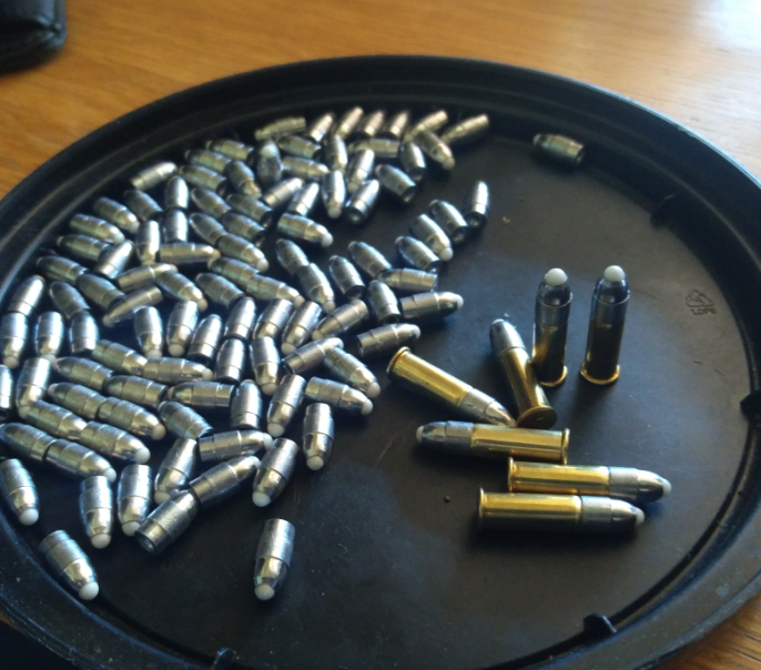

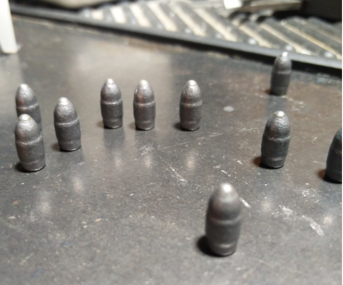

Been a while since my last update as a result of my testing screw-up early on with version 2a. Long story.....
The main issue was that pure lead, with minimal exposed sabot, did not meet the minimum penetration distance of 50 yards for soft body armor. We also wanted to caveat the body armor test results based on some (not all) of real world variables. Some pictures and explanations included below. Version 2a did however pass penetration tests on sloped windshield glass and car doors tests but we wanted to retain more mass after going through car doors for example; another contributing factor for the change.
What we now have is Version 2b - a 33.8 to 34.0 grain alloy bullet with greater sabot exposure:

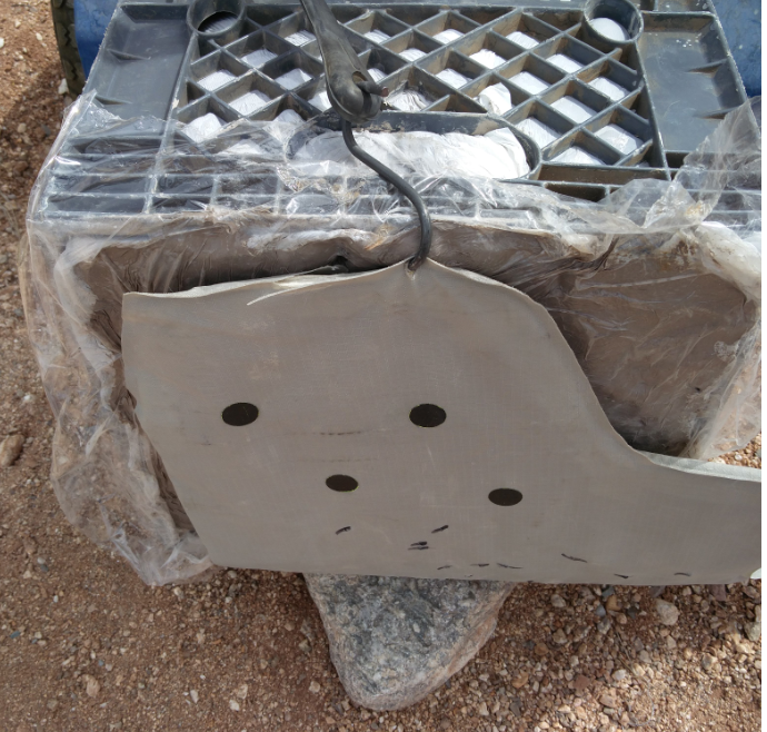

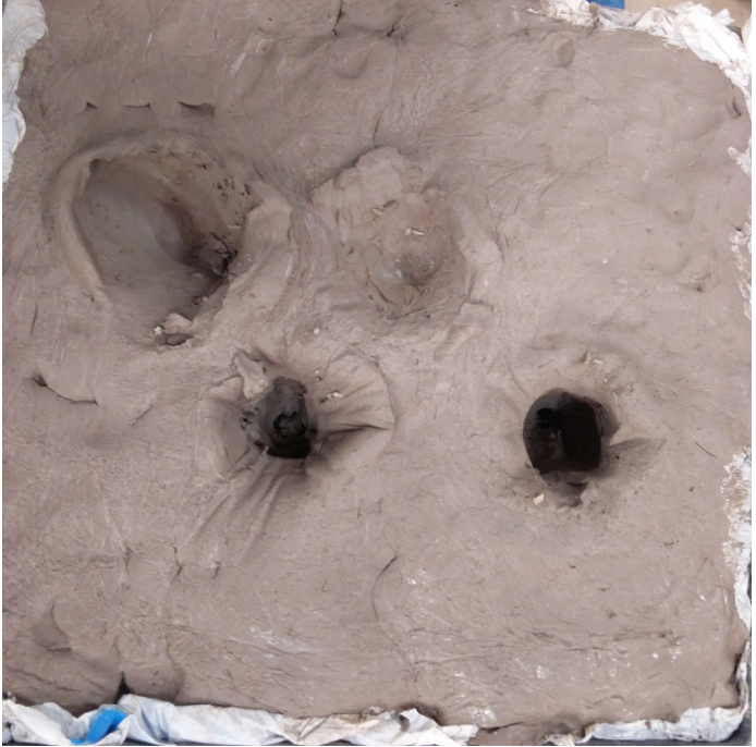

The body armor retesting was extensive. Two pictures to illustrate our findings. The first is the result of a fully secured 3a vest. Smoked it at 53 years. 2 for 2:
7083763
Same test but with a level 2a but NOT properly secured:
7083764
7083765
The lower two shots penetrated as the bottom of the vest was secured under the weight of the clay. The flop at the top produced mixed results even with a lesser grade vest. Should have also done an angled test but this proves there is variability just from how a vest might be secured to one's body.

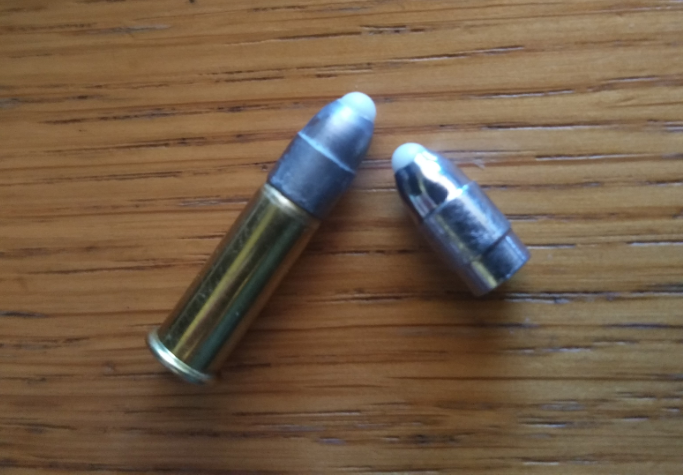

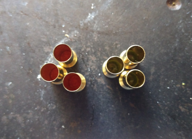

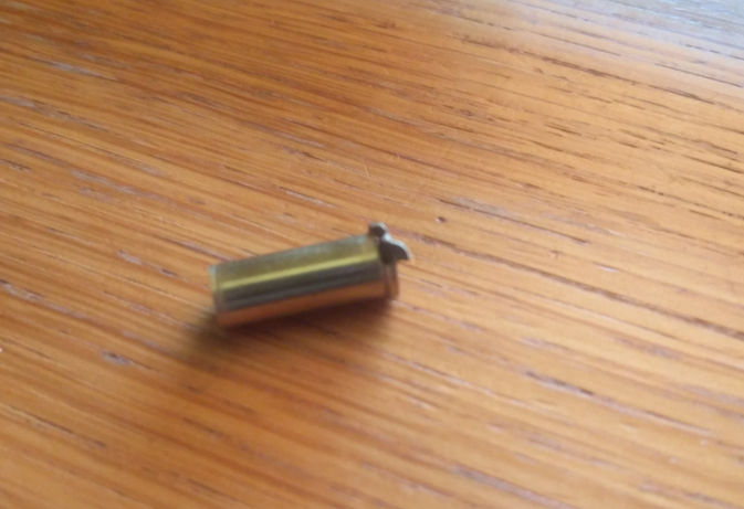

Found out the hard way that not all brass & paste is created equal. Had one blow out part of my magazine clip and bounce up from the table into my face. Stung a bit but no broken skin. What's the old saying "always fun until someone gets an eye knocked out" lol. Max load is now .2 grains lower. Still at a low 1700 fps level.
Here's a picture of the two types of pulled cases and the blown-out one. The Aguila has the red paste:
7083974
7083975
Thankfully this is the only mishap to date on this project. Still want to help?

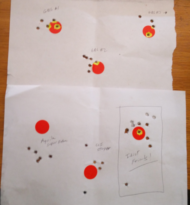

So I had a good day testing all things considered. I was out with a bunch of my retarded friends who created all kinds of issues in terms of formal testing. Our normal shooting spot where (we could shoot beyond 100 yards) was occupied by a bunch of campers so 50 yards was max for today.
Accuracy was in line with previous testing but without a single flyer! I'm coming to the conclusion that my stuff shoots about as good as any typical off-the-shelf product out of this gun. I shot six 5-shot GDS groups. All of which shot about the same.. I think one of the targets got accidentally tossed so only one to show you here:

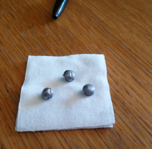

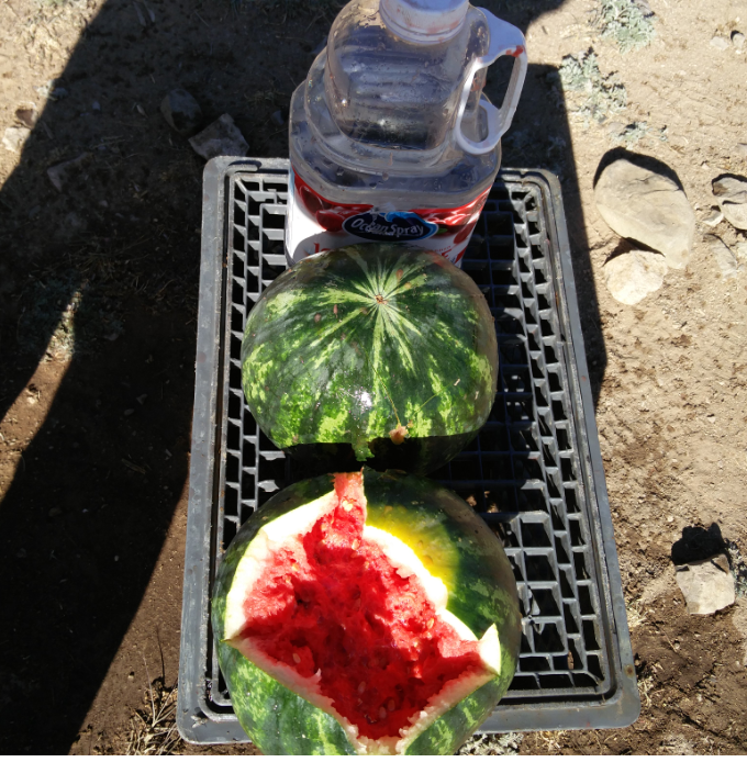

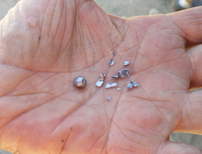

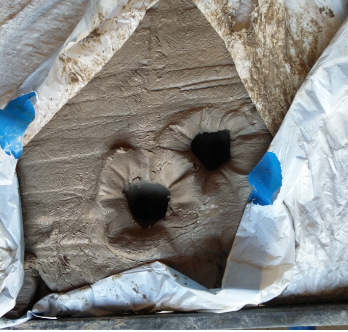

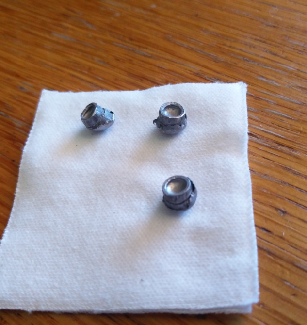

I also did a water jug and a melon penetration test. It went through two jugs and stopped in the third. Pulled this out of the third:
7092422
Shot the watermelons twice (difs spots of course) where both melons were penetrated including a water jug behind them where both bullets were retrieved:
7092423
The cool part of these two test was the resulting perfect mushroom recovered. Weight retention's are 18.3, 18.8 and 18.8 grains:
7092424
So I'll head to the range this coming weekend and do the accuracy and chrono testing correctly without distractions. Looking good at this point!

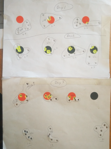

Happy Fathers day to the dads out there! Gave myself a nice present today with the really positive results culminated in today's testing. Everything is now trending in the right direction. My HBN/secret sauce dip lubrication has exceeded my expectations. I no longer have that burt brown crap coming out of my barrel. In fact, have not cleaned my barrel since starting these three days of testing. Those "flyers" appear do be a thing of the past so my suspicion about the previous lube appears to be correct. I also made a more precises punching process to open up the hollow point for seating the sabot (day 3).
With all that said here are the results. Days 1 & 3 were at 50 yards, day 2 at 59 yards:
7096172
Also, here's a group from day 2 with my confirmed low velocity load of 1.6 gr. at 59 yards:
7096173
That's a half inch group, maybe less at 59 yards. The LV load has potential! Here's the chrono data for all three days, left to right with the SD in ( ):

My average velocity keeps going up as the barrel gets seasoned with the new lube mix! I also noticed no crud on the front of my Magnetospeed bayonet so its burning clean. Max/min/avg (SD) is the format. Best I can do at the moment off a plastic card table, a $230 gun with a shit stock and a 1-6 power scope.
I will be shooting out to 100/200 on my next outing. Could be interesting!
Reactions: aam
Interesting project. I cannot help notice that you are doing accuracy testing off of a wobbly table using a 6x optic. I do a good bit of precision shooting and either of those variable would result in my groups being twice as large as normal. You have made great progress. It is time to step up and get a quality scope with at least a max magnification of 16x or 24x. You will be better able to judge the accuracy potential of your ammo by the elimination of those extraneous variables. Shoot only from a solid immovable bench or from prone on the ground from sand bags with a front and rear bag. I have found that all of the high velocity 22lr ammo is substantially less accurate than good subsonic match grade ammo. Some of the best is the CCI mini-mag and Velocitor but they are all crap for precision work. As long as they are accurate enough to hit the tgt 100% of the time, that is OK. My issue is that whatever I can do with it off the bench is going to double or triple in group size when I am shooting off hand and lower magnification from an improvised rest, etc. So for me to be able to say hit a squirrel in the head at 50y consistently, I need ammo that can group under 1/2" (hopefully better) from the bench. Most of the high vel stuff fails to meet that test. One that does work is the 17 mach2. It is getting about 2000 fps out of 17g jacketed ballistic tips and groups 1/2" at 100y and less at 50. Might try researching what powder that use?
Irish
You are correct Irish. At a minimum I need to invest in a higher magnification optic and shoot off a range bench to improve test results. There's a few other items to address that I'm tabling for a possible version 3:

Finally got out and was able to do some quick and dirty shooting at 156 yards. No time to do anything else. All I was able to confirm was an average drop of 10.25 inches at that distance. Hot conditions, but the wind was kind between 3.5 and 5.5 mph right to left. First 5-shot group was left confirming the wind , then I held 3 mils left to produce a second 10 shot group:
7107038
7107041
A quick StreloK calculation produced 9.9" U (1.8 mils) . Holding left 3 mils for the wind was a too much. Another shot group with the windage held at 2 mils was pretty much spot on (not shown). Not happy with the results so back to the drawing board for a version 3 when I can find the time.
