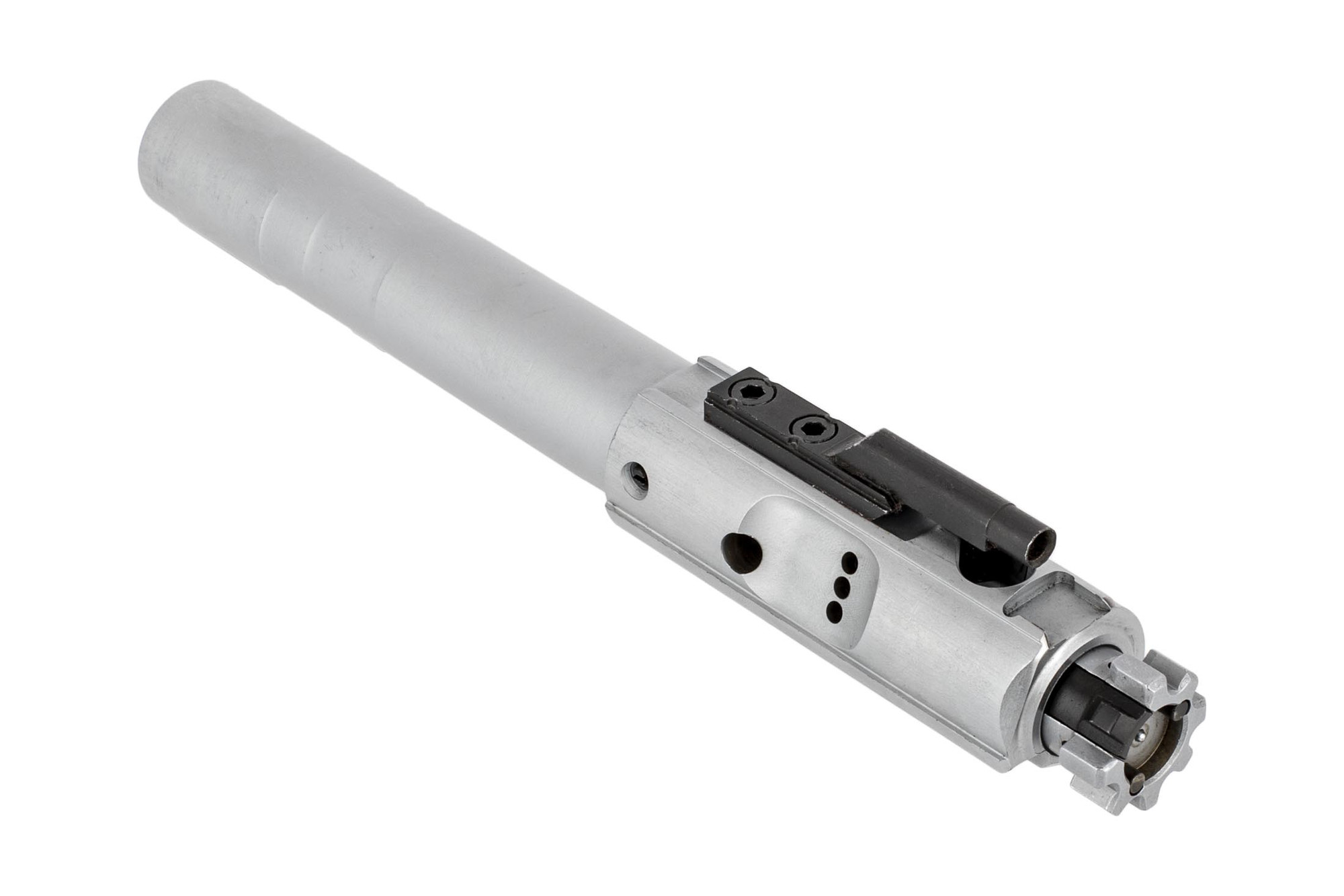

There are a few ways to center the bolt carrier group in the center of the upper with the firing pin hole coaxial with the center of the bore. Make a carrier with a large flange at the back end, bush the front end, and conically face the carrier to fit the end of the extension (a la LMT).
The carrier can't lock up so tight it prevents reciprocation to function.
You have three force vectors that change with every shot: the action spring pushing from the rear; the force of the magazine spring from the bottom (which varies at every shot from 30 to empty); and the force of the hammer as it hits not only the firing pin but pushes the carrier group into final battery.
Each and every mod can incrementally add to consistent lock-up.
The self-centering flange on the front end of an LMT enhanced carrier which mates into the receiver extension recess (M16):

I just got CMC enhanced BCG's in both 308 and 5.56. ( Flare tail and extra exhaust port on both ) might have to see if there is a benefit in precision.
