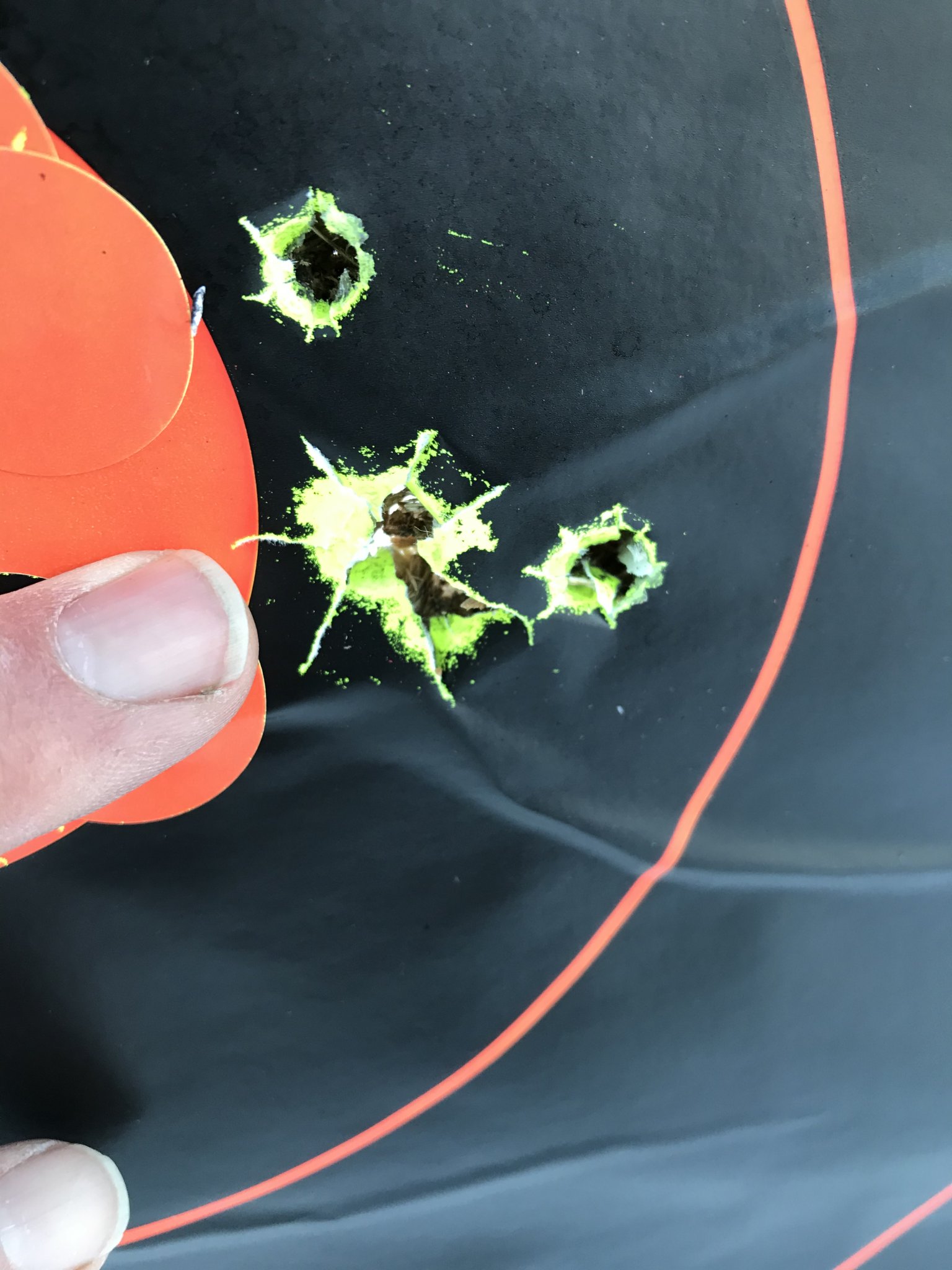

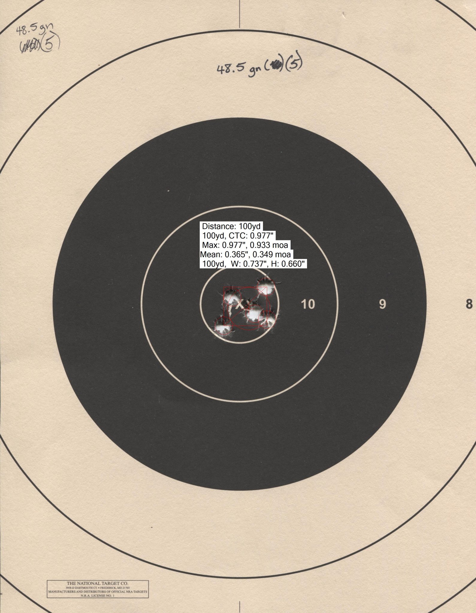

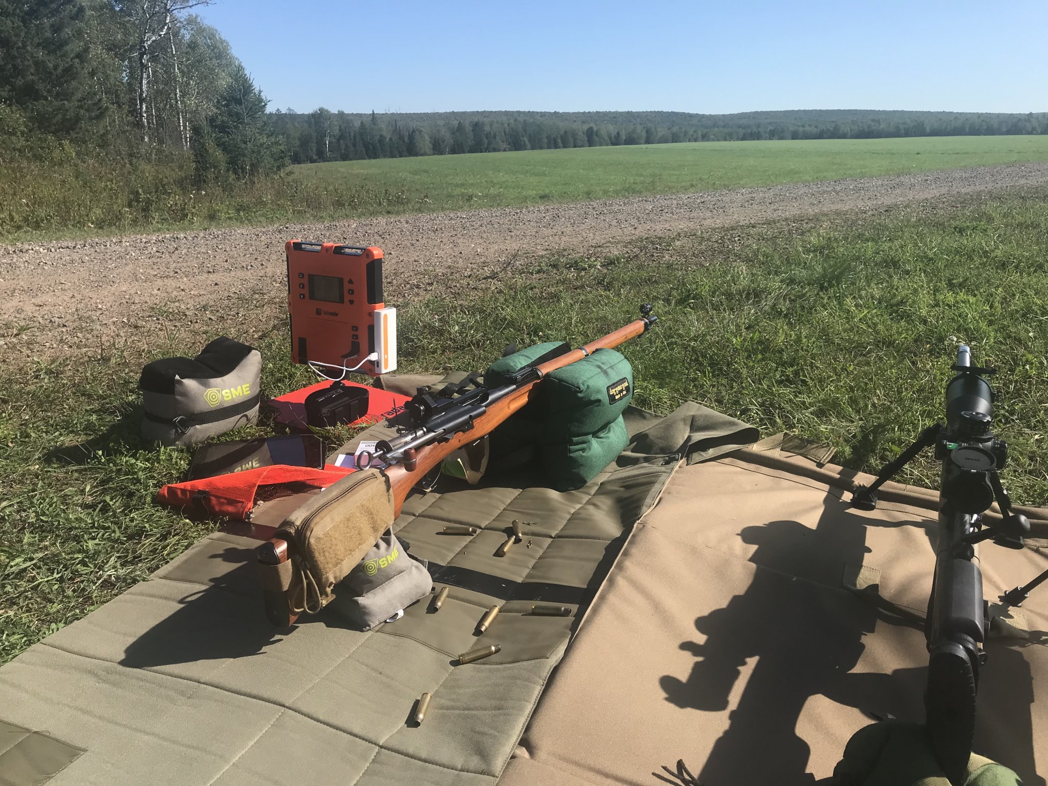

My day at the range with my Swiss:
that is at 100 yd. 5-shot group.
Conditions at the range:

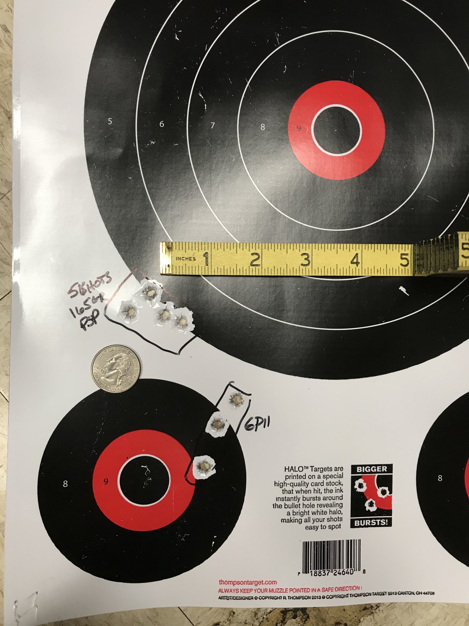

I posted in another thread IIRC, but I’ll toss a few pics up here from October. Hopefully here soon, I’ll snowshoe out and have some more fun!

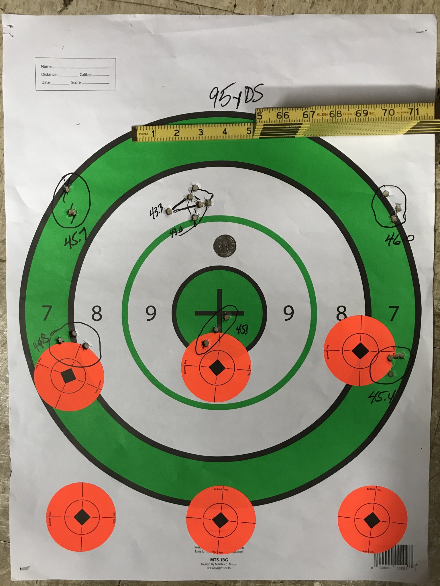

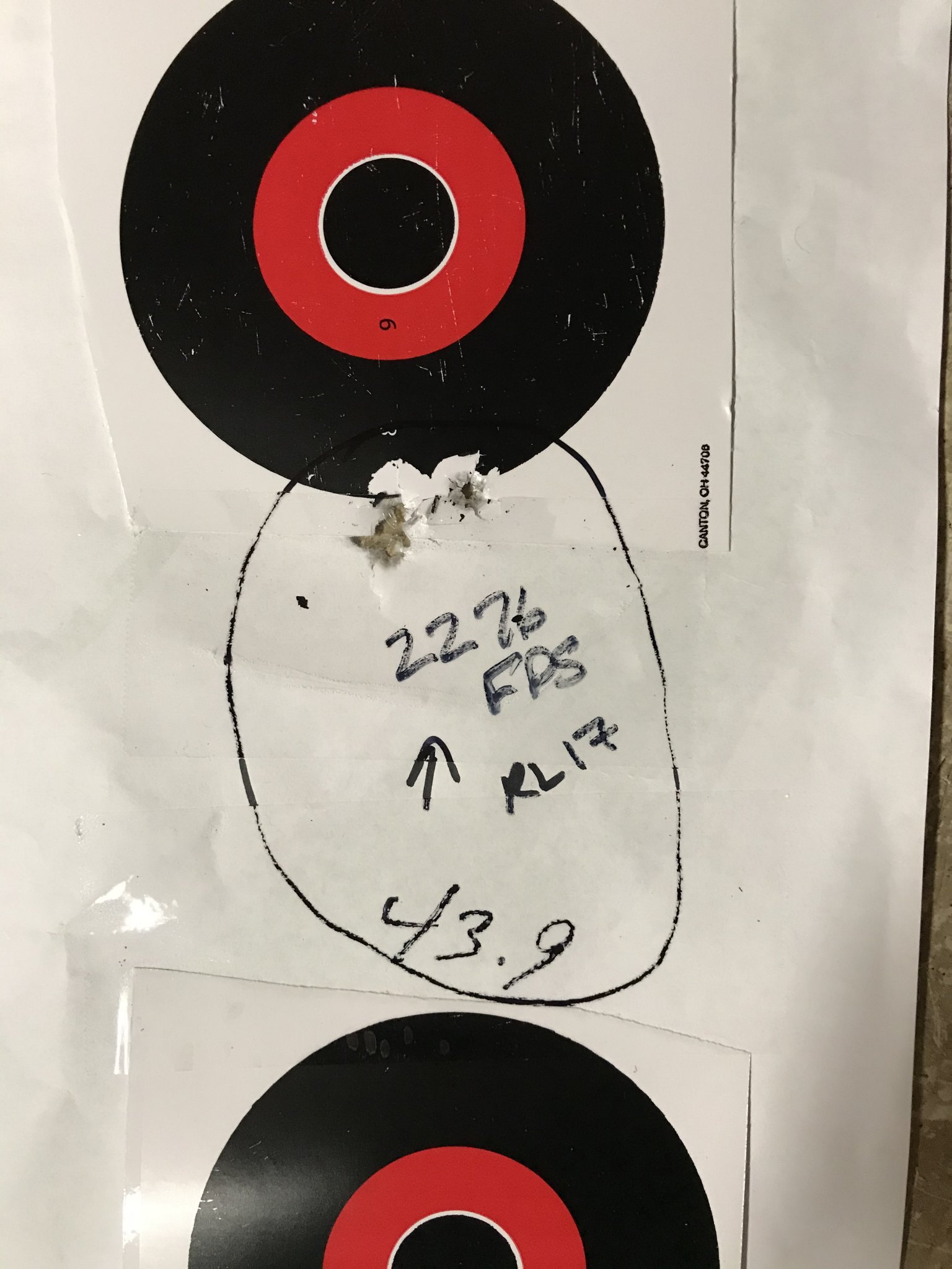

So I talked to zfk55sr and he said he uses 45.5 gr of RE-17 behind a 175 SMK loaded .002"-.004" off the lands. With these PPU Swiss bullet copies, you can't get to the lands in my rifle. So, I loaded them .010" under standard mag length of 3.090", so 3.080" My mag has a lot more room than that, so I think my cartridges are about .020" under mag length. Maybe it's tighter down in the bottom of the mag.
In any case, what I have for miscellaneous primers is magnum rifle. So, I loaded the RE-17 down to 44.5 gr. That load matches the sights as far as elevation goes. At least out to 400. I bumped the sights up one notch and didn't have to hold. That was in about 40 degree weather believe it or not. We had a heat wave and took our 100 inches of snow and made the piles about 1/4 the size they were in early December.

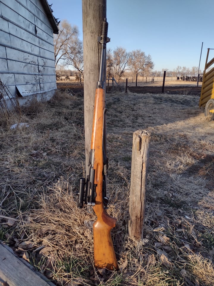

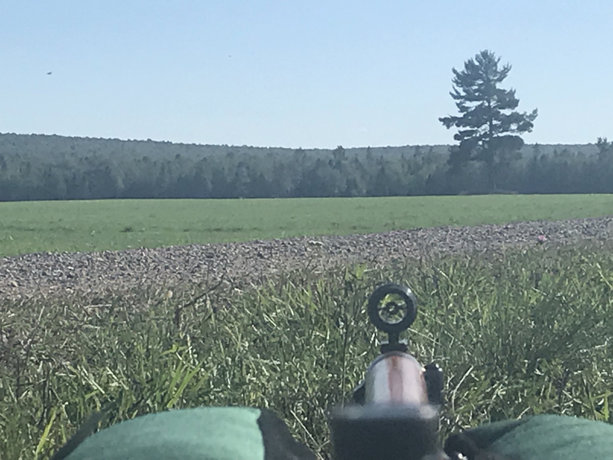

Added: I have to ask where you are. As your first pic looks like a major Montana highway with, of course, forest in the background.
Yep. I had the same problem with my 1911. The throat made my R700 5R look like it has tonsillitis. I barely touch the lands with the 175smk, and don’t have enough length to get good neck tension. I just tossed up my arms and loaded them to 2.410” CBTO. I used RL17 and did a spread from 43.0-46.0gr. I’ll attach part of that below. It did start to tighten up past about 45.5gr, so perhaps I will redo the upper end of that and even bump it past 46.0 a bit. Looking at my notes, I show about [email protected] with a temp in the upper 50’s. Issue is my eyes are 56yrs old with a bit of astigmatism and now farsightedness. Diopter sight not withstanding (those things rock!) I can never be sure if I’m “off the node” or just “off my prime”. Lol. I figure if it’s close to a Quarter, it’s good at 100yds at least.
Pics are from God’s Country Upper Peninsula of Michigan.

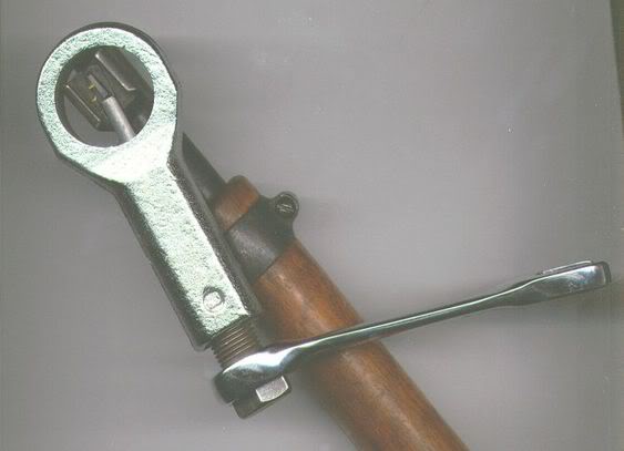

Yeah, I'm like 15 bucks in on a nut splitter and bits that haven't done the job. Likely a problem with my parts selection. I'm not inclined to keep throwing money at the DIY version when $50 and patience will get me the real deal. My K31 will just continue to enhance the gun safe.

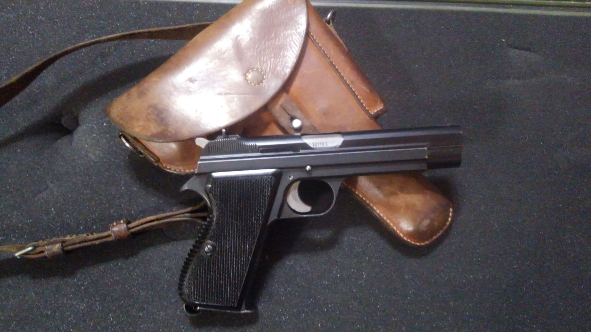

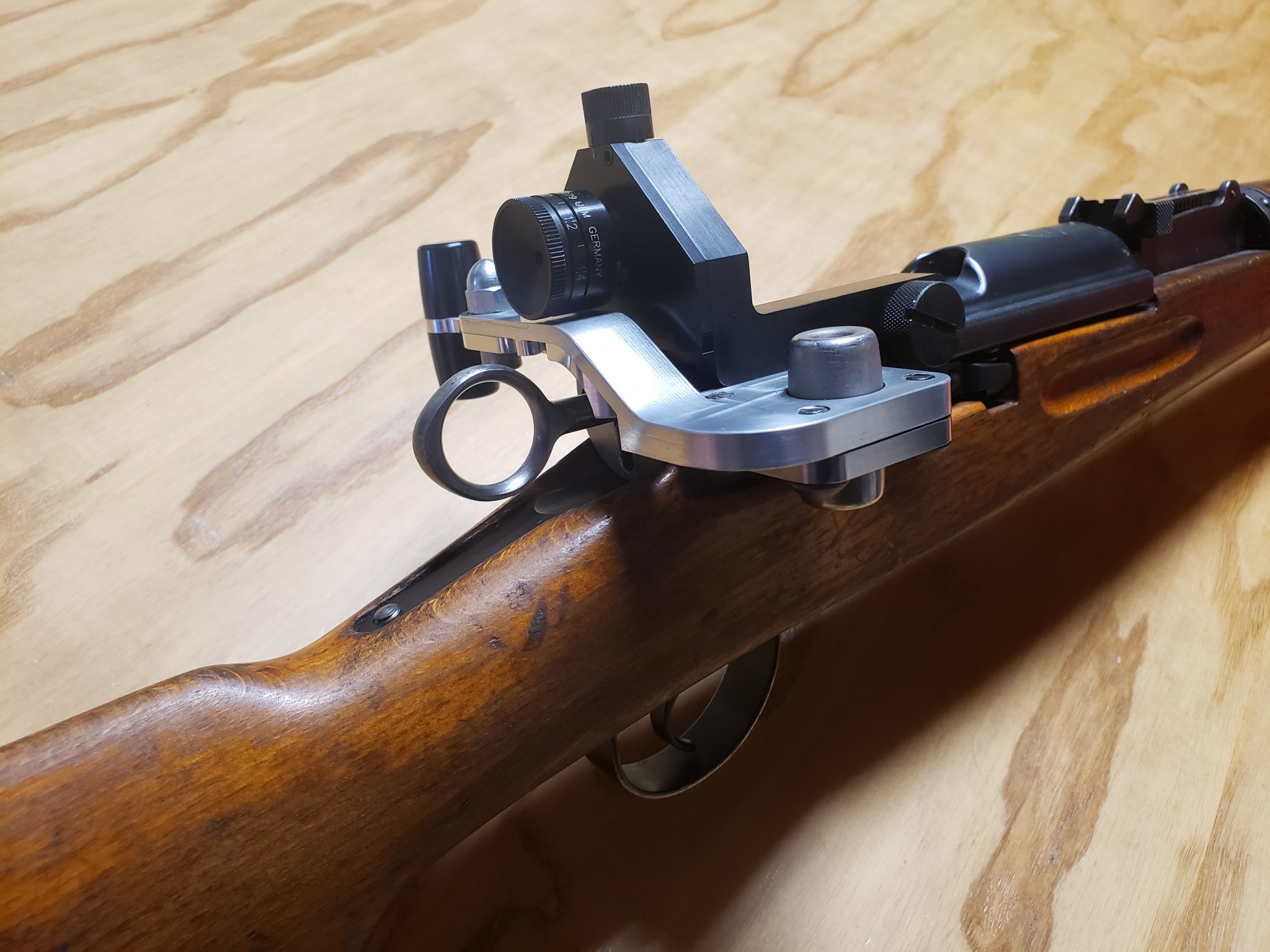

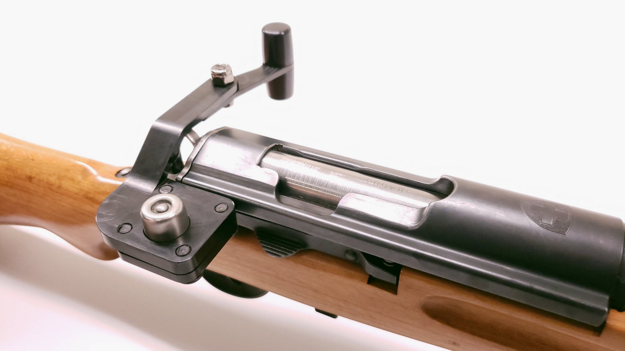

Just for the heck of it, I thought you guys might be interested in seeing the new LHO, or left-hand operating system for the K 31s.View attachment 7630556
Does this work with the excellent Swiss Products clamp on scope mount?
I have a good friend who is left handed, he's already drawn to my k31s because of the straight pull, but I think this might push him over the edge to get one himself.
There are no "original Swiss diopters". Every single one of them coming out of Switzerland and Germany were aftermarket made by cottage industries around Bern. Some were supplied to BERN but they were never, ever an issue item to Swiss soldiers. We began making ours 21 years ago and after submitting to the SSV, they were accepted by the Swiss SSV as being sanctioned for any and all Swiss matches worldwide.
The image represents an entire repeatable target using the information contained within our website. 5 rounds at 150 yards on the SP range in Lost Prairie Montana. The load data is contained within the appropriate title on our website

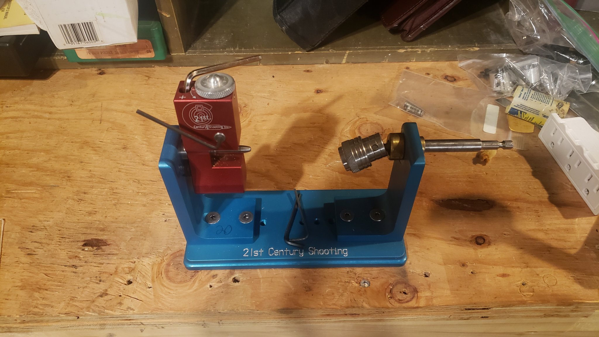

Advanced case prep,
There are two directions the reloader for the Swiss 7.5x55 can take as concerns our approach. Assuming you've already read our initial approach, you may choose to end it there. This next step will take you into increasing accuracy and developing repeatable targets.
Case prep is, for us, easily 90% of the repeatable round process. From here on you'll need a Chronograph. It's the only way to measure your success in the reloading process. The term "Standard Deviation +or -" (SD) means the difference between your fastest and slowest round fired. That deviation is very dependent on the "neck tension" of your resized case, or, in other words, how tightly the neck grips the projectile when it passes through your bullet seater.
Two things will control that. The amount of the neck gripping the projectile, and how tightly the projectile is gripped. Both will greatly affect the SD, and the further downrange you shoot, the more critical that becomes.
Remember that we're talking about our caliber only. Other calibers will behave differently and will require or allow far more variables because of the short throated chamber of the k31. Yes, I'm well aware of the 911 series being a bit different in the throat, but also keep in mind that the GP11 cartridge was developed in Bern for ALL of the Swiss rifles (save the 1889 and earlier) from the G11 right through the MG51..... All using the identical cartridge, and all with the very accurate end result for a production military issue cartridge.
The first control of neck tension will be, after full length resizing, trimming to an absolutely identical length. This will control the amount/length of the case neck gripping the projectile. If you've already bought your press and dies, this might be as far as you want to take it..... But if you're going to the next logical step in controlling neck tension, you'll buy a set of Redding Comp dies.
This will allow you to full length size (FLS) the case body and resize the neck seperately. Why? Because using a Redding collet, you can assure that the neck tension is as uniform as possible throught this step. You may want to buy two collets...... One at your known caliber size and one the next size down. Only seating the projectile is going to determine which one suits your particular projectile factual size.
"Aren't they all identical? No. From Mfg. to Mfg. there can be a difference so slight that simple measuring might not show any real difference. All Sierra's may be the same, but switch to Berger or Hornady or any otehrs may not be absolutely identical, and with neck tensions, we require identical performance. Nit picking"? Maybe, but your long range targets are going to tell you.

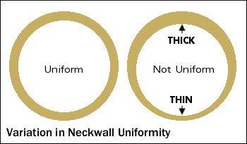

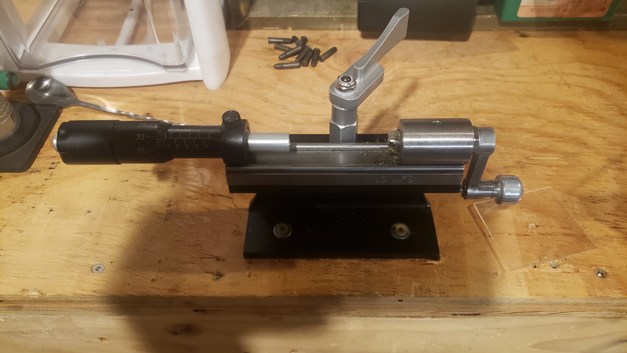

Ok. Now you have your basic procedure. The next step for the most devoted is Case Neck Truing.
Tension as in "neck tension" has an incredible amount of importance in reloading.
Neck tension is controlled by two things, those being case neck trimming and truing.
Case neck trimming will determine how much of the inside surface of the neck is going to grip your projectile. Neck truing will determine how equal the neck tension is on the full 360° inside of your case neck. This is not going to be a tutorial on truing as there are a large number of videos on YouTube explaining exactly how you do it. I'm simply going to give you the importance of these two functions.
There are a plethora of case neck trimmers on the market, and not all of them function perfectly every time. If you have the kind of trimmer like the old standard RCBS, you have to tighten the collet around the base on each individual case. That actually does leave room for barely noticeable differences, but those differences do affect the grip on the projectile. The shorter the case neck, the less of a grip there is on the projectile just as the adverse is true. Shorter or longer, the true case length is very important. Every projectile that you reload should have the same neck length right to the thousandth or less.
So other than correct length sizing in your dies, you might think all you need from that point is a bushing, and rightfully so. When we are setting up a new caliber, we typically order three bushings. One in the recommended diameter, 1000th smaller, and one the next size up. We don't always end up using the recommended bushing, and we will reload 20 rounds using each bushing and let the target show us which bushing is correct. That is usually the end of the line for most reloaders. The exact neck tension might be correct on some of the cases and not absolutely correct on others. All of them are going to be the same outside diameter for sure if you trimmed to length correctly and have selected the best bushing for accuracy for that particular case and projectile. But there is one thing that is not addressed.
Let's consider that we are going to check a box of 100 brand-new cases from Norma, Lapua and Hornady, all of them listed as "national match brass". All things being equal, those cases should be absolutely identical inside and out, but are they factually identical? All cases, new or not should be sized on your own dies and the cartridge length trimmed to what you know is correct for your caliber and projectile. You never assume their virgin brass is ready for you to reload. So, you've done those first procedures and maybe even weigh them to check that they are all similar in weight, and most likely they are. You determine the correct bushing, do comparative loads to determine which is really the correct size and once that's done, were ready to go, right?
"Not so fast there, Potrzbie". There's one thing that you still have not determined that is also something that many reloaders never consider. The case wall thickness of your neck. In virgin national match brass, you would expect it all to be identical, but is it really? Most, or all of it might be for that particular run of brass. But as with all machinery, when it's time to set up the new tooling that means that there has been wear somewhere in the system. Look at the first illustration and you will see what is commonly found in standard brass. National match brass "should" be perfectly concentric, but you will find it is not always so. "So what? The bushing should take care of that". Actually it does not. It makes sure that the outside diameter in relation to the projectile is perfect but if the brass is thinner on one side than the other, does that affect accuracy? Absolutely!
The "perfect system" is going to be a coaxial press that aligns absolutely everything on the case head, from the bottom all the way to the tip of the projectile. If you expect everything to be concentric for maximum performance downrange then you must include the inside of the neck also being concentric to everything else right from the start. If it's not, a very slight bit of tension will happen when a coaxial press, or any other for that matter, cycles up to align everything. The case neck without Concentricty is going to actually apply more pressure to one side of the projectile than the other with its grip. The only way to change that is to true the case neck. It can be done one of two ways and the easiest is to remove brass from the outside of the case neck. When the entire cartridge is forced up into the die the case neck will also be aligned.
That's far more of a PITA. Than doing the outside, and the fact is that doing the outside is enough. What the little digital meter will tell you is by turning the case neck that is contained within a pilot mandril will give you a reading of thinnest side of the neck because the meter sensor will be pushed out at the thickest point. The lesser reading is the one that you will use for adjusting the cutting tool. From that point on, it's a very simple matter of using a 21st-century case neck truing system. I'm providing you with a couple pictures of the (in our opinion) combination that will take you to that point..
One is the Wilson case trimmer and the second is the mini lathe from 21st century. There's not a lot of dollars involved in this and if you're doing long-range precision shooting, this process is a must.
As I said, I'm not going to give you a tutorial here on how to use both of them because there are enough videos on YouTube to show you exactly how to do that without me explaining for the 20th time something others have already done. A complete tutorial will eventually end up in our "rifle info" section on the opening page of our website.

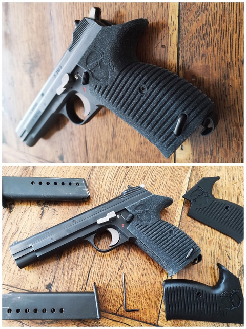

Wyss Waffen in Switzerland, Karl Nill in Germany (and a few others) used to manufacture add-on beavertails, just to fix this.
There are two kinds: one with a hole, for the screw which holds the trigger group on -6 models, and the plain one, which goes on military -2 models (which you seem to have), which is simply epoxy-glued on the handle. Holed models can be glued as well on any P210 model.
I have one, and it works as intended.
Another solution is to simply nail off a part of the hammer, but I always considered it a crime with such beauties.
EDIT: P210-6S or P210-6 Heavy Frame models do have longer tails from factory, and do not require any add-ons to prevent hammer bite.

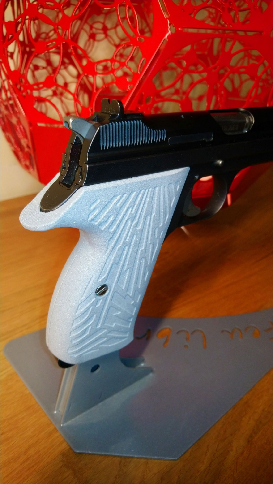

Back in the old days, when Facebook did not yet grow into the monster which ate us all, a few people on a French-speaking Swiss guns forum have tried that: https://www.feulibre.com/t11247p50-beavertail-pour-un-p210
(see also the following pages, there are bits of STL available for download, if it helps)
Apparently it worked out rather well, even with hobbyist 3D printing technologies from 10 years ago.

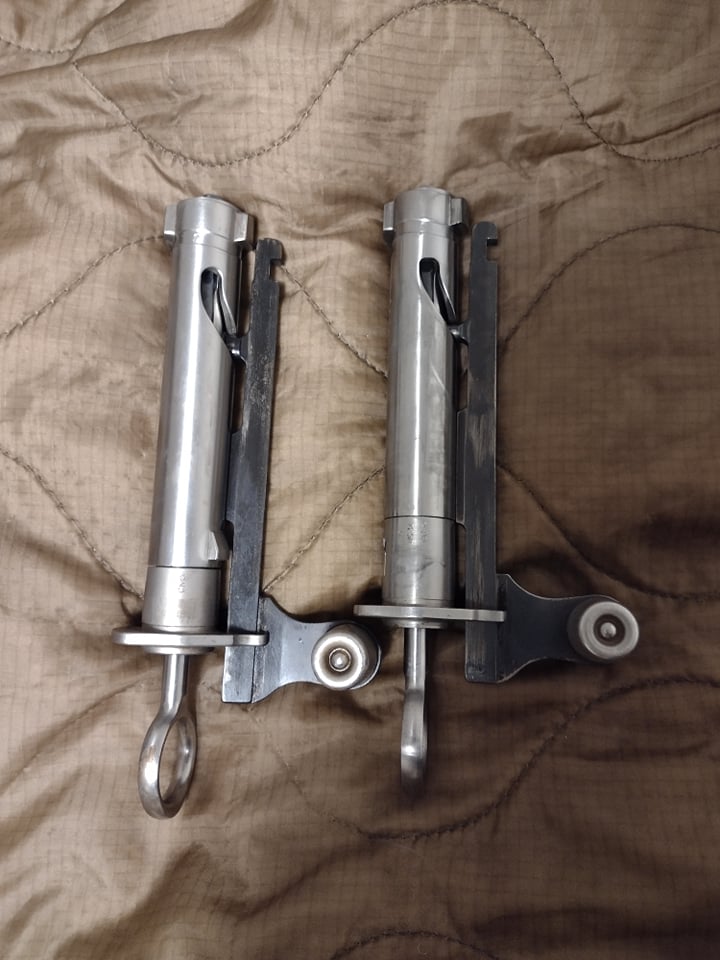

I don't know if this is common (From what I've seen of the rest of this stuff why not??), but I zeroed out the scope adjustments, slapped it on the rifle, and my first shots at 100 center punched the target. Very pleasant to shoot with the brake up there. Not obnoxiously loud, either.
Zfk55 on the left, K31 on the right
It may be hard to see in this pic but in person you can tell the lugs are clocked a little differently, and something interesting I don't remember ever having read/heard before is the addition of the 3rd rearward lug on the Zfk. Interesting to see the difference in length of the bolt bodies, too. It's a little funny how the "same" action tilted 15 degrees or whatever it was results in almost complete interchangeability failure.
Reactions: Davo308
Interesting I thought the charging handle was one of the few parts the k31 had in common with theZfk.
