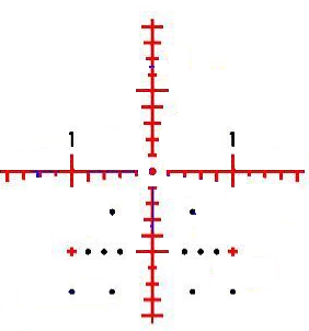

Here's my take on the reticle without the 1-mil dot weirdness:

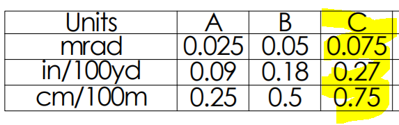

Let’s pretend I’m dumb and bad at math. 0.075 mil center dot would be about 2.2 inches at 1000 yards correct and .22 inches at 100 yards?
1 MRAD = 3.6 inches at 100 yards and 36 inches at 1000.
0.075 MRAD = 0.27 inches at 100 yards and 2.7 inches at 1000 yards.
If you're shooting quarter inch targets at 100 yards and 2.7 inch targets at 1000 yards, more power to you. I don't know of anybody who does, so the dot size doesn't concern me.
