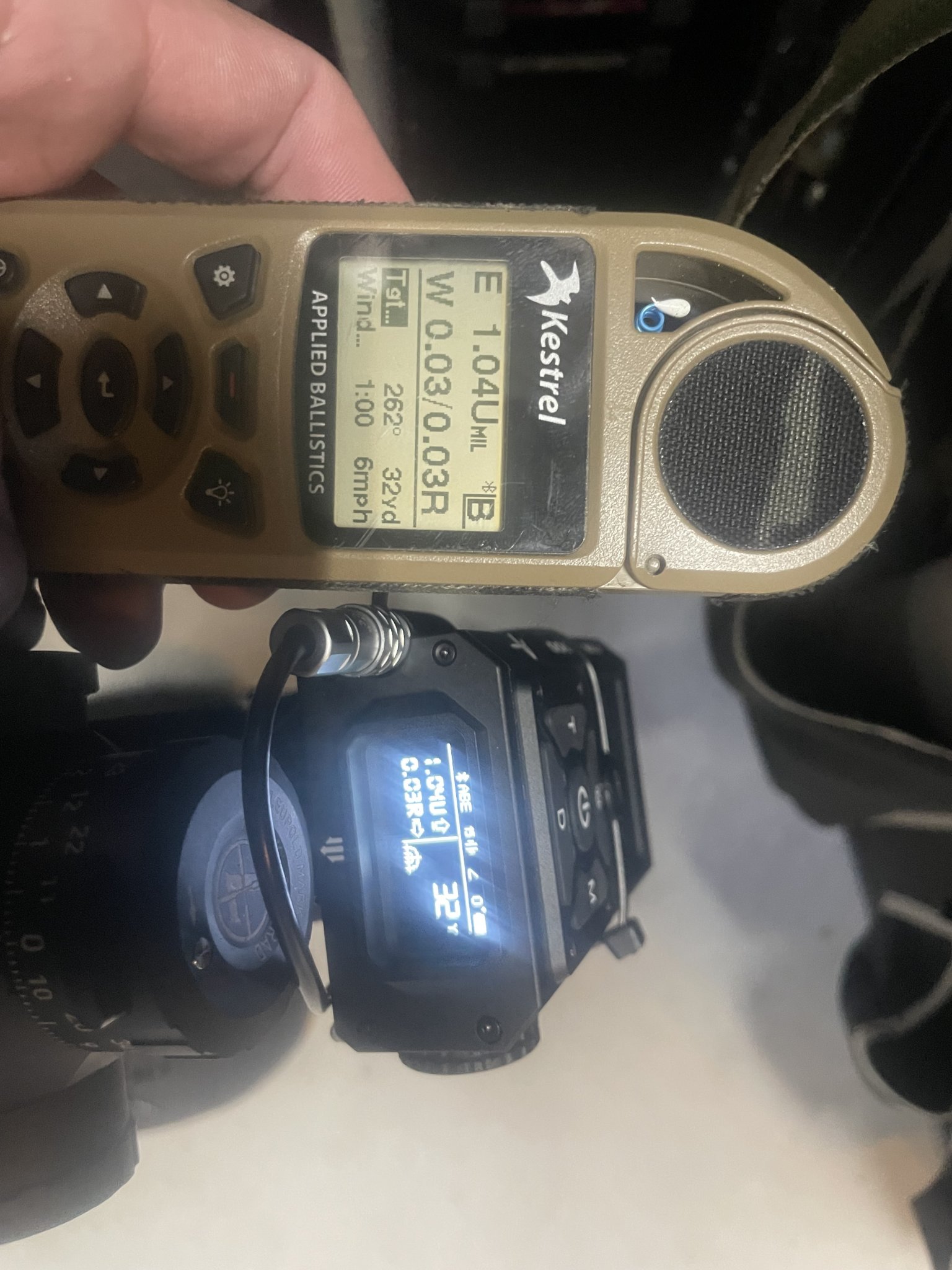

I have a 5700 Elite, I finally got the Kestrel to pair with the Fire 4000 but it doesn't seem to actually DO anything. Even if I have a rifle profile on the Kestrel, connecting to the Fire 4000 and getting a range, I don't get any DOPE values on the Fire 4000 screen. Just the yardage, on ABE. ABI will at least show me a DOPE. I also don't get a range on the Kestrel. The Kestrel is as up to date according to the LiNK app.
Connecting the Fire 4000 to a Foretrex 901, I can at least get a range on the Foretrex, but the Fire 4000 still shows no DOPE at all.
This is similar to the issue my buddy is having. Similar, in that he can get ONE yardage and dope, but the next range, he only gets yardage, but no dope.
Try turning the Fire4K on FIRST, then the Kestrel. Even though mine shows the Bluetooth symbol (on the Fire4K) as connected, if I do it in reverse, it will not pair.
Out of curiosity, is yours an Elite or an UPGRADED 5700 to the Elite? Also, what firmware version is in your Kestrel?
It started out as an Elite, so not upgraded. FW is 2.15 and Boot is 2.00.
Doesn't matter which order I turn things on, the bluetooth symbol shows up on the Fire4000, the Kestrel says it is connected, but I get no communication between the 2 devices. Range doesn't update on the Kestrel, I get no DOPE at all on the Fire4000 in ABE mode. If I change rifle profiles on the Kestrel, it never updates on the Fire4000, even if I turn everything off, turn the Fire4000 back on, then the Kestrel, in ABI mode the DOPE I get is for the original rifle I had selected, not the new one on the Kestrel. ABE I still get no DOPE at all.

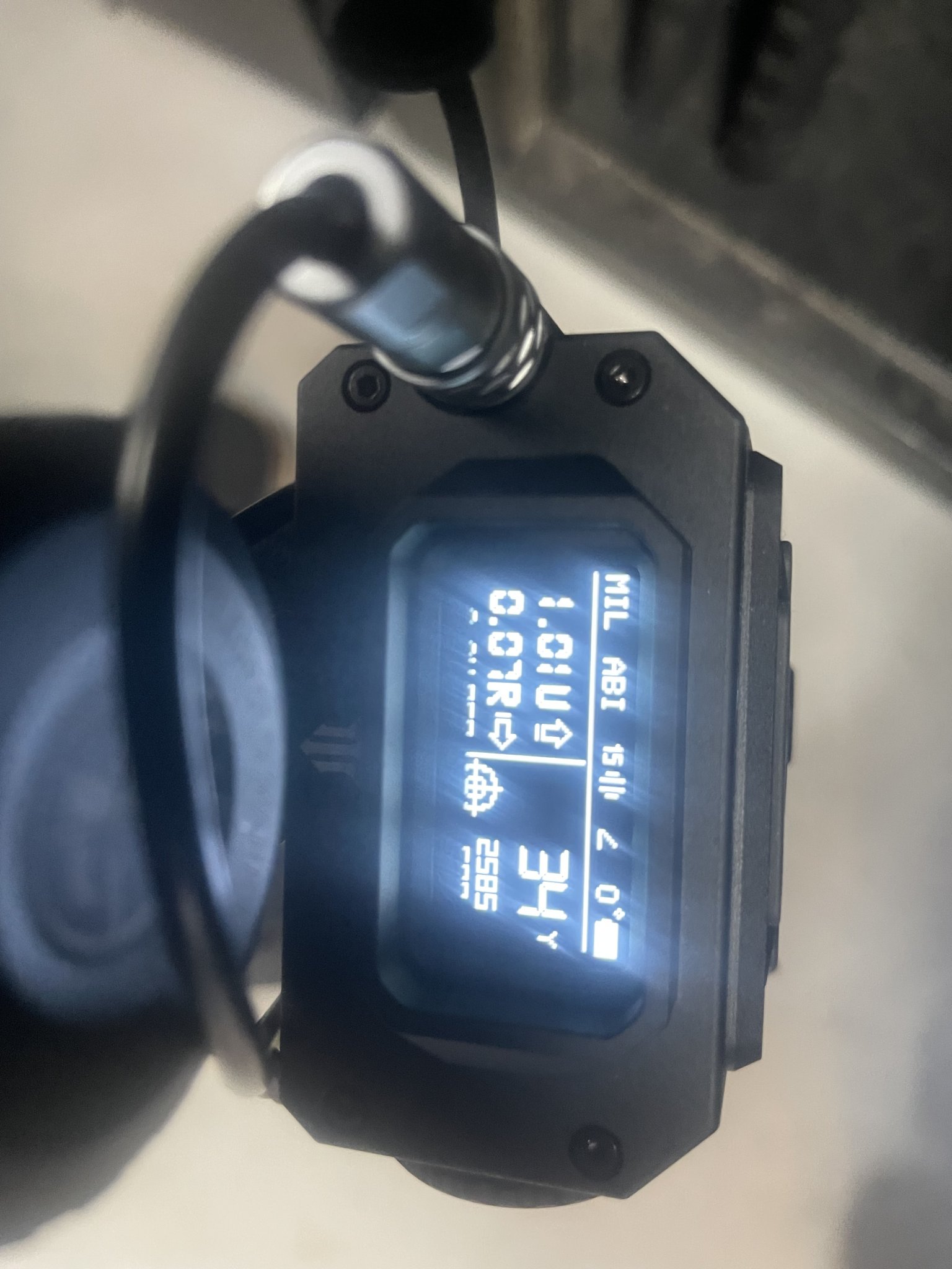

OK, update to my issue at least. The Kestrel will NOT accept any range information inside of 100 yards from the Fire4000.
Going off what you had said skyewalker, I tried connecting to the BOSS app just to see what it would do. It connected just as expected to BOSS. While still in the BOSS app, I turned on the Kestrel and had the same experience as you were asking about. The Kestrel would not connect to the Fire4000. Shut off the BOSS app and restarted the Kestrel, and it connected up as expected.
Here is where it gets interesting, when I tried ranging again, the Kestrel actually gave an error, "Received invalid target data" which it had never said before. So communication was obviously now occurring! Armed with this new information, I went outside with the Fire4000 and the Kestrel. Anything from 5 yards out to 95ish and the Kestrel would always say "Received invalid target data"
Once I found something beyond 100 yards to range, in this case 167 yards, it sent the data to the Kestrel, the Kestrel updated the yardage and I had DOPE on the Fire4000! Tried again on something closer, 26 yards, and once more the Kestrel showed "Received invalid target data"
I need to pull out my VectorX and TerrapinX and get the Kestrel paired to either of them and see if the same "inside of 100 yards" causes the Kestrel to throw an error.
For now, I am happy with this knowledge. Not like I'll be doing many inside of 100 yard shots with a 6.5 CM or 300PRC. But rimfire is another matter. But really, that isn't that big of a use case for me.

Just heads up I have no issues with either ABI or ABE under 100yds. Also FW1.53 rev14b
