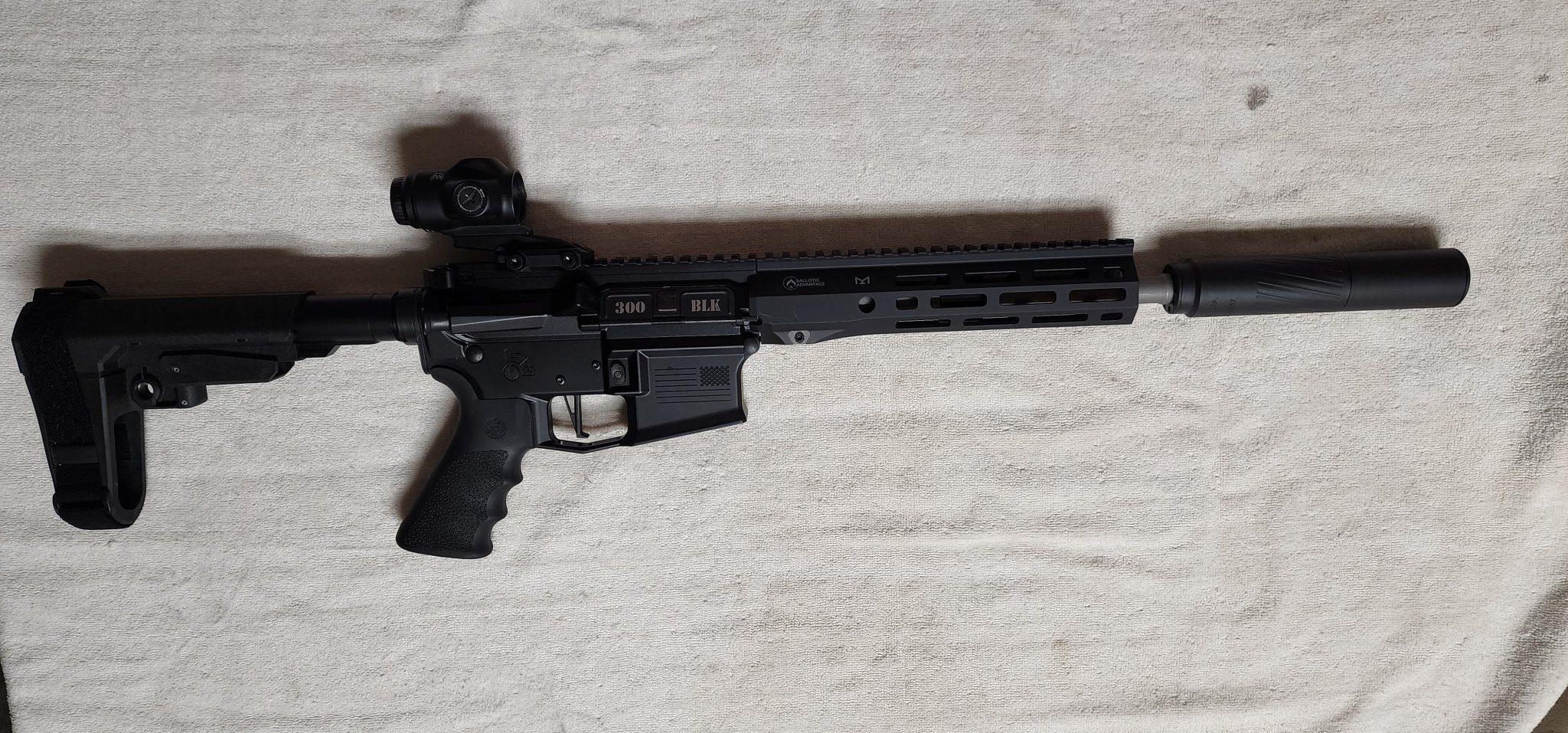

I know I'm resurrecting this thread but I officially took possession of my Fly9 yesterday. Today the silencerco direct thread alpha adaptor came in so I got to do a test fit on my 10.3" 300blk pistol. I'm looking foward to being able to give my input on this combo.
