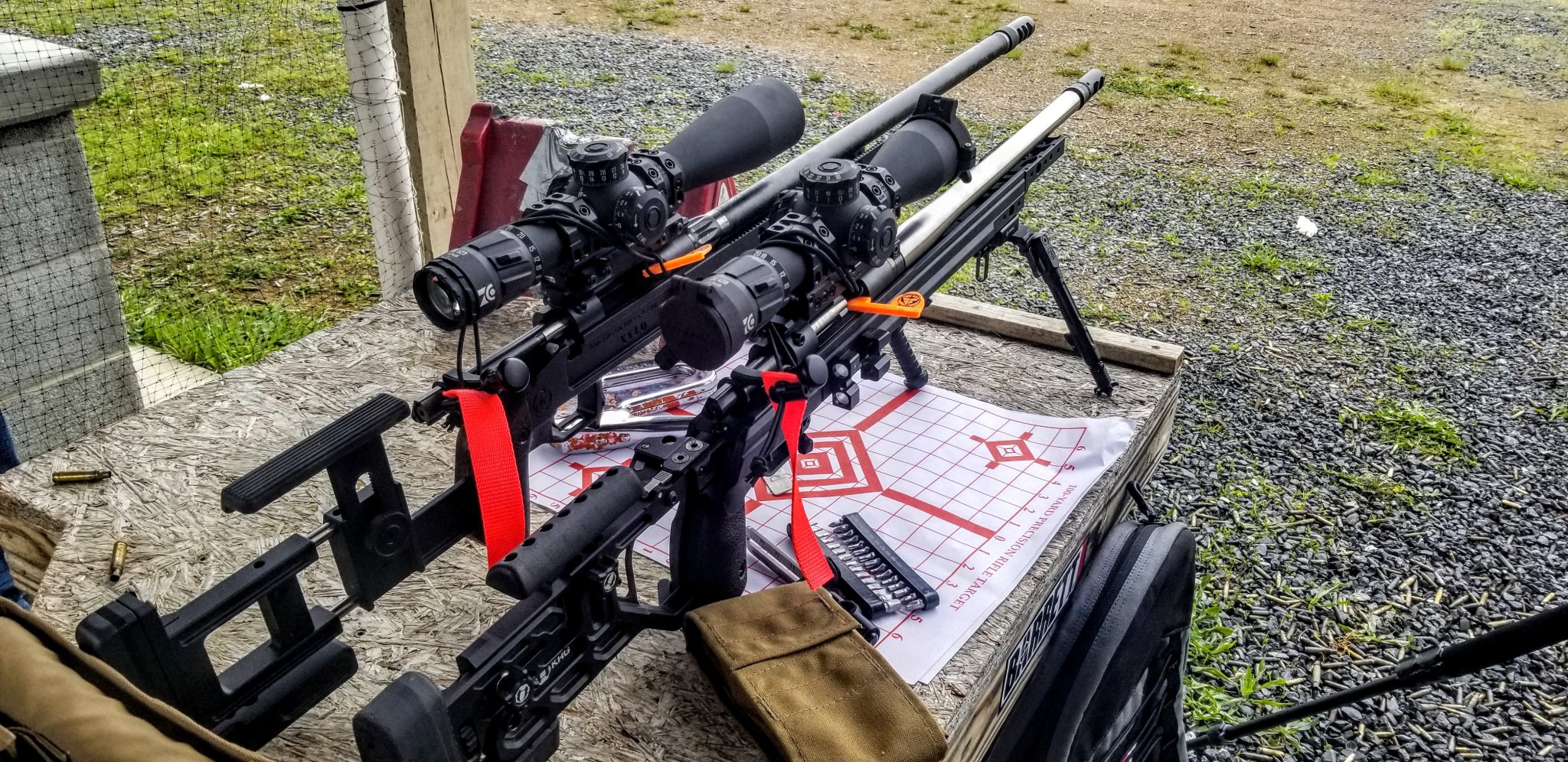

Im a simple man. I see a Nucleus thread, I click and post pics. Happy owner of two Gen 1s. Both TT and OEM spring:
