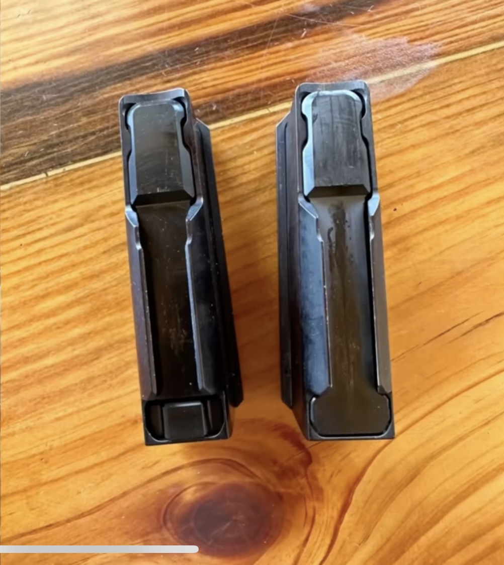

Is anyone running their Zeus with AW magazines?
If so, what chassis or stock and bottom metal combination are you using?
-Stan
I have two Terminus Zeus in MPA BA Comp and ESR Chassis.
AW mags run well in both with the MPA Mag Block glued into the chassis mag wells;
In saying that, the Gen2 MDT BR mags are my preference for 6BRX and 6Dasher. The followers do not tilt at all and I'm more confident in them.
As Franco says above, if a AW with HRD kit gets messy it's all over.
AW with Creed etc is all ok.
Reactions: stanley_white

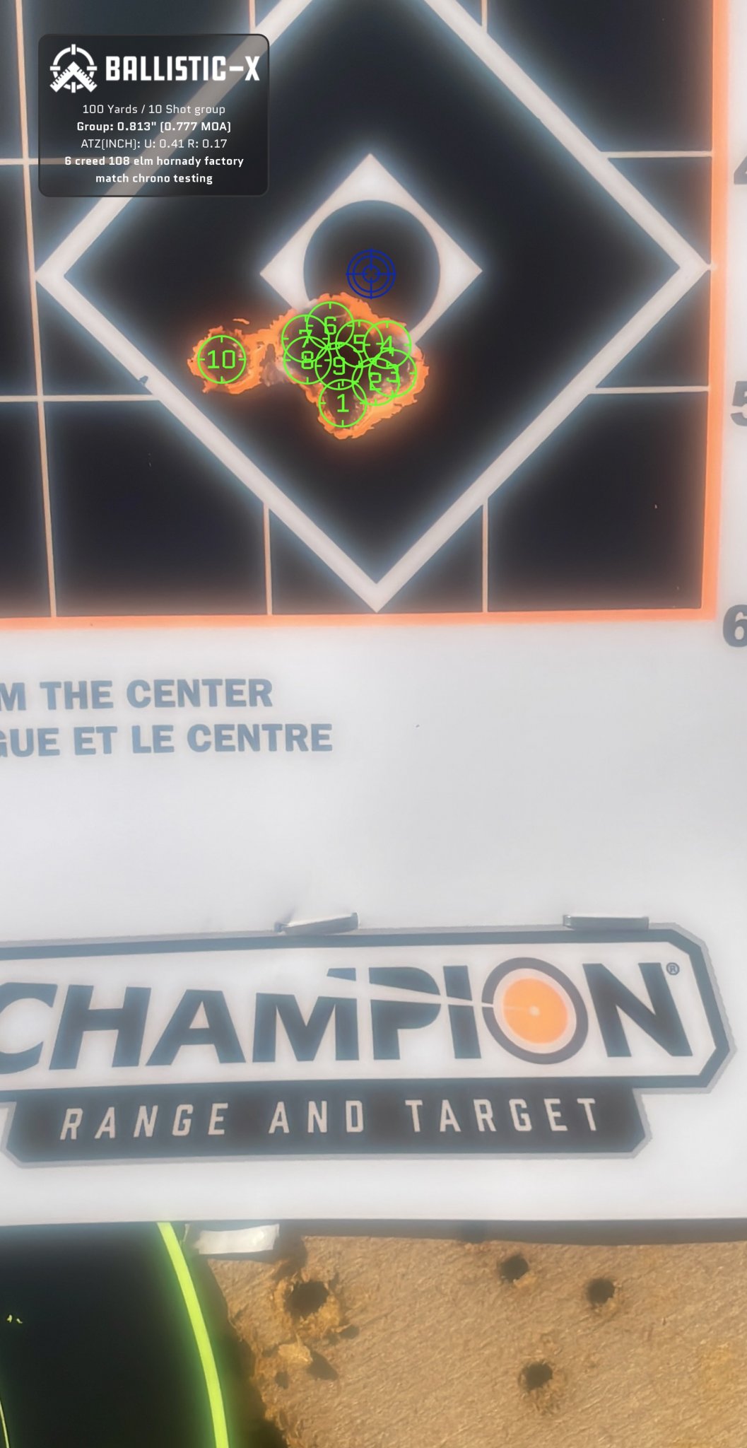

if anyone is running a proof prefit or preferred barrel blank chambers by a smith. I would like to here your experience and accuracy. Photos would be a nice addition. Thanks
Zues qc proof prefit from Altus had my little helper put it together 10 shot group factory ammo 6creed

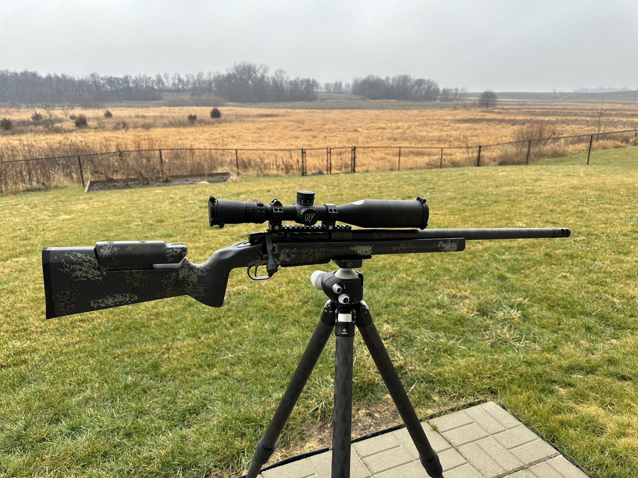

Nice rig. Building something similar soon. What’s your final weight?

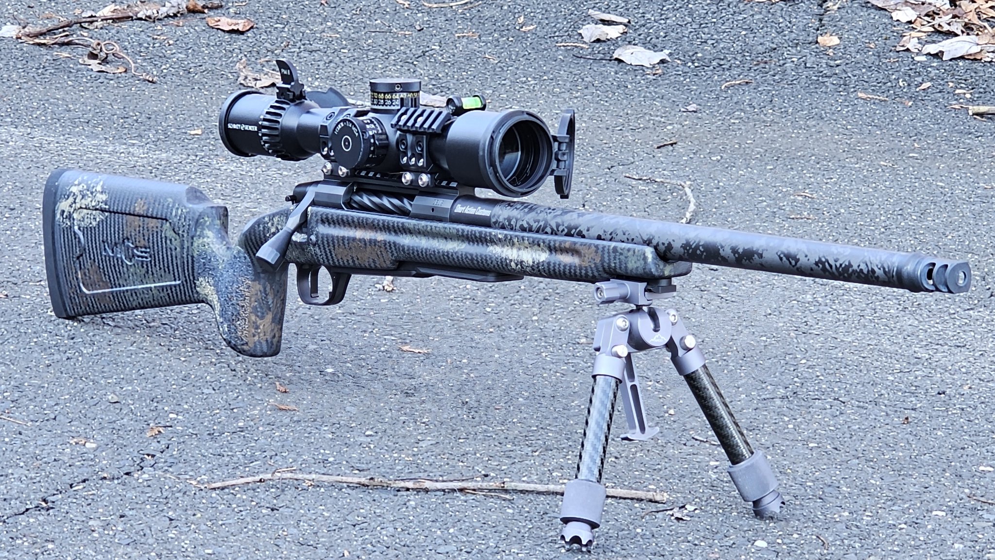

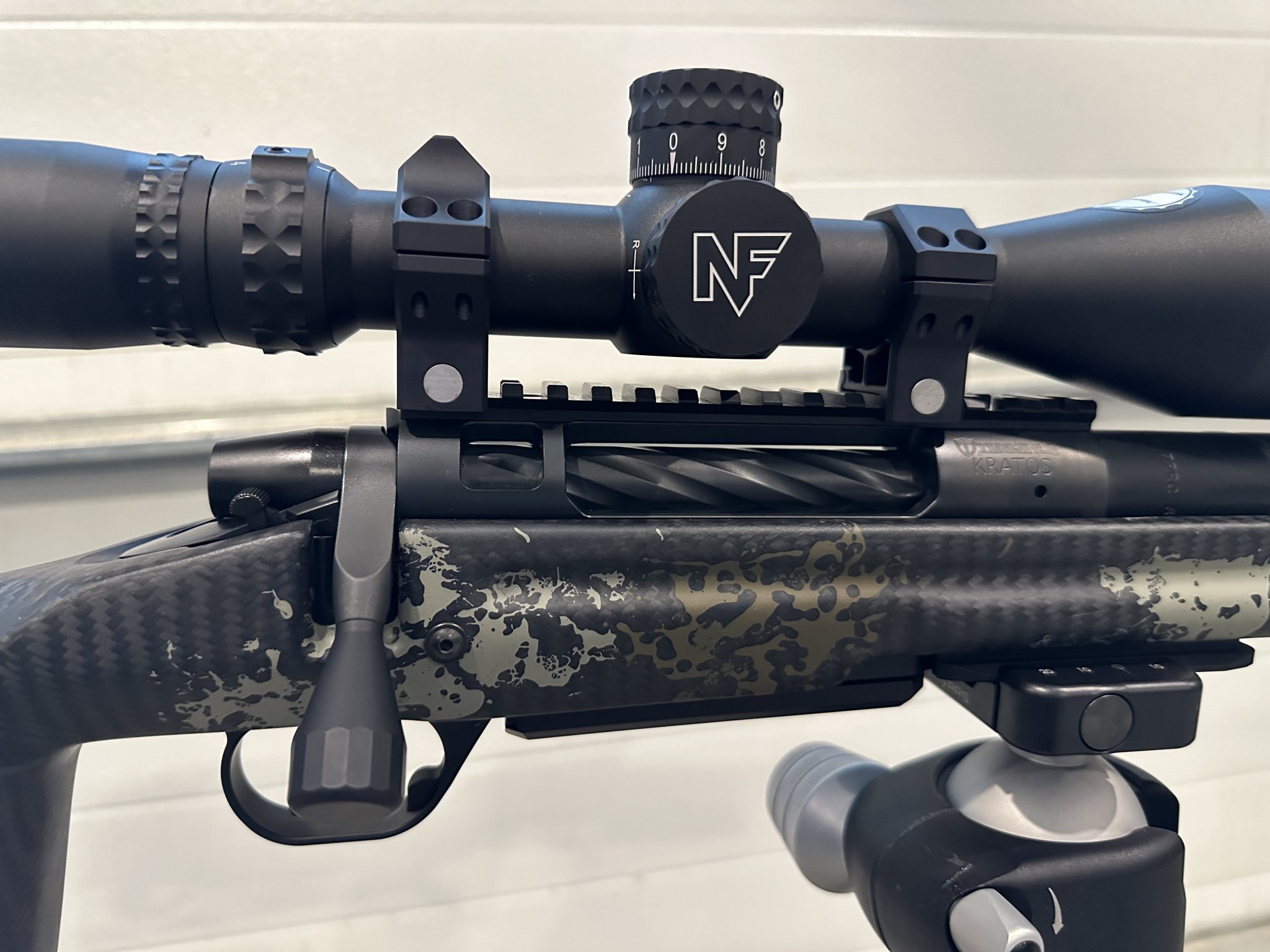

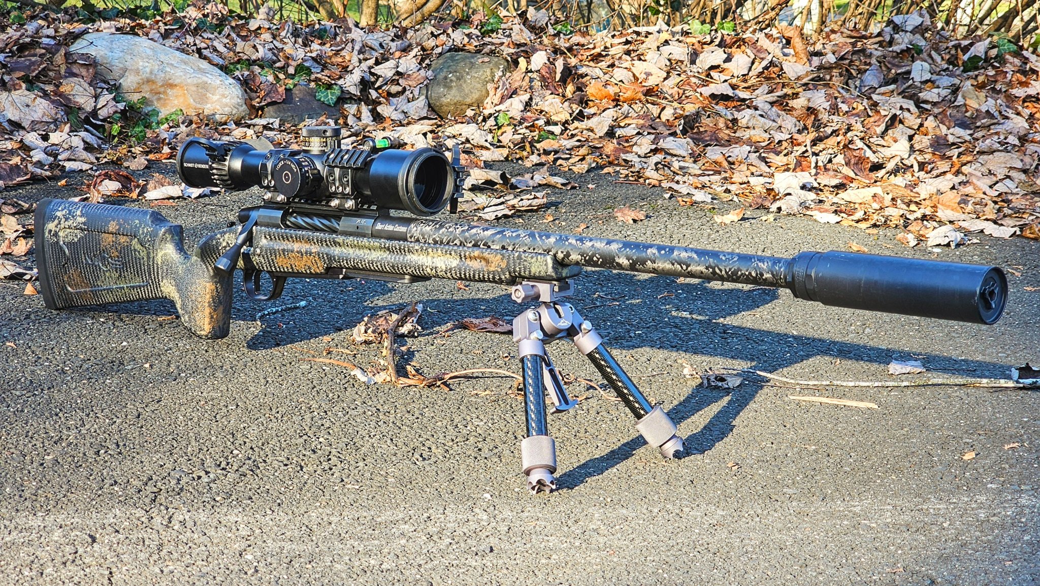

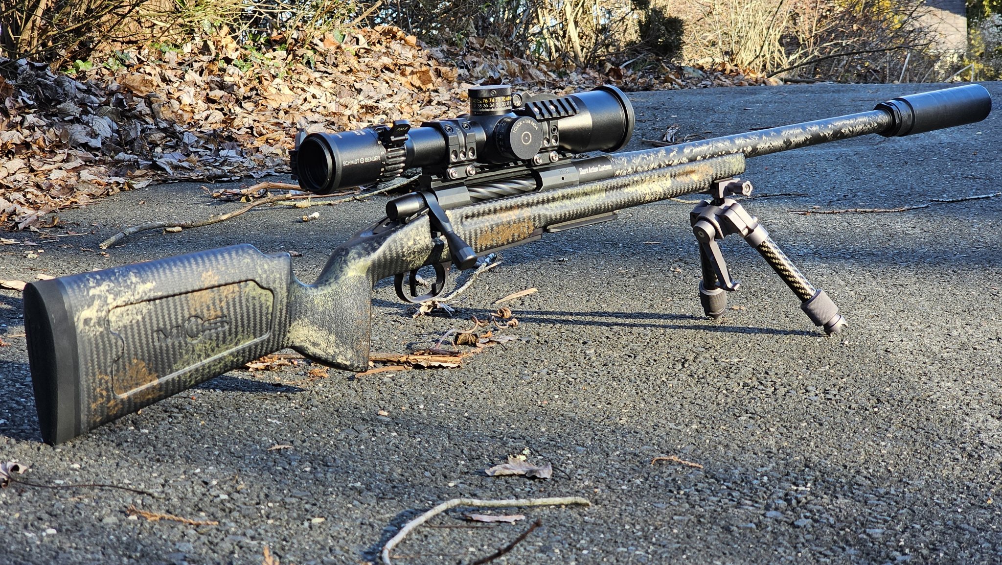

Not sure exactly what it finished at. I’ve used it in a variety of configurations with suppressors and brakes, and weight wasn’t a big concern for me. Originally had it in an HNT 26 but wasn’t a fan of the chassis. I also installed a full length pic rain on the Kratos lite instead of the two short rails it normally uses because it worked better with the mounting length of my scope.
Reactions: mjspeers
Looked to be an NX8 4-32?
Mine will be a Bartlein Rem/Var carbon finished at 24, Kratos Lite. Still debating on stock and scope. Likely a Manners PH with NX8. Want it to be reasonably light and handy.
Reactions: Pat McGroin
For reference on parts, rifle I posted above is about 7.5 pounds without an optic or suppressor
