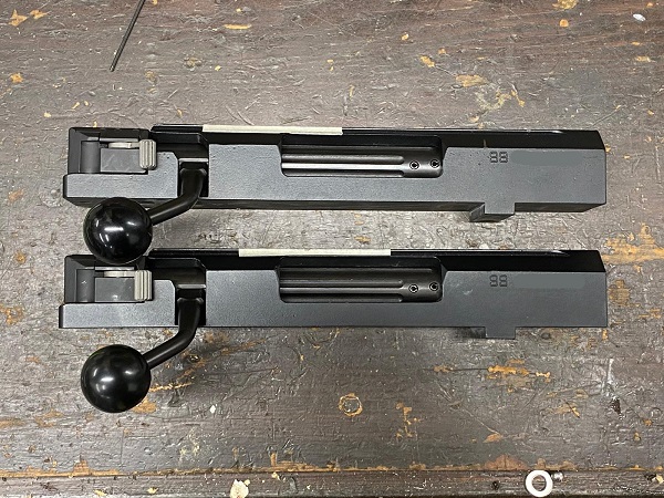

I have very little interest in anything that came after they introduced the quick change barrel feature, but a very rough timeline of their main offerings up until then is as below:
The list is excluding one-offs they did outside of their main lineup. It is also based on action and bolt alone, chassis are whatever. I am aware that I have missed the AXSR, AX Mk3, PSR, and other variants of the AX. I am happy to add these in if anyone can provide me details, or correct anything I have written. I can add more columns if interested.
TimeframeType/NameboltfaceAction lengthNo. of lugsAction type "code"
1984 - unknown but finishedSS (single shot target rifle).308"short"3A (no magwel)
1985 - unknown but finishedPM (CISM target rifle).308"short"3A
1985 - mid 90sPM (sniper).308"short"3A
1986 - early 90sL96.308"short"3A
~1991 - unknownAW Arctic Warfare.308"short"3B
~1994 - early 2000sAT (single shot target, CISM target, AT sniper).22PPC, .308, .300WM, .338LM"short"6C
~1994 - unknownAWM Arctic Warfare Magnum/Supermagnum.300WM, .338LM"long"6D
2002 - 2009AE Mk1.308"short"3E
2009 - 2011AE Mk2.308"short"3E
2010 - 2014AX (pre-2014) "Mk1"?.308"short"3B
2011 - 2013AE Mk3.308"short"3E
2011-2014AX338.338LM"long"6F
2014 - 2024AT.308"short"6G
2014 -AX (post-2014) "Mk2"?.308"short"6G
2014 -AXMC.308, .300WM, .338LM"long"6H
:sleep:ATX.308"short"6G
:sleep:ATXC.308"short"6I

It sounds like you'd best be looking for an AT.
Any of the first four on the list you can forget about, especially the L96 and PM CISM. L96s were British (and Irish contract) military issue. 12 of the Irish contract ones were imported into the US a few years ago but will command an incredibly high price, perhaps $30k or more. PMs were made on order for police and law enforcement, and non-British military, but a very few were sold commercially. There are also a few PMs in the States, but again, same sort of money. PM CISMs are virtually non-existent outside of military CISM shooting team armouries, mainly in Sweden, Norway, and Oman. PM and L96 are the same action and chassis, but different name by end user and subtle differences in accoutrements. Some very late PMs were folding.
AW and AE are also very expensive, about $10k+ for an AW and bit less for an AE. They are basically the same action mechanically except the AE is round and AW is square. AW is glued to the chassis and AE isn't and has a Rem700 style recoil lug. Only issue with the AE is that the Mk1 and possibly Mk2 have unique mags, whereas Mk3 uses AICS. The original 90s AT is almost non-existent except in wooden target rifle form. The sniper ATs are extremely rare and not many know about them. They're basically an AW with a round tang, AE MK1/2 style shroud and safety, and AWM 6-lug boltface.
The 2014-2024 AT is also available in fixed thumbhole chassis and are quite a bit cheaper, perhaps $4000 minimum. You'll always find some opportunistic listings that are overpriced on account of the AT being discontinued and therefore "rare" so try to shop around. There are lots of spares for these still around and are fine rifles, especially with the quick change barrel feature. The skins aren't as sleek as the OG skins on an AW and AE because they are multi-panel. You'll just have to live with that unless you can fork out $10k+ for an AW.

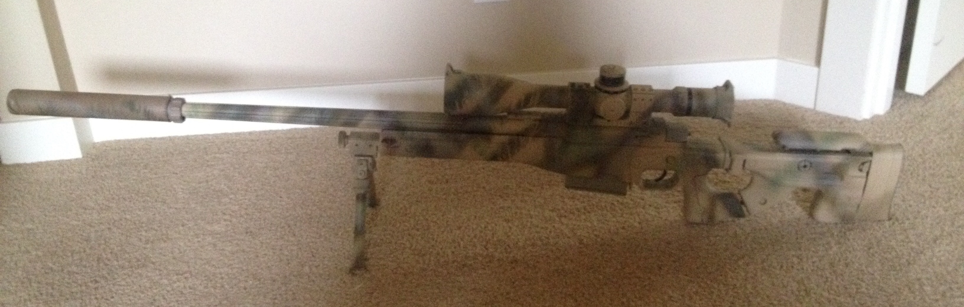

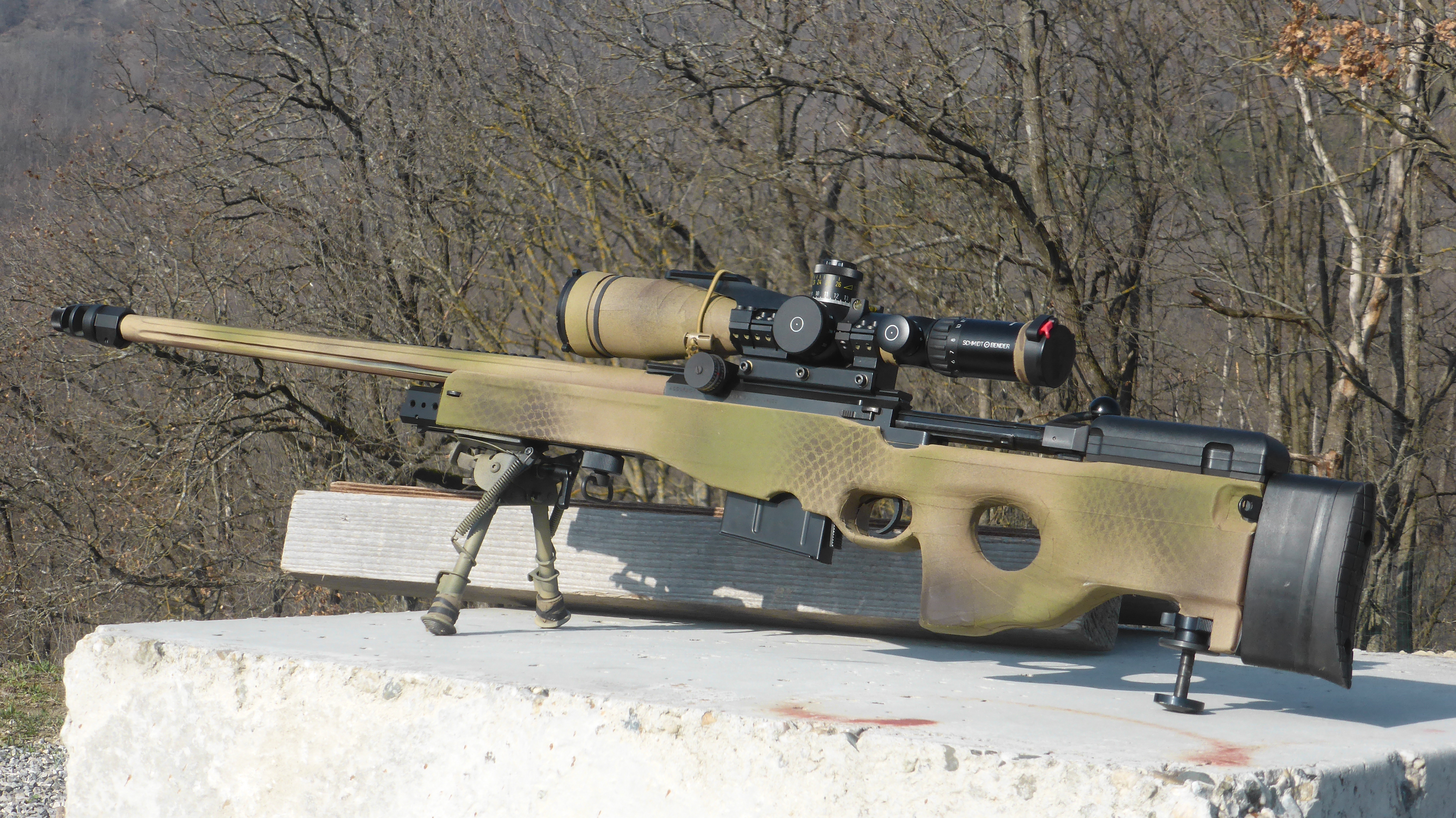

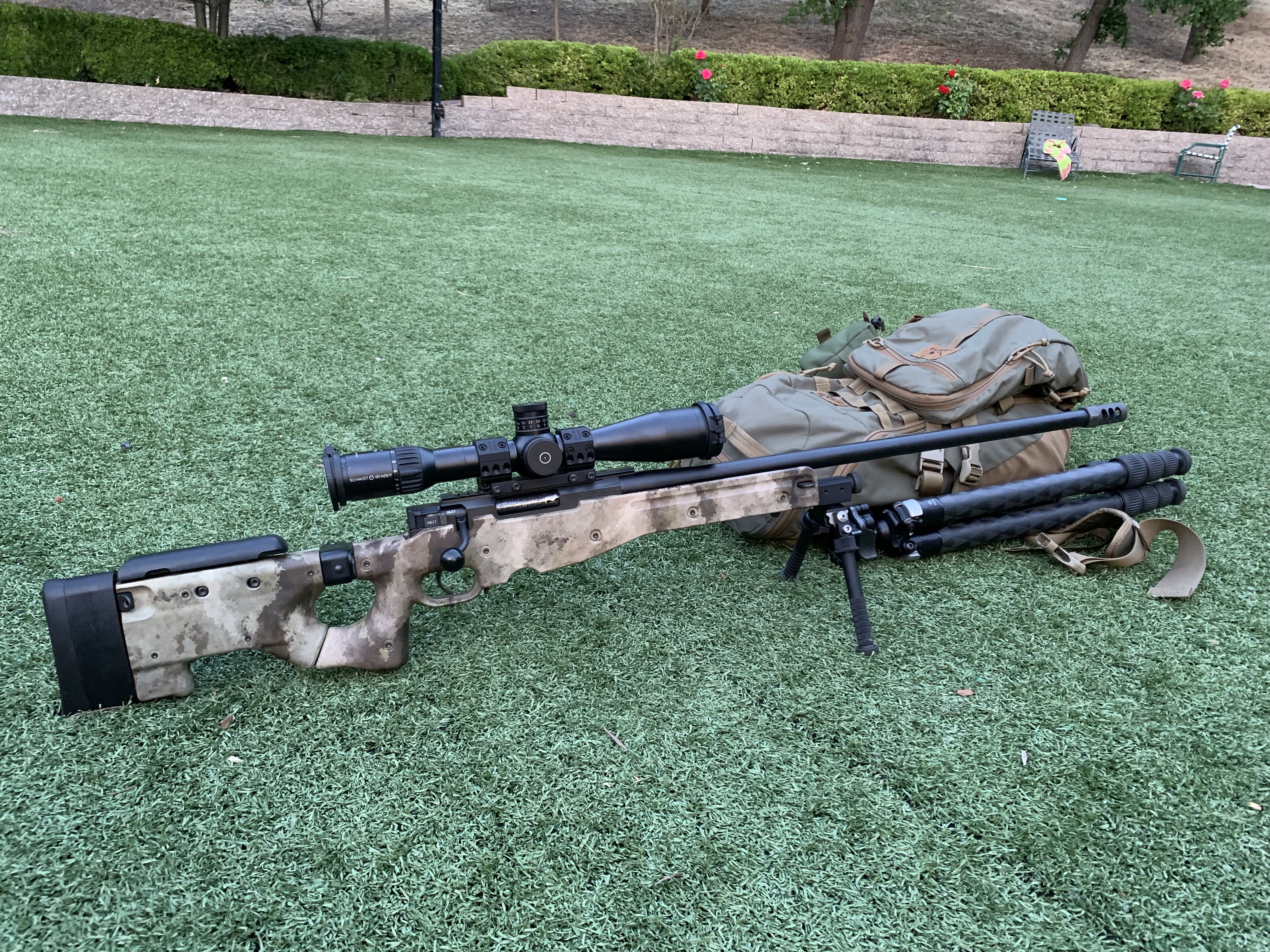

I feel like those camo skins look familiar. I bought and then sold a SA AW on the hide with similar skins some time ago. Looks good on the AWM.
The AWM came out of KY.
I pulled my rifle book and found the original ad and correspondence. The seller said it is ATACS camo dip that was done by GAP.

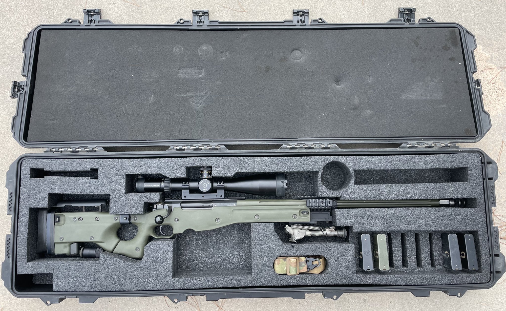

It was given to me, so I’m not exactly sure. But, based on who I got it from, I think it’s probably some kind of Mk13 case. It’s a Pelican…
If I knew where to get another set of foam similar to this, I’d set up a case for my AX as well.
pretty sure those are Hardigg Storm iM3300 cases. but my AWSM will barely fit it when extended. But, my dumbass didnt remember that MK13s are stored folded in this cases so thats what i will do.
although yours fits completely extended
getting the right foam is a challenge but not too bad.
You might be right and it may not be a Pelican. I can take a look at it tomorrow and confirm.
Is there a place that sells pre-cut foam?
my case builder does. if you have some rudimentary sketching skills and can upload a picture. ive done it once, had to trim some as i didnt know what i needed.
i bet yours is an AI branded Explorer case. those cases are like a grand, atleast.
