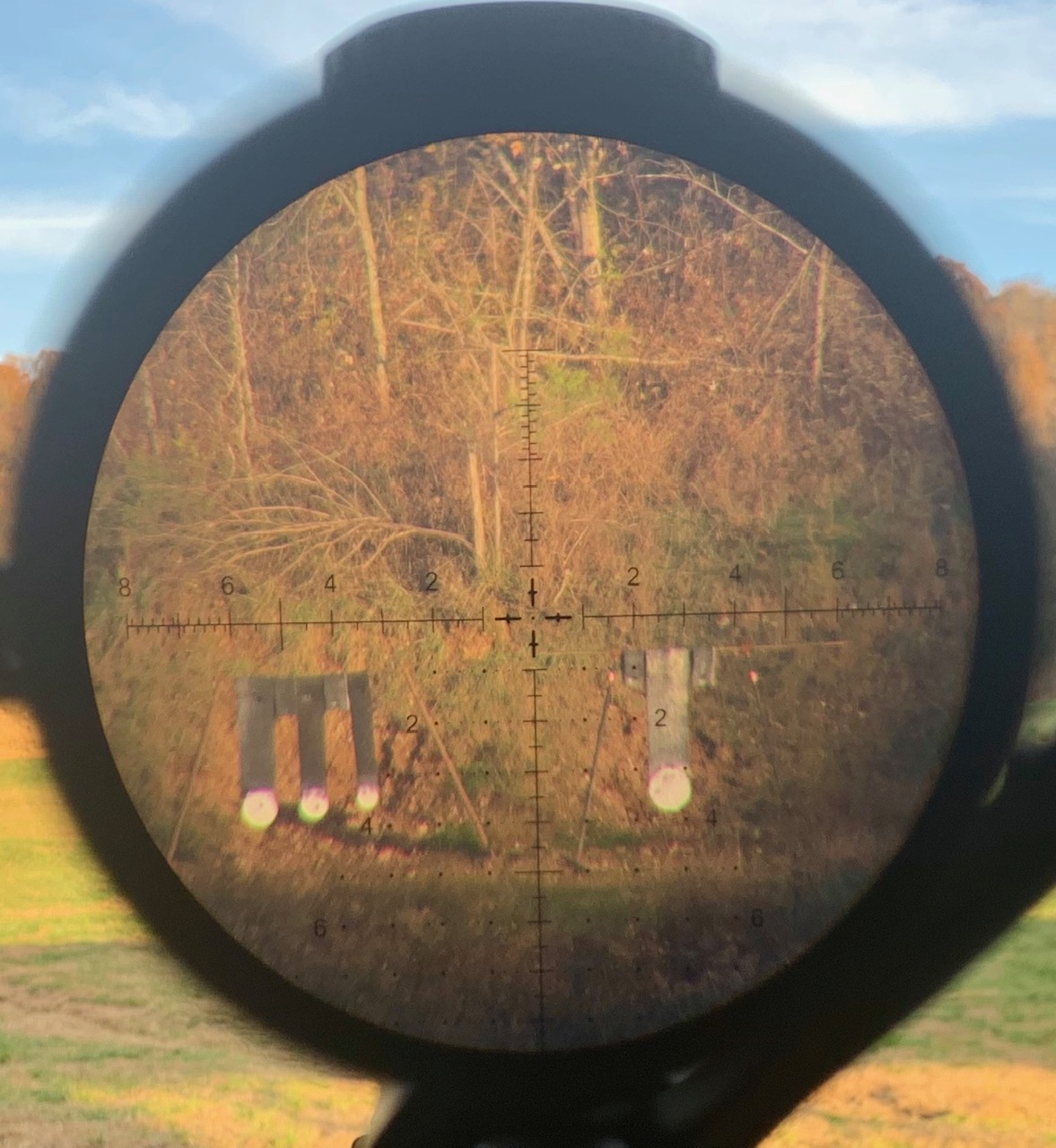

FYI/FWIW, I had posted this in another thread but it'd probably help some guys here - the representation/rendering of the VPR reticle on Arken's site isn't 100% accurate: in the pics on their site it makes it seem like all the lines in the VPR reticle are the same thickness/thinness, but IRL the "crosshair/X" lines are actually a bit bolder/thicker; it's actually better in-person IMO.
The lines for hold-off's and the "Christmas tree" stuff is still really fine/thin (but still usable), which I like because the whole reticle FOV seems a lot less busy than many reticles I've looked through, but the thicker "crosshair/X" lines draw your eyes to the center and make the more common .2-1.0mil hold-off's easy and fast.

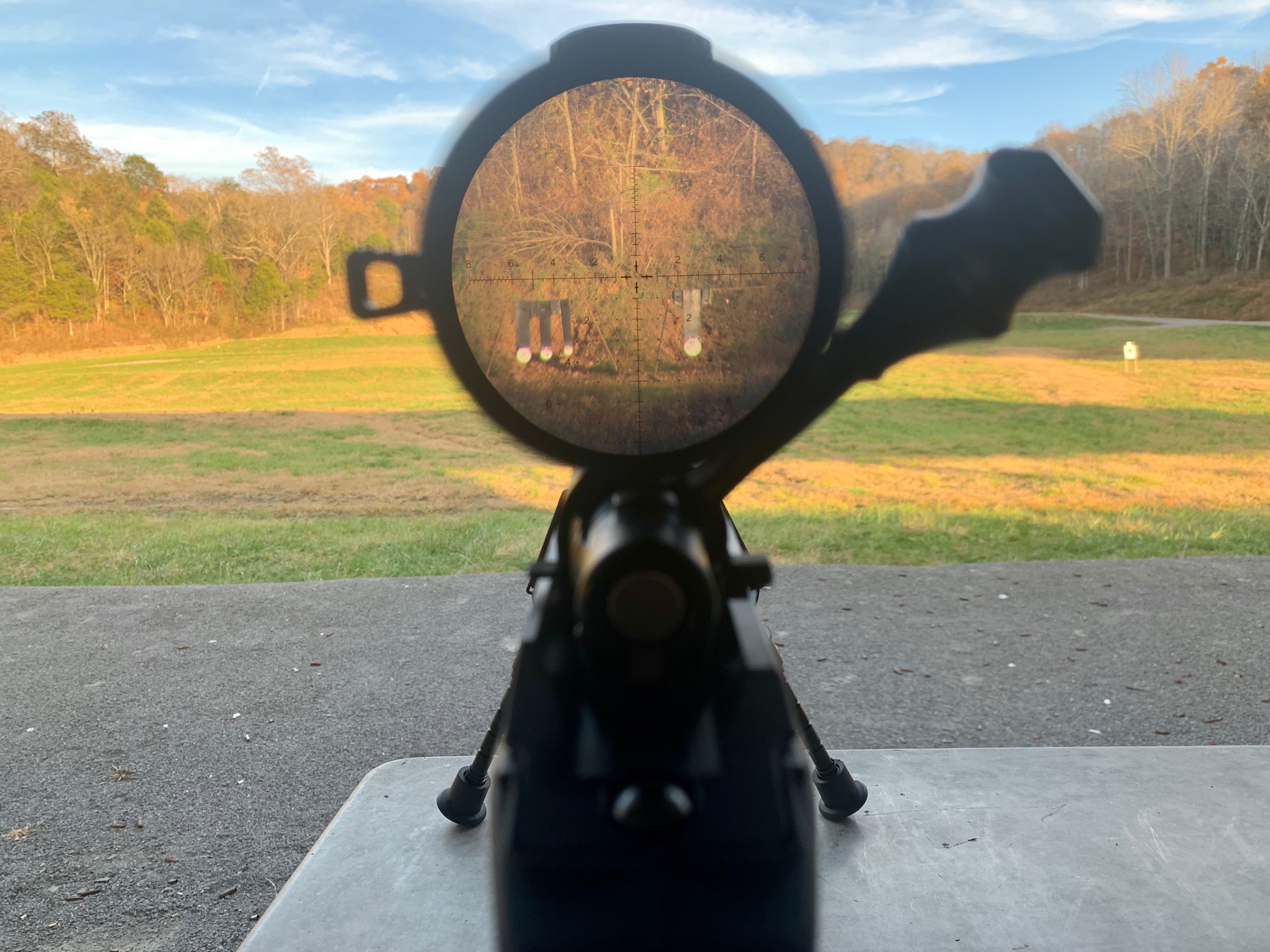

This is just a shitty iPhone pic (never knew it was such a pain in the ass to capture a reticle pic with an iPhone lol), and does not represent the glass (makes it look shitty like there's tons of chromatic aberration, it's far better in-person), there is some chromatic aberration present in the glass for sure IRL, but it's not too bad and the parallax/focus can dial/tune most/all of it out and the image cleans up, but hopefully you can see the thicker "crosshair/X" I'm talking about...
Scope is at 24x, plates are at 400 yards, second pic is just a blow-up of the first:

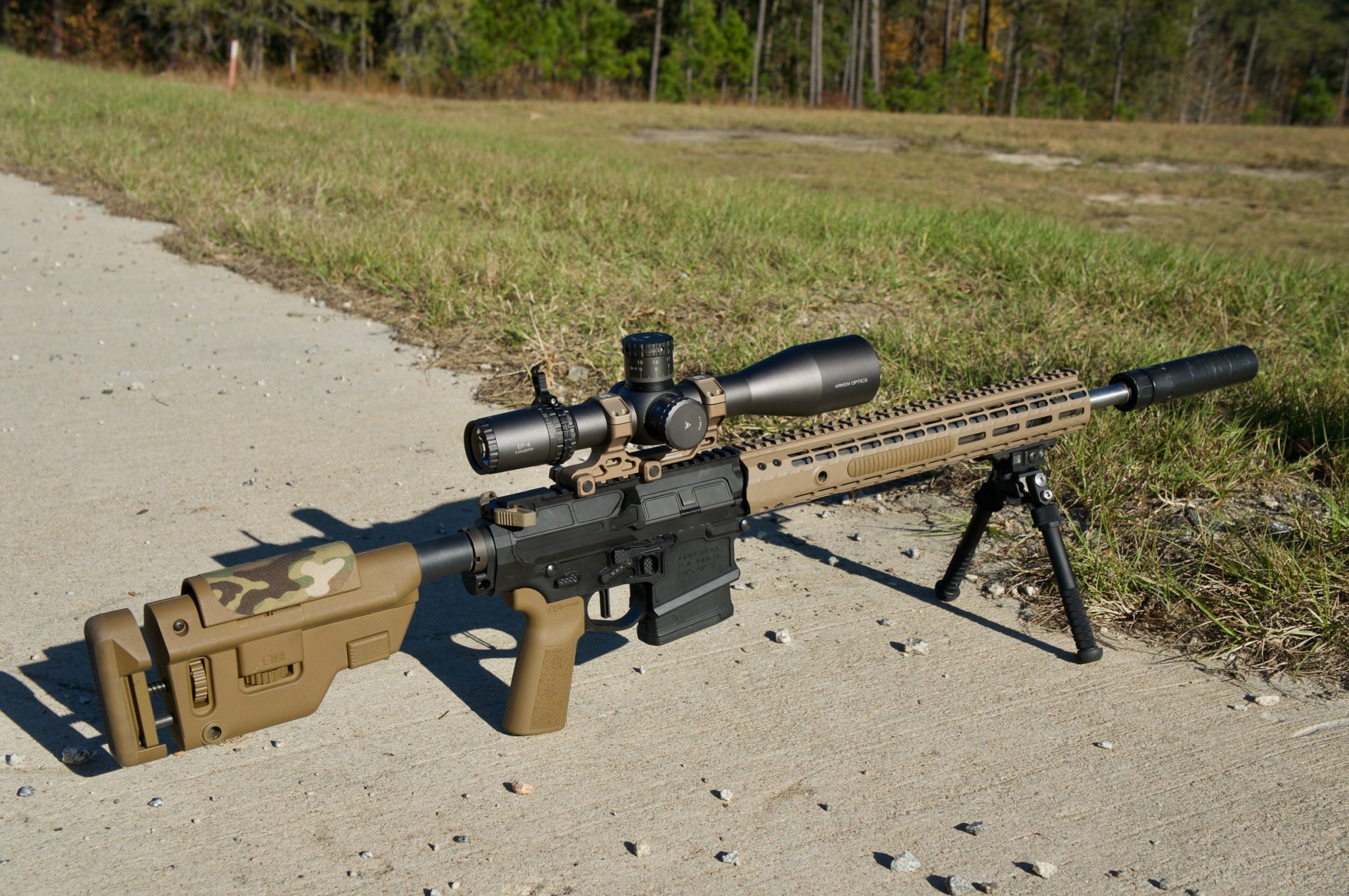

First impressions; hell of a lot of scope for the money!!
This rifle is my trainer and loaner for when we run courses. She a pretty run of the mill .308 Franken rifle. But shoots tight, is super reliable and predictable with 175gr match ammo. What I do want to highlight is the optic. This is the Arken Optics USAEP-4 6-24x I picked up a few weeks back. Other than zeroing the rifle I hadn’t spent much time behind it. The more time I spend behind the optic the more impressed I am. The glass is what really sets this optic apart from anything else in its class. It is clear that Arken spent the majority of their focus on the glass quality (puns intended). I am super impressed with the clarity, crispness of the reticle and color transmission. I don’t have any quantifiable evidence to bring to you on it’s performance thus far. But I can say that switching to this after spending time on other quality optics, I wasn’t disappointed.
With any optic the trade space you have to give up to have top of the line features all around, is price. Since Arken didn't want to compromise on price, I feel that they sacrificed some on features. While overall feel and usability of the scope is still well above other scopes in its class. I did recognize a few things I think are worth stating.
1.Turrets: these track very accurately as has been demonstrated by numerous other reviews. But, they aren’t very crisp. They are almost gritty, and I would compare them to maybe a PST or 2010 era MK4. This is my personal feeling, I would like to see that cleaned up in the Gen II.
2. Zero stop: it works, is easy to set-up and needs almost no instruction. It is also unlike anything else I’ve used. There a set screw to set the zero-stop, and another set screw to hold in the zero-stop set screw. Which I promptly lost the second set screw upon firing a mag through my .308 AR-10. The recoil was enough to back the screw out and now it’s lost forever. I suppose Loctite would fix that, but I am hesitant to use such things on optics. I will be contacting customer service for a replacement screw and just holding-over for engagements in the interim.
3. Parallax: this adjustment was finicky in my opinion. I was able to properly set my parallax, it just took me much longer to find the sweet spot. Nothing dramatic, but probably 5 seconds longer than my MK5. Not a deal breaker, but worth noting

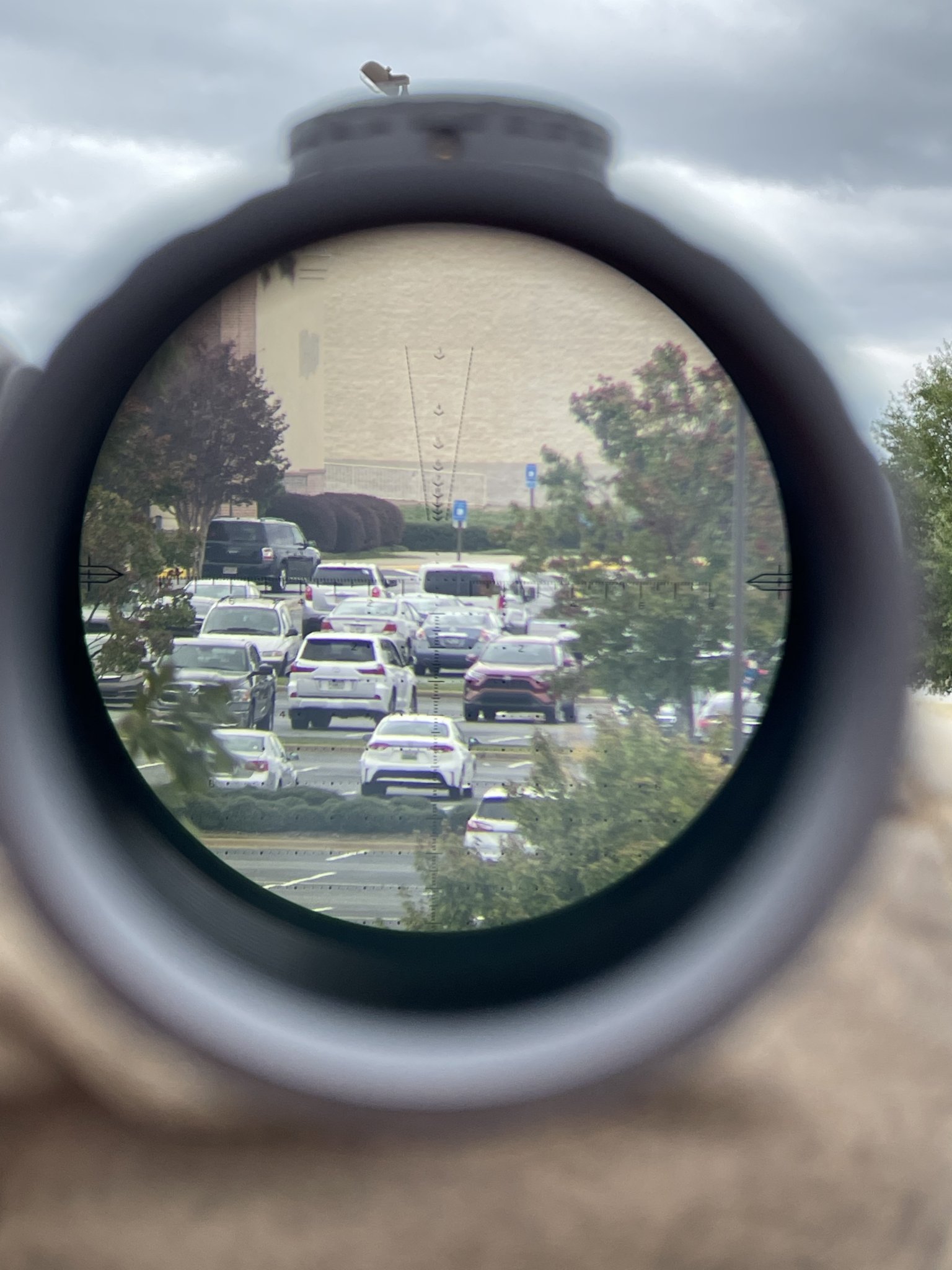

Well, I just had a little look outside. All looks good except the parallax; I can not get it to focus.
:confused:
When i get it in focus as close as possible and I move my head behind the scope the reticle moves off the target. Adjusting the side focus helps but stops before I can get a steady sight picture where the crosshair does not move away from the target.
I compared / doublechecked this by using another scope, an older vortex viper in the same range, and sure enough, no issues there, so it's not my eyes, it's the parallax being out of whack..
Let's see how good the customer service is...
Yep, done all that. Have about 15 scopes in various pricing ranges. It's the scope, not operator error unfortunately.
