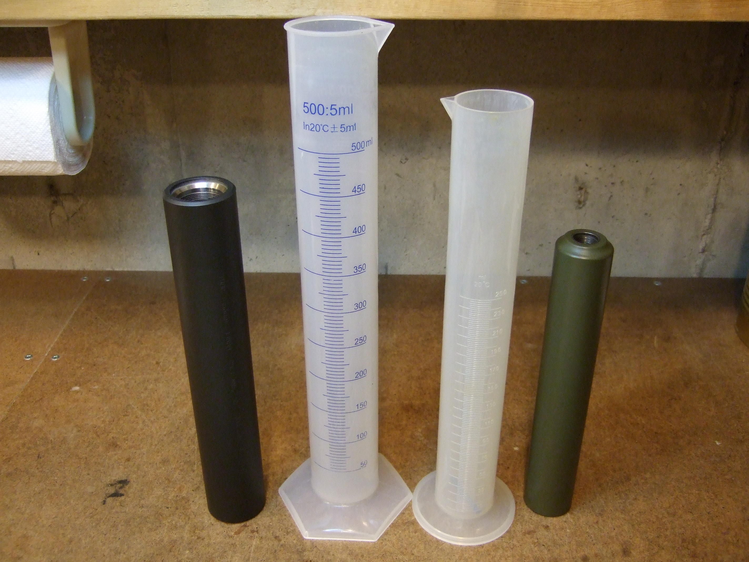

I use plastic graduated cylinders - tall and skinny. Perfect for conserving the amount of chemicals that you use.
