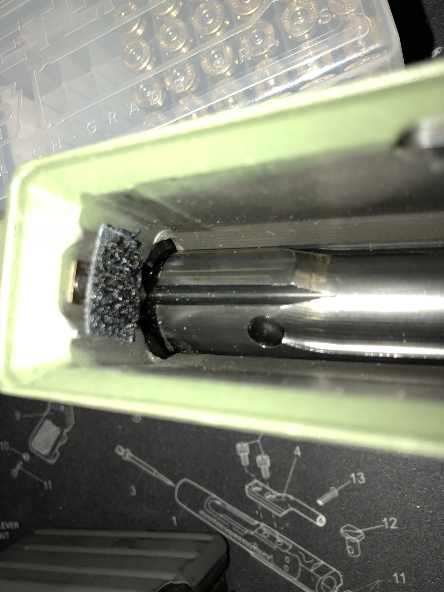

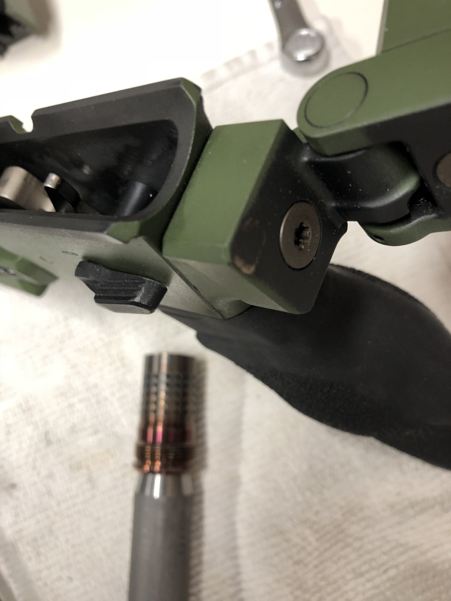

@Scotch_egg I’m gonna need a picture of the area you think it’s contacting. I don’t know if I’m following what you’re saying
I have added the image above. Hopefully you can see where the contact is being made on the receiver.
7044568
Naw brother mine doesn’t do or look like that. That does not look right to me. Why is it always the Guys way overseas who have issues haha. Sorry man.

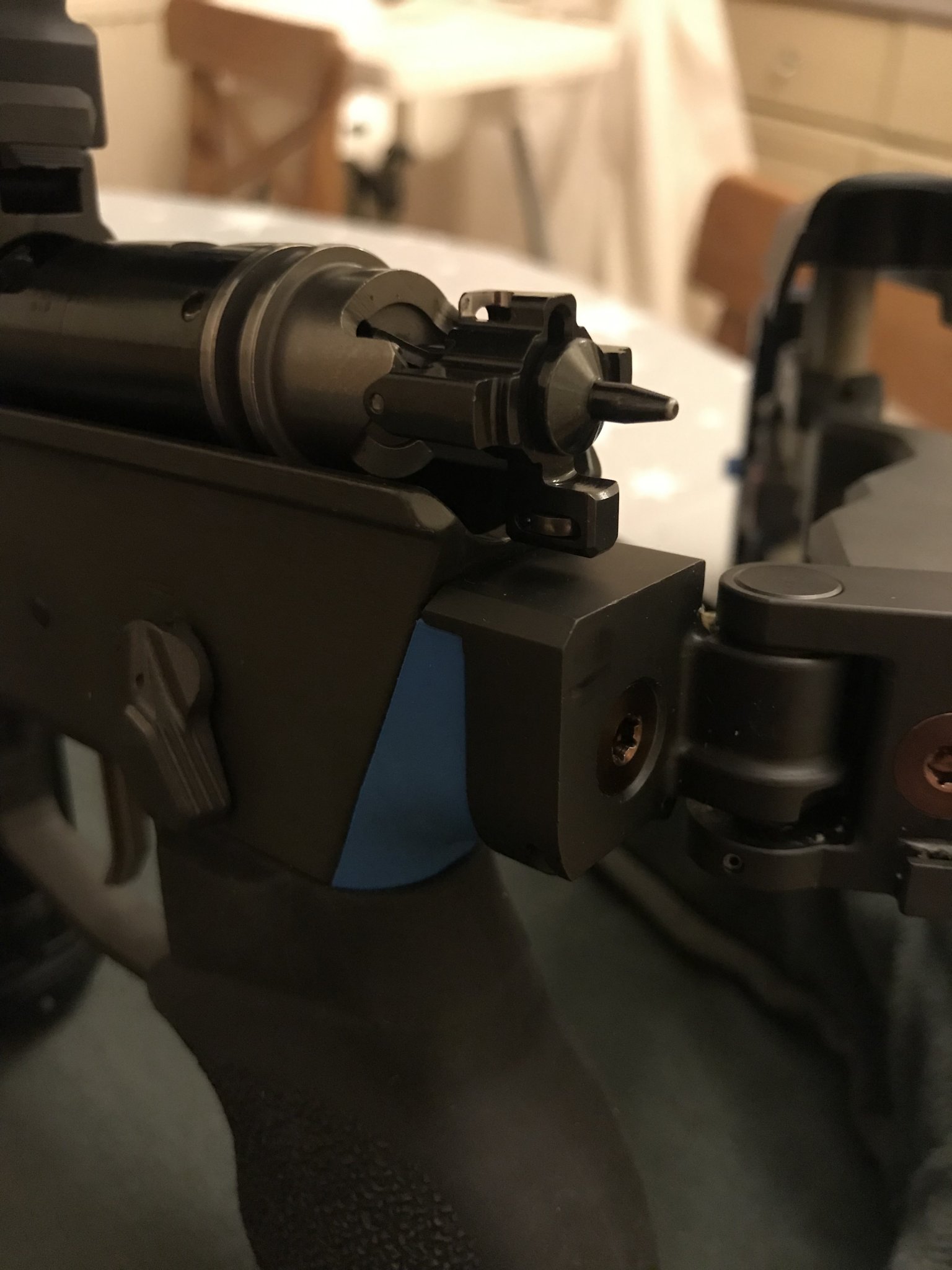

I happen to have mine apart right now. You’ll notice with a couple hundred rounds and countless dry fires mine is clean.

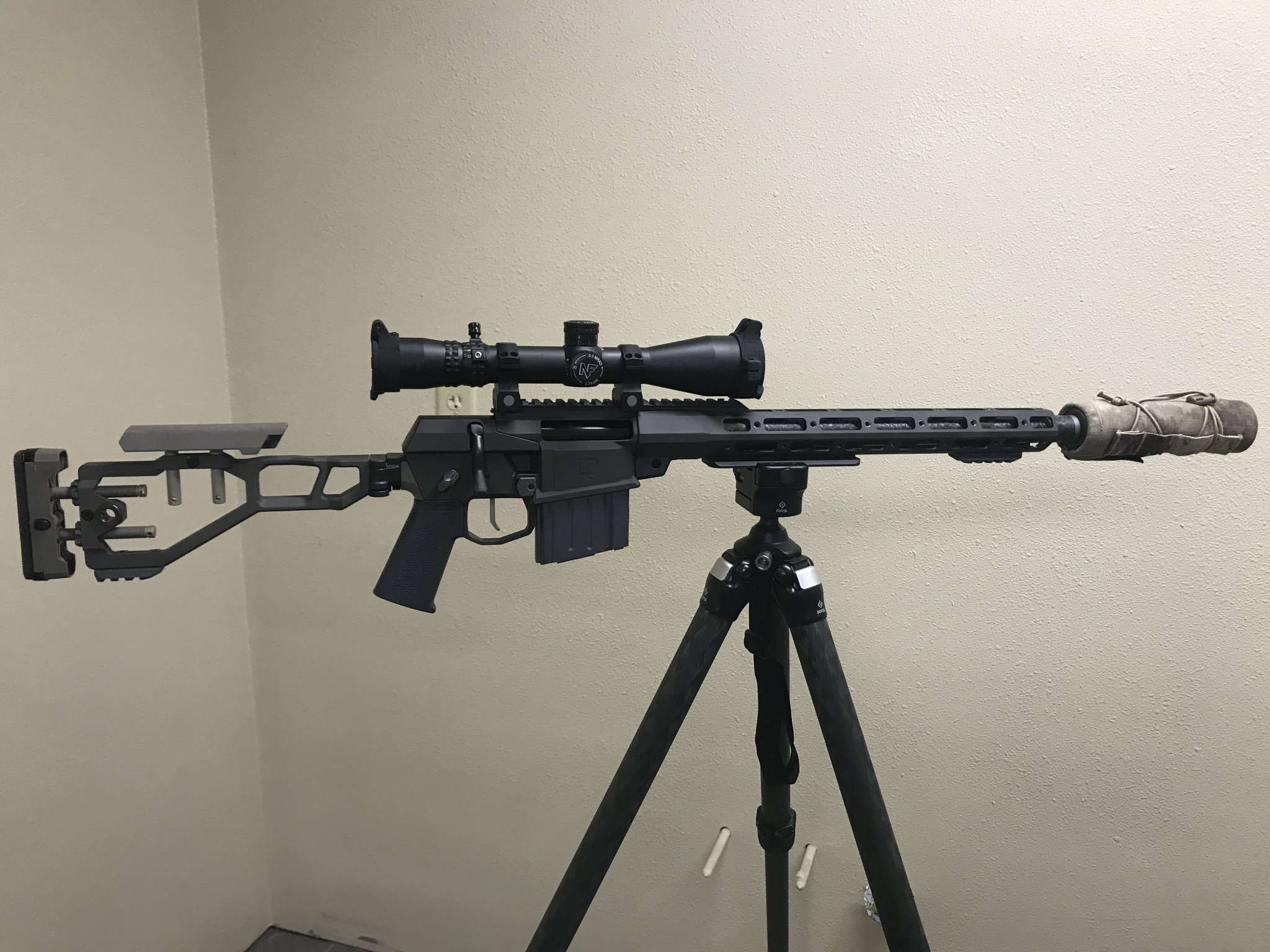

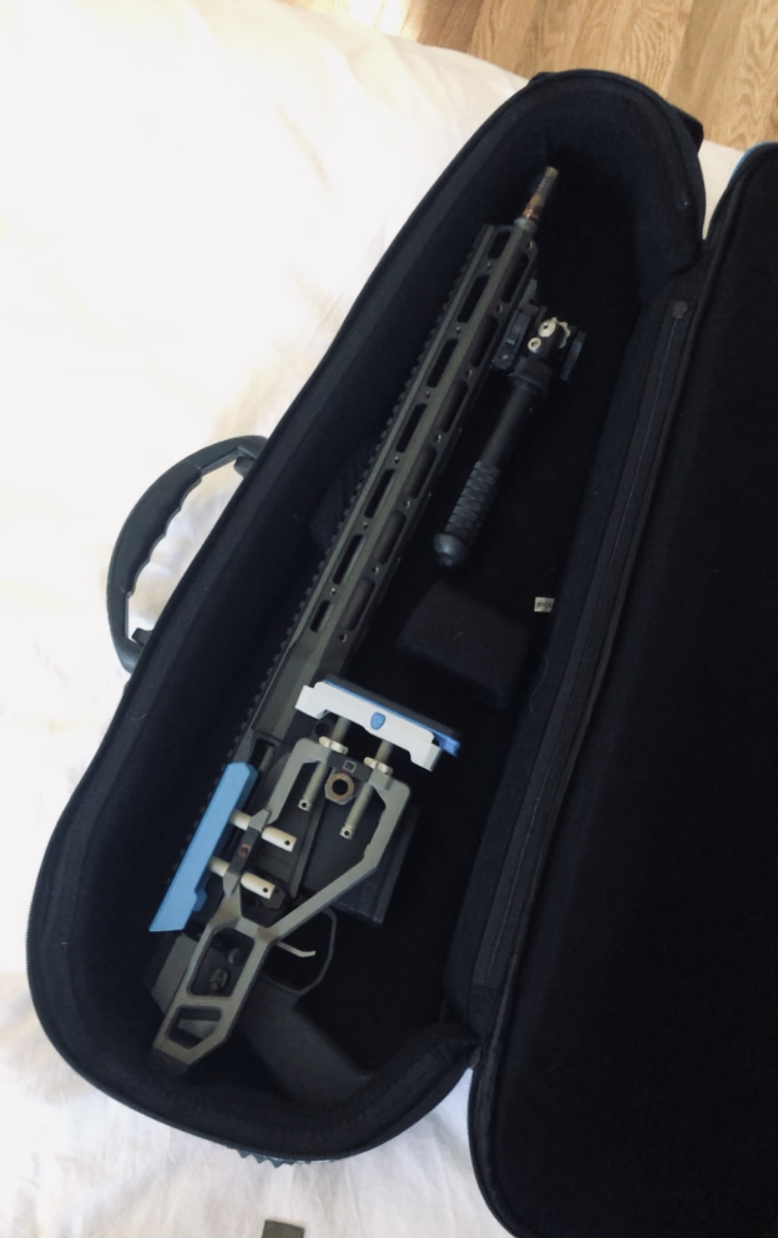

My Q journey ends today. Realized I need a new car and the Fix is first on the list to go... unfortunately. Building it at Q made it worth buying in the end. Fun fact I thought I'd share... I got the same ukelele case the original prototype was shipped in. Ended up matching my rifle perfectly. Think it was a tenor sized uke' case.
Are you going to list in the Post Exchange?
@derk how has your rifle shot? How many rounds have you put on it? What’s your favorite thing and least favorite thing about it?
0 rounds :(. It's a virgin... I was saving for a Tangent Theta scope to put on it but I decided I'd probably use a new Audi more. Favorite thing in my limited experience with it is size.

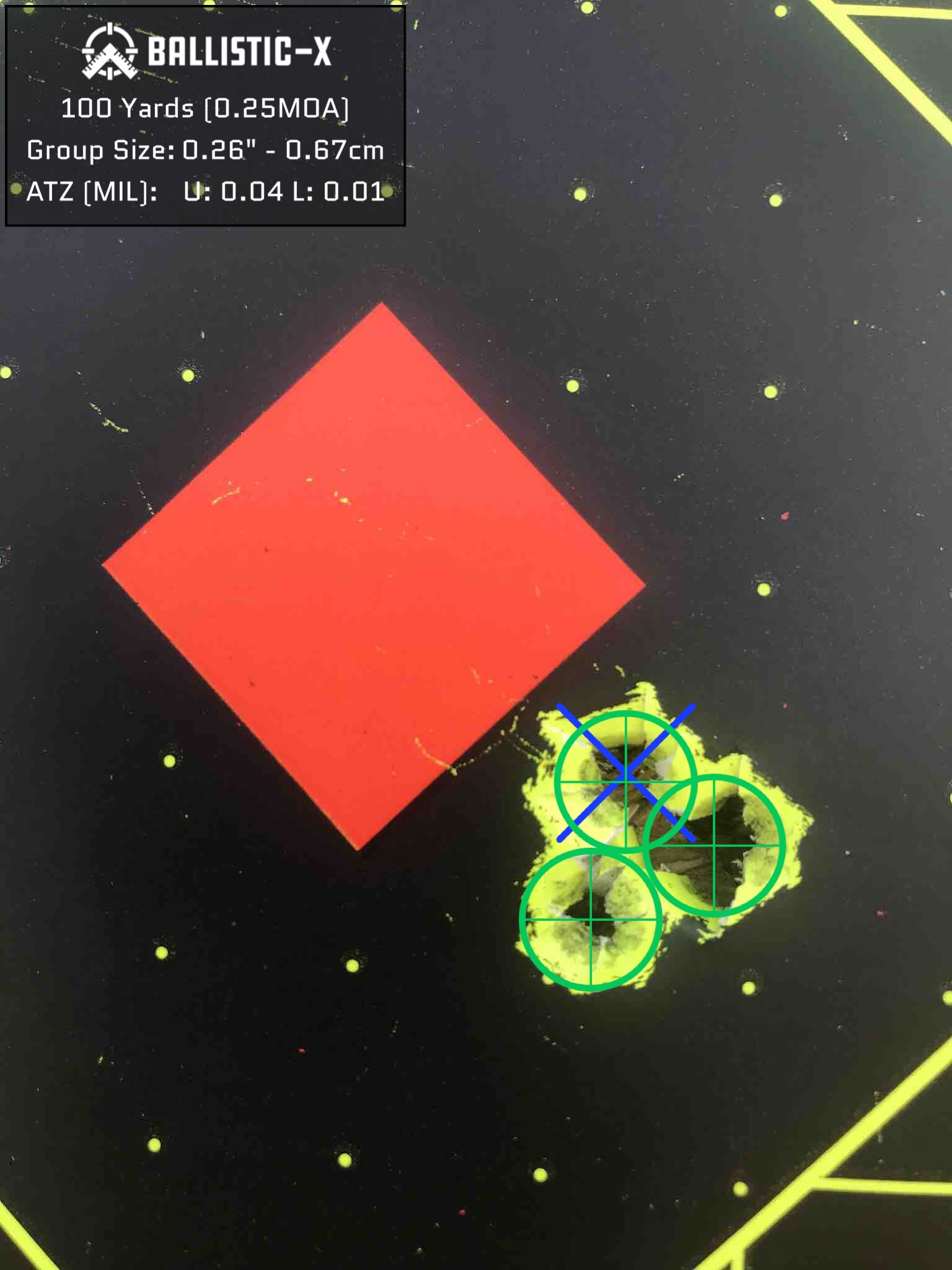

Just got this little Fix set up and running. I tried to keep it light for the kid. It is showing promise. These are the third, fourth, and fifth shots I took after getting it put together using the Hornady 143 eldx precision hunter at 100 yards. I got movistar’s DT Proof in it.View attachment 7045307View attachment 7045308
That's an awesome looking Fix and an even better looking group.
What rings/height and caps are those? And would that same setup fit with full length rail (can't really tell by the photo)? I ordered the same NF 4-16 about a month ago and have two sets of rings that I'll have to choose from.
Yeah that barrel is a shooter for sure. I shot it a lot better after I discovered the screw was contacting. But you’re a better shot than I am.
Assuming it’s 100 yards that’s .25 MOA

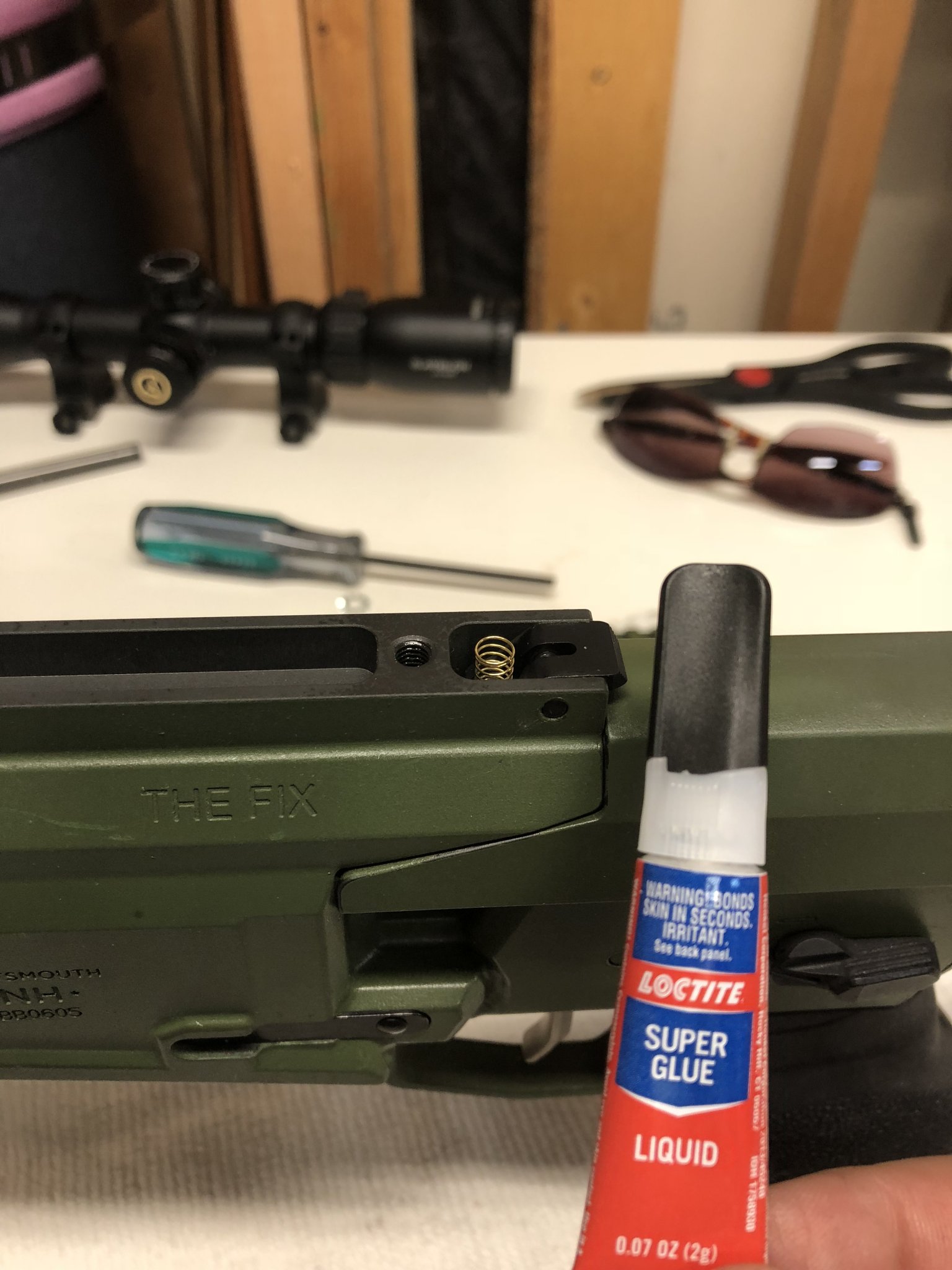

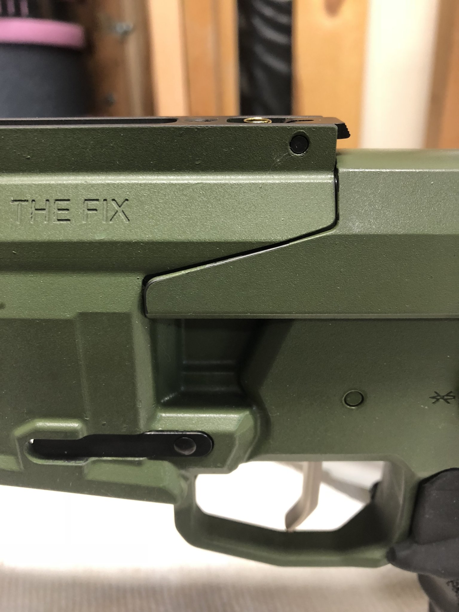

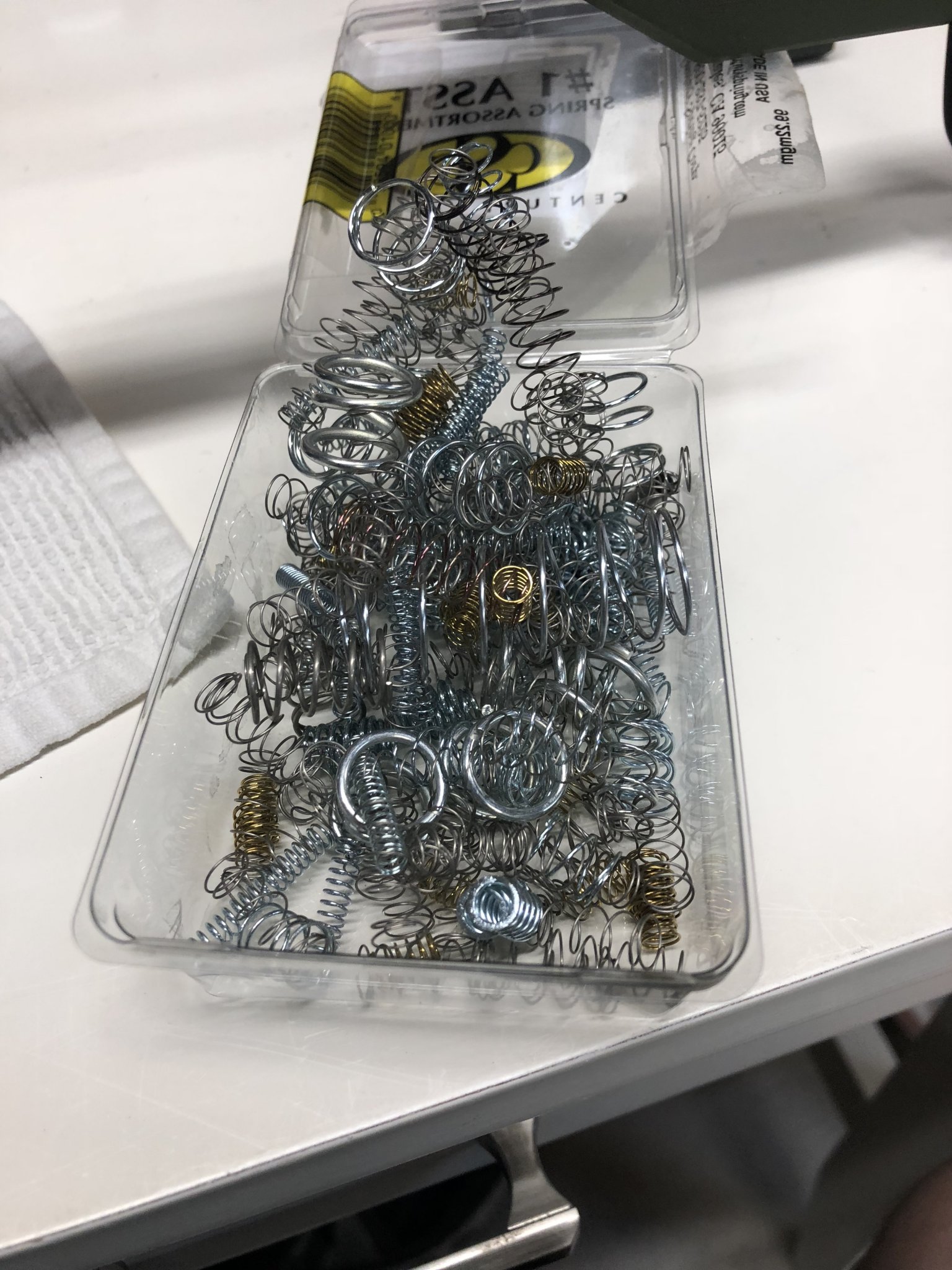

Welcome to the official Fix bolt release Fix. I bought a 3 dollar pack of assorted springs from the hard ware store. I want one that doesn’t get lost easy (still have my stock one) but that thing should have been notched in there or something. So a dallop of super glue and a spring that is lighter weight and flush with the top of the receiver. What I have is an easier to manipulate bolt release but one that still functions 100%. Don’t have to worry about bending the rail or crushing the spring. Or losing it.

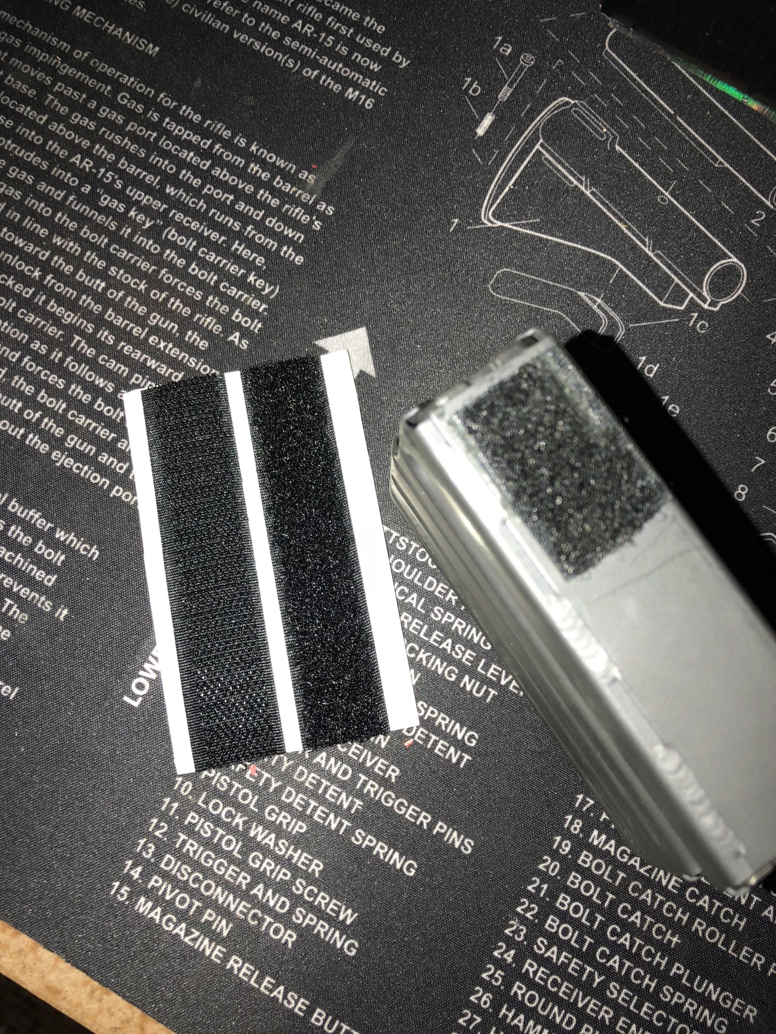

Can you please snap a pic of your Velcro mod to the mag well. Noticed lots of movement on the KAC mag when cycling.
As long as it feeds 100%, I wouldn't mess with it. I didn't used any KAC mags (just pmags) but wrapping a ranger band around the mag and pushing it up into the magwell really seemed to help with the excess movement but was never able to get the rifle to feed 100%.

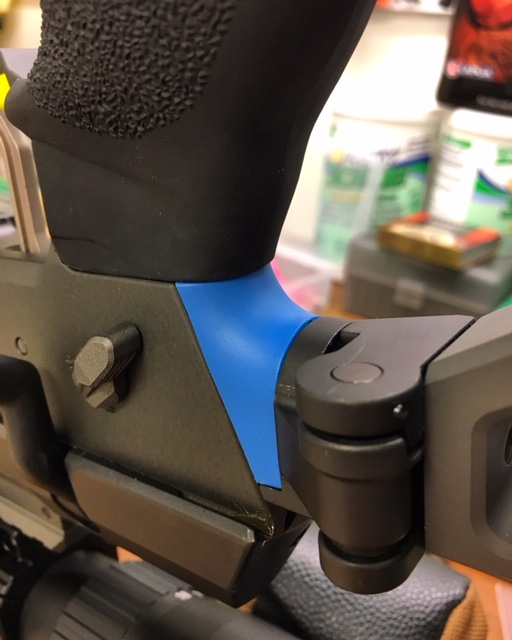

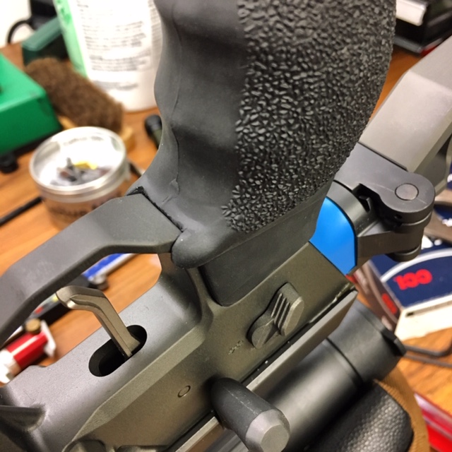

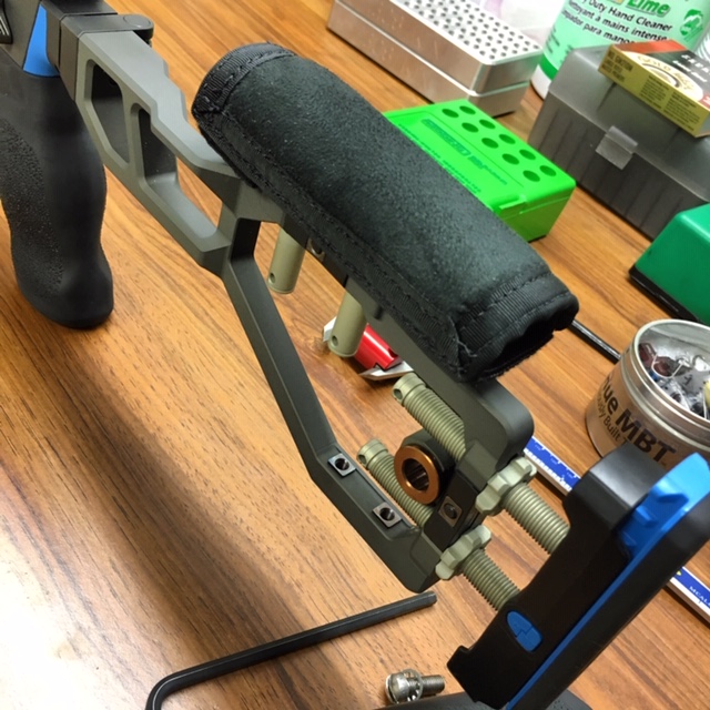

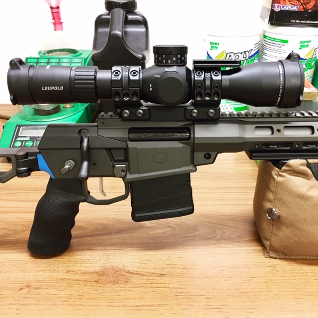

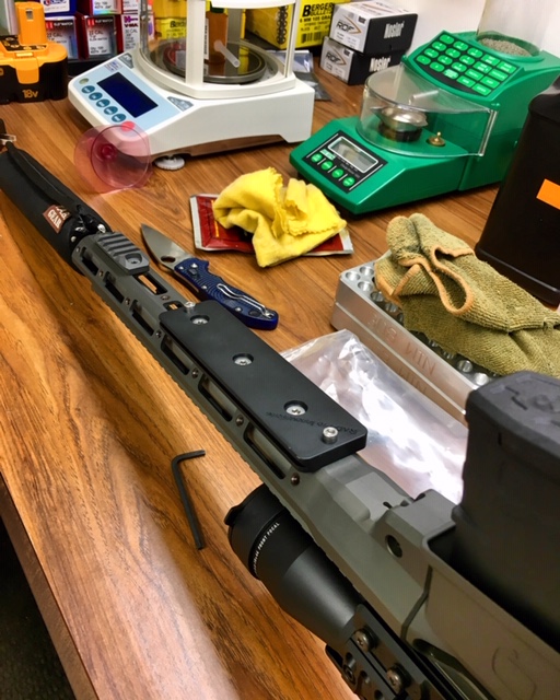

Dropped on a Ergo grip, Weibad Cheek Pad, and RadPro Arca plate.

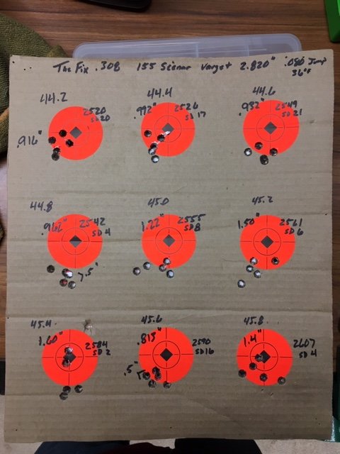

With 50 rounds thru the GM barrel, I headed out for initial load development with some mixed bag 155 Lapua Scenar's I have laying around with Varget. While the lightweight will certainly expose your flaws as a shooter, it showed me some obvious potential. 44.8g was a glaring node in all aspects. Great SD, consistent POI, and good group size dead in the middle of a velocity plateau. I was likely creeping up on another node around 46 but no sense in pushing the brass that hard for an extra 60fps. The 16.5" barrel sees diminishing returns quickly when trying to load them hot.

Absolutely man. I’ll be home tonight and get it done. It seems like the mag well is a little big. What shimming it does is put it on the right level. You can shim the front of each mag or the magwell itself. I tried Pmags and they were not even close to the ability of the KAC. There was a kid in here a while back who was putting rubber bands around the pmags to get them to feed so I don’t think Pmags will solve any issues. The issue seems to be getting the angle the mags sits correct. In my opinion the front of the mag dips too low. That’s why shimming the front of the mag or the front of the mag well wirh adhesive Velcro really helped. Mine is 100% smooth and reliable at any speed and with multiple projectiles. Before shimming I only had issues when I went slow.
I’ve only got half a box through it but it looked like it had lots of play in there and had a couple rounds feed sloppily. Haven’t tried the Pmag so will do that. Just want to get it right sooner than later. Thanks.
Definitely not saying to try pmags.... supposedly the KAC mags work better, I just never got around to trying them out. I would have a misfeed with the 10 round pmags about 3-5% of the time and about 10% with the 20 round pmags.... not something I would want to get involved with. Maybe others have had better luck, but that was my experience. Q needs to make some changes to that magwell if you ask me. I would say it is WASR 10 bad, but that would be giving the Fix's magwell a little too much credit. If your rifle is not having misfeeds (completely locking up when trying to feed a round), don't touch it because that is as much as you can ask for.
@sodakhunter here is the Velcro shim. Mag fits tight and won’t move but isn’t hard to pull out. It doesn’t drop free but isn’t hard to remove either. It feeds fine without it but feeds perfectly with it. The other option is to shim the front of each mag. I attached a pic of that as well.

Thanks again. Just want to get the bugs worked out. I do like the platform so far.
