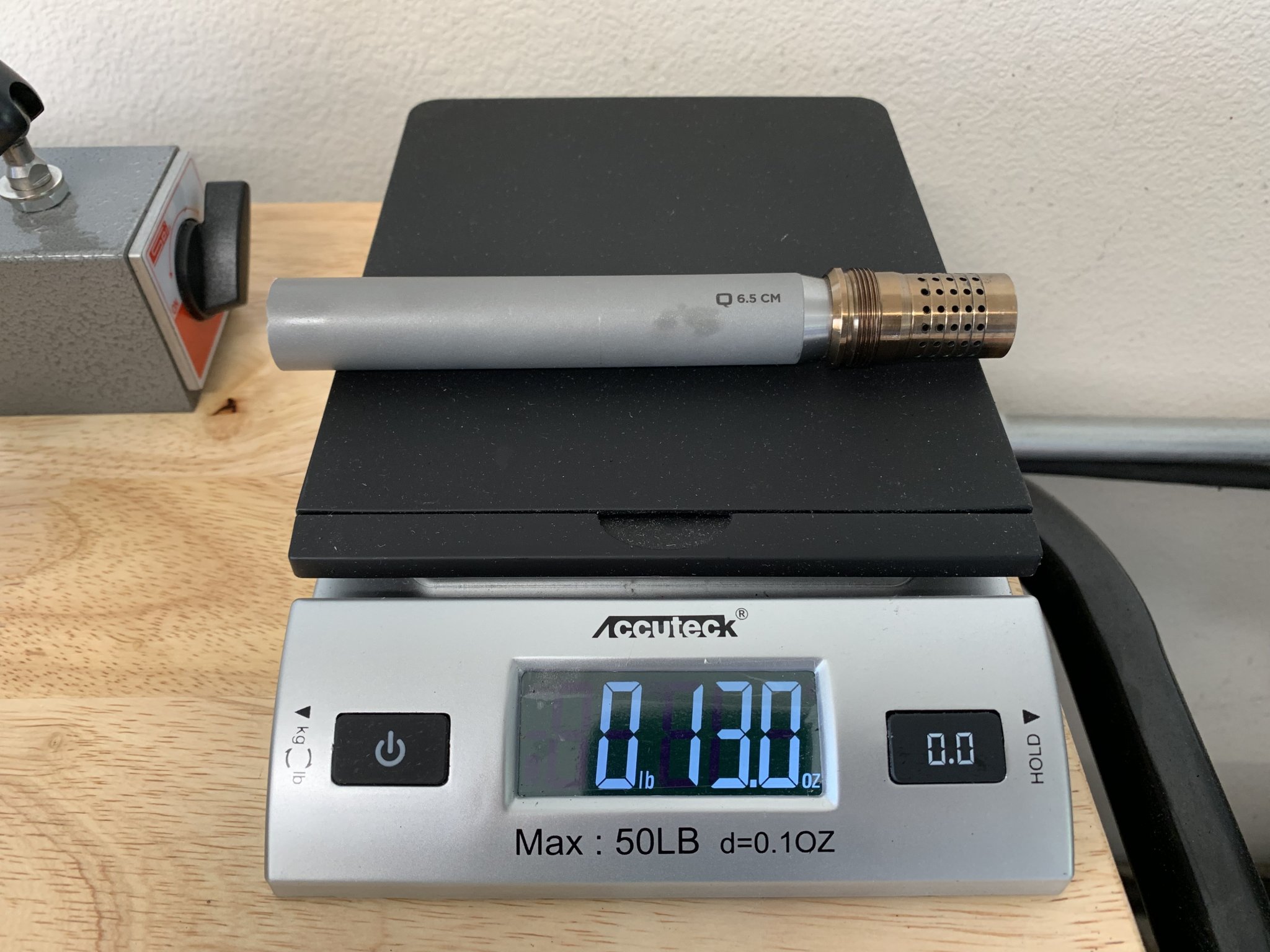

Does anyone know how close the weight of a factory cut off heavy 6.5 @ 16" is compared to the factory 16" 308?
Thinking of cutting down my 6.5 and not sure how close the weight is
My 22 is going down to 17 in the next few weeks.
According to the site 22 to 20 is about 3 ounces only . So I am expecting 17 to be in the 2lbs 10-12 ounces range. A 16 308 is 2 lbs 4 ounces. I could prolly flute it and have it down close to 2lb 4 ounces but not sure if I would.
I've likely missed it in the last 73 pages...
But
My 20” 6.5 creedmoor Bartlein weighs 3.10
My 16.5” .308 Bartlein weighs 2.3
I can’t see chopping 4” off the 6.5 will save anything like a pound.
The .308 profile is very thin in comparison. Even the 24” 6.5 proof research. Is nearly 9oz lighter than the 20” barrel.

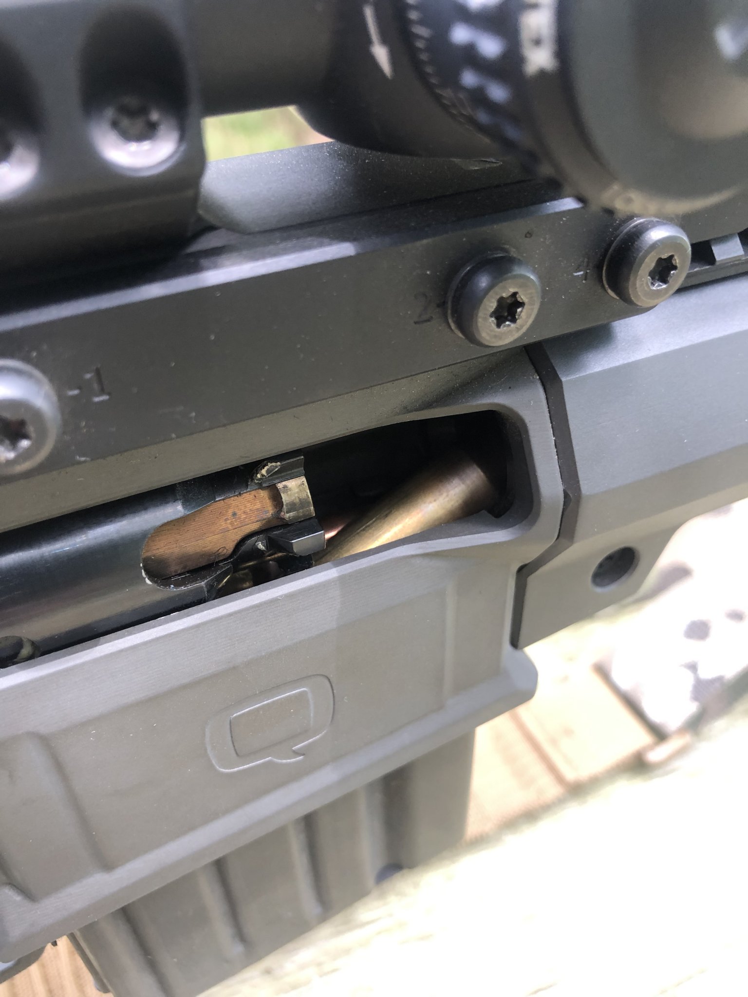

Does anyone else have this happen? Velcro shim to keep rounds from jamming into the feedramp but now this. Bolt speed and different mags doesn't seem to make a difference. Running the bolt faster just means mangled cases.
This is with KAC 10rd mags. I have 5 total.

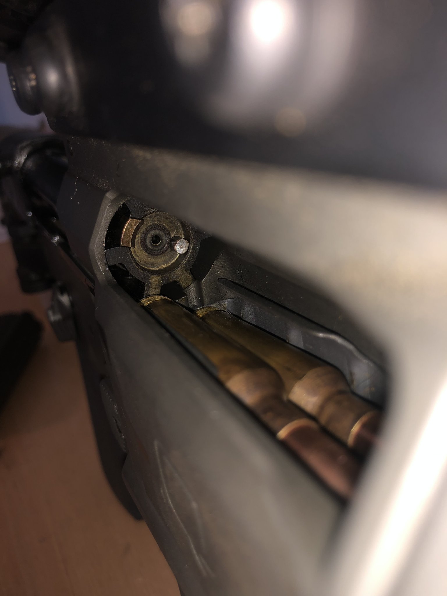

Is it the same position in the mag every time or is it variable?
Could you take a photo of the loaded mag in the rifle and the bolt head just at the position it is just touching rim. That’s where it’s going wrong I suspect.
Pretty much the same place from the left or right column. My first thought was that I was short stroking it and it was my own fault but it'll do it starting from a fully rearward and open bolt as well. Honestly it seems like this issue and the others stem from the mag sitting too low.
I could try tweaking the feed lips but then I guess I'll have to clearly mark and segregate these mags so I don't try to use them in my mws which is flawless.

I'm at 2.84-.845 in a 2.86-7 mag so I don't think that's it. As the round tilts upward going into the chamber it looks like the rim slips below the bolt lug sometimes.
The bolt looks like it is engaging the case head enough.
I have just looked at your first photo again. Is that an actual fail to feed or have you mocked it up as an example? It looks like that’s a spent case and not the new round stripped from the magazine, I can’t make out the bullet in the case neck.
Your bolt head also looks like it could do with a wipe down.
That was an actual fail to feed. After about the 3rd one on that mag I was pissed off enough to take a picture
