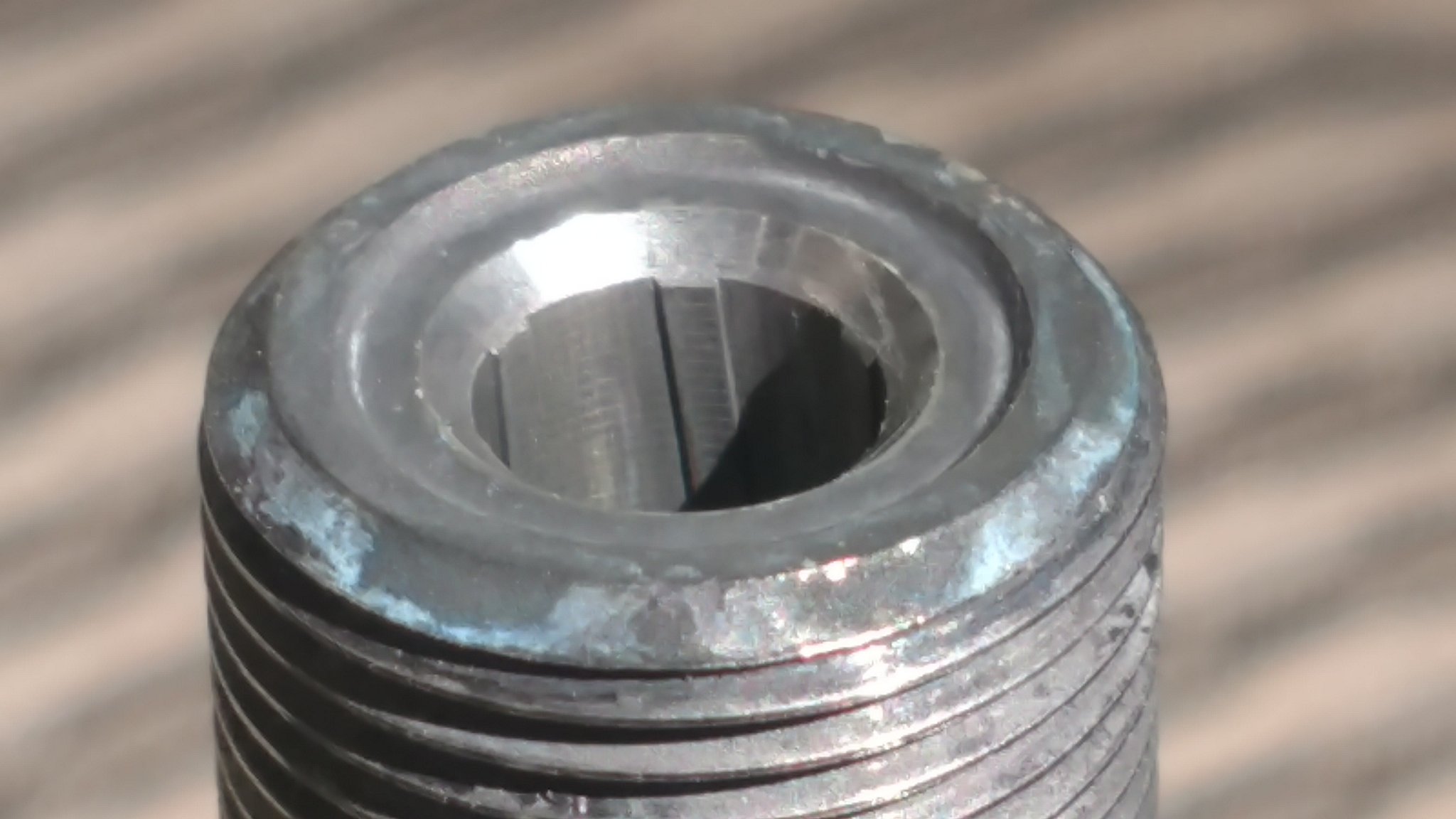

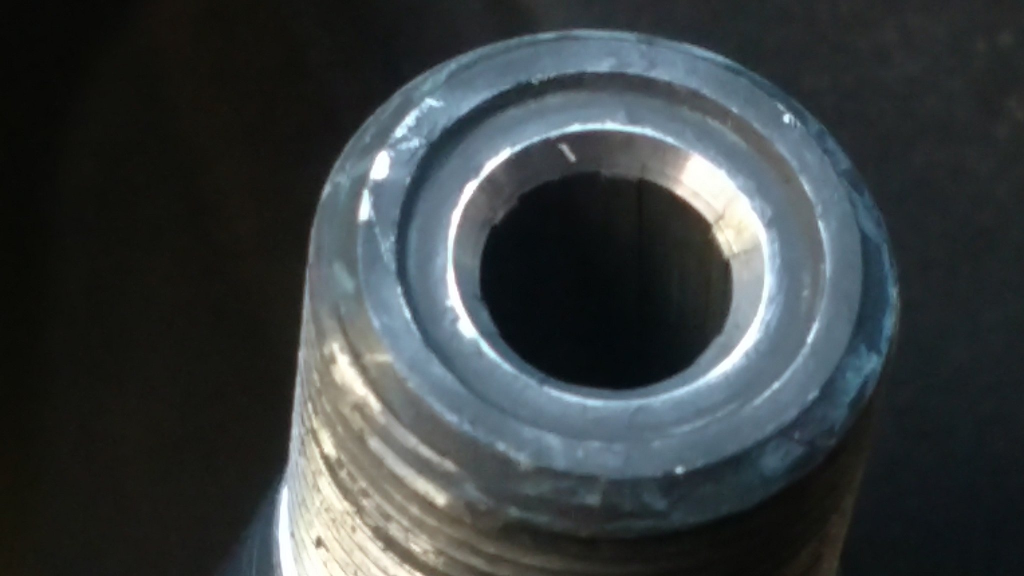

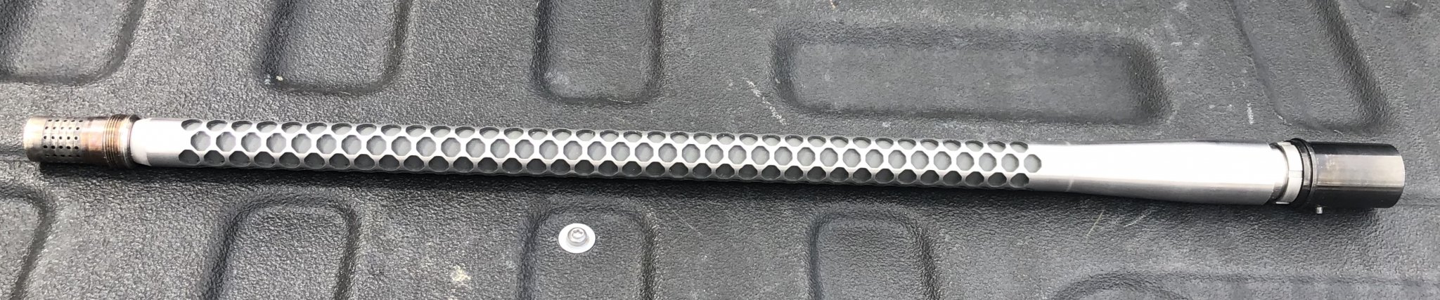

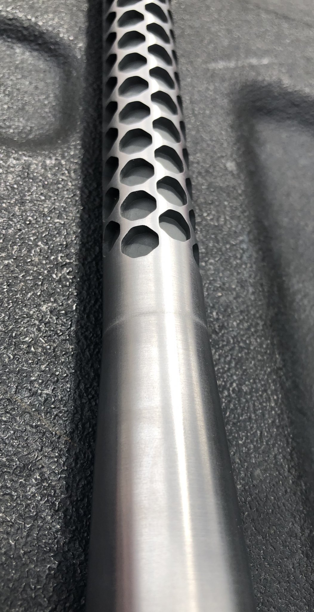

ETA: not fired since cut down
What am I looking at here? Looks like the rifling distorts in to the barrel. Is this CHF?
What am I looking at here? Looks like radial rings on the lands and groves. CHF? I've never noticed this.
I've got a couple hundred rounds through it max, probably 140+/-
I thought it was shooting fine with 120amax, around 1", little over with a couple anomalies.
They don't shoot great on my DT either.
Shot a little better with 140, just under 1"
This was my first outing, I assumed I would improve with trigger time.
Recently, couldn't shoot a group with 143 eldx or 127 lrx. Like 1.5-2moa. I wasn't having a great range day overall though.
I had it cut to 20" and changed the muzzle to work with the device I've eyeballed and already dedicated other muzzles to, was just looking at this souvenir and noticed the strange features.
That looks like button rifling chatter. Which barrel is that? I've never seen a hand lapped Bart look like that.
Reactions: Huskydriver
If this is a 6.5mm, Bartlein typically does not make a 6 groove in a 6.5 caliber. My first guess is that is a button barrel considering the perpendicular rings, but but made by whom? Only Q may know.

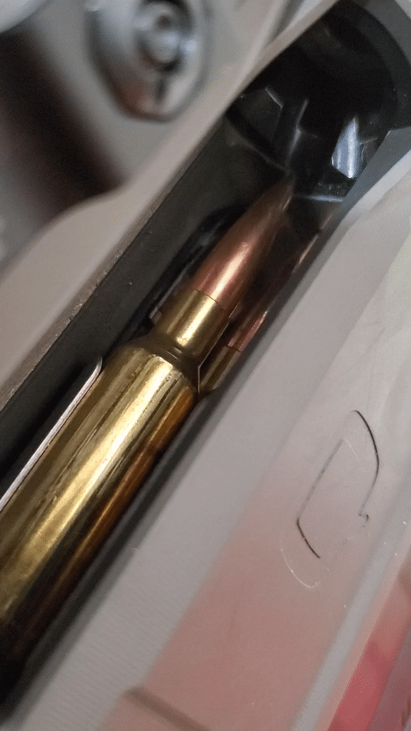

So I bought a Lancer mag to see if the wiggle / feed issues get better..... Nope. Here's a video showing the degree of wiggle.
@Kevin Brittingham - please give us an official Q position on this problem.
Another challenge is that the nose of rounds appears to hit the barrel (not the extension) at the chamber chamfer. The tip getting hung up here is why people are advocating forceful cycling of the bolt. Chamber the same round a few times and examine the tip for damage. For rounds with low neck tension, I would also suspect that the bullet is being recessed into the case reducing OAL.
Pretty much exactly what mine does. The lancer actual looks tighter than a Larue or 20rd KAC. With those the bullet tips actually hit below the feed ramp and will not chamber no matter how hard and fast you cycle it..... Without the Velcro strip in the magwell. I really only use the 10rd Kac with it and they're much better luckily.
