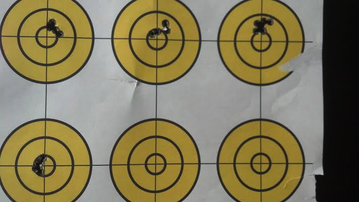

First pic below are 5 shot groups showing rounds 11-15, 16-20, 21-25, and 26-30 left to right and then down to lower left. The targets are 3 inch circles with 1/2 inch center.
I went out again yesterday and my first few groups looked like those above but I finished with this 5 shot group. I now have 80 rounds through this rifle. These are all from a bipod and a Triad large wedge rear bag.

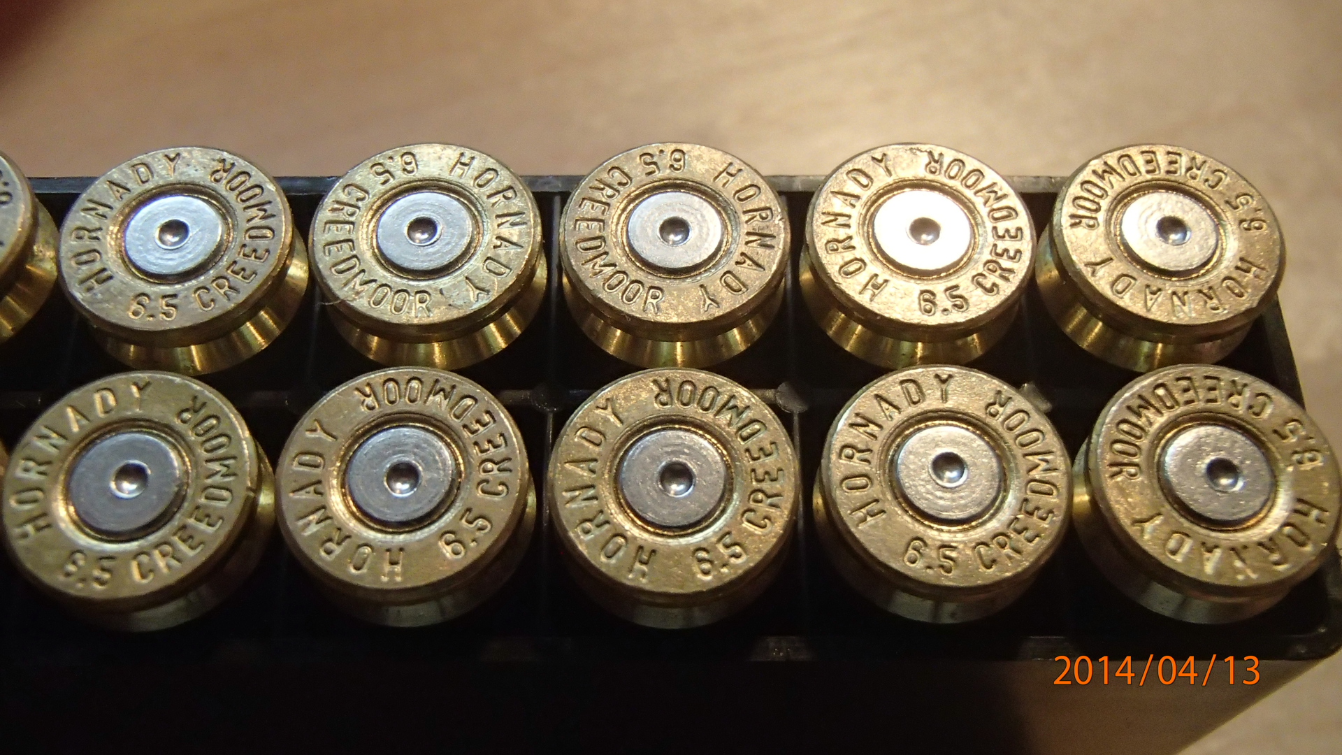

I took the rifle out again today to finish off the last 10 Rounds of Hornady 140 Grain A-Max that I had. Everything was fine. I am blaming the oil here for my issues. If I had another box of the same lot left I wouldn’t hesitate to take it out and shoot for groups—But I don’t.
On a side note I was pretty happy with the reloads that I tested. I ran both Hornady 140 gr A-Max and Hornady 140 gr MATCH bullets in front of some IMR4350 . I was shooting 3 shot groups and found a node that seems to produce about 0.3 MOA groups at 100 Yards. Hopefully I get the same results when I head out to fire some 5 shot groups.
Here is a pic of the primers of those last 10 Factory rounds.

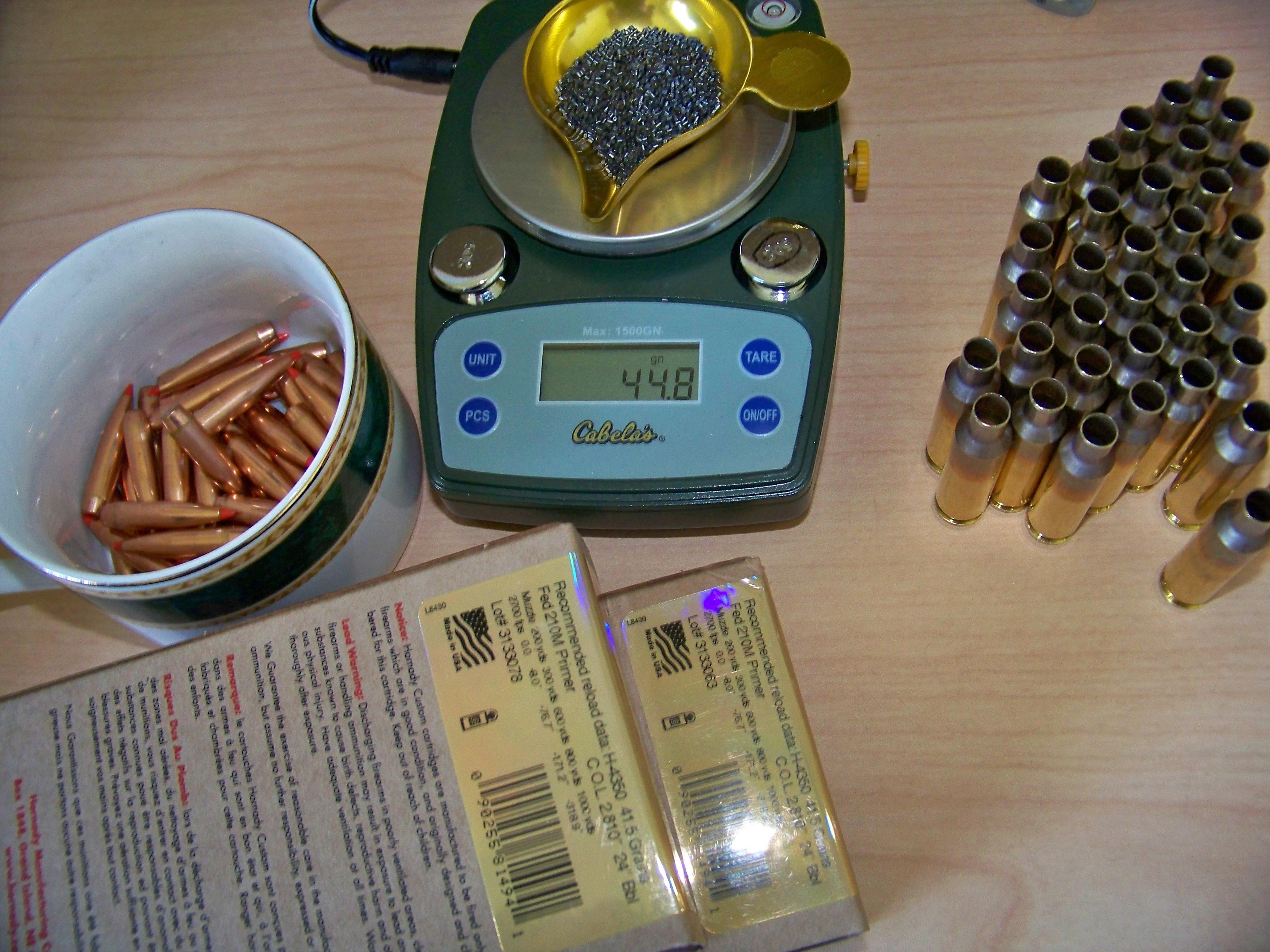

I just opened 40 rounds of the Hornady 140g A max Match ammo:
20 form lot #3133078 they had between 43.8 and 44.8g of a powder other than 4350 in them.
20 from lot #3133063 they had between 43.7 and 44.4g of the same mystery powder.
Verified on two different scales and made sure they were both in spec/calibration.
I called hornady and they are not at all any help. They said and I quote "we don't always use H4350 and the recommendation on the box is just a recommendation". They admitted that they substitute powders when they need to.
There is no good reason the a 6.5 CM load would have 44.8g of powder. Maybe only if it were H1000 which it is not. I don't know the exact powder but it not in the H4350 IMR4350 or AA4350. My guess is after measuring it and checking with the NCFS Smokeless Powders Database I would conclude it to be reloader 17. I cannot be sure of it but that would be the reason people are getting over pressure on every brand of rifle.
The 6.5CM should not ever achieve a 2950fps velocity with a 140g projectile. THIS IS NOT YOUR RIFLE!!! IT IS THE AMMO. It is the only component that is the same with all the situations we have heard of. The thought that every other rifle in 6.5CM from various manufacturers would have an issue is assured. A bullet consist of only a few components (projectile, primer, case and powder) we all know it is the powder that is giving people the classic over pressure problems.
WHAT SHOULD YOU DO--- Call and complain to Hornady, report them to every agency you can contact. To my knowledge no one has been injured yet, but I would speculate that this might change if nothing is done.
My advice is don't shoot them with that much powder in them. I am pulling all that I have and am reloading them with a powder that I am familiar with.
Please be safe.

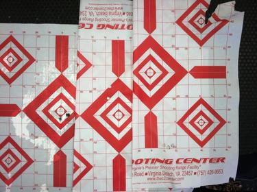

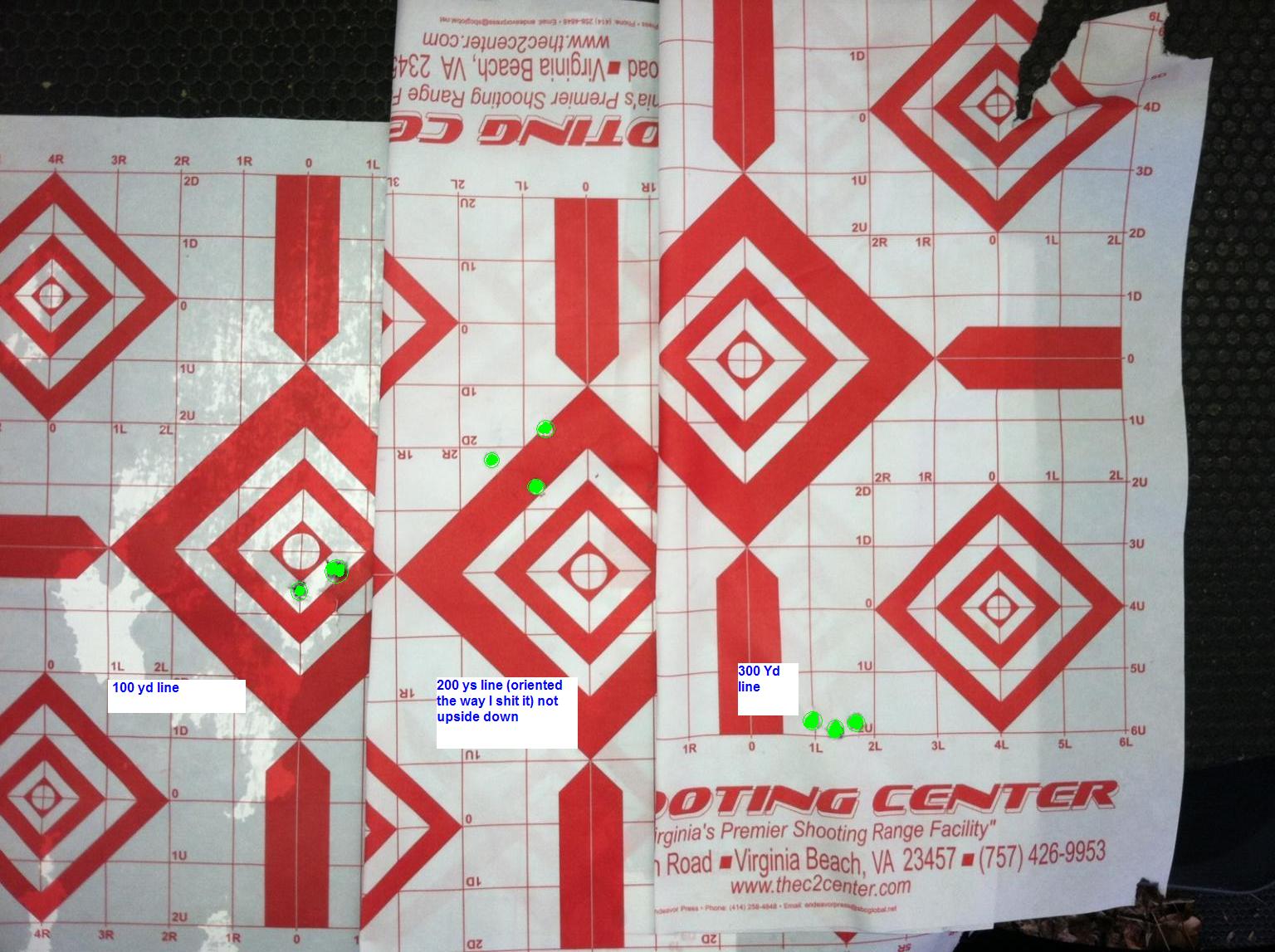

I have noticed that my CM shoots awesome at 100 and great at 300+, but at the 200yd line it opens way the hell up to like 1.5 MOA. I have taken it to 1k and shot a 6"/ 5 shot spread off a bench with the 140s. The rifle is accurate, I just cant figure out why it opens up so bad at 200. Any ideas, suggestions, comments?? Thanks.
So your shooting 2 1/2" groups at 200 and 6" at 1,000?
What are your your actual group sizes at 100 and 300? You never said
At 100 the groups are 1/2" then at 200 they open up to 2.5-3" groups, at 300 close back down to 1.5-1.75". I had a picture of the 3 targets side by side after I left the range that day. Trying to find it now, If I can, Ill post it. The measurements on this reply are all inches NOT MOA as I lested in my initial post above.
I cant blame it on a gust of wind during that string of fire either because the 1, 2, and 300 yd lines are one shooter apart essentially. C2 Shooting Center look on the homepage and it has an ariel view of the range I shoot at. 100, 200 and 300 are on the left and I set all 3 targets up before I started firing. I fired my 100 rd group then moved to 200 to fine tune come-up, then moved to 300 to fine tune come-up. I didnt rush or or take my time. I fired slowly and took my time to get a nice group so I can start building my dope book. All 3 firing positions were off a bipod, with rear bag and off a bench not prone. It was drizzling and like 52 degrees but it shouldnt have effected the round at these short ranges.
I will say this, at least for me, firing off a bench isn't nearly as comfortable as prone. Alot of movement on my part when shooting from a bench. How many times did you try grouping at 200? Only reason I ask is human error. Because there is no way a bullet can go from 3" to 1.75" in only 100 yards. My opinion, human error. Go back and try again and don't worry about getting drop info. Just pick a point on a target and keep shooting at it 5 times. Don't move your turrets. I can almost promise it'll be Better
