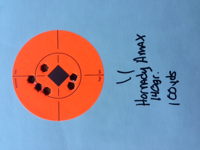

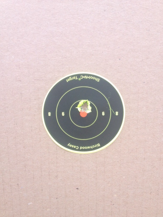

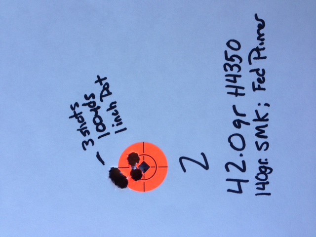

Yeah, no kidding. My first batch was TERRIBLE. (#3131672). I thought my gun was bad and I was ready to send it back to the gunsmith until I finished those 200 rounds, and switched to my other lots, which both shot MUCH better.
photo 1.JPGphoto 2.JPGView attachment 44149

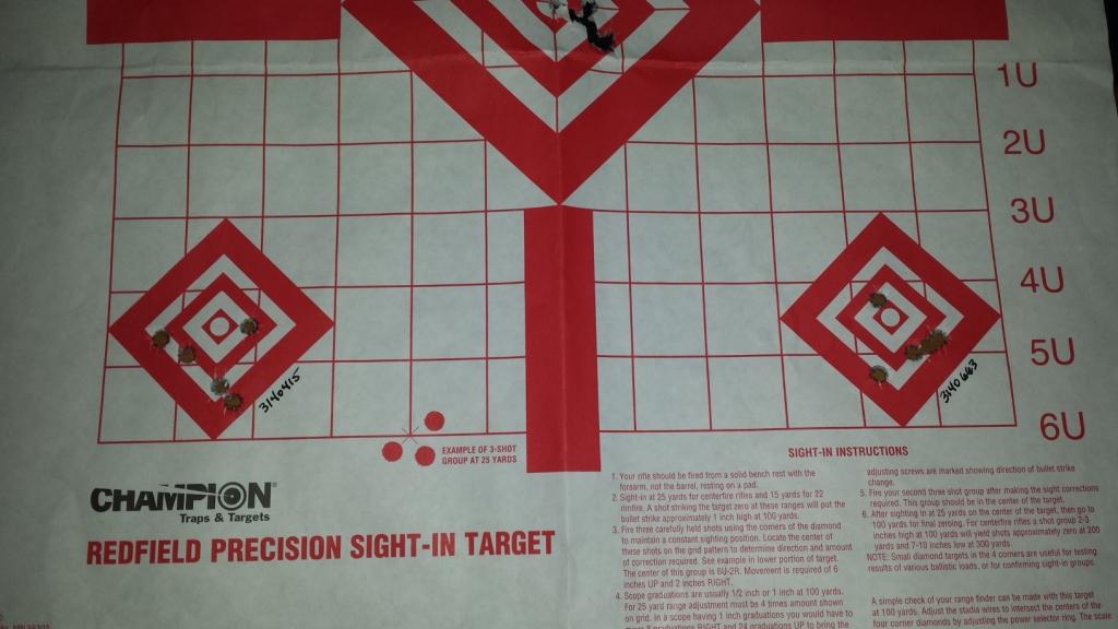

I'm not sure if people are still experiencing problems with 6.5 CM factory ammo but I read through this and other posts indicating problems and wanted to share my issues. I have three lots which I shot last Saturday. I had heard people were having great success with factory ammo so I jumped in. I was extremely upset with what I found after my first trip to the range with the new 6.5 Creedmoor.

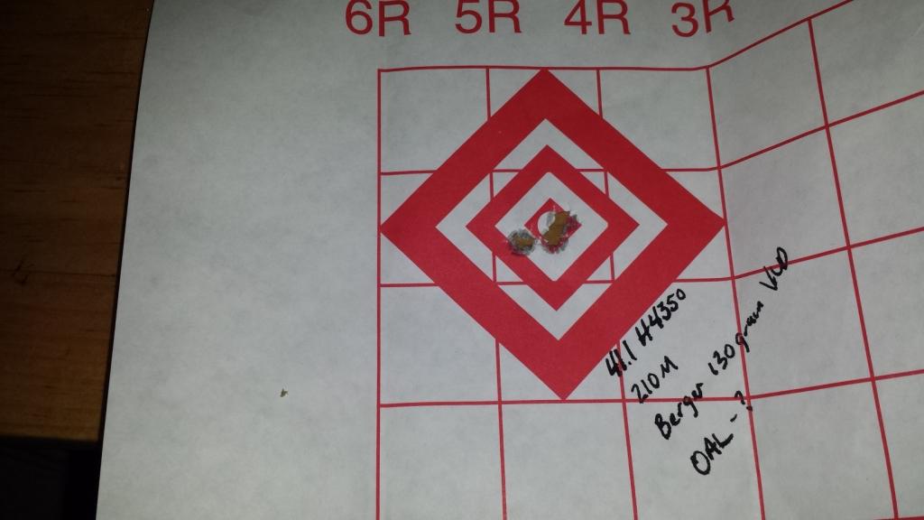

After shooting three groups, My blood began to boil. I wondered why in the hell this rifle couldn't do what my stock savage barreled action in a manners stock could do. I asked another patron at the range, who was shooting reloads from his 6.5, if he had been having issues with factory ammo. He said he was only shooting reloads so he had not witnessed issues. I continued to tell him that my rifle "sucked". He then volunteered 5 of his reloads. I was a little hesitant but asked his load data and felt comfortable so I figured I would try it. My rifle loved it. 41.1 of H4350, 210M primers, Berger 130 VLD. So after this, I realized that I should have never questioned the rifle build. I am upset with myself that I even questioned it.

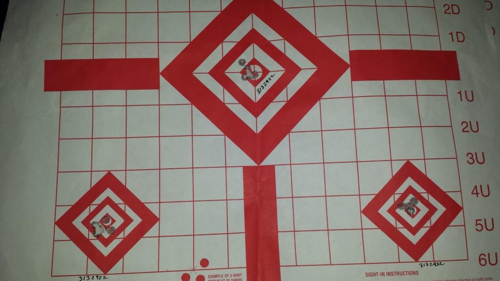

To this point, I had shot two different lots of factory Hornady and these reloads. I decided to grab another lot and try some more. This lot was exactly opposite of what I found before. I believe I saw earlier in this post that someone had the same lot with similar results. I have not pulled bullets from the poor lots,, but I will to measure the charge etc...
The 3 factory lots used:
3140663
3140415
3133922
Results:
Factory Target 1 (Bad Lots) - I have others but they all look the same so I only posted one target of each
Factory Target 2 (Good Lot-15 rounds, 3-5 shot groups)
Reload Target (One 5 shot group - I promise it is a 5 shot group!)
I do not profess to be a great shooter so take this for what it is. I am very unhappy however, with the inconsistency of this factory ammo.
Just wanted to share.

I just picked up 200rds of factory 140AMAX lot#3141767. Seems to be working well.
Here is 5 at 100
