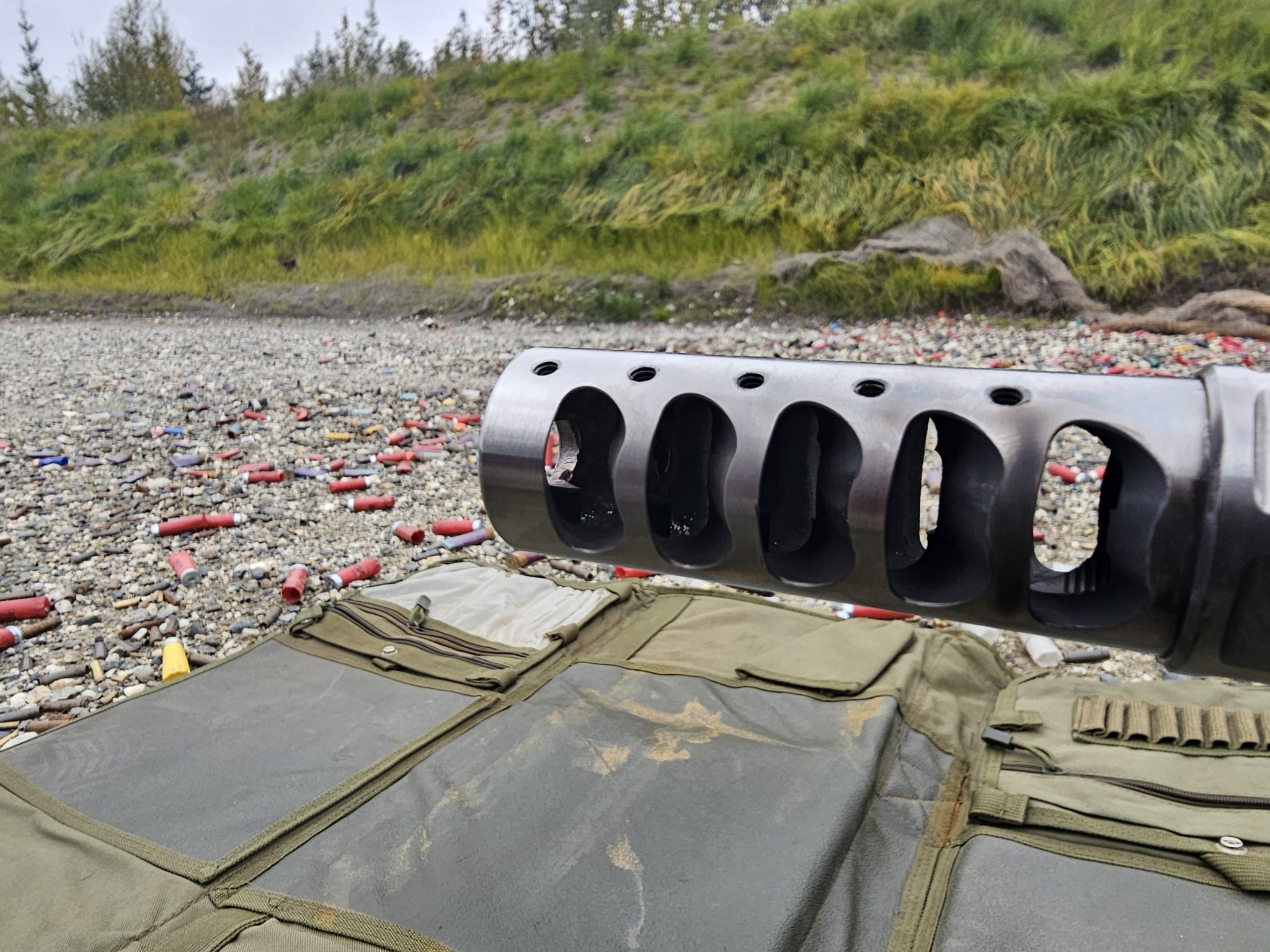

Bullet is surely not coming out correct from barrell as it also destroyed my brake.....do I still need to do that yaw card test?

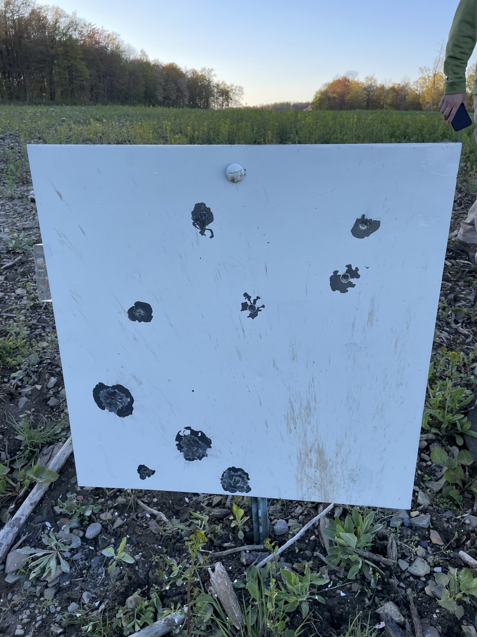

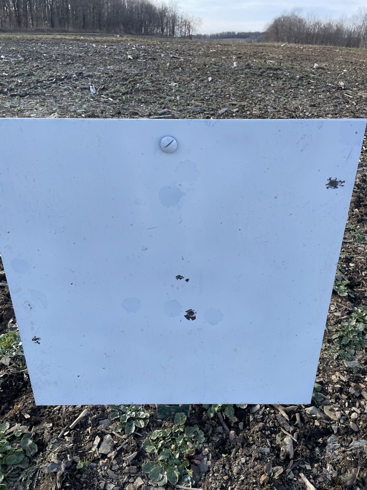

I noticed the Badlands being a softer copper leaves a nice signature on steel at distance vs the Warner FL. I can actually see my hits through the scope w the BL, splash is 3/4 of what the Berger 300 OTM leaves. I have no experience w CE Lasers so how is the splash at distance? We use hit indicators also but its nice to see where your hitting on the plate.
Reactions: harry_x1
6 w Badlands vs 3 Berger 300 OTM at 2315 from 33xc

2 Warner Fl 285 vs 2 BL 285 at 2450 if I remember correctly. Had some switch wind that day. Badlands, Berger no issues seeing the splash on target in the scope. Warners a different story. Anyone have a picture of hits on steel at 2300-2500w CE they can post?

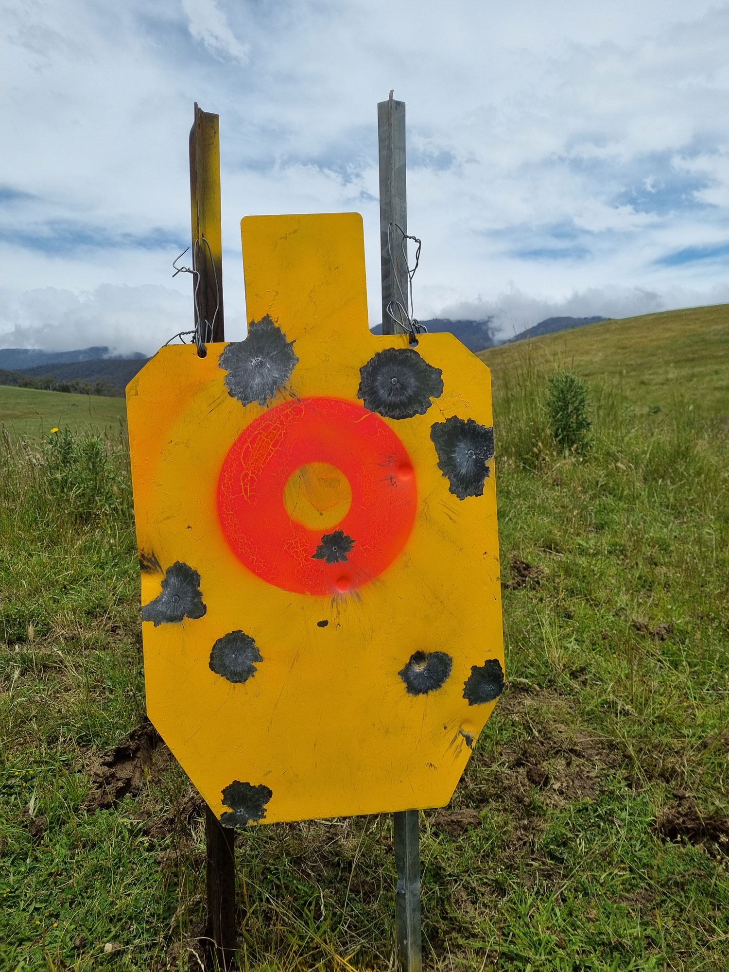

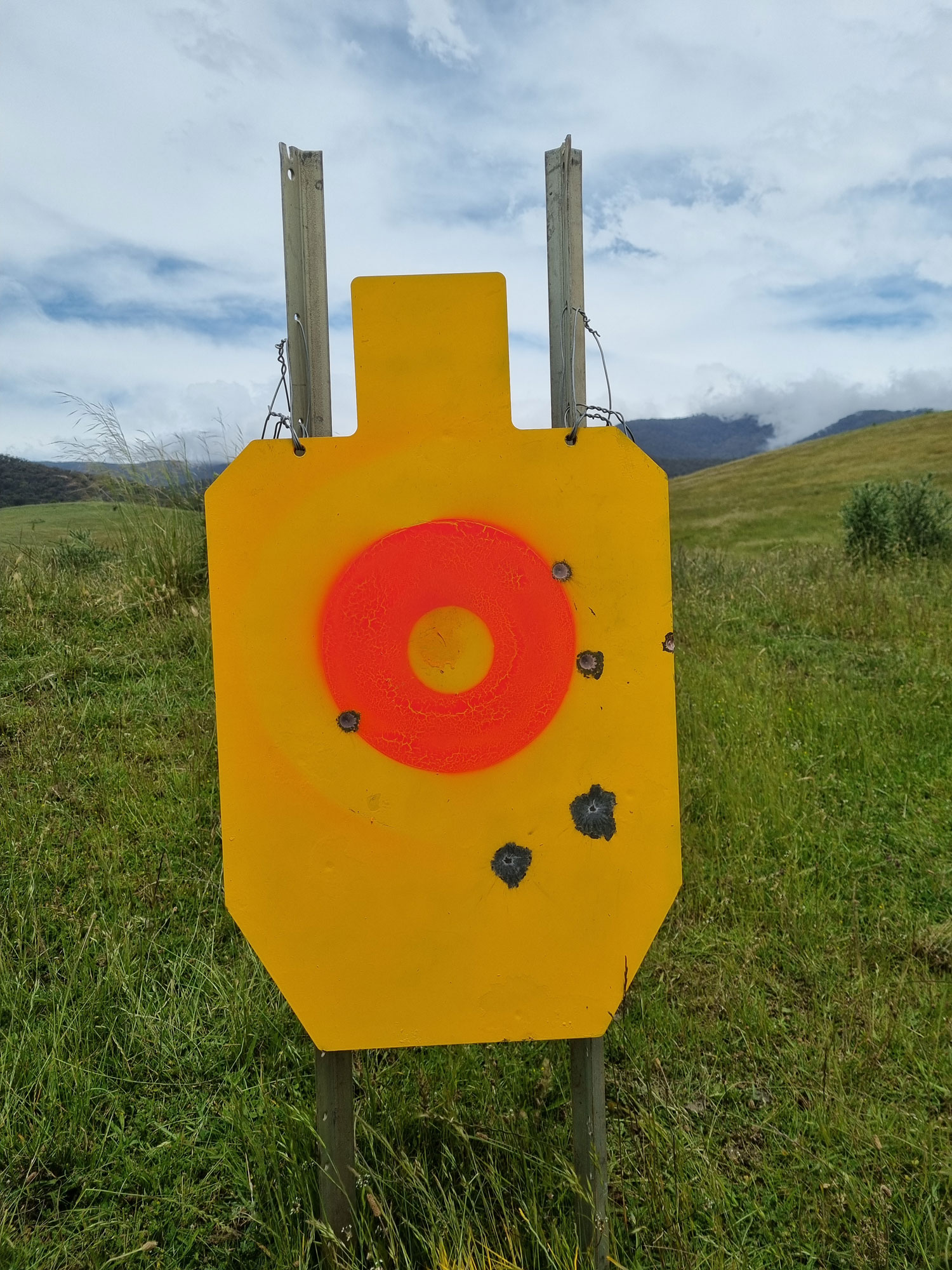

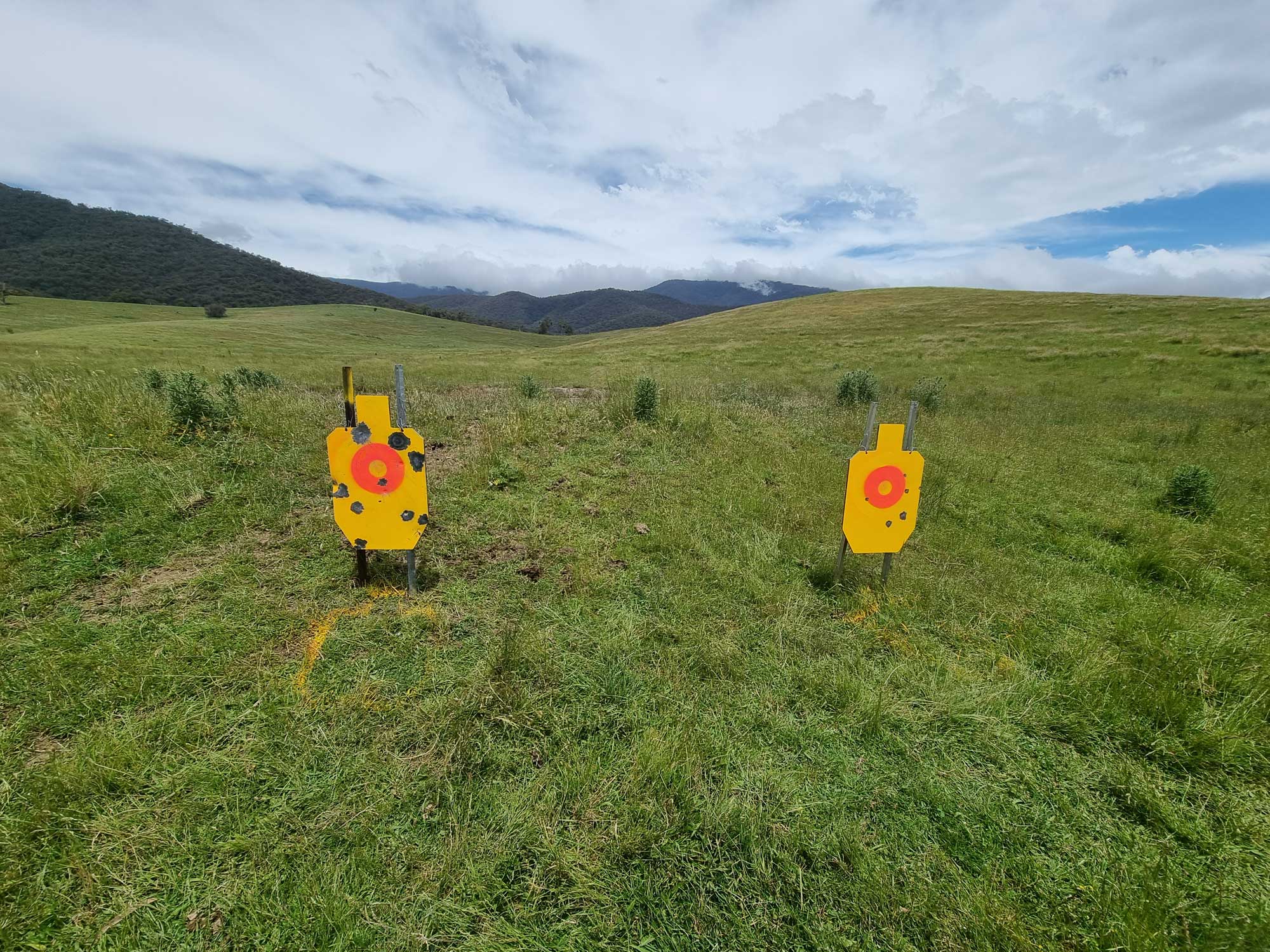

2500mtrs
375CT .. and 50BMG.
The 375Ct was with 390gr Atips and 379gr Berger Solids ( the 4 mosquito size splash's on the plate) ...
50BMG 750gr Amax and 375Ct with 390gr Atips strikes are easy to see..

Below is link to thread on another forum where I have detailed all the issues I faced using badlands. The barrel shoots CS Lazers fine but with Badlands it was all over the place. I ended up with a destroyed suppressor and muzzle brake. I even shot the barrel without any muzzel break, diff loads, seating depths etc....but results were same. I concluded it has to be something with the diameter of the bullet for that particular batch. Let me know if you have an alternate hypothesis after reading this thread.

I am at the range now and I'm having the same issues with the 285s. My groups are are wild right now. Man I was really hoping it'll be ok.
33XC 285 ICBM N570
114.5 gr 3067, 3069, 2085, 3072
SD 8.3 ES 18 avg 3073
33XC 285 ICBM H50 123 gr
2967 fps
2995
Error
There are traces of the bullets in my brake. 🥺
