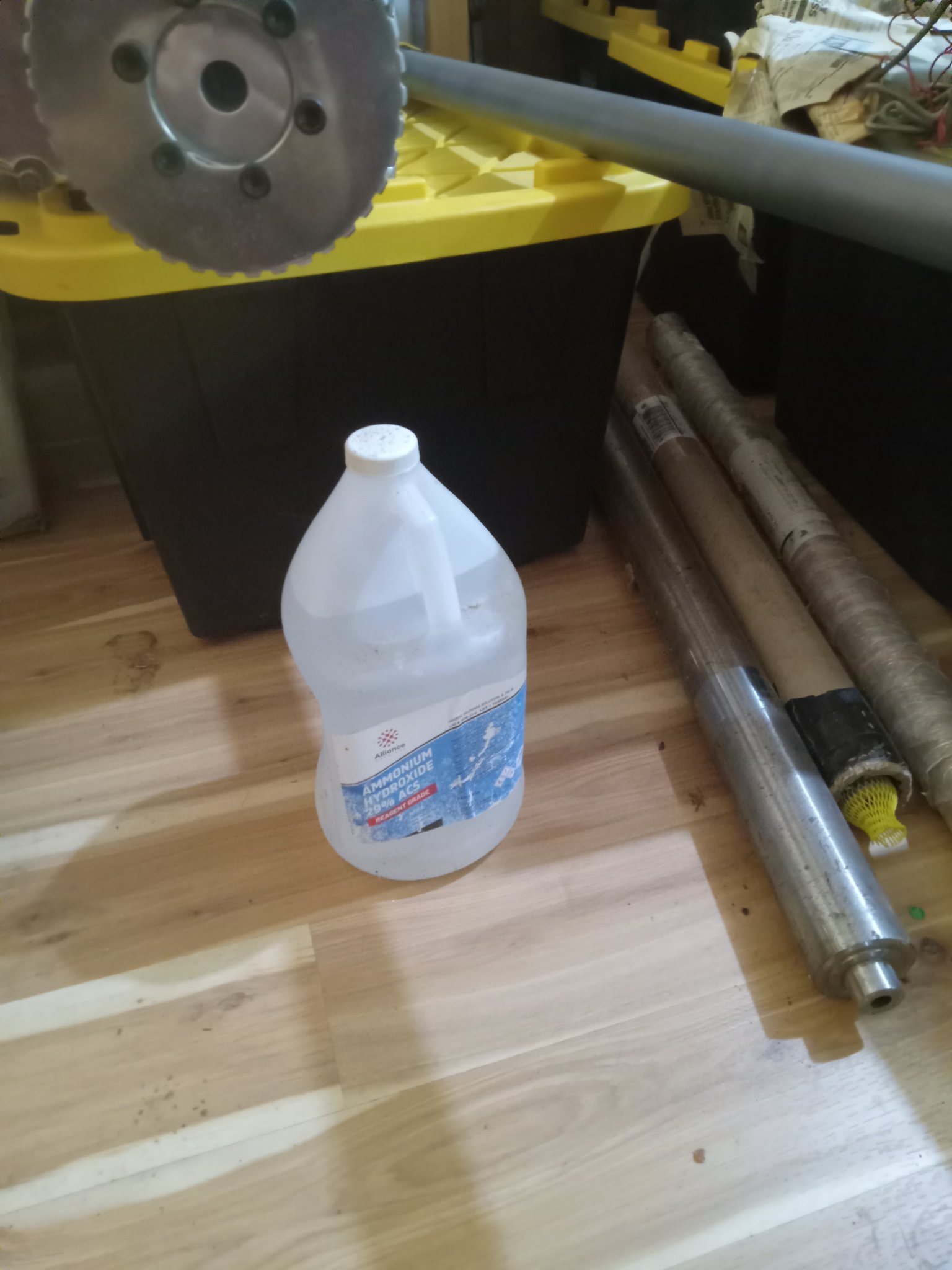

If your cleaning outdoors you can use 29% ammonia to remove the bullet fouling. I use a bore guide and a rubber turkey baister(sp) to coat the bore thoroughly. I then get rid of the carbon with GM top engine cleaner. If you buy 2 gallons at a time online you get free shipping and 2 gallons will last 120 big bore barrels
