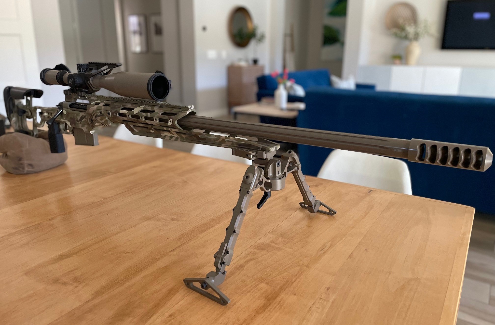

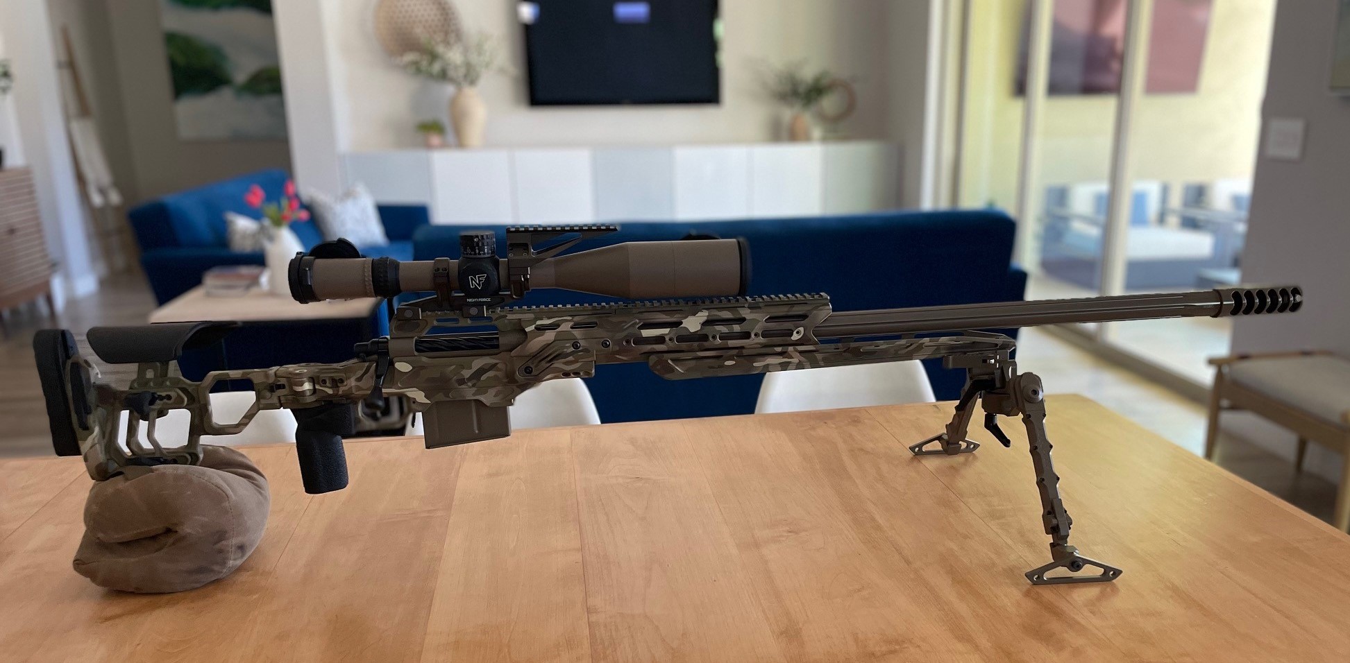

Real nice looking rifle. I like my AccuTac Bipod too.Mine is the 50BMG rated one. How does it shoot so far.If I can ask how much was the chassis?Ilike its looks.Got my 41XC barreled action last Wednesday and put it together this weekend. The barrel is heavy!! The Defiant Rebel looks puny compared to the barrel. Hope the CADEX chassis is up to the challenge. I'm really liking the Accu-Tac Bipod.
